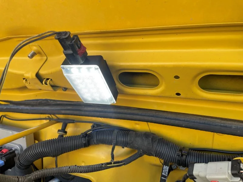

Installed an LED-based underhood light. I'm on a roll today LOL. Andy

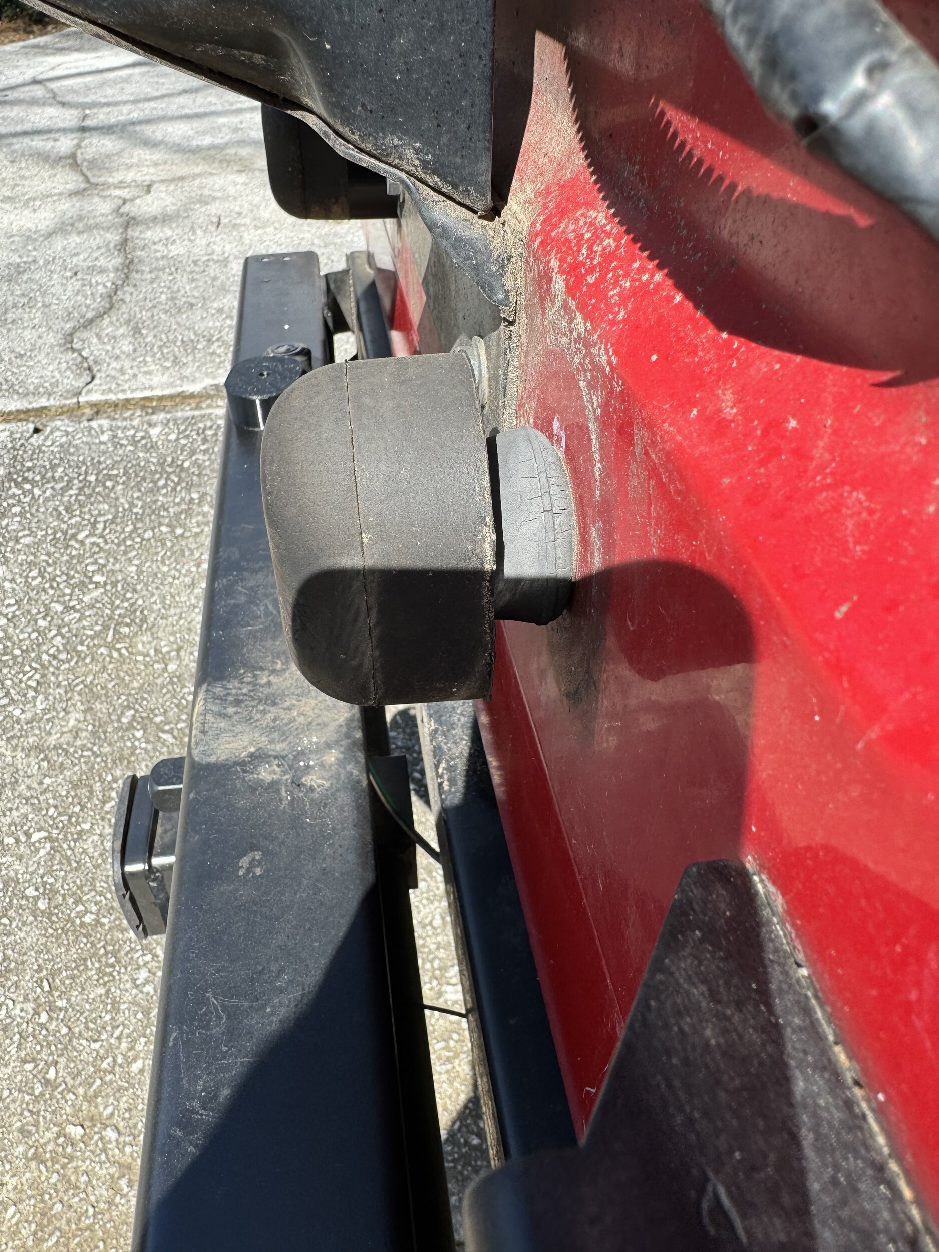

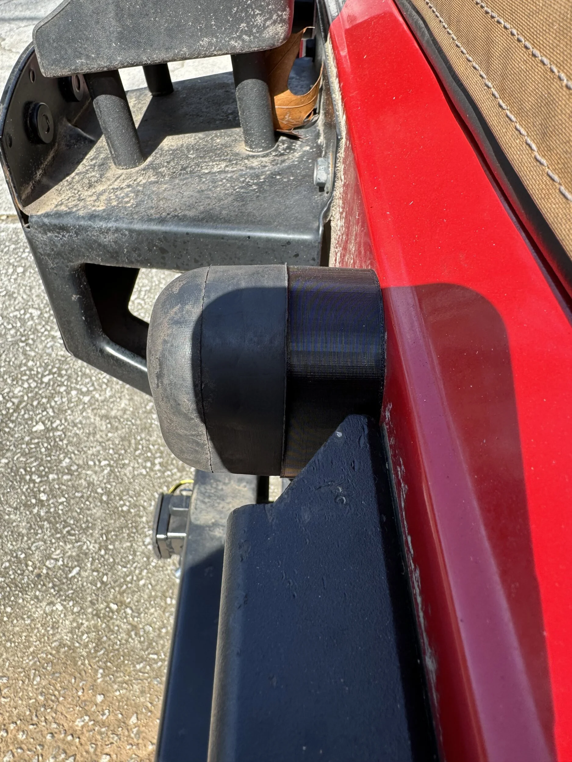

Thanks to @gbirk for the file and @SSTJ for maintaining the list. I got my new 3d printed snubbers installed. Looks much better than my DIY PVC and cane feet setup.
I printed half a dozen of these ^^^. Certainly don't need all of them. If anyone wants a couple, PM me. I think I paid like $4 each.

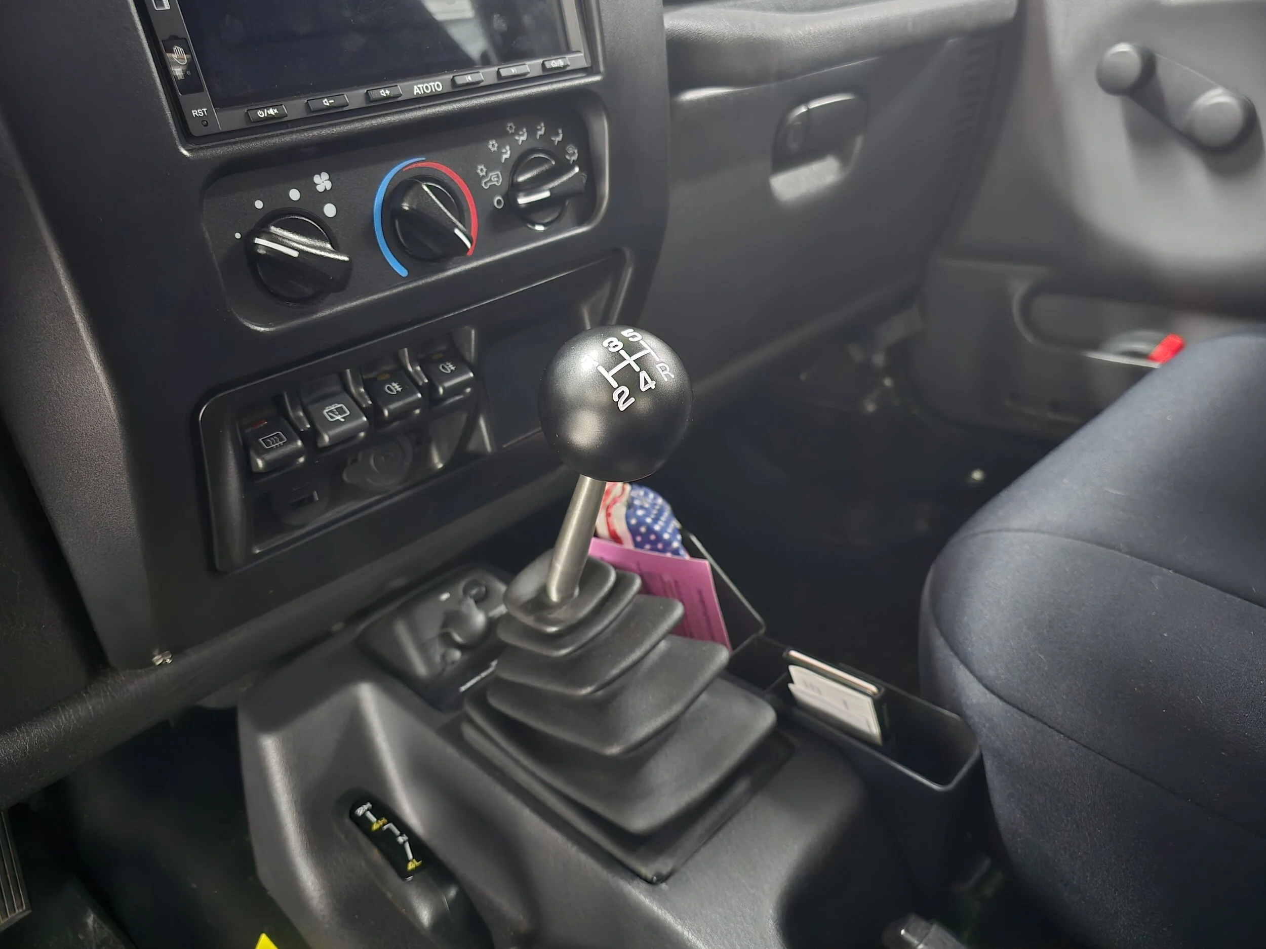

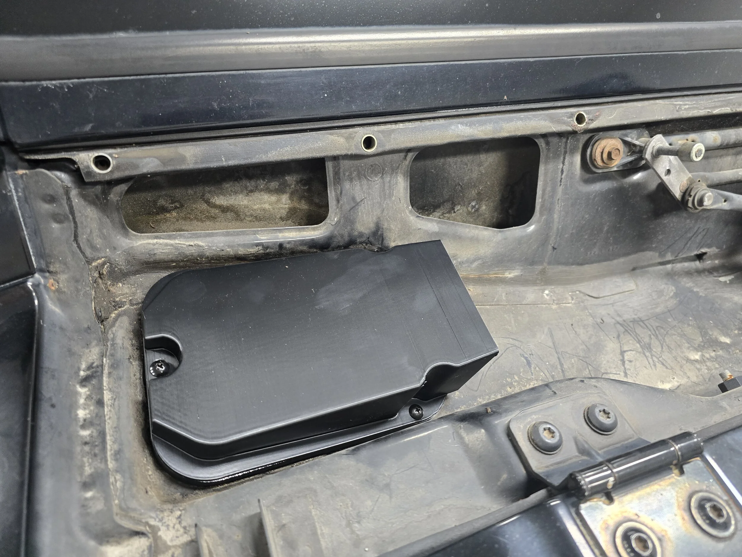

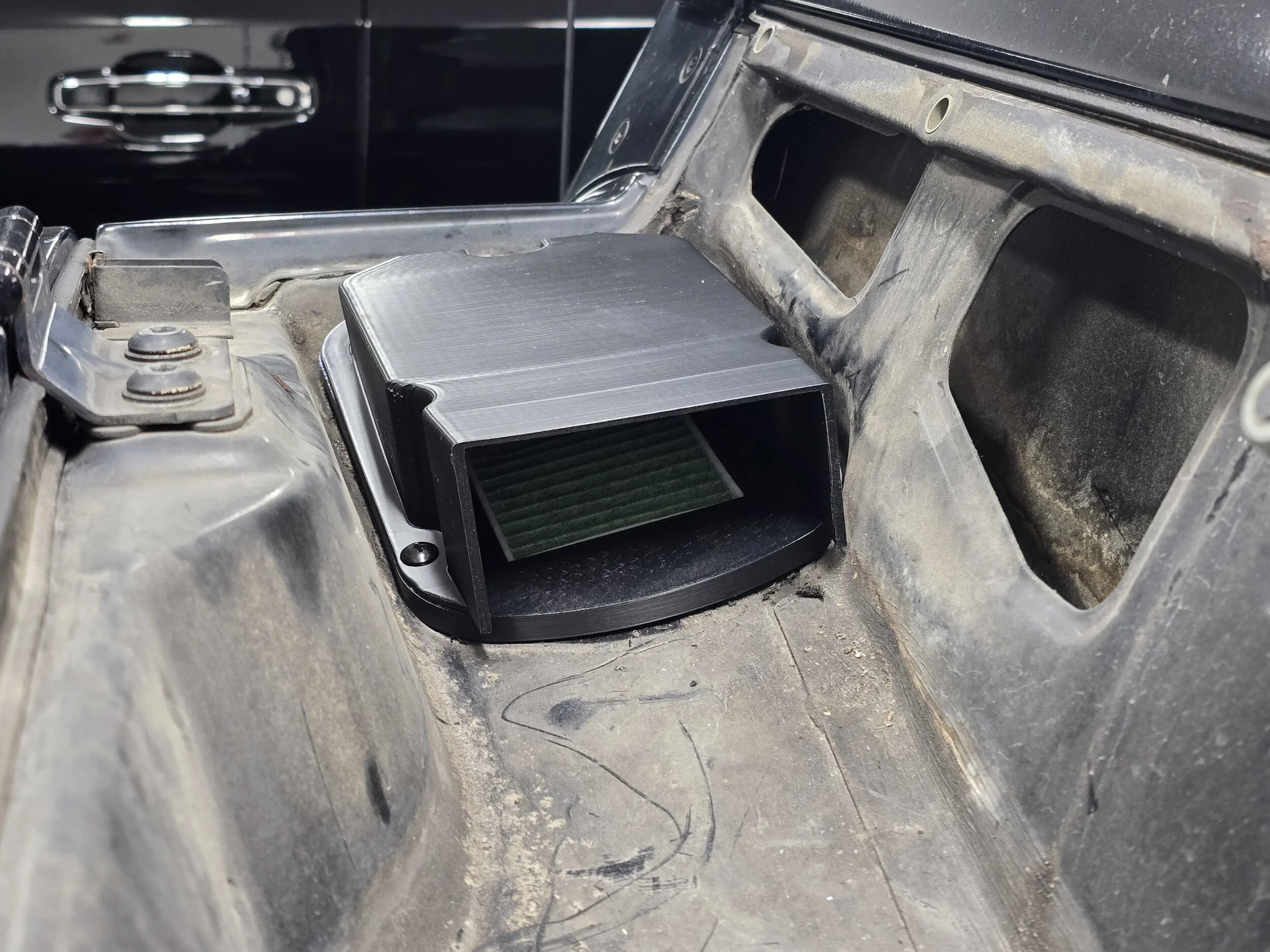

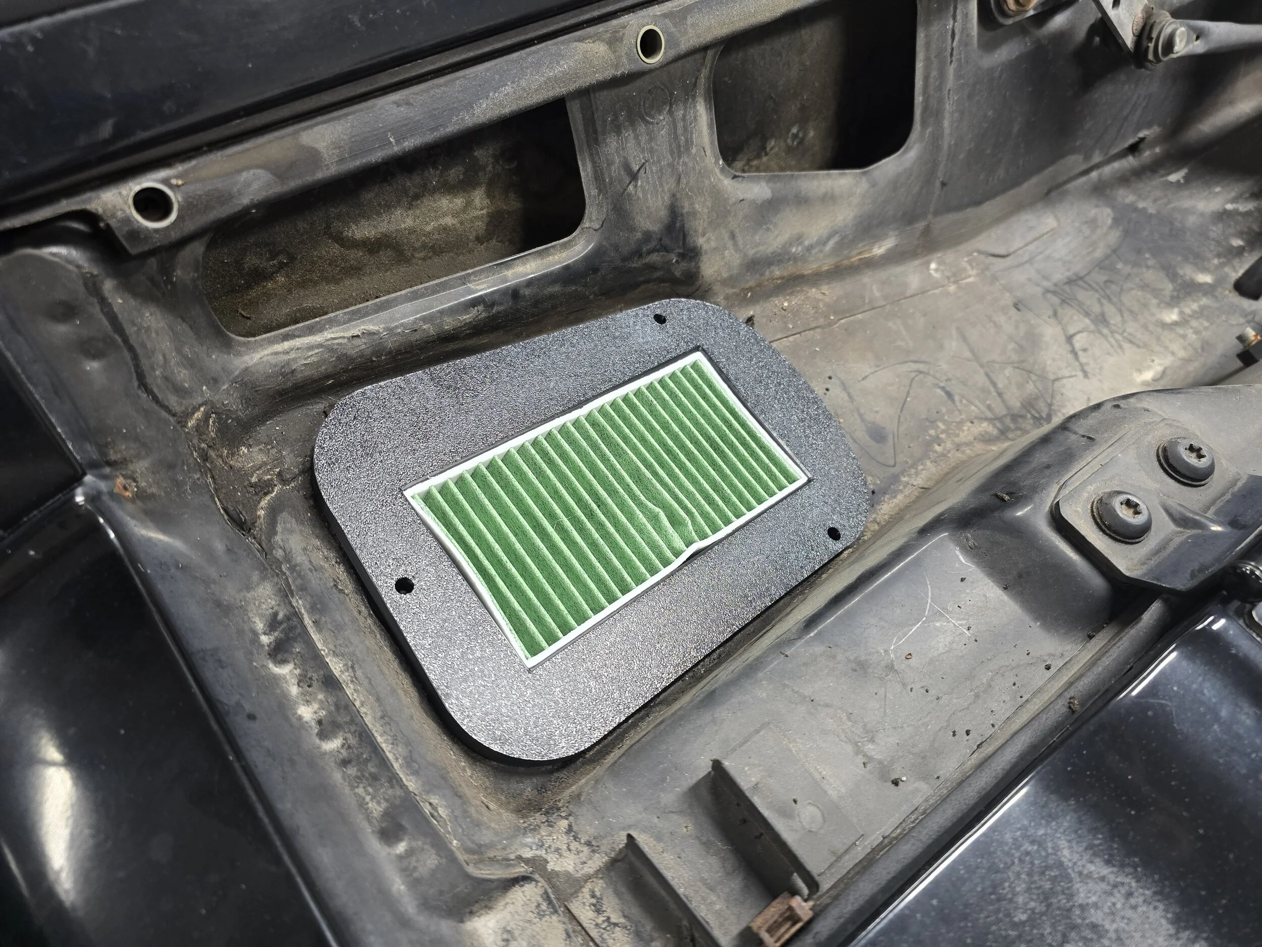

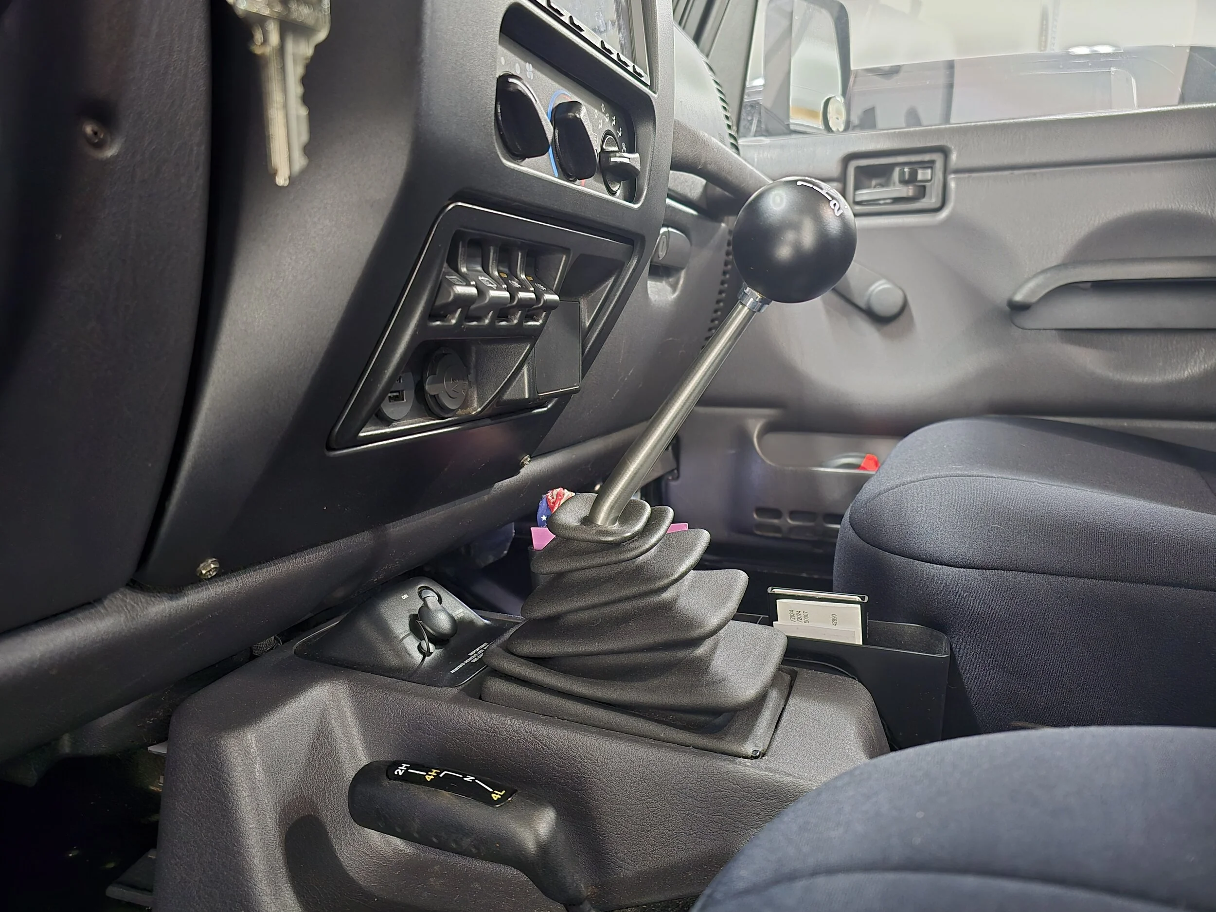

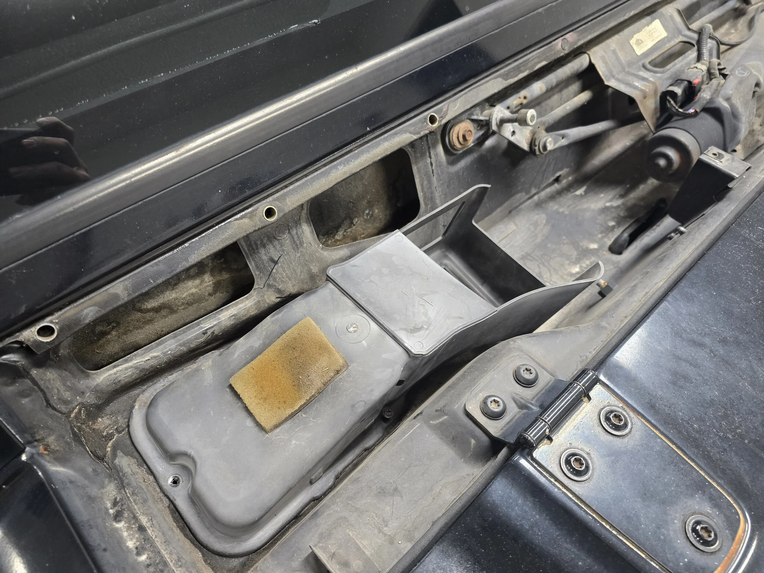

I installed the B&M short throw shifter and a cabin air filter housing. I am interested to see how different the shifts are in the morning after the RTV dries. The cabin filter is 3D printed and the filter is from the JK's.

Got a link to the file for the cabin filter housing? I'd like to print one of those. Still chasing a passenger side water leak.
B&M is in my top three favorite comfort mods... B&M, Seat risers and seat warmers.

How long are your snubber extensions? I may be interested in a set of them if they are long enough.
Here is a link to the cabin air filter housing. So far it has done great.

The B&M shifter is fast becoming one of my favorite mods. I had a grinding in 2nd gear that after a fluid change and shifter change it isn't there anymore.
Thank you for the link.
I had the exact experience with second gear. Fluid change, which was needed anyway, and that resolved it. But the short shift made it whole lot more fun.
The snubbers are too long for my needs. 1" tall. I made a mistake in not checking how big they are before having them printed. I am going to cut down two of them. The rest are up for grabs.

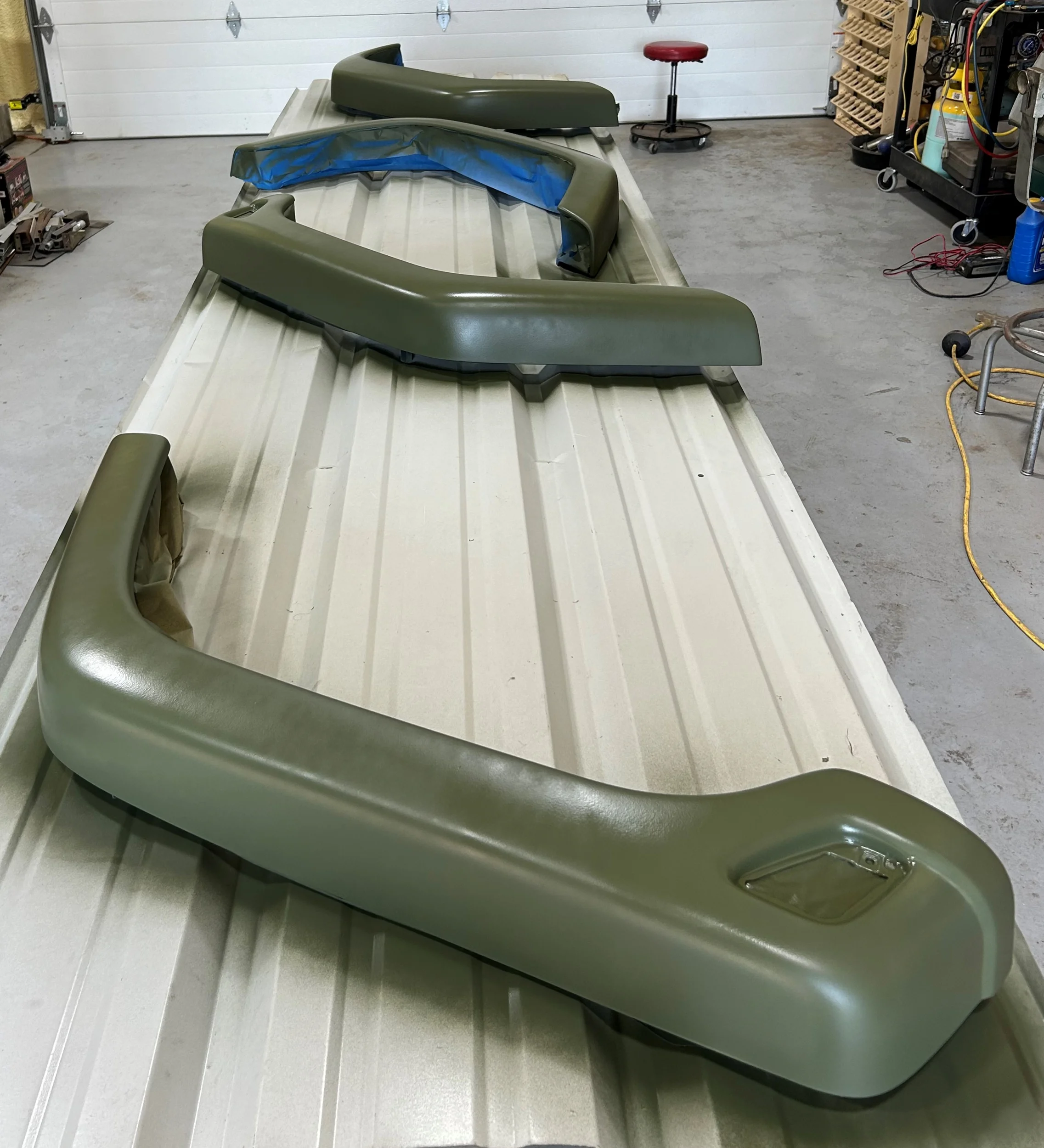

So, started the day off poorly, but it got better when I started the big project of the day. I realized that, although I don't think they inspect for fender coverage here, there are signal lights in the front fender flares. I had removed the flares about a year ago, meaning to paint them, but never did. So that was today's big project. Here's my "recipe":
  1. Wash with Dawn
  2. Dry with compressed air
  3. Clean with SEM Leather and Plastic & Leather Prep (#38353)
  4. Rough up with grey Scotchbrite pad
  5. Sand heavy scratches with 120, 220, 320 on an orbital sander
  6. Rough up with grey Scotchbrite pad
  7. Wash with Dawn
  8. Dry with compressed air
  9. Clean with SEM Leather and Plastic & Leather Prep (#38353)
  10. Mask inner sides with masking tape and paper
  11. Spray with SEM Adhesion Promoter (#39863) following directions
  12. Spray with OD Green paint (matched to my powder coat) following directions
  13. Spray with SEM 1k Matte Clear Coat (#40923) following directions
And after all that work, here they are right after Step 13 above:
And now, several hours later, they look awesome! The matte clear dried to a consistent finish (much better than in the photo above). But, oh, does my shop stink! I wore a respirator because I had to keep one of the big overhead doors closed due to high winds, so no cross-ventilation. I'm going to try to install them Thursday evening, after several days of curing.
Crap. I need a out 5-6" ones that I can cut down.
  1. Wash with Dawn
  7. Wash with Dawn

Missing a word, what size do you need? I’ve got a whole role of TPU leftover from printing mine.
I need ones that are about 4" long. That would give me enough to cut down. I'd appreciate it!
Stacking them won't work?
The ones I have are round. I'd prefer the ones that are shaped like the OEM rubber ones and be 1 piece.
Reactions: MikekiM
I scaled the attached to 4in snubbers but on my printer they are a 9+hr print each, so a bit more than I can handle.
