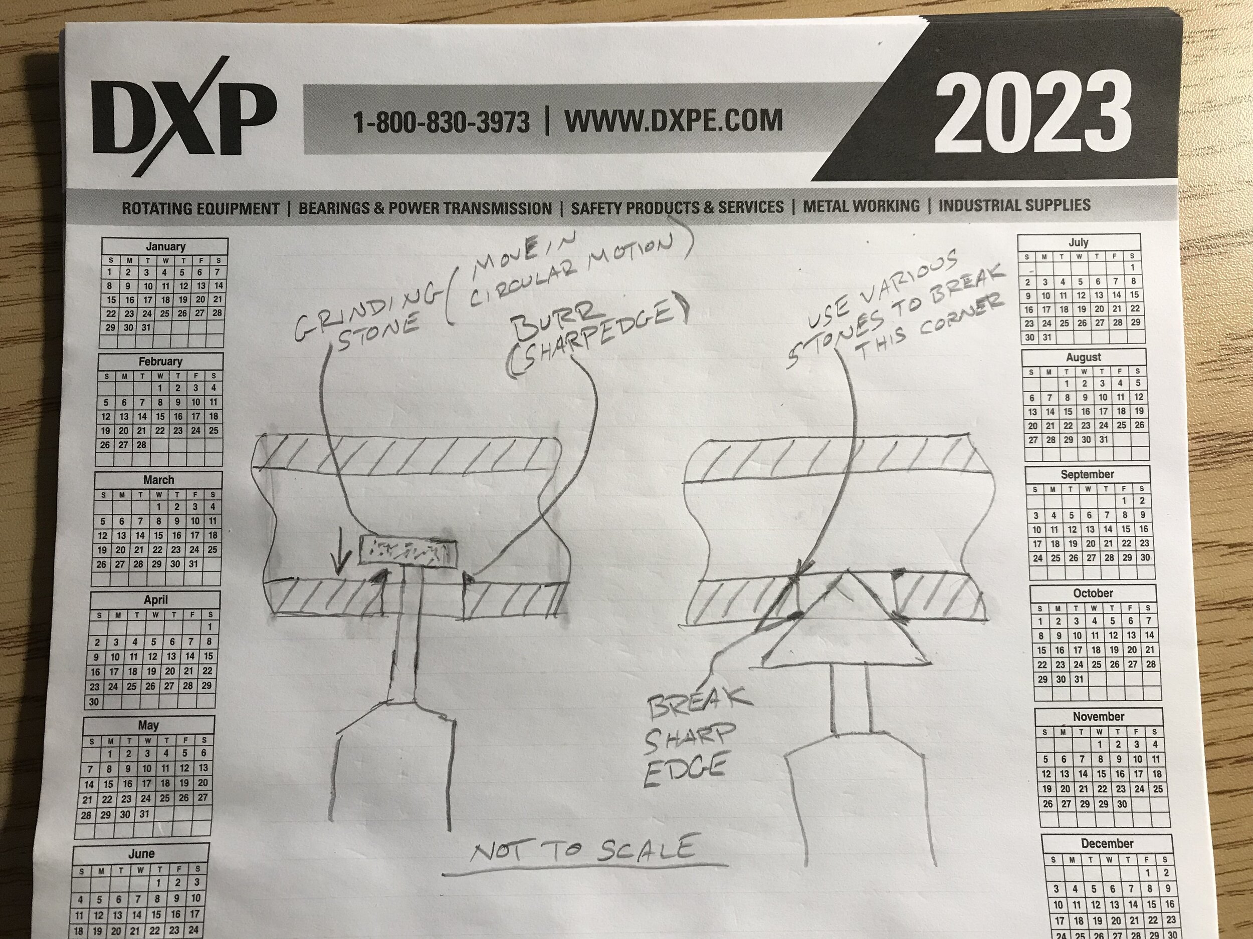

Any recs how to prep the hole edges? I have a small deburring tool that I could use. And how do I get that to work on the inside?
If your tool can hold something like this from Amazon or somewhere else they should do the job.
I drew up a quick sketch trying to show how to do it versus trying to explain it in words. Hopefully it makes sense.
Just be careful checking the edges with you fingers, I speak from experience on that :rolleyes:
https://www.amazon.com/Metal-Grinding-Stone-Rotary-Wheel/dp/B09V282ZH1/?tag=wranglerorg-20
Or: https://www.amazon.com/AFA-Tooling-Deburring-Blade-Blades/dp/B01L2XR4P2/?tag=wranglerorg-20
The manual version. Regardless of which tool(s) you use, be sure to wear good quality safety glasses. Eyeballs are not cheap.
