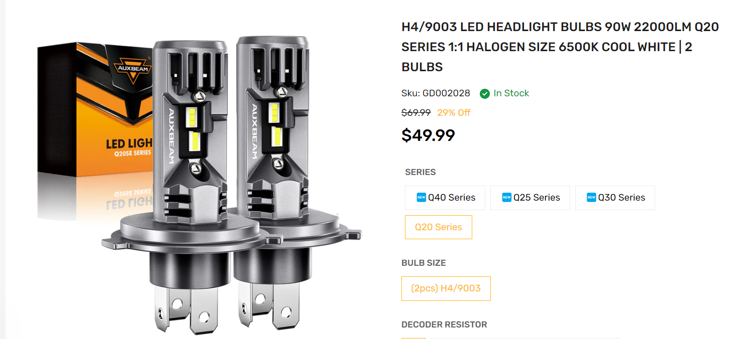

Have you looked at the Hella E codes and Auxbeam LEDs?
$98.96 on Amazon
https://www.amazon.com/Hella-Halogen-Replacement-Headlight-Standard/dp/B000FKIURK?tag=wranglerorg-20
These are a direct replacement for the H4 Halogen bulbs (plug and play), I have the Q20 series and IMO they are WELL worth the price and that is a pair not each. Auxbeam didn't charge me tax or shipping
https://auxbeam.com/products/gd0020...IcOj5c-kLZN2SQKat61AfsKL7p0p5rx6JAAoHWoIroS3s
Yea, I had a set installed. I like the LED headlights I have and they have great output, but they don't look the part. It is being picky.
$98.96 on Amazon
I've been running the Hella E codes for several years now and love them. I did the LED H4 bulb conversion last year and they're great.
