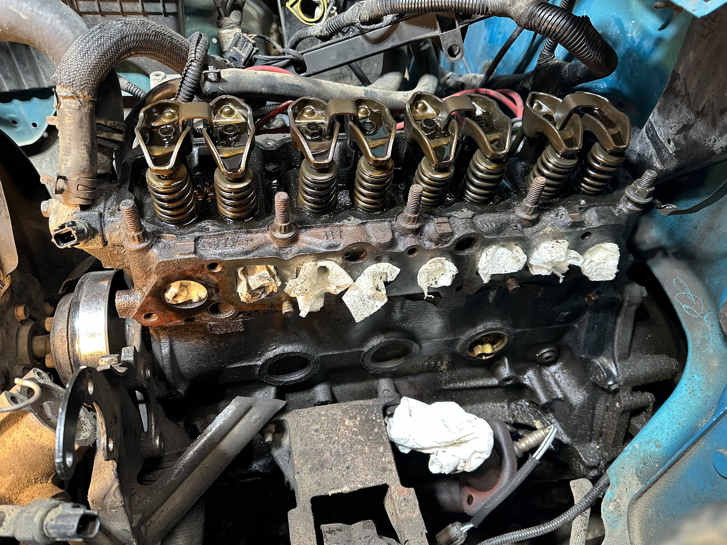

Must be exhaust manifold week. My exhaust manifold had been making noise for a couple years but wasn't too bad that it needed replacement yet. When Jade started squealing a bit, I thought it was an idler pulley and replaced both of them, since they were both worn. The squeal continued and was getting louder, so I had a friend help confirm that it was a faulty intake gasket. After a couple rounds of CRC Knock'er Loose, all the bolts easily came out. I also discovered that 2 of the bolts were missing and both of them were near the firewall on cylinder #1. When a shop had replaced the exhaust manifold and exhaust system (when my dad owned Jade), they broke the stud and just left it. Then they didn't replace the bolt on the other side for #1 exhaust. Just to make sure the exhaust system would fail sooner than later, they didn't install an exhaust manifold gasket. I'm surprised the exhaust wasn't noisier and that it took this long for the intake gasket to fail with no bolts attached the manifolds to cylinder #1. Since I had most of the top off, I am also replacing the leaky RTV on the valve cover with a Fel-Pro gasket.
I never have much luck using a bolt extractor and usually break the extractor, which is almost impossible to drill out. I tried using the Torx bit method by drilling the bolt and then pounding in a T-20 Torx bit. Having used a fair amount of CRC Knock'er Loose, it easily came out. It might require a little heat to remove the stud from the Torx bit, though.
With the intake and exhaust ports are a little gunked-up, I soaked paper towels in Sea-Foam and inserted them into the ports while cleaning around the valve cover. The intake will get a gentle cleaning, too. Anything else I should do while the intake and exhaust manifolds are off and I can easily get to the motor? Don't say to swap it out with the 4.0 in my driveway. As soon as I get this one back on the road, the 4.0 is going into my 2000 Sahara.

Finally got Jade back together and running. Amazing how much more power the ol' 2.5L has after a fresh intake/exhaust gasket that seals and a complete set of manifold bolts. I push on the gas and it actually accelerates! My Jeep doesn't that "tin can" sound like something from an old war movie, either.
It would have been a one day job but I had to wait the weekend for the local parts store to get the "in stock" parts I bought online from the other locations in town. So while waiting, I bought a 3/8" power ratchet, since every job done at home deserves a new tool! It took a couple more days for the exhaust pipe flange bolts. And then I dropped a manifold bolt down the exhaust. The shop towel covering the exhaust had moved out of the zone, leaving it wide open for the bolt to slam-dunk it down the pipe. It was near the cat, so I couldn't fish it out by dropping a magnet down the pipe. How to remove a dropped bolt inside an exhaust pipe: I used a large magnet against the exterior of the exhaust pipe to "grab" the bolt. By giving the pipe an occasional shake, I knew the bolt was being magnetically gripped as it was dragged along the pipe. I was able to move the bolt to the first bend of the exhaust, where I could drop a magnet down the pipe and pulled it out. (Yes, I wrote this for the future "me" since I will undoubtedly do this again:-)

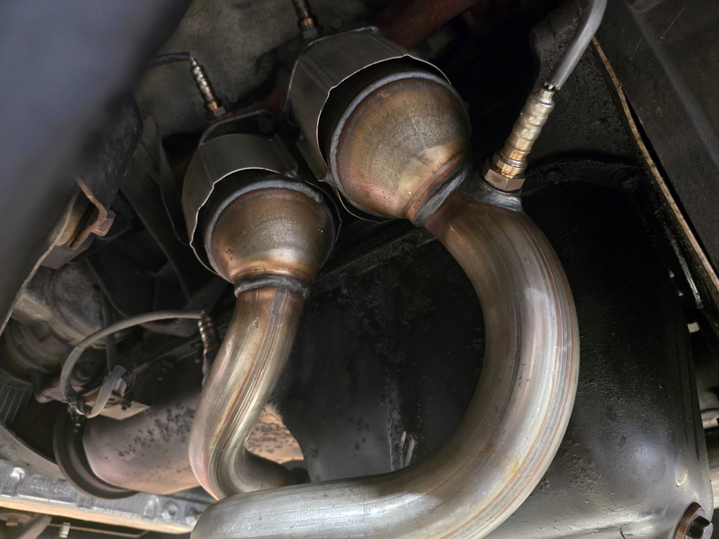

How close are the heat shields on the pre-cats to the oil pan?
Any shots from underneath looking up at the shields and edge of the pan would be greatly appreciated if you have them.
For example, are they more like photo #1 or #2?

I cut my exhaust after the pre-cat's join so I don't have the stock piping to help me align things...just want to do it correct before it gets welded to the turbo piping. Thanks, again.

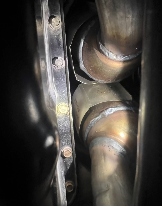

When I get home from church and get back to the shop, I'll snap a picture for you.

It won’t sound like a tractor unless it’s way off (causing a significant leak), but you’d get a B1/2 sensor 2 code for a slight leak (had a P0431 after I bent the flange).
Your setup is easily adjustable, so no need to sweat it.
