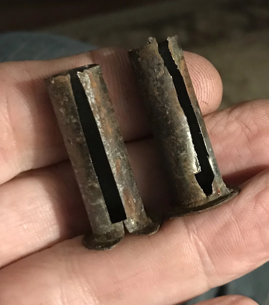

Had to use a 2x4 to get the doors off. Guess they hadn’t been off since 2002 when they were put on. I tried driving the old bushings out with the ‘tool’ that was supplied with no luck, in fact I slightly moved my driver side lower hinge by whacking it so I removed the hinge and took it to my shop. I eventually used a small 1/8 in cutter tool in my dremel flexshaft and cut a slot through the thin insert from the bottom of the hinge. Just ran it in and out in the same spot for a few minutes. I used a pointed tool to get between it and the actual hinge and pop it out then. Just needed some place for the rusty steel to go. I didn’t remove the hinges from the truck on the others. Just cut the groove while they were still on the Tj and then popped them out. There is a seam in them, the left one was cut in the seam. Clean up the inside of the steel hinges and door pins good before you insert the delron inserts and don’t forget oil. Hope this helps.
Try though IO may I could not get my OE bushings out. I am going to try your method with the hinges removed. Thanks for the post.

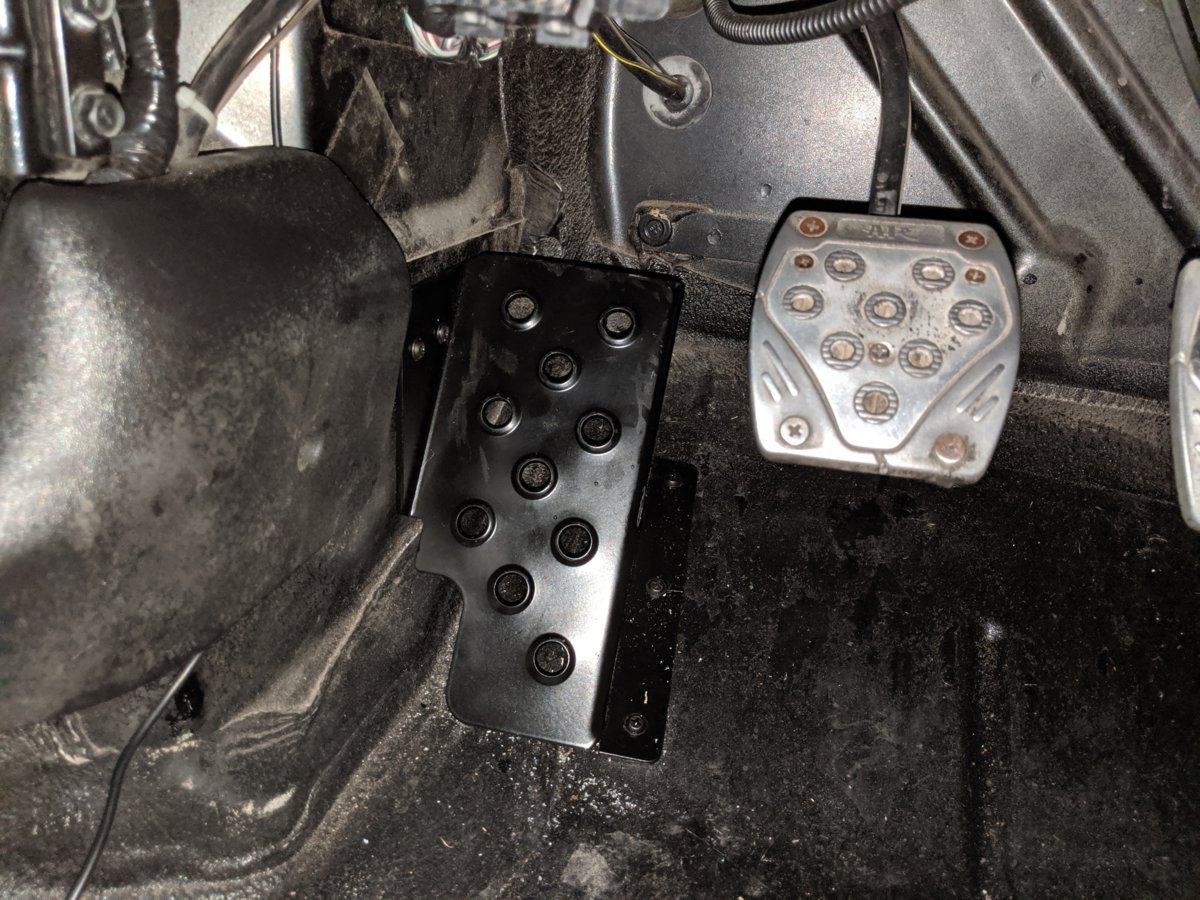

Installed a dead pedal yesterday. Haven't driven it since, but so far it definitely helps getting in the Jeep. Now I don't have to put all my weight on my elbow on the center console to adjust myself. Totally worth it. My center console doesn't seem too sturdy.
Wait, is that a break or clutch pedal? I need a dead pedal but they say, not with a clutch. I don't see why not!

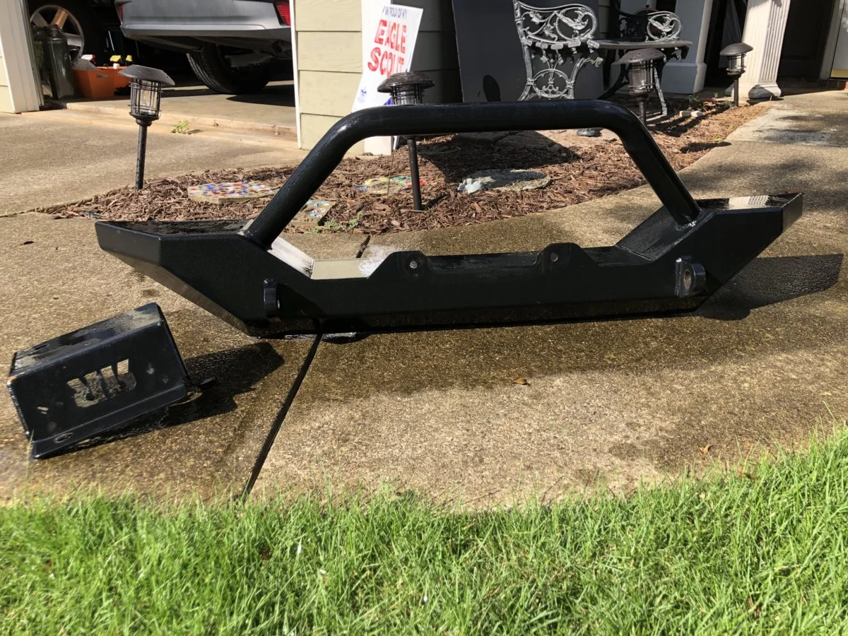

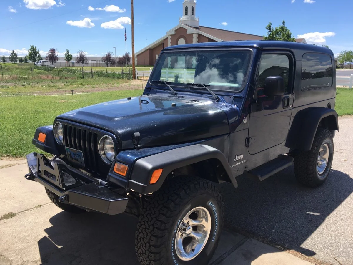

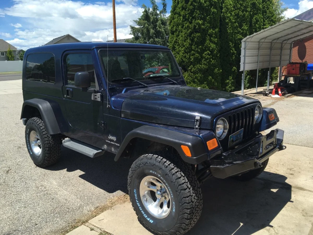

I go the new fender flares installed, rattle canned the front bumper black, aligned the front axle from side to side, leveled the steering wheel, lowered the rear axle pinion down by a half degree. It seems to drive good except for the death wobble. I still need to install the new radiator shroud and radiator, the shroud is cracked and the radiator is seeping. Need to order new belts, idler pulleys, change the oil and check the levels. By the time I get some of this done, I will be putting in the new dana 44's and outboarding the shocks.

That's a clutch. It fit no problem. I haven't driven it yet, but I backed it in and out of the garage a few times, it's def not in the way.

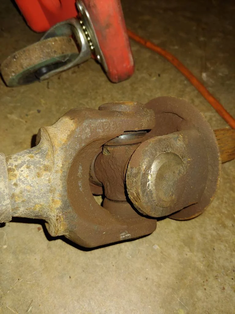

Replaced both of the hubs. In doing so I found the u-joint on the driver side in this condition. The passenger side is old (probably original, like this one, 158K miles), but is still functioning. Was going to change it, but while assembling the driver side I screwed up the new u-joint meant for that side, smh. I'll take care of it soon, but had to get it on the road today.
