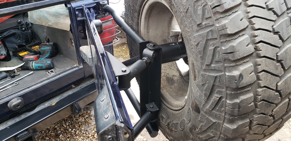

Finished the Bestop rear bumper and Bestop rear tire carrier install. Went pretty well, think I want some frame tie-ins though, as will be using for recovery and for towing a small utility trailer.

Also, had an issue with the rear seat belt. When I unbolted it to attach the Bestop support bracket to the roll bar, it went up, but nothing I could do would make it come down! So I unbolted it completely, then held it over a bucket and sprayed a bunch of brake cleaner into the the little hole in the mechanism shown below. I finished it off by spraying a bit of silicon spray lube in there. It works great now!
On another weird note, the new rear bumper's receiver hole is too small to fit the hitch's pin, but just barely. I could almost pound it in with a hammer. Guess I need to buy a new one?
Love the single action carrier.
I’ve heard that hitch pin is a known issue. I think it’s because it’s not supposed to be used as a hitch, just recovery
1. I was thinking the same thing about a frame tie in. I’d like to know what you go with as I’d be interested as well
2. I had the same seatbelt issue! It went up and wouldn’t come back down so I spent a good hour taking it apart when all I had to really do was hold it flat so the little marble inside stays in a position to release the seatbelt🤦🏻‍♂️ Oh well, impromptu seatbelt mechanics 101 session
3. I used a hitch carrier last weekend to carry my tires to the shop and my pin didn’t fit either. Luckily I had a bolt from the hitch stabilizer I was able to use but it was a bit annoying.
I bought the Poison Spyder ones off of Amazon, the price was right. Only con (if you see it as a con) is that they need to be painted before install. It said 14 left in stock a couple days ago when I ordered but now it says only two left, so you might want to jump on it if you're set on them.
I actually googled it too when my seat belt wouldn't come down, and I thought I was being dumb too with not holding it level, but turn out mine was too gunked up anyways.
Other people have said that it's the powder coat that causes the pin not to fit, which I can definetly see as I could almost get mine in with a hammer. I have no doubt that a bit of sand paper wrapped around a pencil will get rid of the issue.
