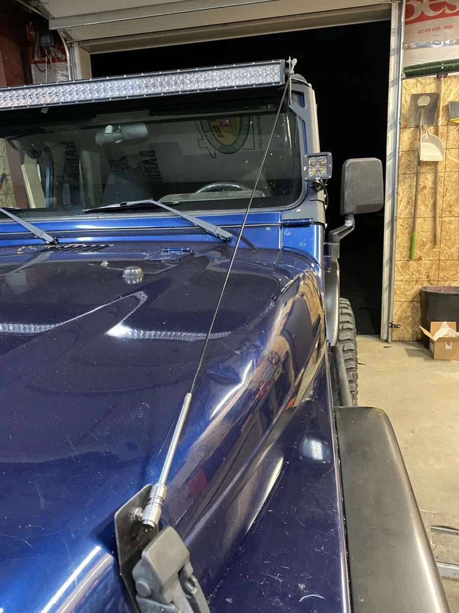

DIY limb risers. Cut the brackets, used watercraft steering quick release cable ends w/ball studs and had the local hardware store crimp some extra long threaded studs to coated cable, cut off the old threads and threaded to metric. Now I can take them on and off quickly if I don’t want them on non woods days.

Thanks for the close up! Gave me some ideas. I also like your thinking on the quick disconnect. I wouldn't want to run them for daily driving either. Just when we plan to go to the trails. The last trail I did had a lot of overgrowth and my windshield did most of the clearing. LOL

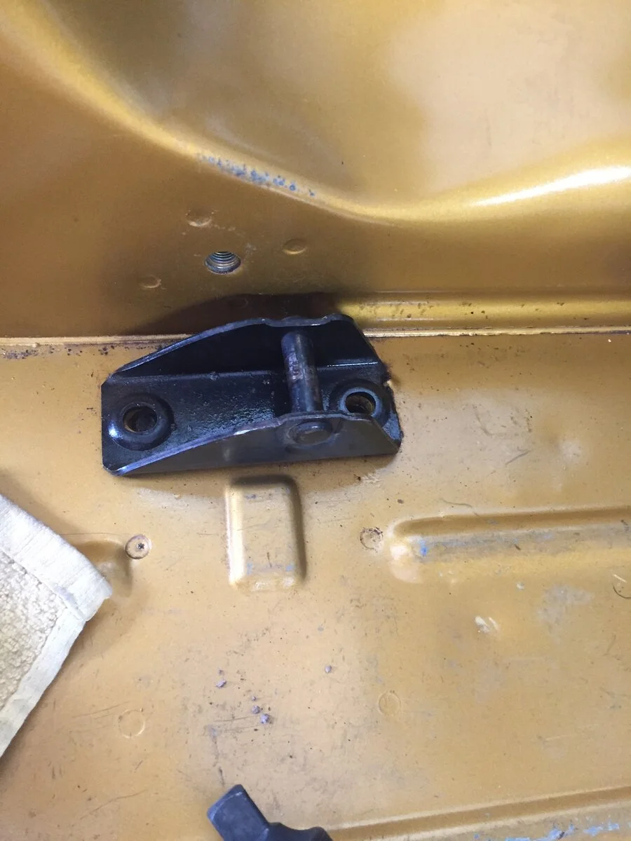

Now to your question, it's really hard to tell from the straight on pic but it looks like the sway bar is going to hit the disconnect pin on the frame when your axle drops, that would be my only real concern from this angle.
I tried to take some pics from the front. One I am holding a tent stake of some sort to try to show that is just barely clears. The adjustment the links are at now, I can only move those pins up or down. Either way, they would still be close to the sway bar.

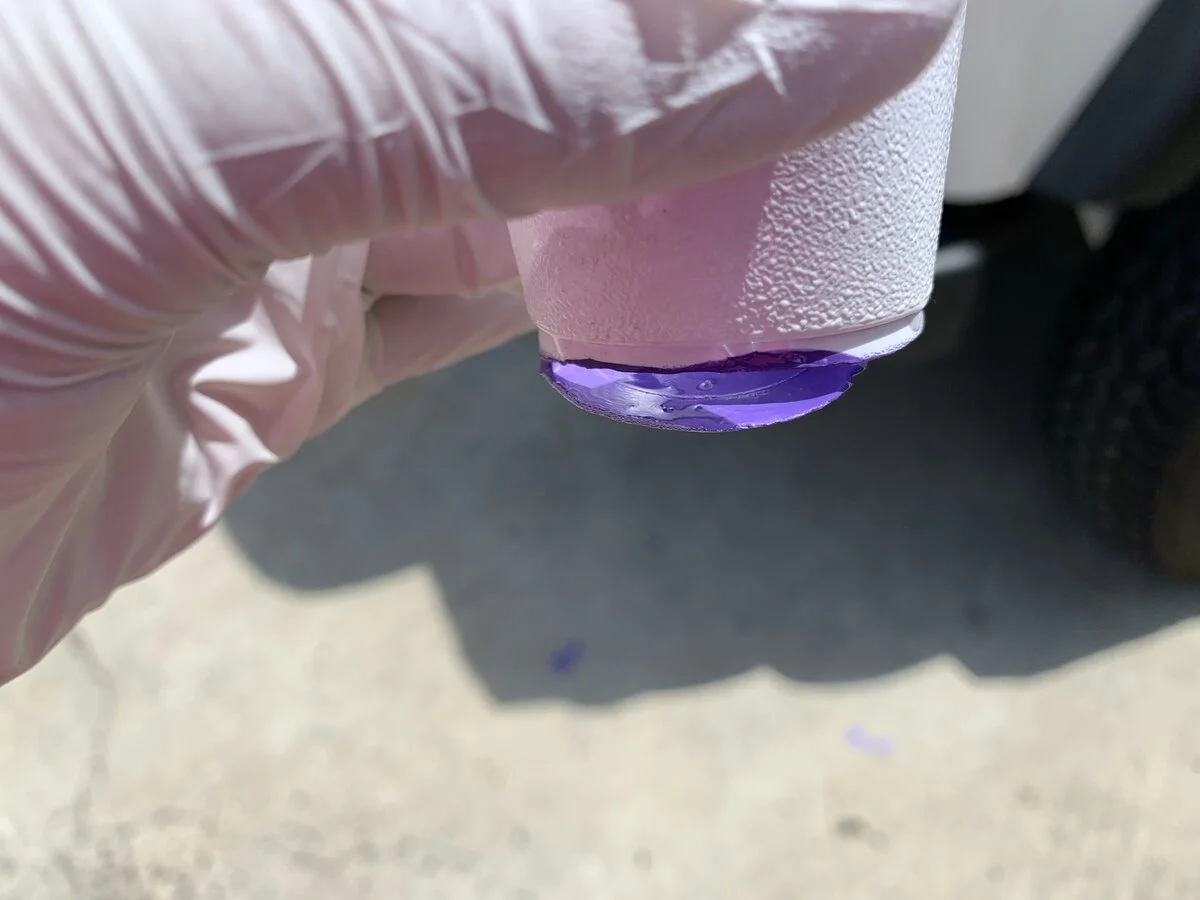

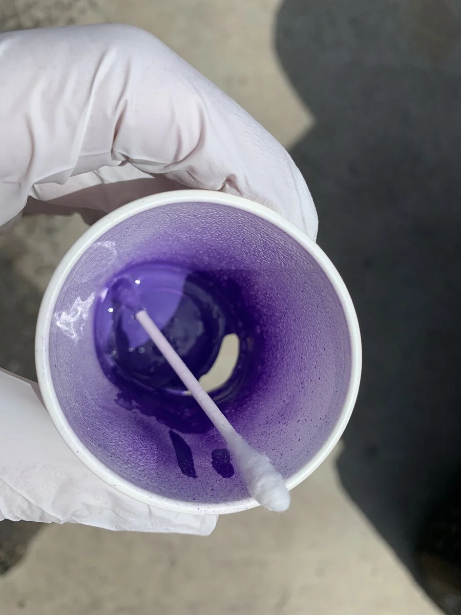

As far as what did I do today, I went around and touched up any rock chips and such in my purple paint. To do that, I spray paint into a bathroom cup and use a Qtip to brush or dab the paint. Well today I learned you can't use plastic bathroom cups. LOL Going to have to buy some more paper cups. :D
See the purple drops on the concrete? LOL

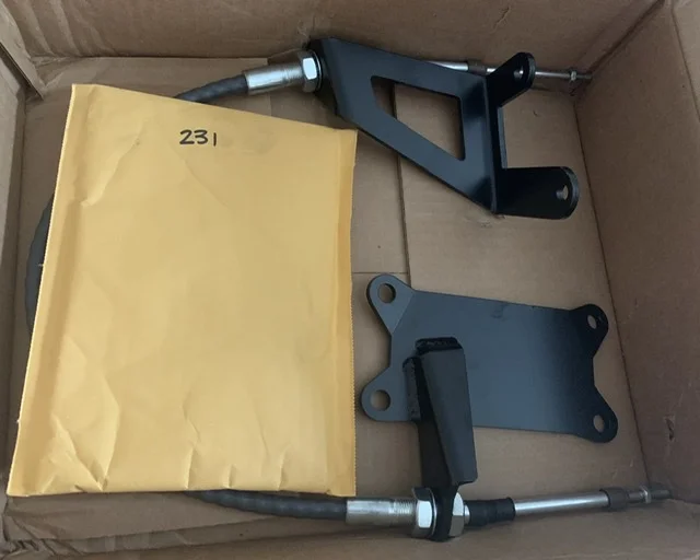

Savvy shifter came in today. Boxes are really starting to pile up and I can’t quite get the consecutive days I need to get everything knocked out in one sitting. So far the shifter, sye, driveshaft, new skid, diff cover, and a few other odds and ends are all standing by. But man will I be relieved and ready for a ride when it’s all said and done!

You'd be the best judge if they'll clear or not. it does look close in thee pics but with the sway bar attached to the axle I doubt you're going to articulate or have enough axle droop to hit the pins. (y) (y)

EDIT: if you still have your stock sway bar links, measure them and add 2" or whatever your lift is. That is where your QD's should ride (minus the new bracket).
Yah, I looked up the instructions for the links and it shows a pic of the sway bar being level, then up 10 degrees. So I went out and extended the links up a bit. I also removed the pins for now and will redrill the holes for them another day. They should be out of the way once they are in their new positions. Should make them more in the bigger curve area of the sway bar. :D
