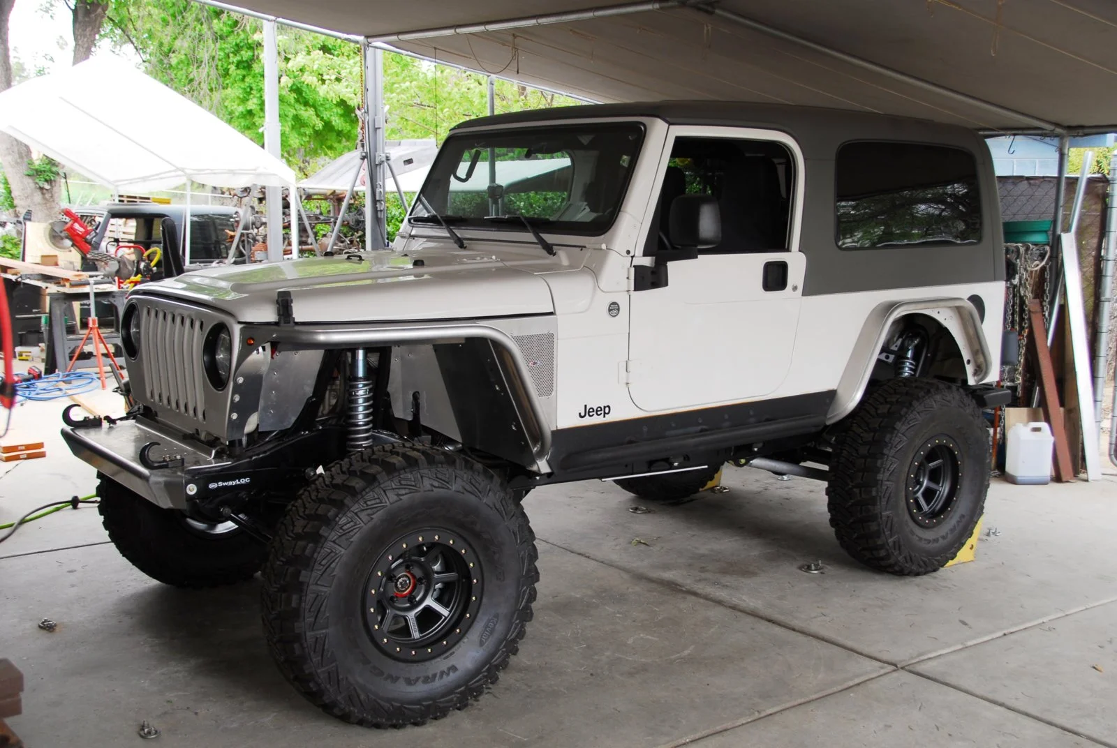

Yes these. What is the advantage of going this route? I've only seen them on high budget builds. Other than getting to easily adjust ride height, why are they used?
Adding or subtracting nitrogen in one of the Schrader valves changes compression and rebound, adding to the other valve changes height. Makes tuning on the trail easy, small package, internal bumpstop, hydraulic and nitrogen combo, apparently they don’t need a sway bar (doubt it)
Ok. They seem to make more sense than a coilover. No need to try a handful of different weight springs or a dozen various shock valvings.
Whole lot more than just the air shock I thought they were. Thanks for the info.
