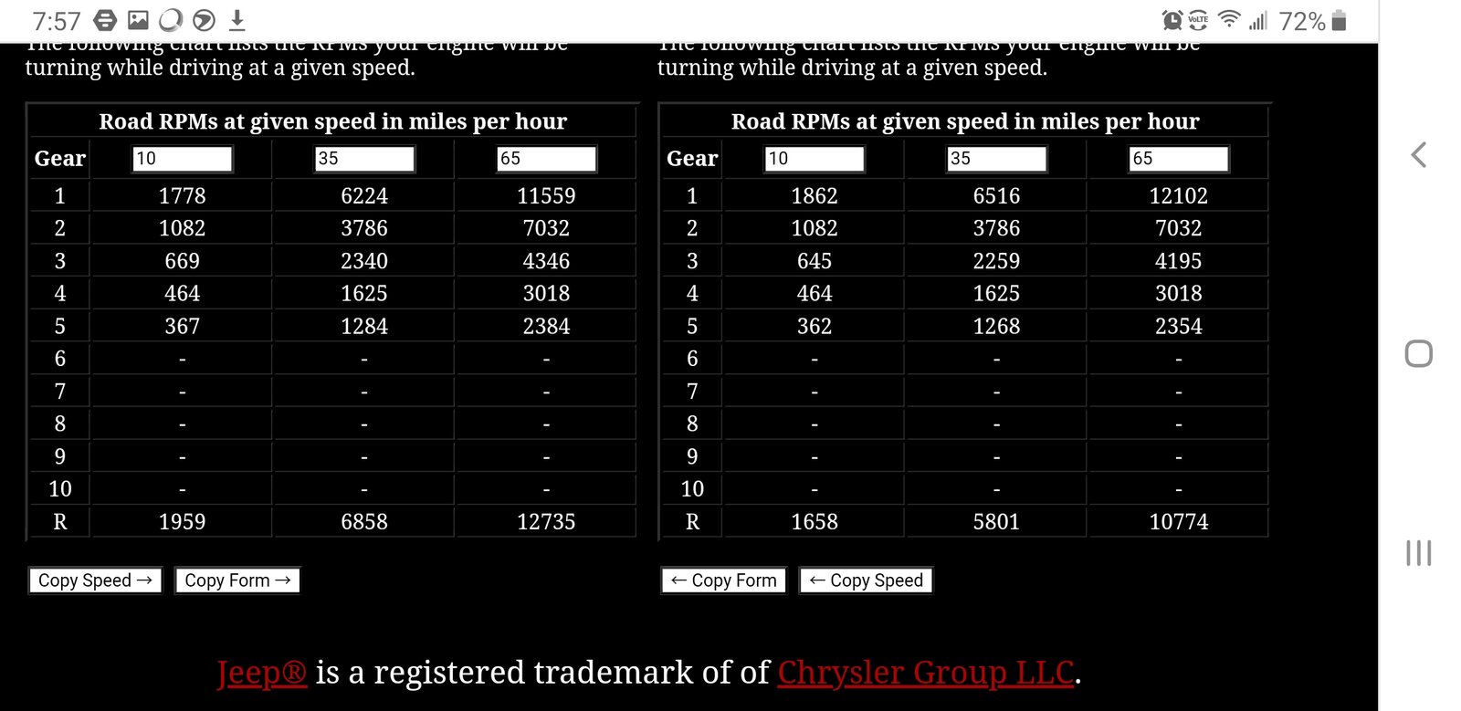

Unlike most of the individuals who have posted on this thread my highway driving never exceeds 50MPH and most of the on-road driving is at 35MPH
@Oldguy how long have you been running your 4.88 setup? Where conditions allow, has 1st gear hi-range been adequate for cruising most trails at a comfortable pace? Secondly, forestry roads while driving uphill. I have a handful of roads around my area where 25-30mph is a comfortable speed for the hill but that means close to 3000 rpm in 2nd, whereas 3rd I'd be around 2000rpm but too much tire and not enough motor doesn't make that an option😅
Sorry for the novel here but I'd appreciate your experience and input before dropping cash on the project.

I’d go 5.13. The 2.5 needs all the help it can get. 4.88 doesn’t really even get you back to stock 4.10/27’s. 5.13 makes up for it and gives a bit more pep than stock.

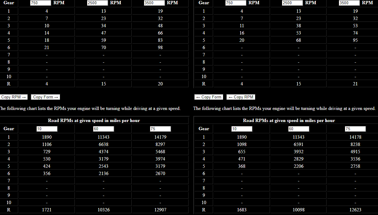

Having read a lot here the recommendation seems to be 3k RPM @75 MPH. A lot of the info for gearing manuals is regarding the 5 speed. My TJ has a .84 overdrive NSG370 close ratio 6 SPEED, 4.0 and 33" tires. So are the recommended gear/rpm combinations in gear 5 @ 1:1, or Gear #6 @.84:1? Currently running a 3.07. One formula 33/30*3.07 = 3.37. So if factory was 30inch tires and I went to 33, that is 110% larger so 3.37 would be the actual ratio required to restore the rpm/gear to factory design? That does not seem right. I must be missing something.

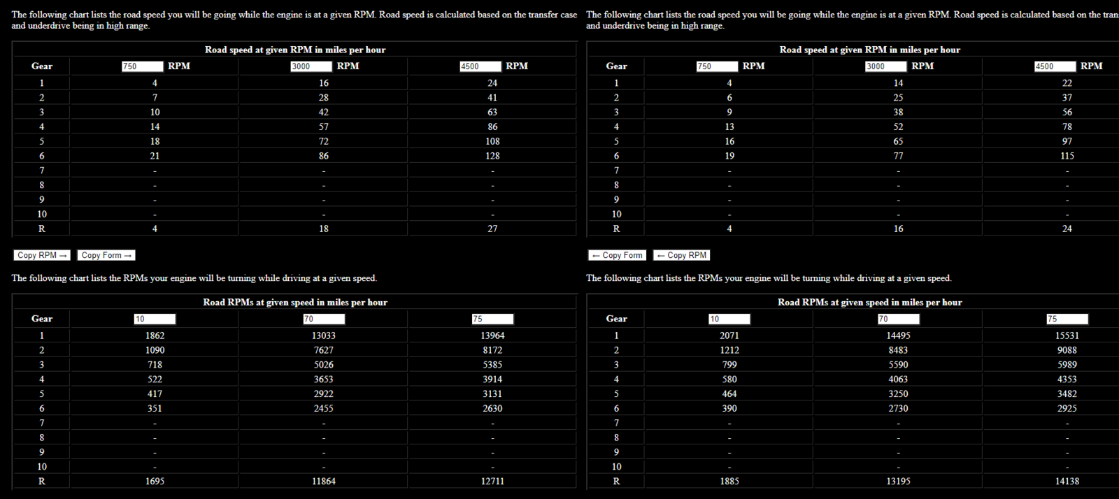

Trying to decide on using 4:10 (LEFT) or 4:56 (RIGHT) I used 33" for my tire size in reaper, which I am now aware might actually be slightly smaller.
I don't crawl. Looking for best drivability and economy IE: A daily driver. Thanks for any and all advice!

You are over-complicating it. Regardless of the transmission, look at the final drive gear- the last gear you can shift into. That is your highway gear. Anything else up to that, you will naturally adapt to.
Also, in all these gear ratio threads you should have noticed that your tire size for the purposes of the calculators is your center hub height x2. It isn't 33 inches.

Personally, I would run a 4.56 in your case. It would be comparable in performance to a factory 6-speed Rubicon on factory 31s.
4.56 will also provide you a bit of headroom in case you ever go to larger tires (though 4.88 would be preferred for 35s, 4.56 would still be perfectly driveable.)
4.30 could be an option, but you can only do that particular ratio with Dana 44 axles in front and rear.
4.10 would certainly be tolerable, maybe not perfect, but with 5th gear being so close to 6th, you would just need to downshift a bit more often.
To give you an actual test of what 4.56 will feel like, here’s something you can try (assuming you already have your 33” tires installed):
5th gear on 3.07s is almost exactly equivalent to 6th gear on 3.73s given the same tire size. So if you drive around pretending you only have a 5-speed, that is what 3.73 will feel like.
4th gear on 3.07s is almost exactly equivalent to 6th gear on 4.56s. So if driving around and on the freeway and 4th gear seems like a decent gear to use in the highway, 4.56 gears will work very well.
Unfortunately there is no similar test for 4.10, but it will be close in performance to the 5th gear / 3.73 test.
Steel, thank you for your reply. Please consider this:
I compare the 6 speed NSG370 with 4.10 to commonly used 5 Speed NV3550 with 4.56. I think the lower gear ratios in the 6 speed help the 4.10 behave like a 4.56. I notice the first 2 gears identical for rpm/speed. Top gear rpm/speed is almost the same too. So it looks to me, like the 6 speed with 4.10 is virtually identical to the 5 speed with 4.56 that is generally recommended. It also looks like 1st gear will be very short if I use 4.56 with the 6 speed. I am now leaning heavily toward the 4.10, wouldn't you agree?
6spd/4.10 -> 5spd/4.56
Realistically, you could be happy with either 4.10 or 4.56. Many of the 6-speed users who go to 35s use 4.88 gears, which seem to work quite well with that tire size. One common target for manual TJ owners is to run about 3,000 RPM around 75, which seems to net the most torque without any significant impacts on fuel economy.
Consider that a TJ Rubicon came with 4.10s and tires 2" or so smaller than yours, even with the NSG370. Those RPMs are perfect fine to run for an extended period; in some cases (like the 6-speed Rubicon and in the 3 speed autos) they did that from the factory.
