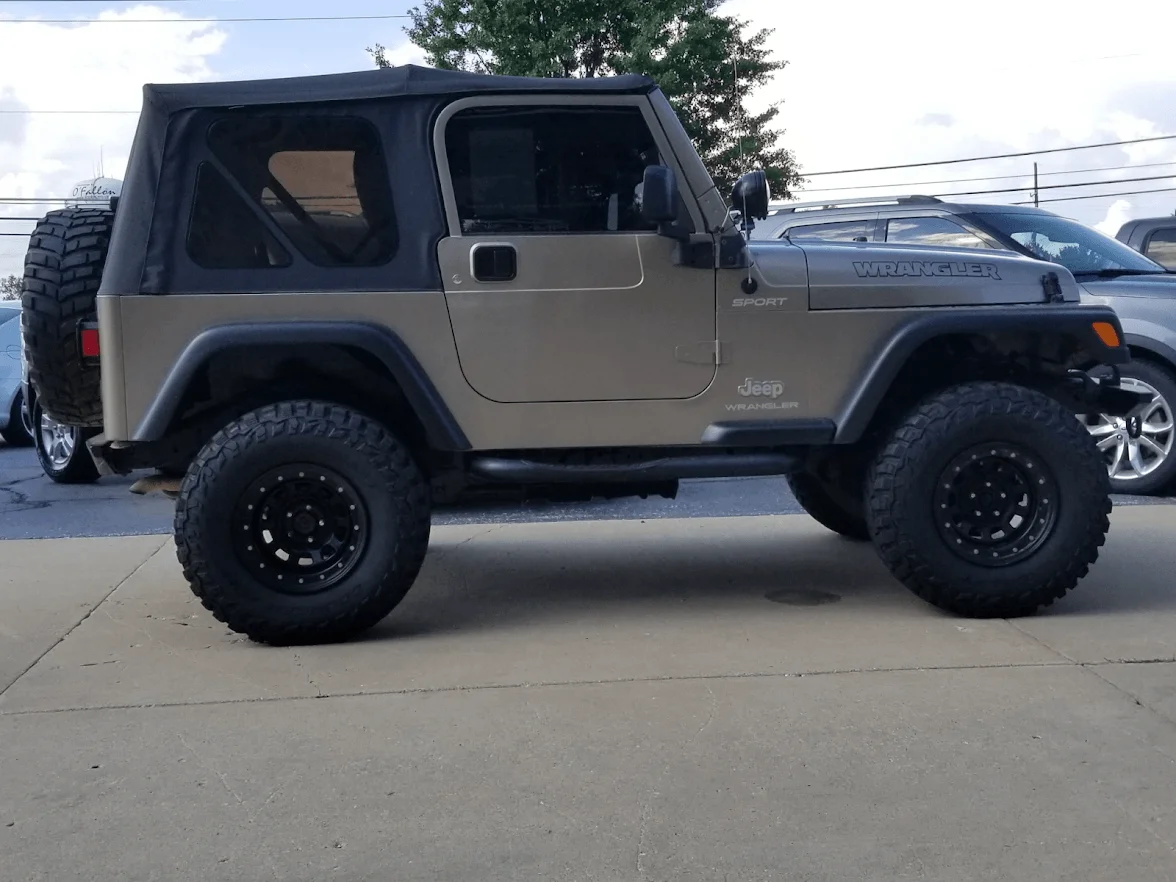

Your suspension lift makes no difference to the jack since it lifts from the axle, not from the frame. The OE factory jack works fine for tires up to 35" and even 37" in a pinch.
This is my TJ with 35" tires using the OE factory jack to lift its tire up several inches off the floor. Not that it matters here but my TJ has a 4" suspension lift plus a 1" body lift.
