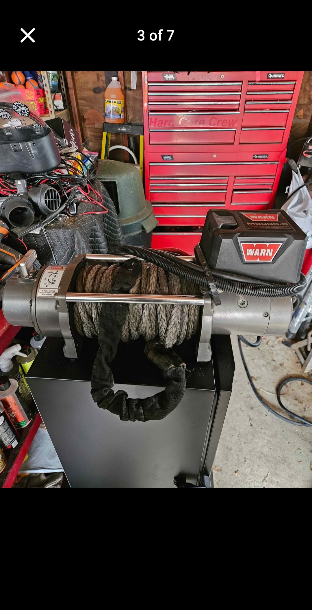

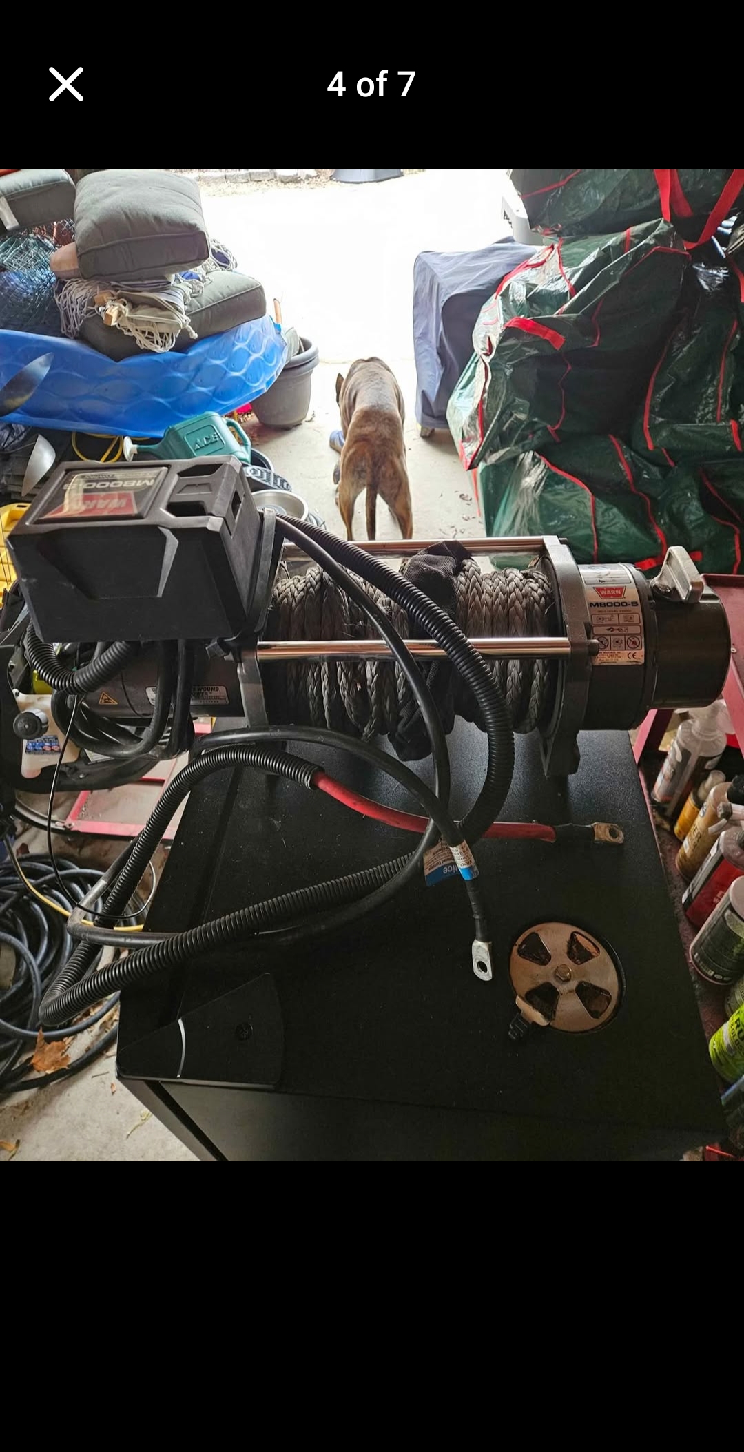

Sorry to post in an old thread but I'm looking at a used Warn m8000 and didn't know if this is worth checking out.
From the description: "I have a warn m8000-s winch synthetic rope like new been on vehicle never used comes with a corded handle and a wireless programmable controller"
Seems legit but has been posted for a few weeks which always scares me.

View attachment 603045View attachment 603046
It looks OK.... If the price is right then I'd go look at it.

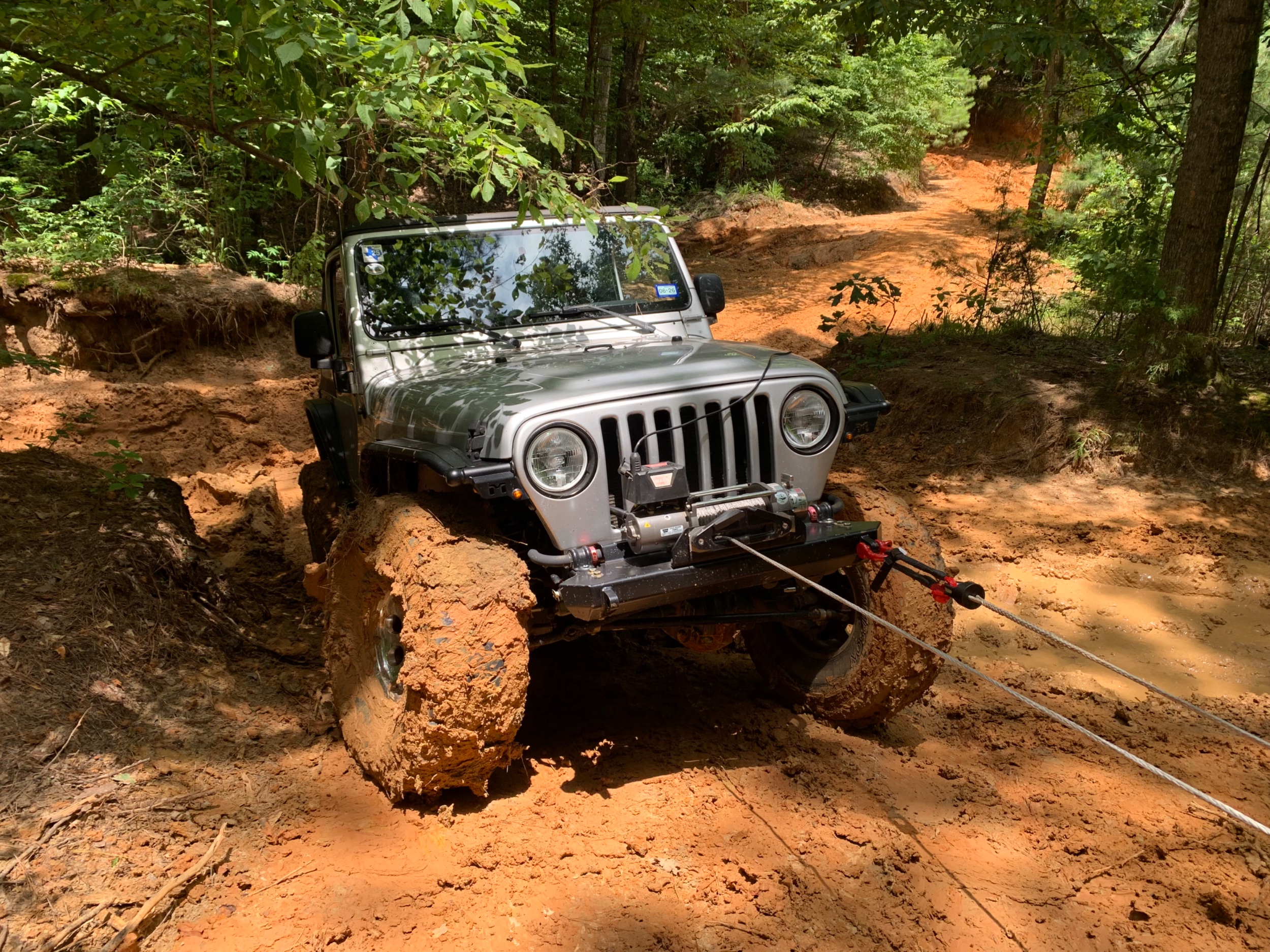

When I started looking for a Jeep a few months ago, I had it my head that I wanted the overkill of a Zeon 12000 pound winch. When I found the Jeep I purchased, it had a virtually new M8000 steel cable winch converted to synthetic. I was ready to sell it in favor of a Zeon until I read Chris’ glowing endorsement. I decided to leave it in place and give it a chance. After all it does meet my twice GVWR formula and it is a Warn product.

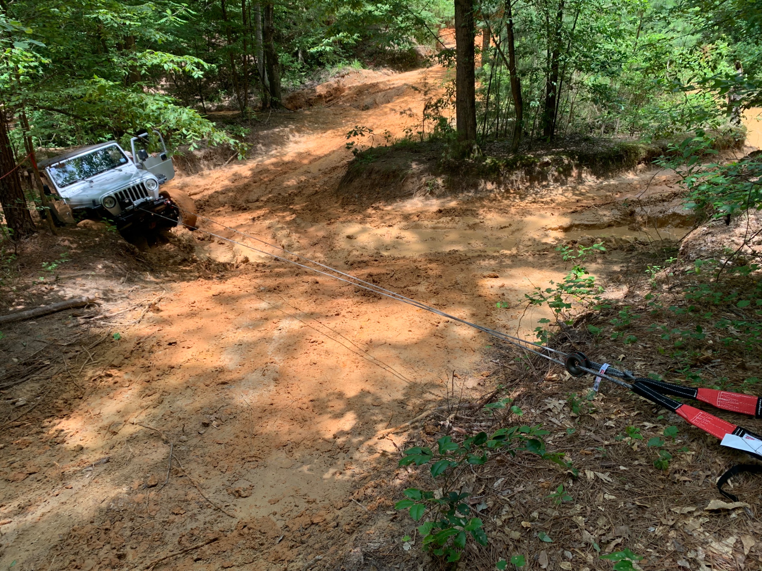

Today, I got mired to the rear axle in one of those suction cup kind of bogs. Lockers on both ends and 35 Mickey Bajas didn’t get it out of the thick glue. A tree had been kindly placed by God in the exact location I needed. We used a soft shackle snatch ring for a double line pull, which sort of indicated my lack of confidence.
The front axle wasn’t as deep as the rear and when I started winching I noticed that the left front wheel wasn’t turning, but the vehicle was moving fine. I stopped immediately and realized I had left it in gear by mistake. It was dragging the Jeep on the non turning wheels!😳. Hope that mistake didn’t cause damage to be discovered later.
Anyway, I just want to admit my lack of confidence was unwarranted. This winch is, as Chris claimed, the correct winch for a Jeep and Peppergat did a very solid installation, both mechanically and electrically.

Does the dog come with the winch?
