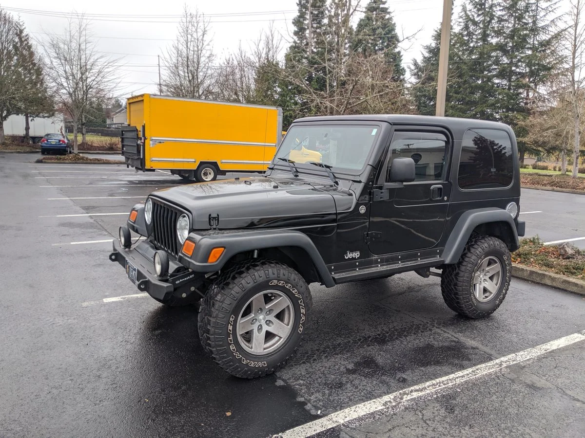

Hey @psrivats , replacing my wheels with your exact set-up. Do you have a side shot of your rig somewhere I can have a look-see?
This is the best I have. But note that it's parked on a bit of a slope.
I'll say though, don't go by looks, set the rig up so that you have the proper clearances for the tire size you choose.
