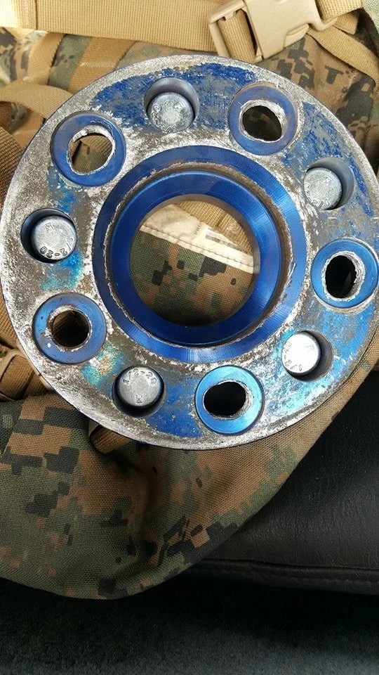

I have had Spidertrax spacers on more than one Jeep, never had one issue. Every time I would check the torque settings on the mounting nuts used for the spacers, they had never changed. What I cannot figure out is how on God's green earth did this happen to these wheel spacers? They look like they were run down the road with NO lug nuts on them at all, or maybe with lug nuts on, but just hand tight:
I don't see how that Jeep could have gone down the road in a straight line.
Reactions: Kyle_W
Hmmmm, looks like the lug nuts were loose to me. If they were correct, just the clamping force should have held them tight and in position.
