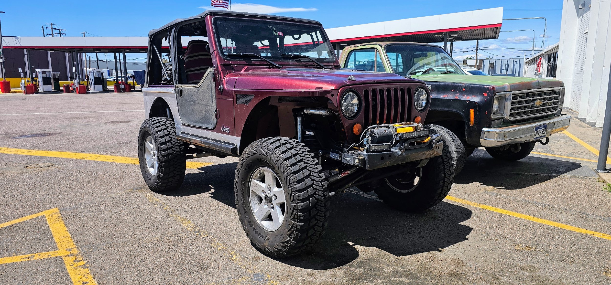

My own experience has been that the only negative of wheel spacers is the added work of removal and re-installation for any maintenance, such as brakes, hub bearings and u-joints.
Good to know. I had some brake work done in a shop when I bought this Jeep in September (replaced front disc pads and rotors and flushed brake fluid, DOT4). They never mentioned anything about taking the spacers off, but I'm not sure if they would have said anything. I haven't pulled the spacers off myself yet, but it doesn't look too bad as long as they are not frozen on.
What you mean is that in your experience you have not noticed any negatives. There are definite and well known negatives to spacers which alter stock offset / backspacing. Increased wear on ball joints (including early failure), steering impact including wandering on uneven road surfaces, and braking issues. Just because you have not noticed does not mean they are not there.

If you had a shop work on it unless they knew how to properly mount the spacers I think I'd pull them back off and reinstall per the instructions.
Edit: Granted if you were going to have issues you should have already. Peace of Mind would be why I'd do it.
What you mean is that in your experience you have not noticed any negatives. There are definite and well known negatives to spacers which alter stock offset / backspacing. Increased ware on ball joints (including early failure), steering impact including wandering on uneven road surfaces, and braking issues. Just because you have not noticed does not mean they are not there.
The negatives are identical to a set of wheels with the same low backspacing without spacers.
None of that is any different than a different wheel with the same backspacing without a spacer.
These are JK wheels with 6" backspacing. However, as installed on mine they are like any other 4" backspaced wheel of the same width.
That's why I thought providing the Moab wheel specifications might have some relevance. The positive/inward 0.5" offset of my 16X8 Moab wheels (with 5" backspacing) plus the 1.25" negative/outward "offset" of my spacers (if it's OK to use that term for spacers) gives me an effective 0.75" negative/outward offset. The point being that the 0.75" offset should be less stressful on components than if you're just considering the 1.25" wheel spacers (1.25 to 0.75 is a 40% reduction in offset per wheel/hub, if it's helpful at all to think about it that way).
I have an extra set of 5 18X7.5" JK 5X5 wheels right now that look like yours. The offset on mine is +44.45mm (+1.75"). I had bought this as an extra set because I I got a good deal and thought at one point that I might replace my 1.25" spacers with a 5X5 adapter (probably with the same 1.25" spacers). But I decided to keep the Moab wheels instead. I still have the JK wheels but I'm trying to re-sell them now (they're just taking up space in a shed). If I had used these, I would have ended up with a "combined" positive/inward offset of 0.5" (1.75 - 1.25)... interestingly, this is the same offset as the TJ Moab wheels, without the spacers.

I appreciate the responses here that had to do with wheel spacers and my particular situation. I think I have enough information now to weigh the pros and cons of keeping them on or removing them. I think I'm going to leave everything as-is for now, but eventually pull the spacers to inspect them more carefully... something to add to my list of about 200 other things I need to do eventually!
Would it be crazy to back off a nut on the spacer and look for the blue lock tight. If it’s on one, it’s probably on the other 19.
That’s true and you wouldn’t. I was just thinking it might give you some piece of mind until you have the time to pull them all.
Do one nut, do the other four. Do one wheel, do the other three.
We are past the point of this getting silly. Checking the spacer nuts is not a big job, if one is actually concerned about it.
When it comes to spacers/adapters, you either do it right or roll the dice. The problem with the latter is other, innocent, people could get hurt.
