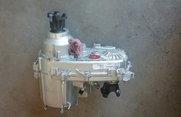

I have a transfer case lowering kit . its a little over one inch bar on each side. I do not have any vibs from what i can tell 4" lift 33" tires
Ready to stab back in.
hey yall. i called JB conversions today and talked to them a little and he told me the standard HD SYE should be jsut fine up to 4" of lift. Then I told him i may be installing a ford 8.8 sometimes in the future and he said it was a lower pinion than the dana 35 which would make the angle more and i might be better off buying a super short sye. that may be a sales pitch , not sure. just thought i would toss it out for yall to hear.
