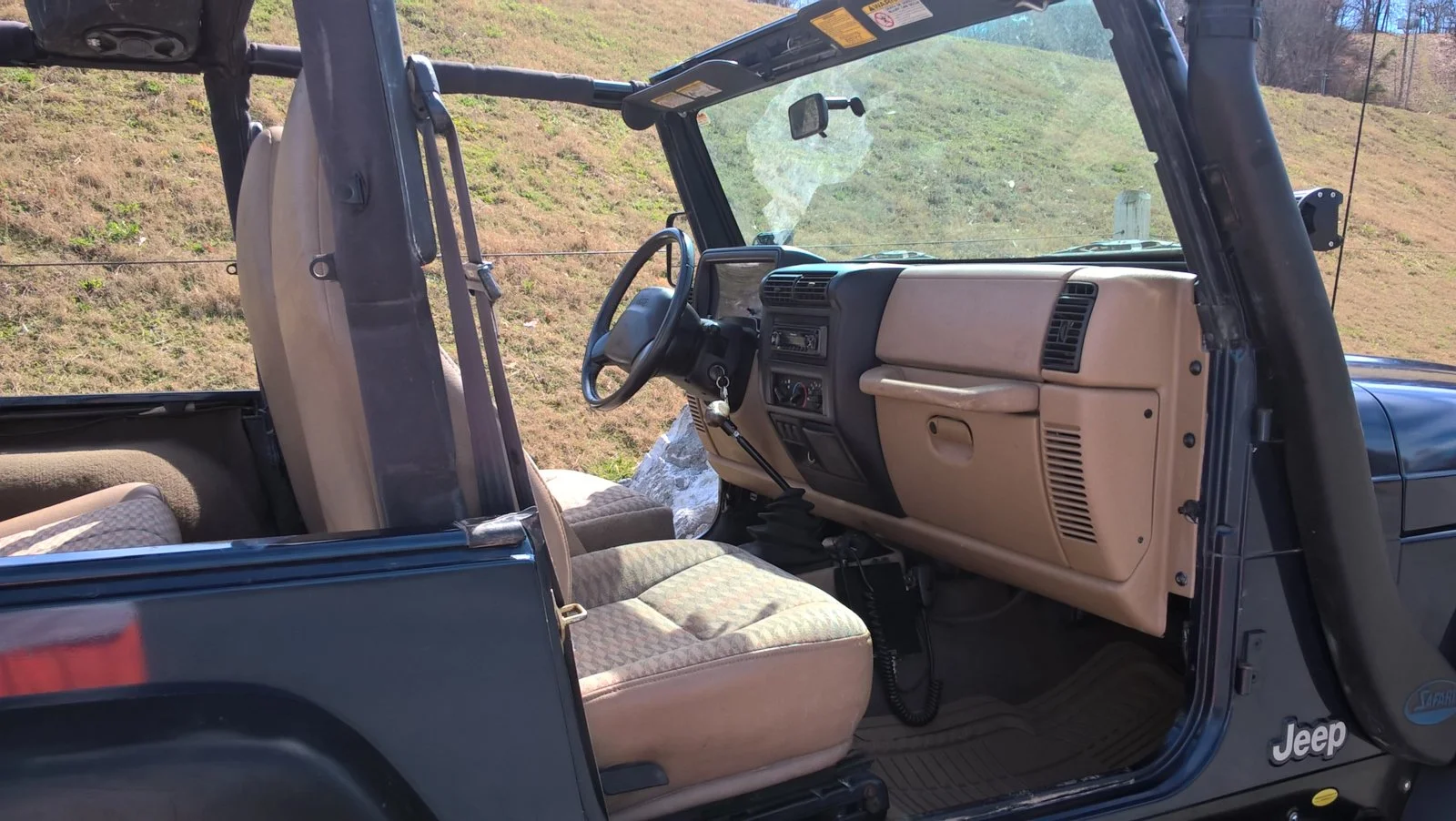

I had an ARB Safari snorkel on my previous TJ and I could not remove the upper door without removing the mounting bolts and pivot the snorkel out of the way. Super frustrating since I remove and install my doors often!
86138
86139

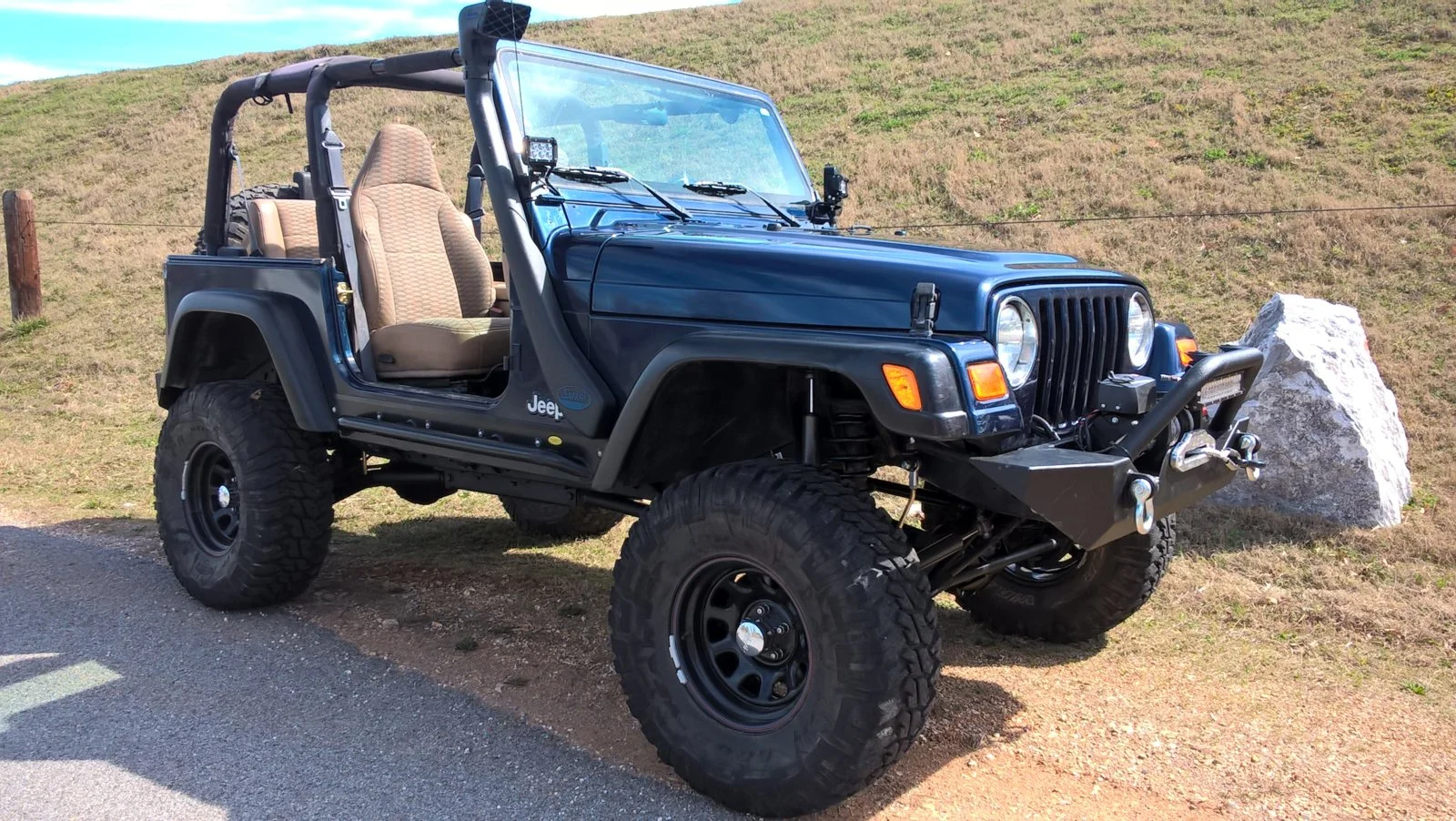

Whan I bought my Jeep 2 1/2 years ago, a snorkle was something I thought I would like. I think they look kool. As it turned out, I haven't seen a snorkle kit that I like enough to spend the money.
My next mod, anyone else?
86144

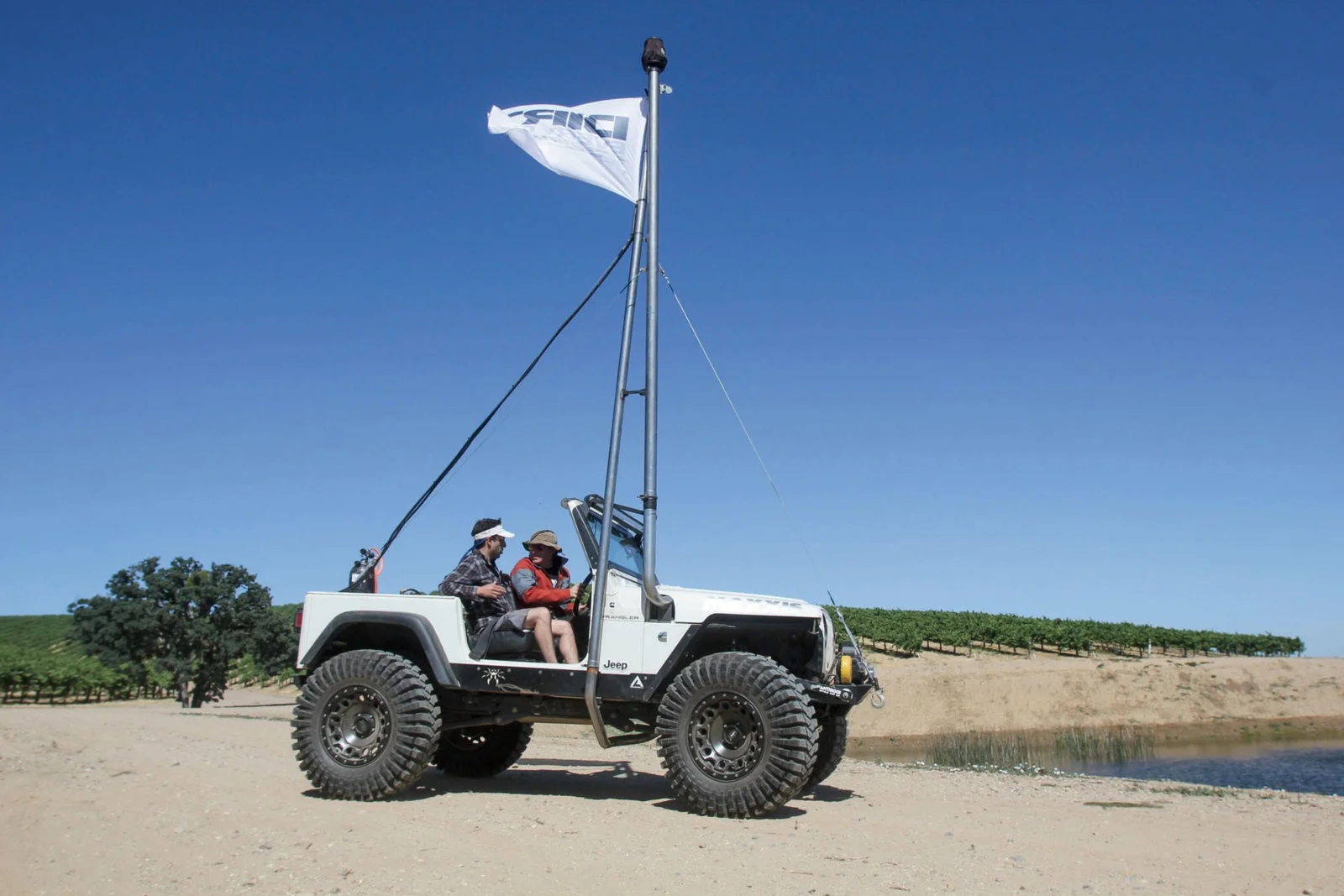

The pic is from a Dirt Everyday episode where they tried to cross a pond. I think this one also had the 2.8L cummins crate engine.
