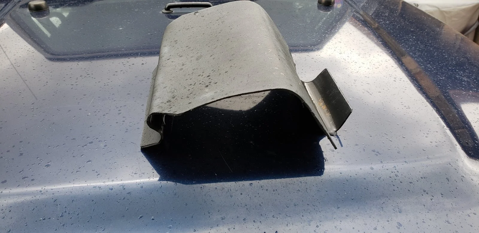

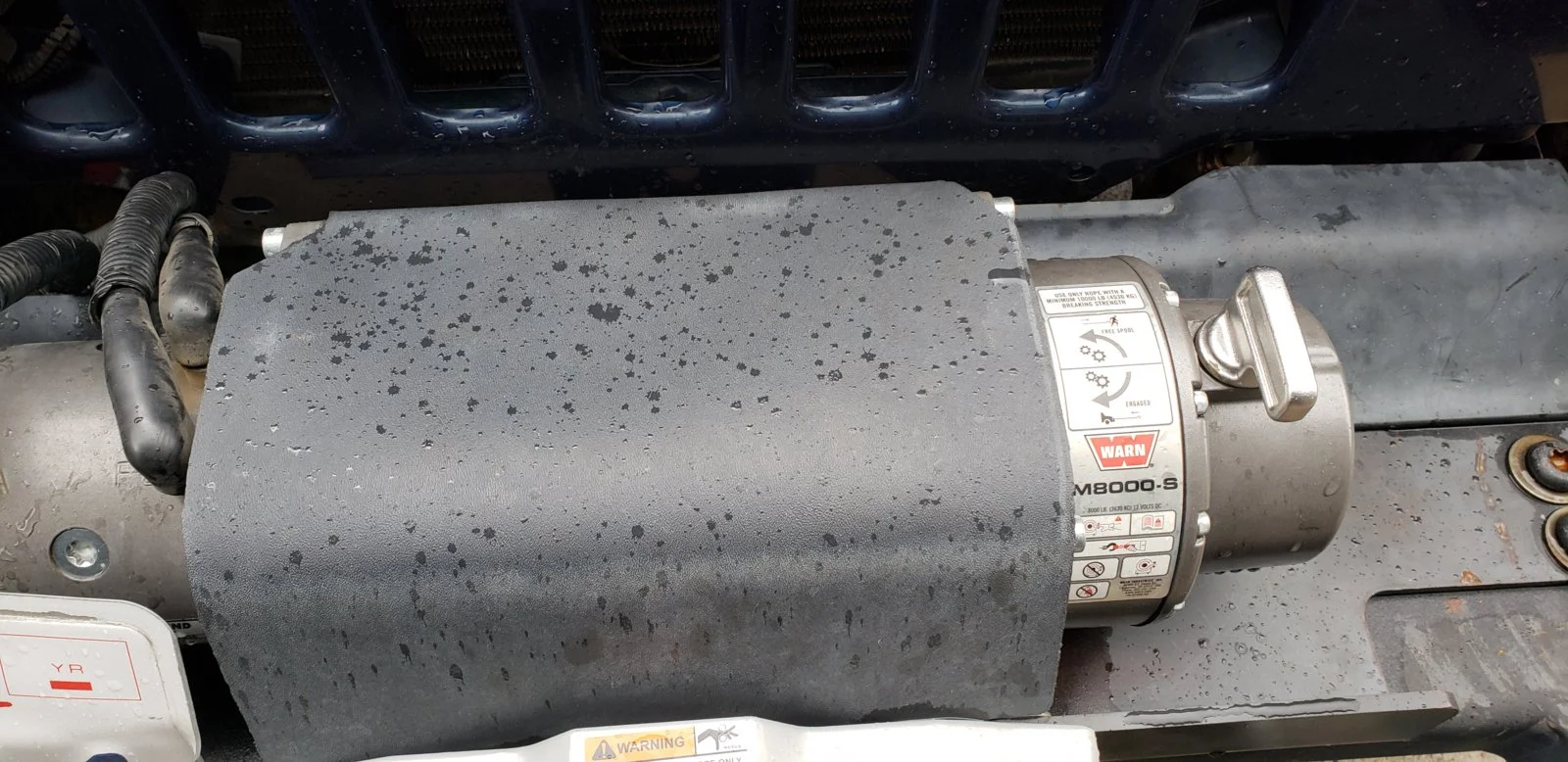

I made a Kydex cover for my synthetic lined Warn. Just buy a 12" by 12" sheet of kydex, and trim to size. Heat with a heat gun and mold it wearing gloves. It's just for UV protection covering the spool and the synthetic line. Snaps on, snaps off. Had for a couple years now.
My steel wired winches I don't cover at all..
I thought about manufacturing these and selling them for maybe $30. But they are so simple to make my profit margin isn't worth the time.

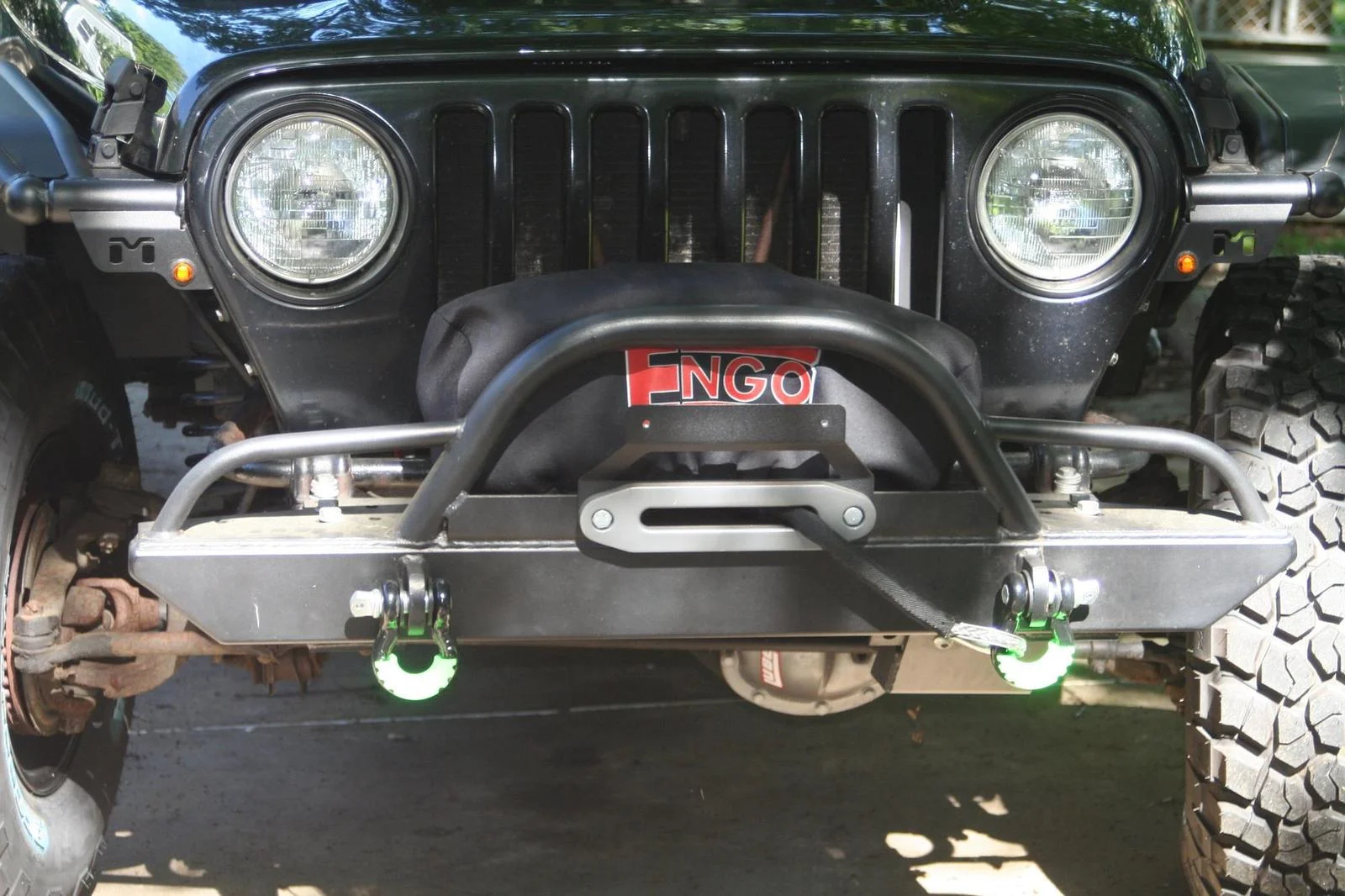

Is that cover made from neoprene?
No...A quote from the website...
"our covers are made in the U.S.A. using our seat cover fabric and 1/4" open cell foam backing. "
Its pretty nice, but NOT water or dust proof. It does breath nicely though, so I haven't seen any "trapped Moisture" like you might get with a vinyl or neoprene cover. I bought it mostly for sun protection and because its a cleaner look to me than just having the winch hang out in the open.
If you are going to cover the rope, also do the end where the clevis is...that is probably the most fragile part of the rope...
You're right, of course. Not sure how I'd do that, without sucking the hook into the fairlead and damaging the aluminum though. Need to get one of those nice ends from TRE.

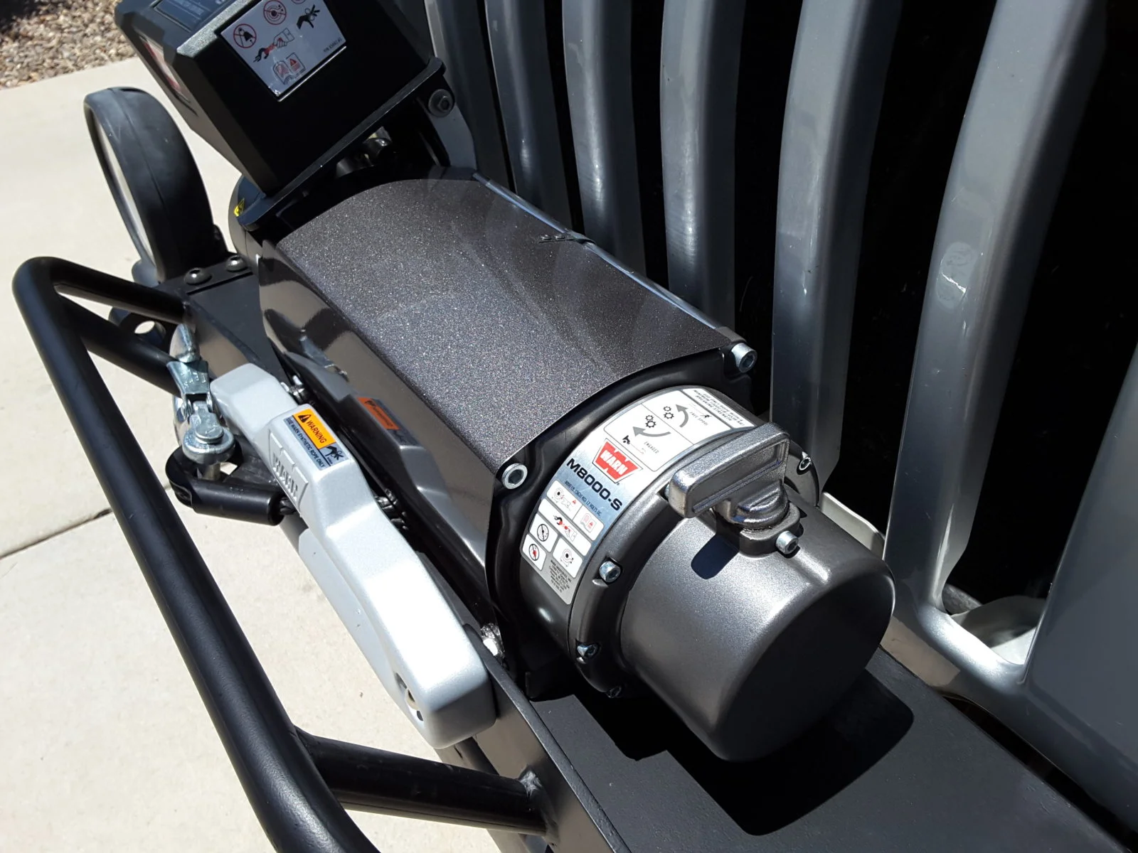

I did much the same thing using thin sheet steel. Keeps the UV off the rope and doesn't trap moisture.

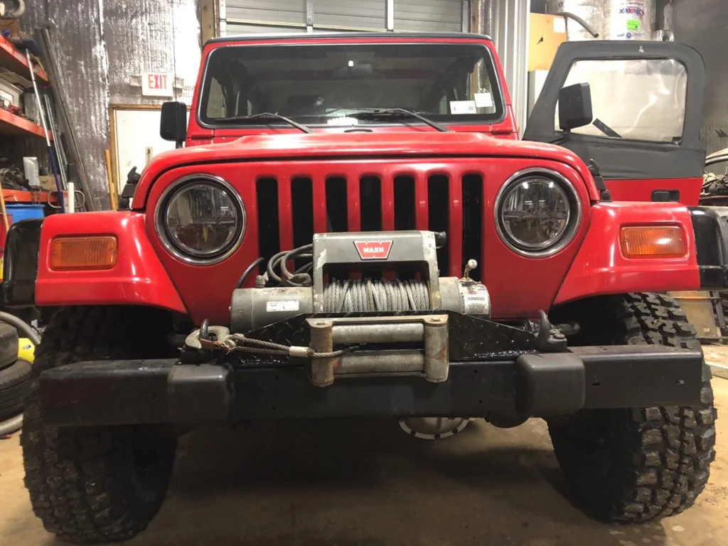

Open. I spray mine with fluid film every now and then.
I do too ... but with Krown Rustproofing T-40 spray. I use Fluid Film on some things and it's a good product (heavier than T-40). I take my cars into Krown every year. Without even asking they always spray the winch on my LJ.
