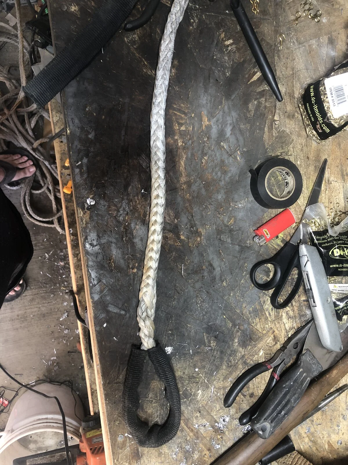

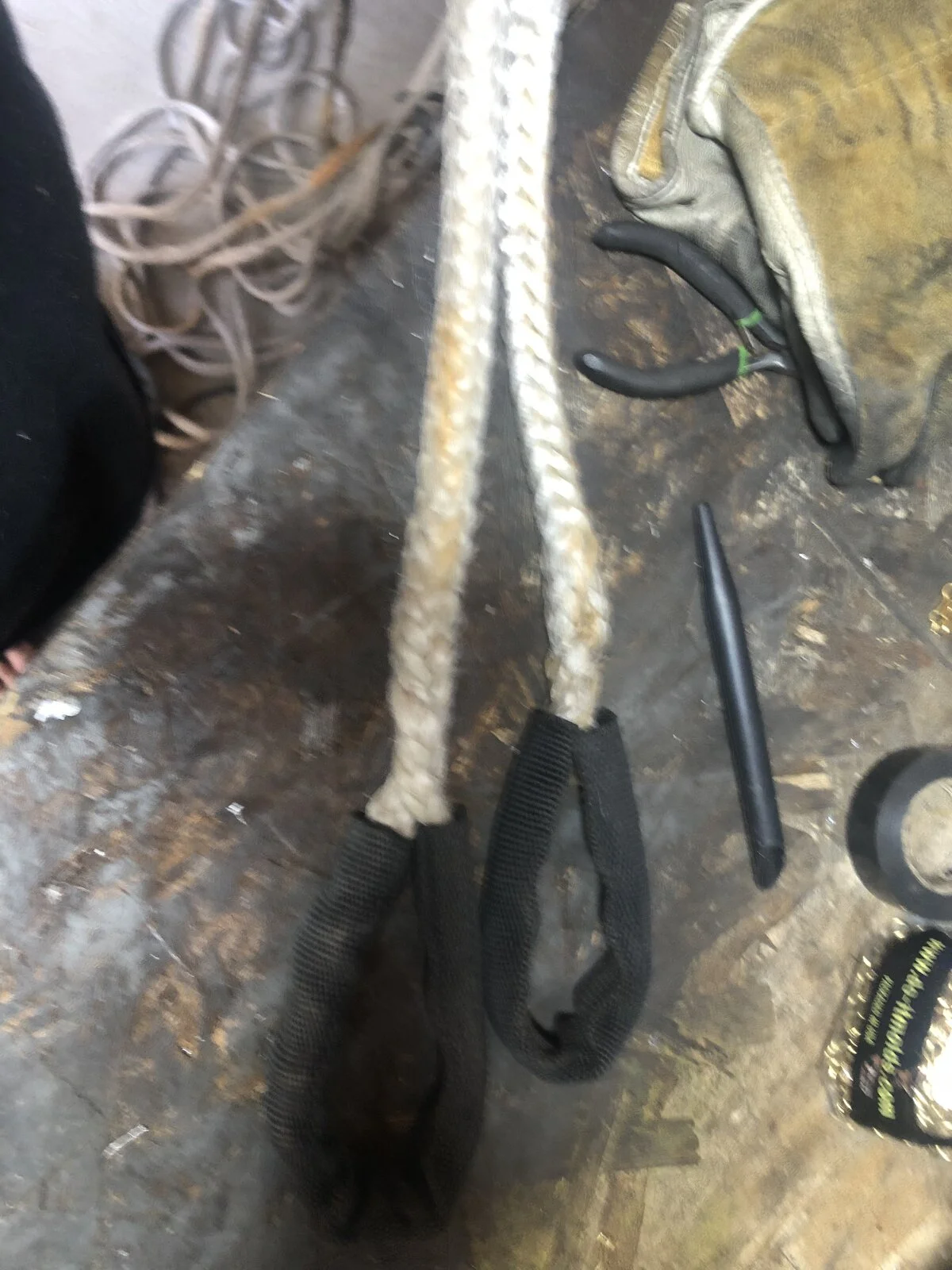

I want to use the good part of my old winch rope as a winch rope extension. Is there a loop knot that works so there in no metal thimble used? So there is a loop at each end?

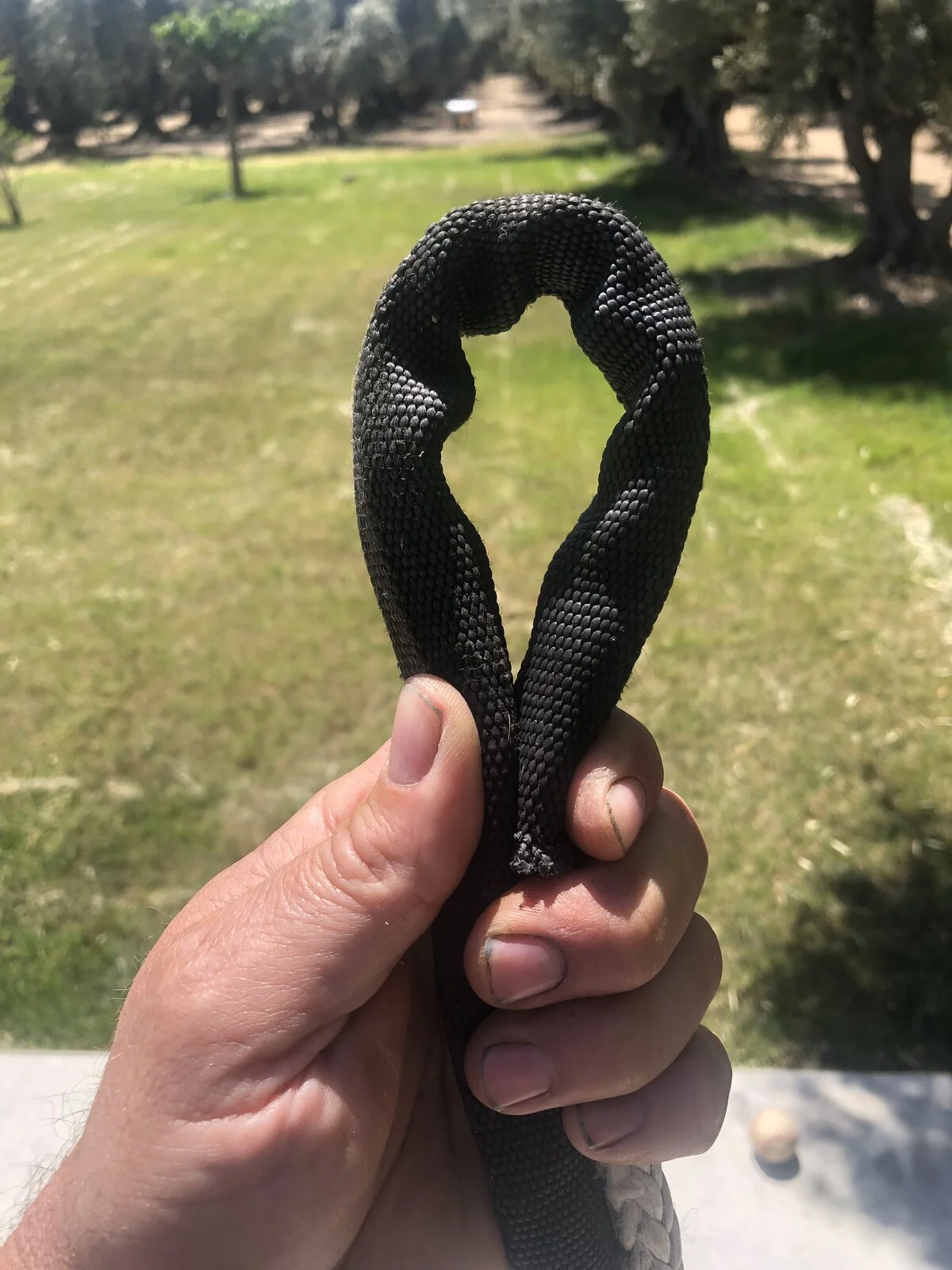

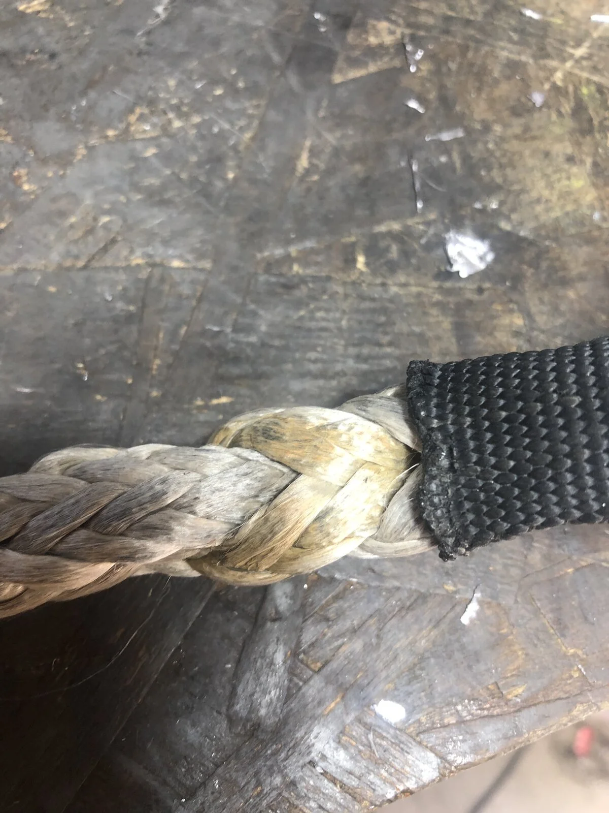

Locked Brummel eye splice with some abrasion guard.
So just line the loop with the abrasion sleeve?

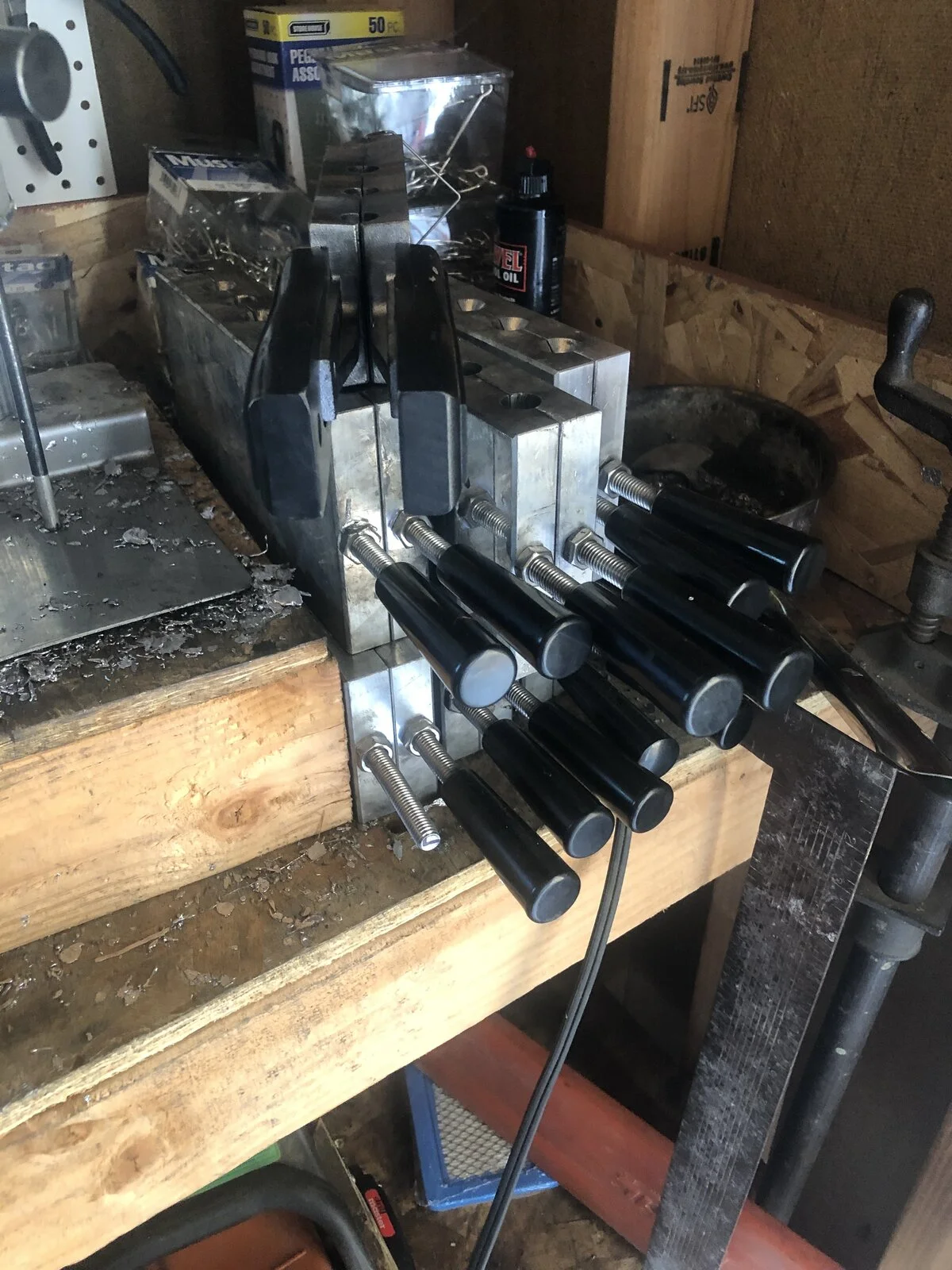

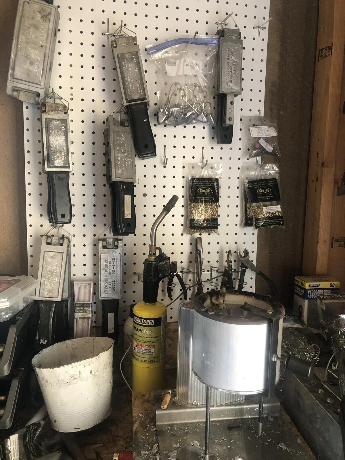

Somebody has been making a bunch of fishing weights. I make a bunch for halibut and salmon fishing.
Here's a link to a guy that makes awesome billet aluminum molds.
http://shawncollinscustoms.net/index.htm
I have a few of his molds. It is my side gig. Paid for a lot of toys. Lol
I don't need to tell you anything, you're on it!
That's a nice set of molds.
I have that same smelter and I use a big pot with ladles as well because i do as big as 32oz. cannonballs and as small as 1oz.
I do 1oz-3lb balls.
3/4-16oz torpedo
1-10oz pyramids
3,4,5,6 shad jig heads
2-6oz bullet head jigs.
They keep me busy enough. Not as busy as last year but that is ok. I was swamped last summer.

Here is the video I followed. The only thing I did different was to taper the tag end of the rope more like the TRE video.
