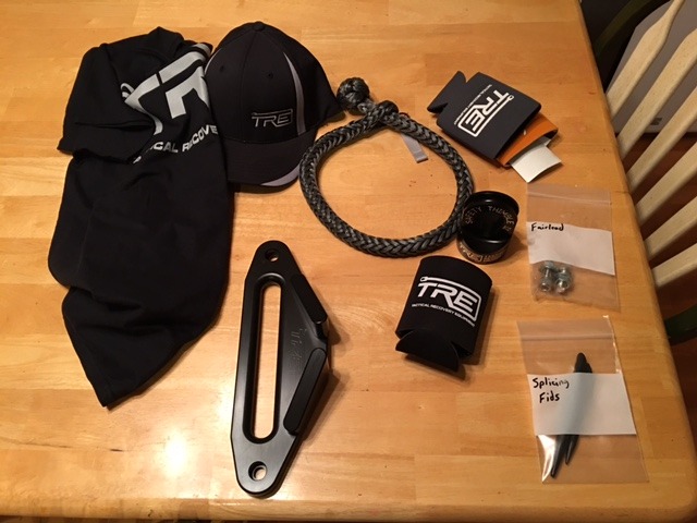

BTW, here's a picture of my package all laid out. I have to admit, the hat and shirt might be my favs ;)

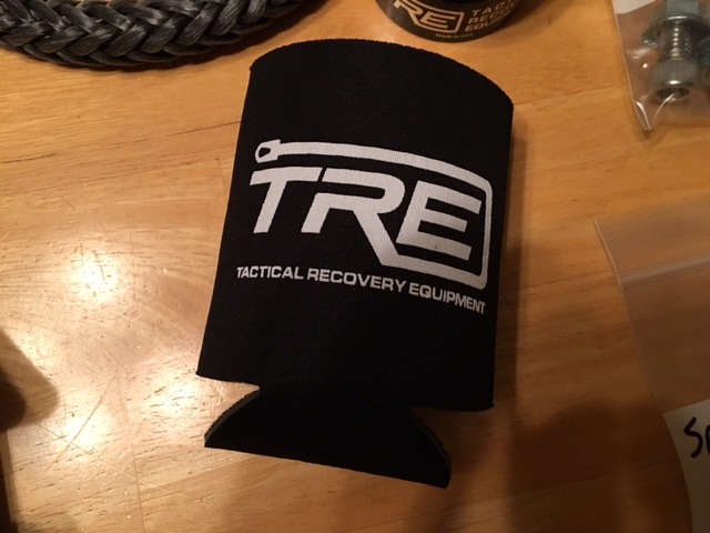

Also, what is this for? Does it cover the safety thimble while it's on the vehicle? If so, I assume this has to be installed at the time of splicing it otherwise there's no other way to get it on?

Samson's website has a good technical section. Look for 12 strand eye splice. There are a couple of simple things to keep in mind. First and most important is the length of the buried tail. Second is push the fid further along inside the tubular rope before you bring it out to daylight and remove the fid. That extra bit of length makes it easier to milk the tail back inside. After that, it is stupid easy to do.
That "cover" looks suspiciously like some sort of thermal outerwear for an adult beverage. ;)
The way I attach the fid is to take the tapered tail and push it inside the hollow. Secure it in place with a couple wrap of electrical tape and you're golden.
Reactions: JMT and Chris
Holy crap... didn't realize that was a can cover. The TRE safety thimble was inside of it so I thought it was a cover for the thimble, haha.
