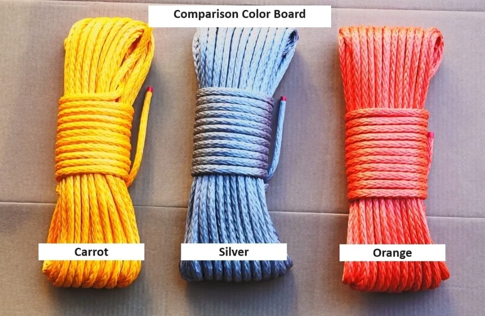

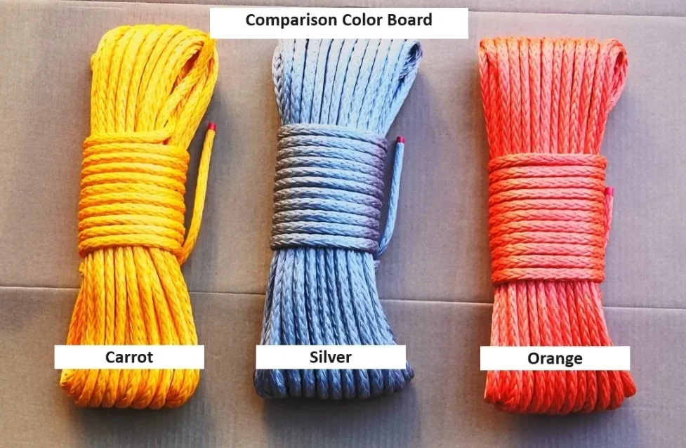

New winch line colors! A bright orange and silver,
Between yellow, carrot, orange .. folks have very nice options for bright and visible colors from BMB. I think Green and Carrot are still my favourites.
Carrot looks really good/bright--very tempting to get rid of my 3.5 year old TRE line.
It's the one to get if yellow is too yellow but you also don't like the widely common safety orange.
I am surprised more people haven't bought it. @jjvw's photos show how nice it is.

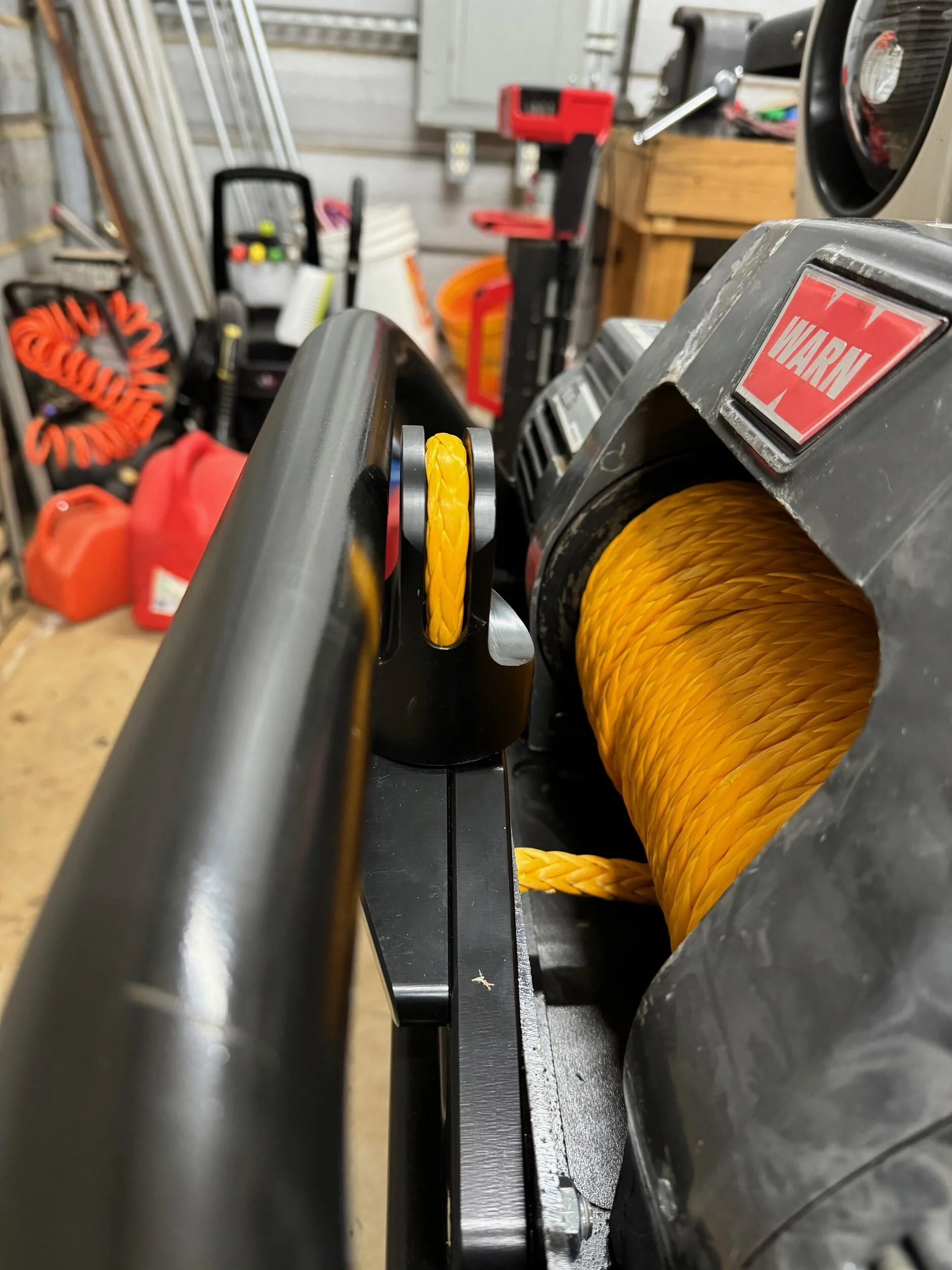

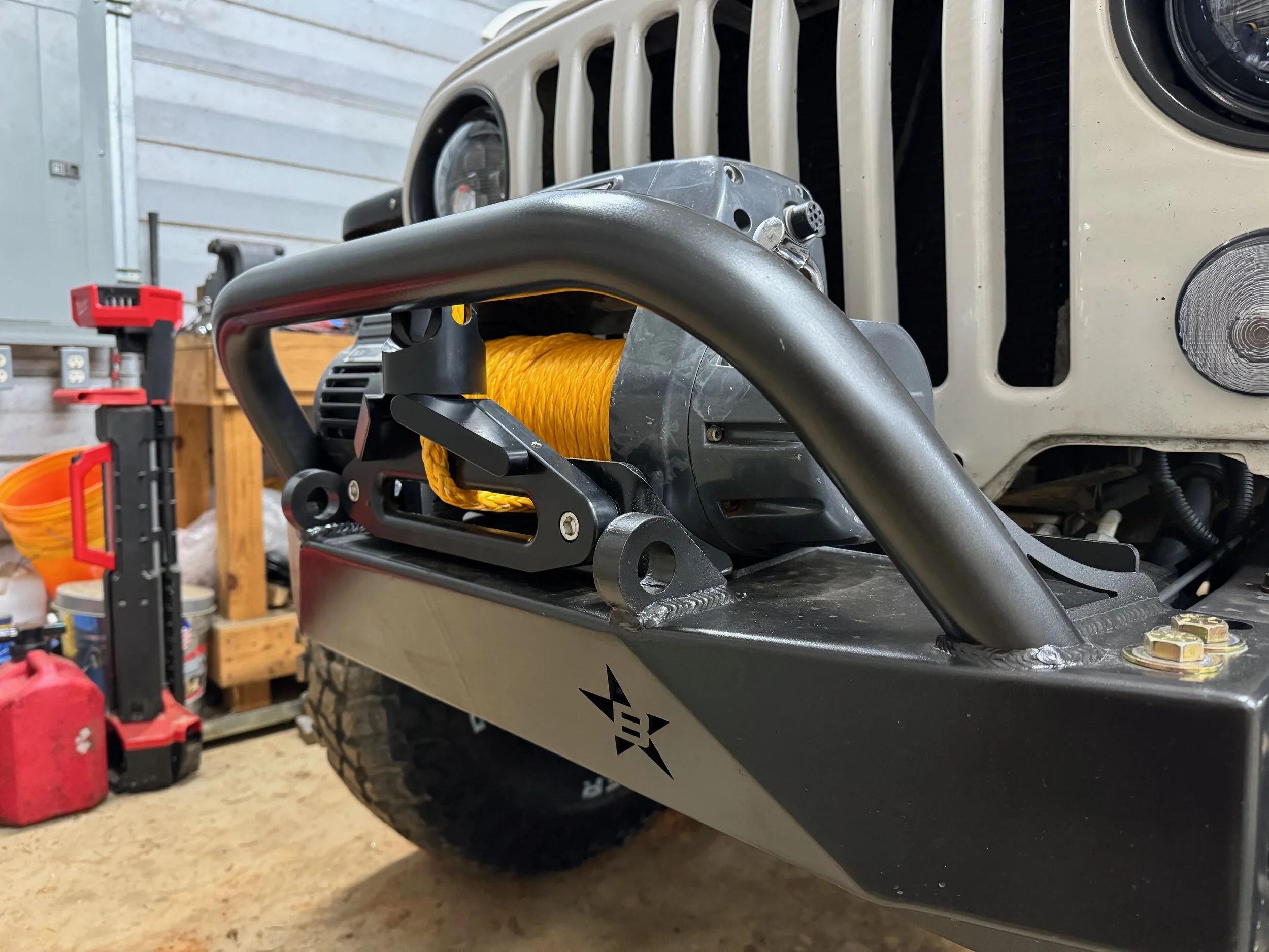

I wanted to follow up and let everyone know what wound up working for me; the issues was 100% that the Barnes 4WD fairlead mount was too tall.
I went with the gusseted MotoBilt fairlead mount, and feel like I wound up with a PERFECT fit with the WRG fairlead and safety thimble.
I'll add that this combination got me enough "tuck" of the fairlead that its protected by the bumper and winch guard on the Barnes 4WD stubby bumper.
Another note, the opening in the motobilt fairlead mount was a bit too small vertically, but nothing a flap wheel in a grinder couldnt clean up, I went ahead and rounded over the contact points while opening it up, to hopefully protect the winch line should it ever contact.
