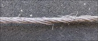

Your steel degraded somehow? Synthetic is easy to break and replace, I guess that's a good thing.
My wire rope didn't degrade, it kinked and stands would eventually break after doing multiple pulls in single days when level rewinding between pulls wasn't easily done. That pulled the rope down through layers kinking it and eventually breaking individual wire strands.
I went through 2 wire ropes before making the switch to more durable synthetic 3/8" synthetic.
