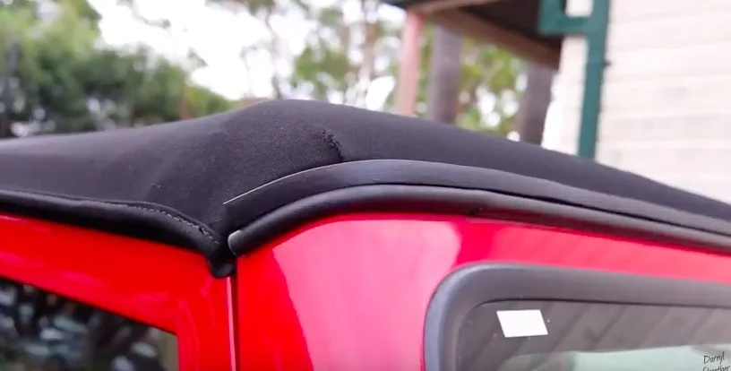

My Twill tracktop developed wind noise and I put a strip of 10mm square rubber along the top of the windscreen header where the leading edge of the softtop is. When the top is clamped down the rubber compressed and all flapping/windnoise went away. Worth a shot.
