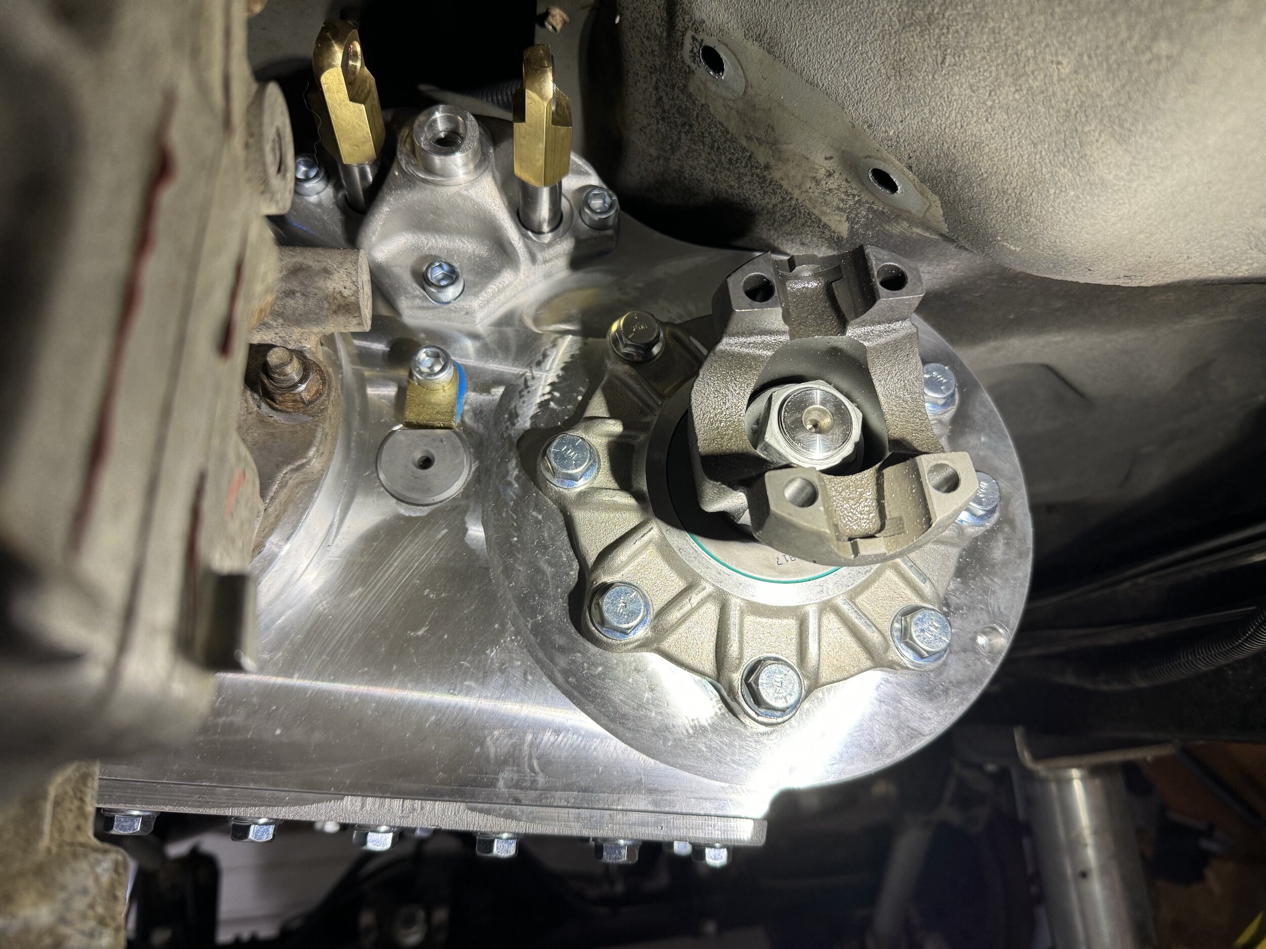

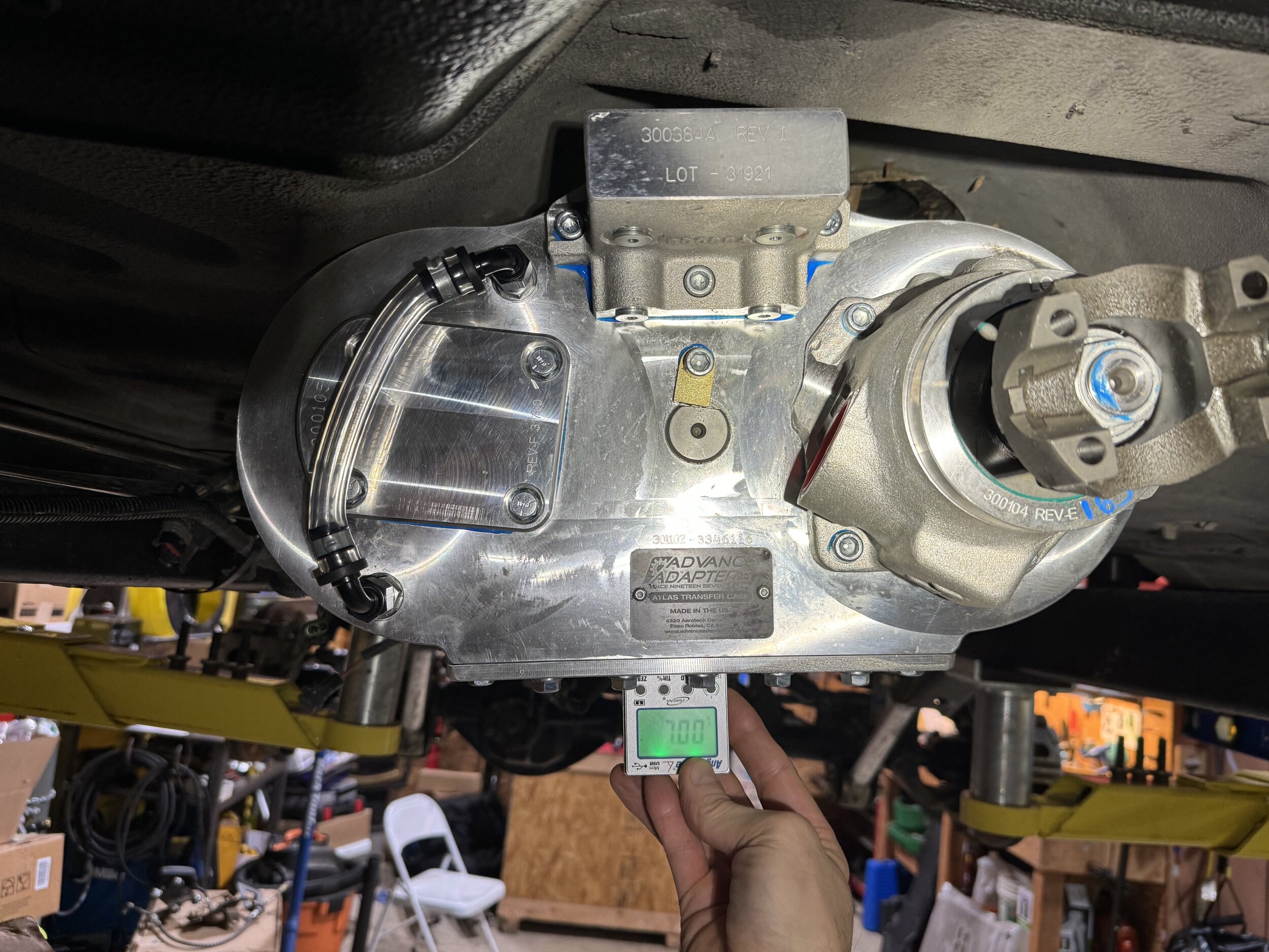

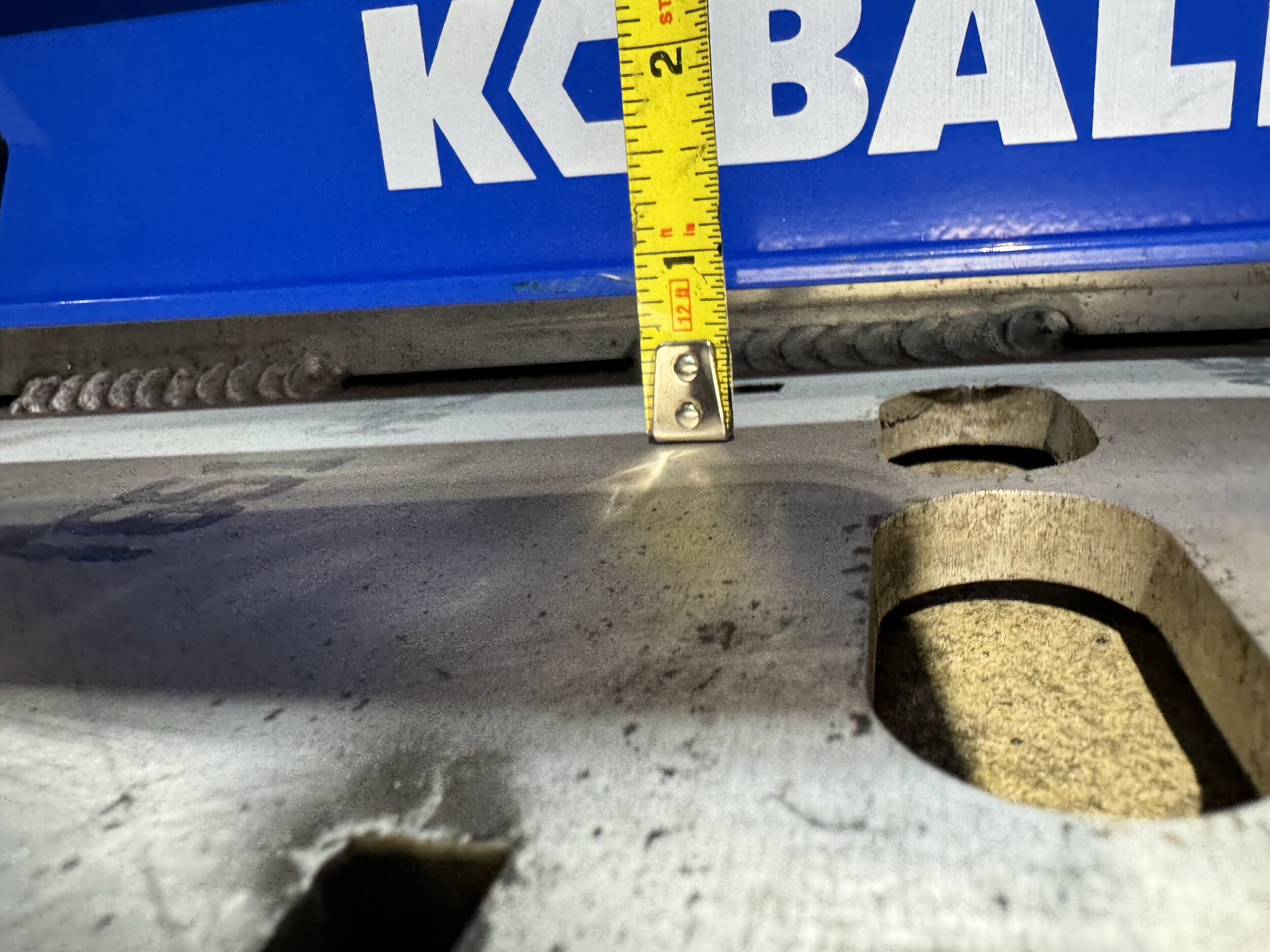

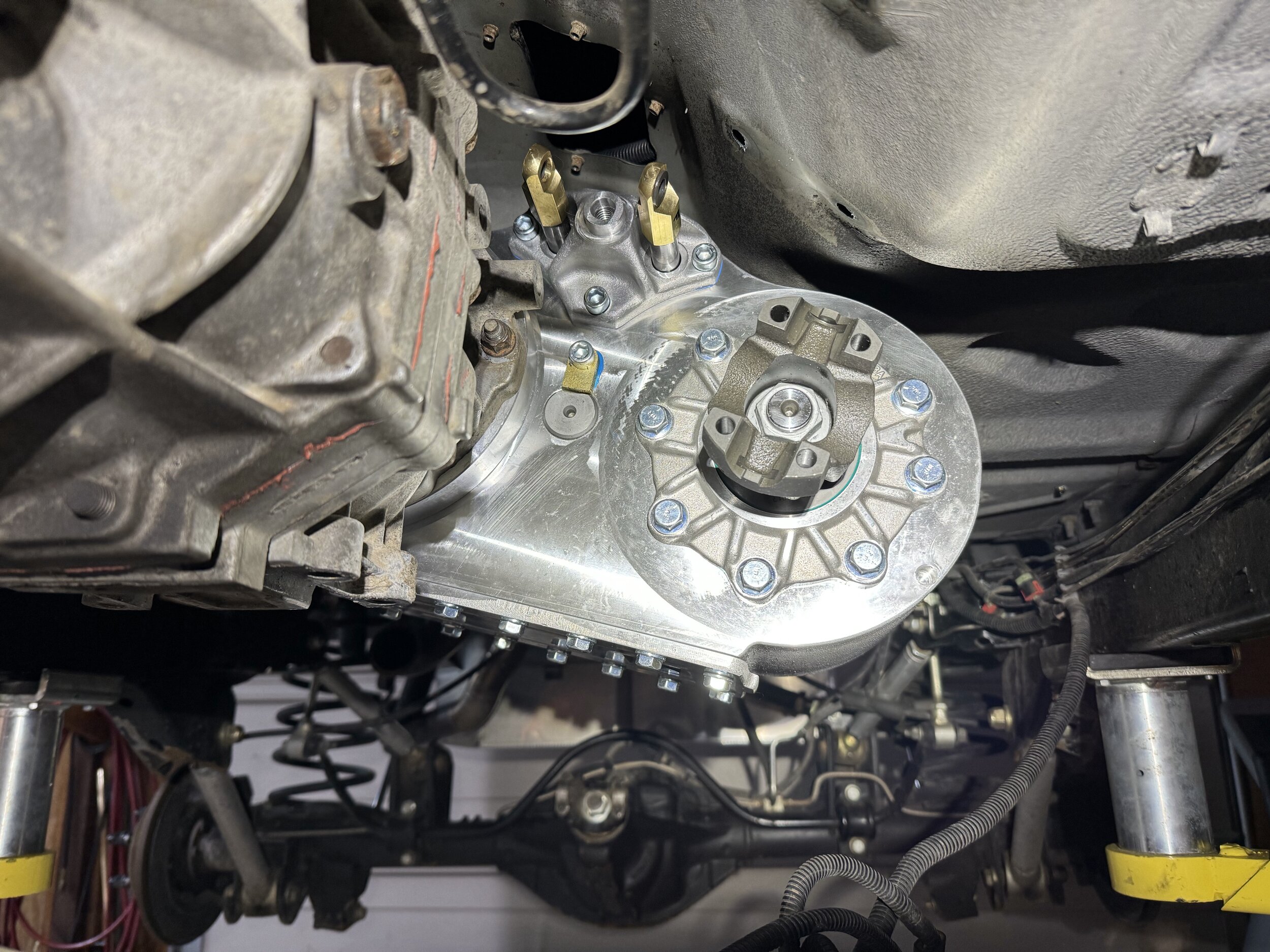

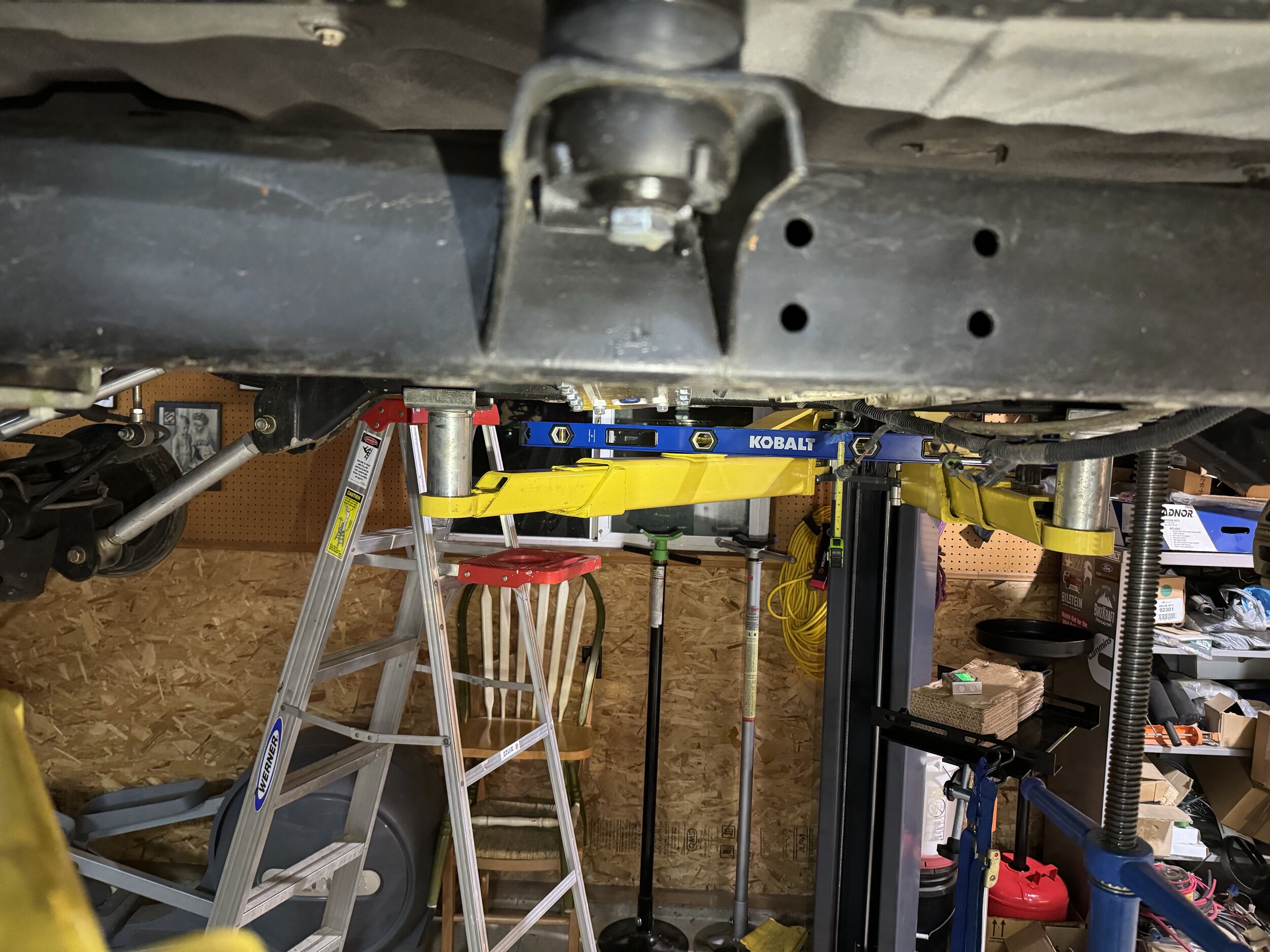

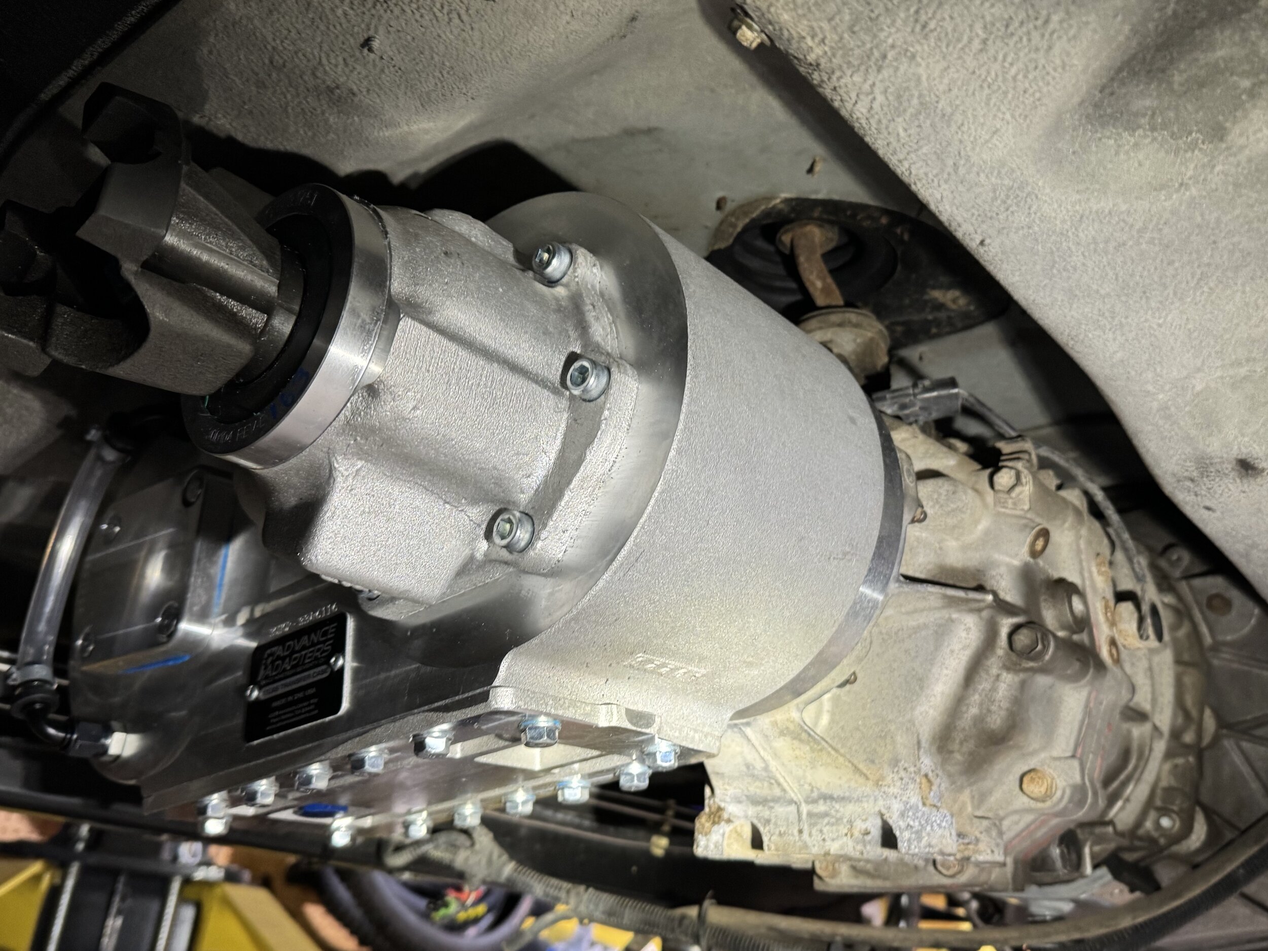

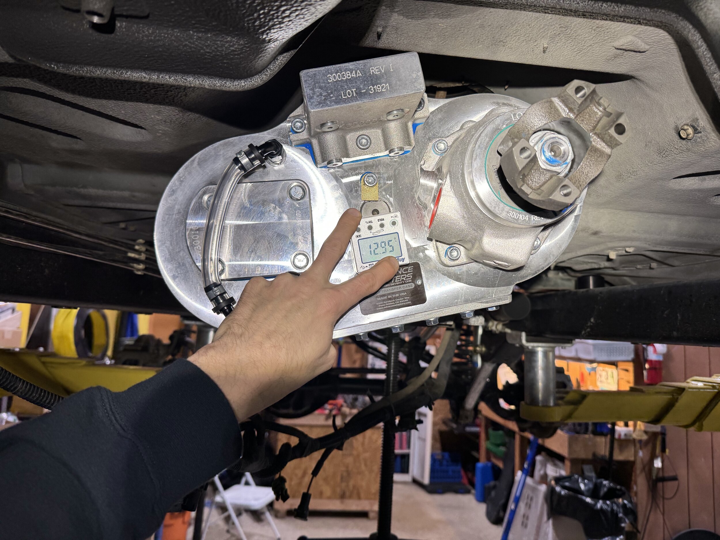

I began work on the Atlas install this evening. This Atlas is much larger than the NP231 top to bottom, especially on the front output (driver) side.
Despite this, I’m hoping to exploit the new 1.25” body lift to increase the amount of tummy tuck from 2.5” below the frame to roughly 1.5”. The Atlas has multiple options for clocking. The position of the stock 231 is 13 degrees down on the drivers (front output) side so I started with that. The height of the pole jack supporting the AX15 is at the height the trans sits when using the stock trans mount on the UCF ultra high clearance skid.
This gave plenty of room on top.
But that Atlas at 13 degrees also hung down too far to use the UCF ultra high clearance skid. That skid is about 1.25-1.5” below frame belly height (outside) but less than 1” on the inside.
So next I tried 7 degrees.
I liked this better. It will require some tub clearancing but should also allow the higher T-case skid.
Either way the transmission mount plate will need modification and I think I’ve decided to make a custom crossmember rather than have the transmission rest on whatever skid I use.
I‘ve got some work to do…

Do you think you could clock it flat? You are so close, and that would give you clearance for the skid.
I clocked mine flat, but as you said it takes some body work. On mine, I also had to modify the driver’s seat bracket to clear the case. It was quite a bit of surgery to make it work.

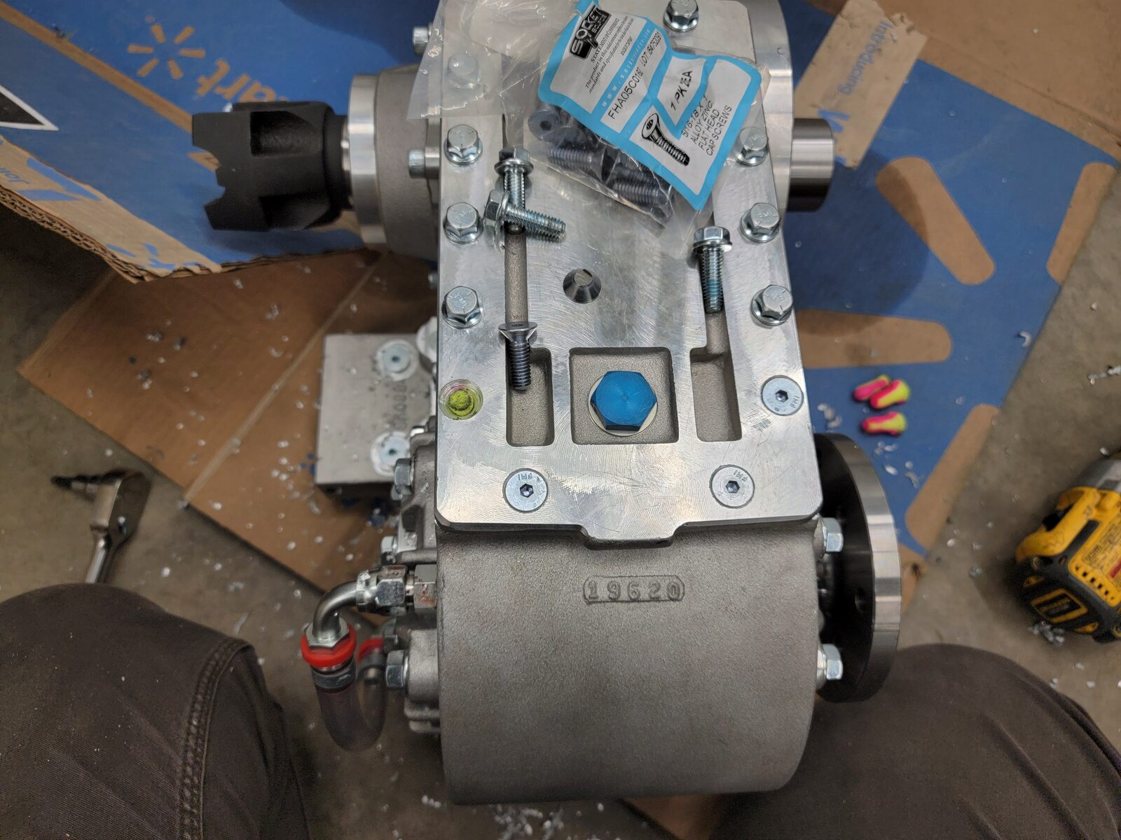

If i remember right blaine puts countersunk screws in that access plate to give a little more clearance?
I might be able to but I'm not sure the juice is worth the squeeze. I think I can fit the 1" drop T-case skid at 7 degrees with less body massage. But I'm not sure yet. I need to get the crossmember tacked in and probably will do the access plate bolt counter sink noted below.

Both threads I linked show their crossmembers. BoomBooms is on the next page IIRC.
