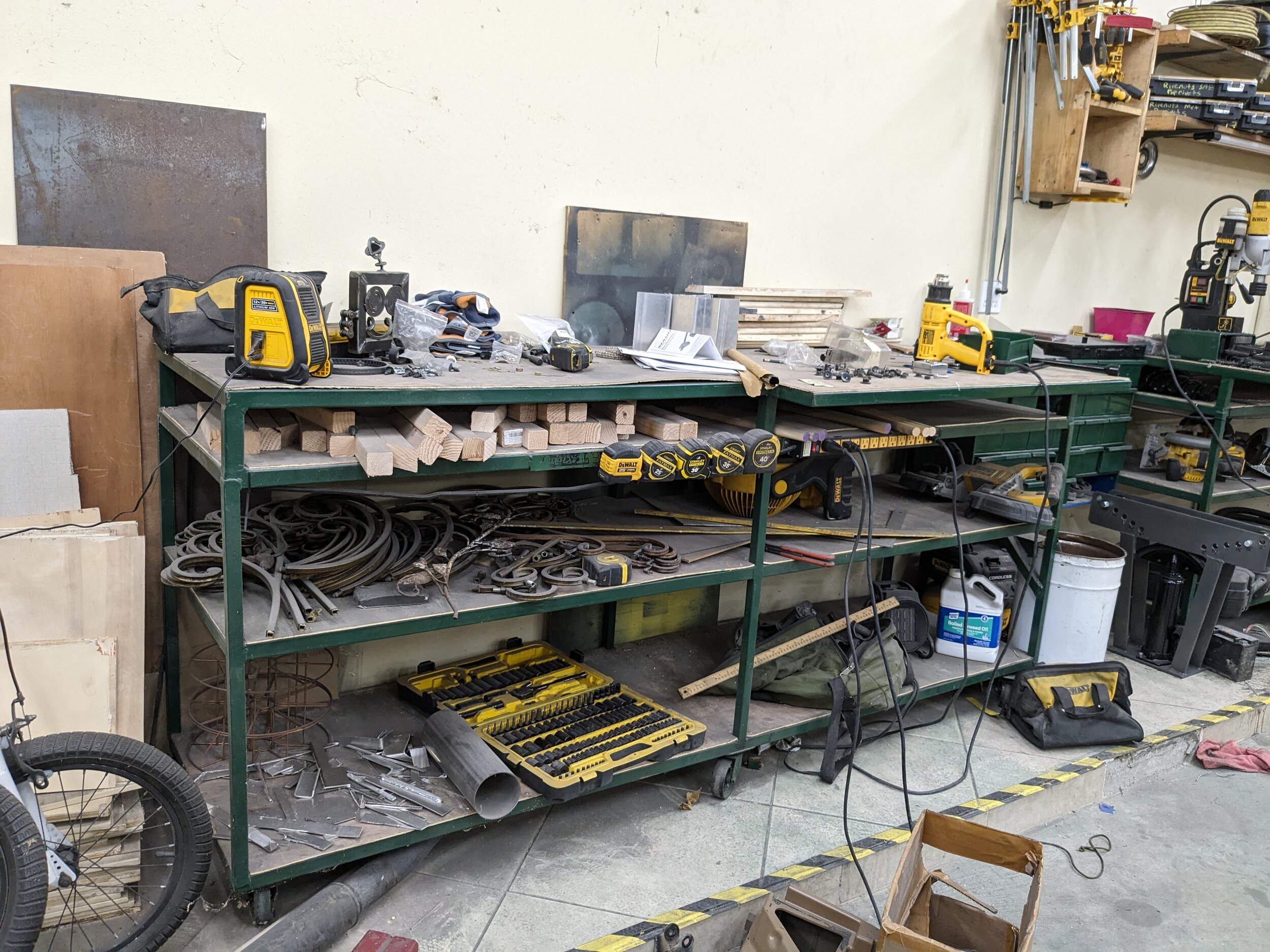

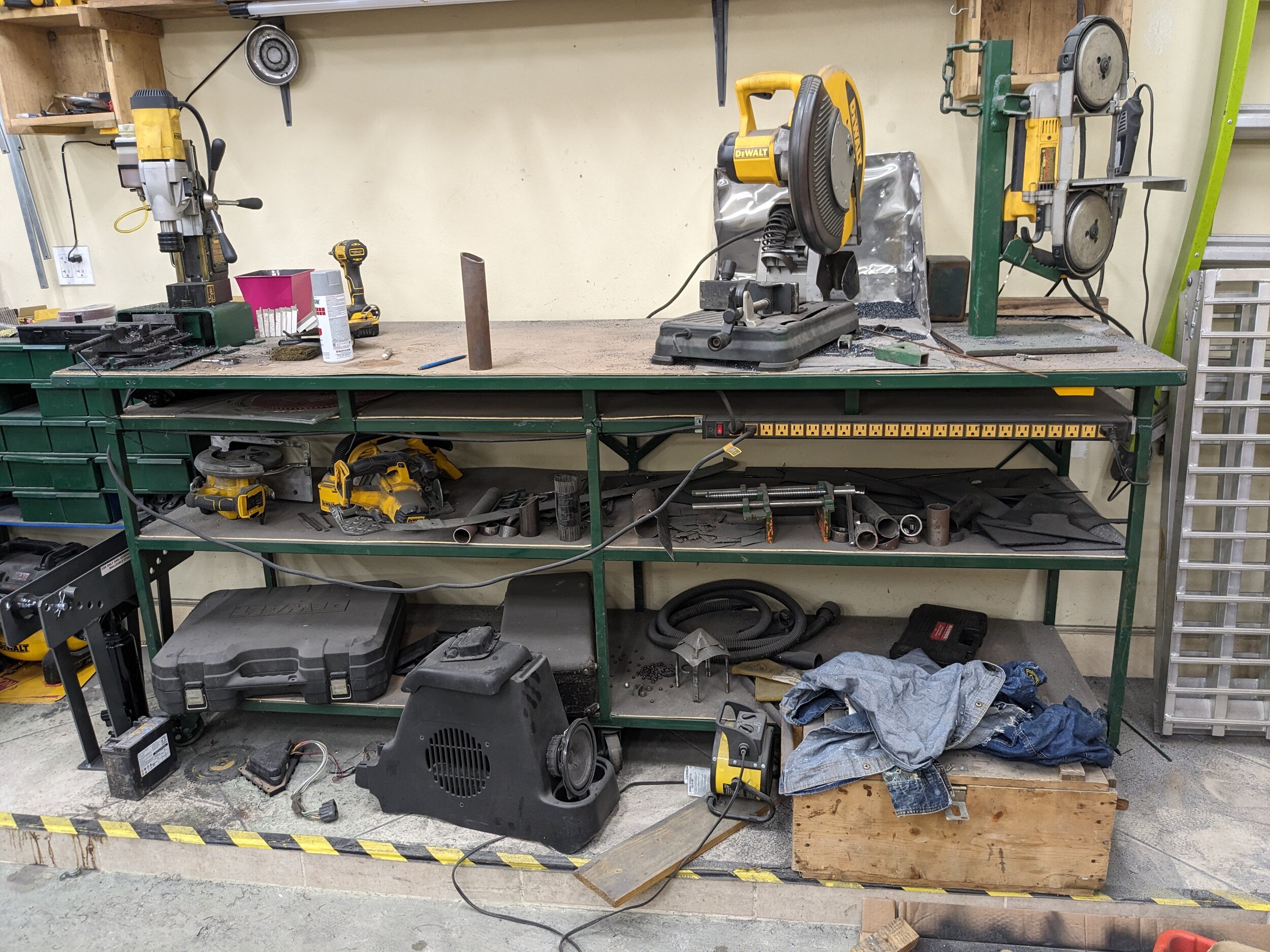

You've got a welder, have you considered making the frame for the workbench & shelves out of steel? I made mine out of 1.25" x 1.25" x 16 gauge sq tube & they hold up to the abuse pretty well. The frame is thinner than 2x4s & with steel it's also easier to make modifications.
  • Wow
Reactions: FarFire70
Honestly.... no. Hadn't even considered that...
What a great idea! Welp, now I need to re-consider my idea. Without looking into it yet, I wonder if cost delta may be a factor. But, that's what research is for!
Reactions: Danarch

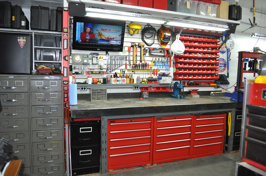

Love the OS card cabinets, PC. I have a few of those as well.
Reactions: PCO6

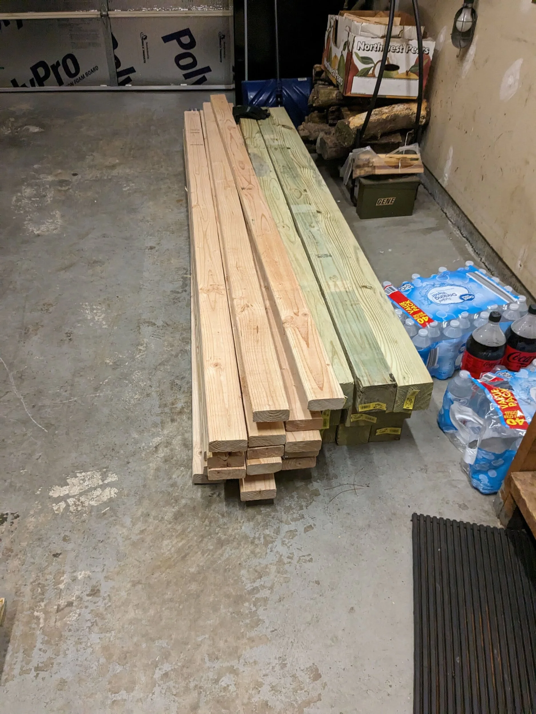

I plan to pick up the wood this weekend and will post updates here as this project comes together.

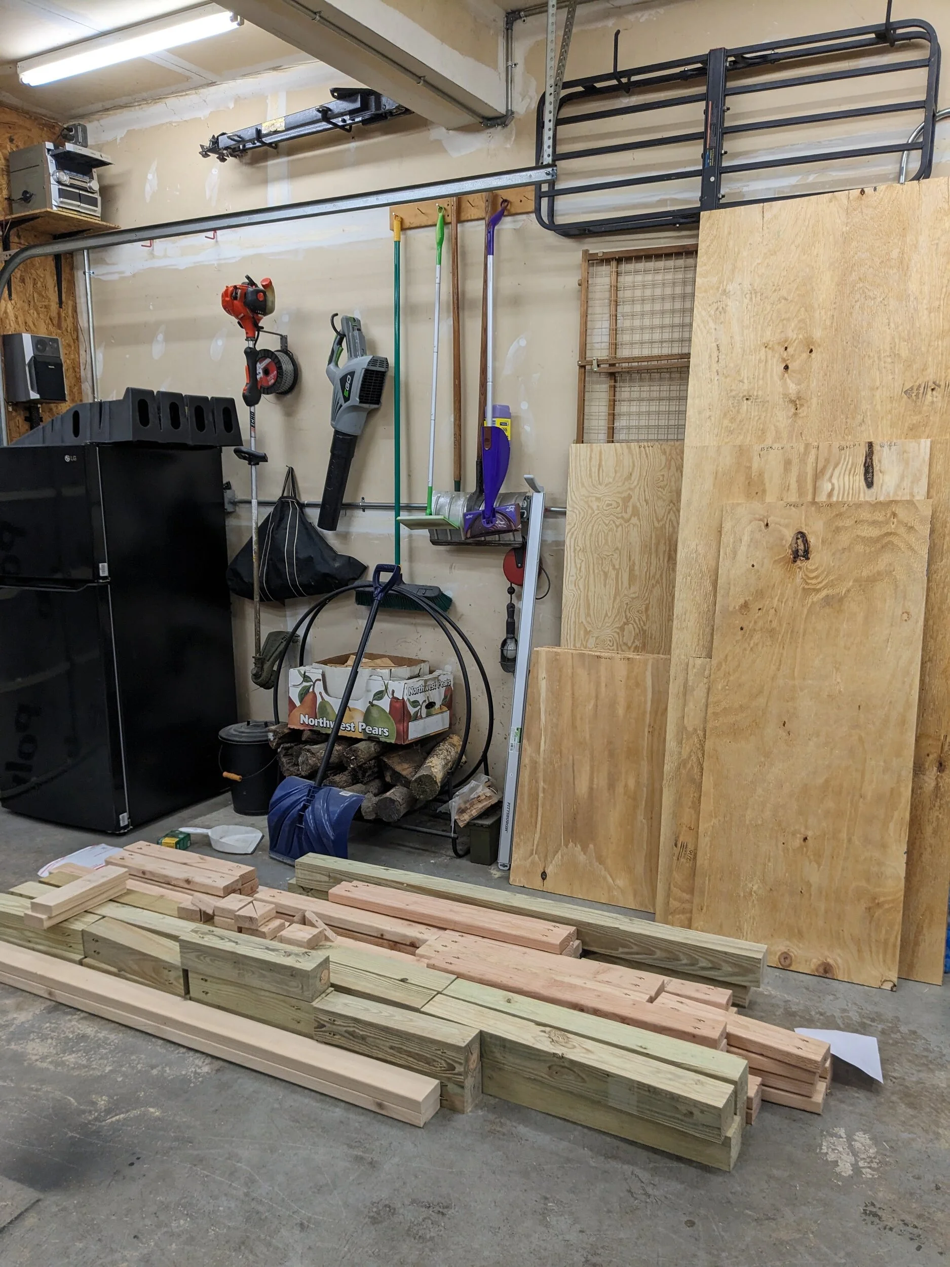

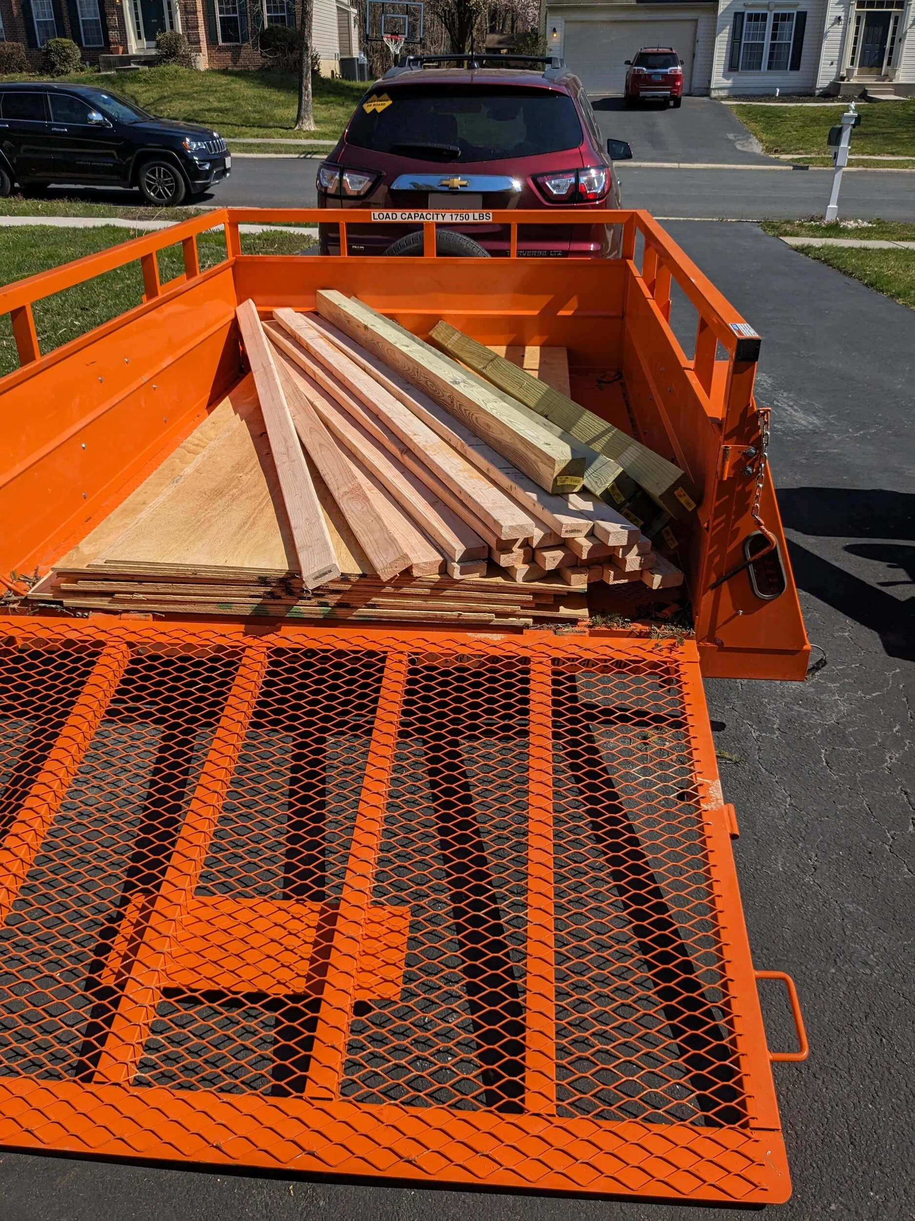

Pulled to trigger. Ran over to HD this morning. I don't have access to a trailer or truck but I've rented their trailers in the past to bring home the OSB for the garage. Unfortunately, their semi-reasonable price for a half-day rental that I use on occasion doesn't help my items to the wife that I need a truck...
Stacked up and ready for chopping and pocket hole drilling tomorrow. I'll see if time allows for starting to mock everything up.

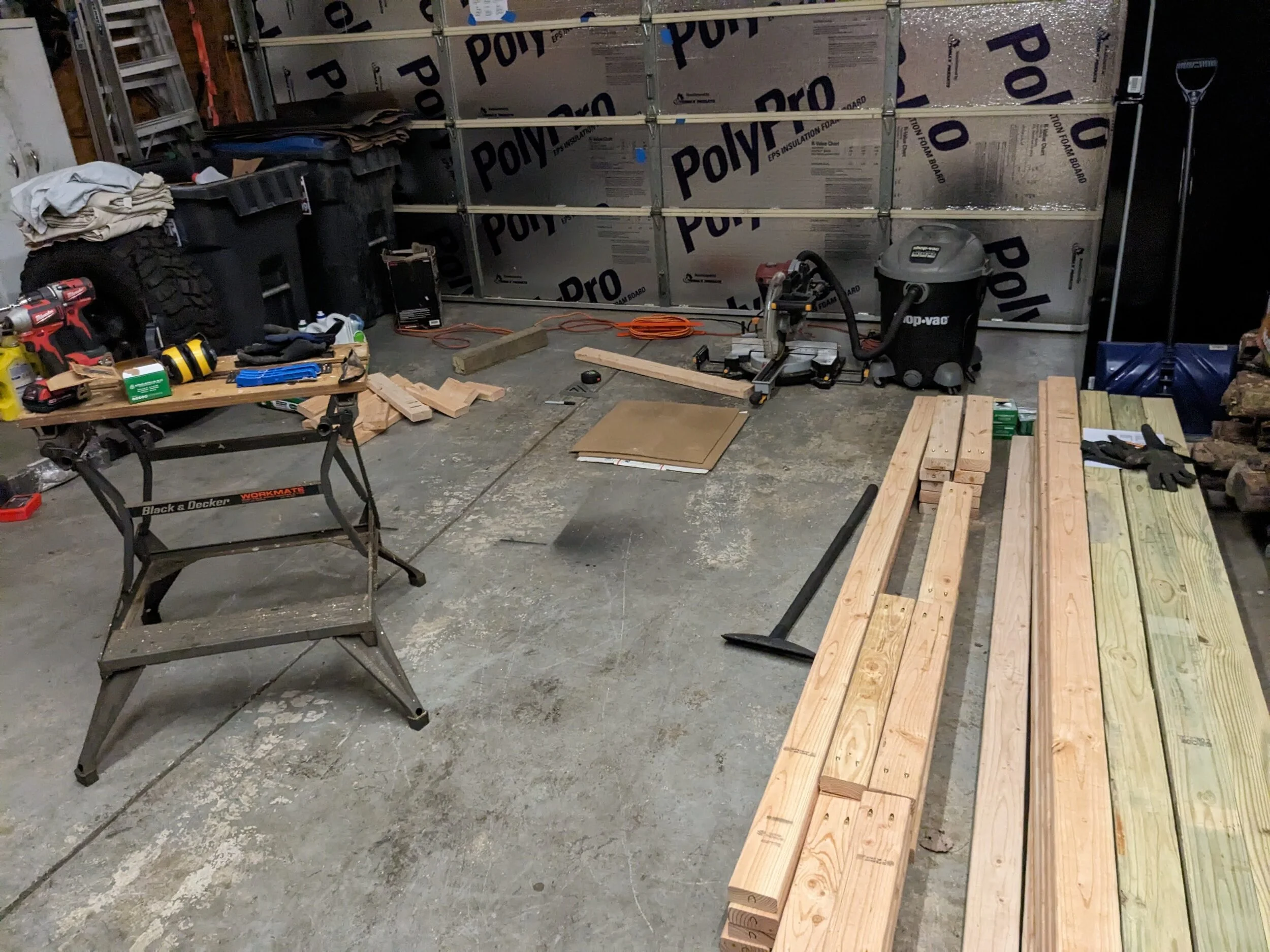

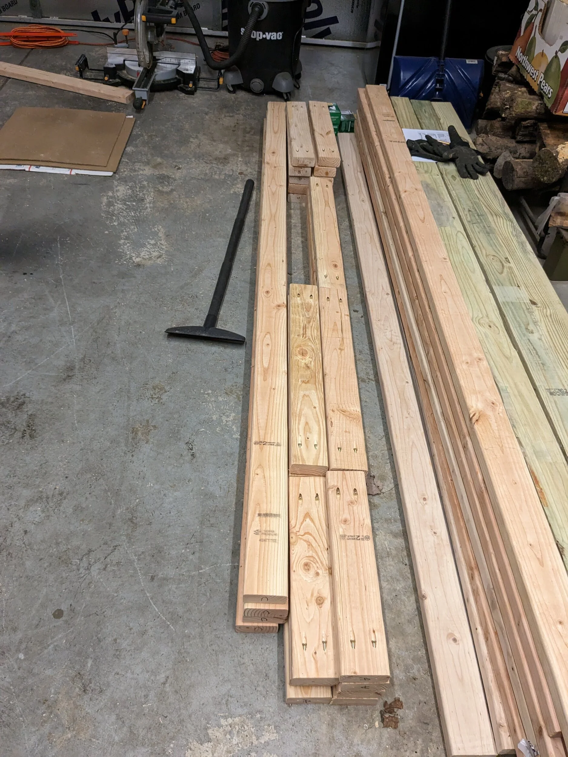

Got about 75% of the 2x4s cut, pocket holed, & primed with screws. (y)
Marked the same sized board on the end so the assembly should go together like a kit.
Setup an assembly line. Chopped on the floor. Pocket holes on the portable workbench.
Portable workbench is great helper that folds up 'flat' for storage. Got it from my grandfather when he went into the nursing home - he's a WW2 vet turning 100 years old next week. 🇺🇸

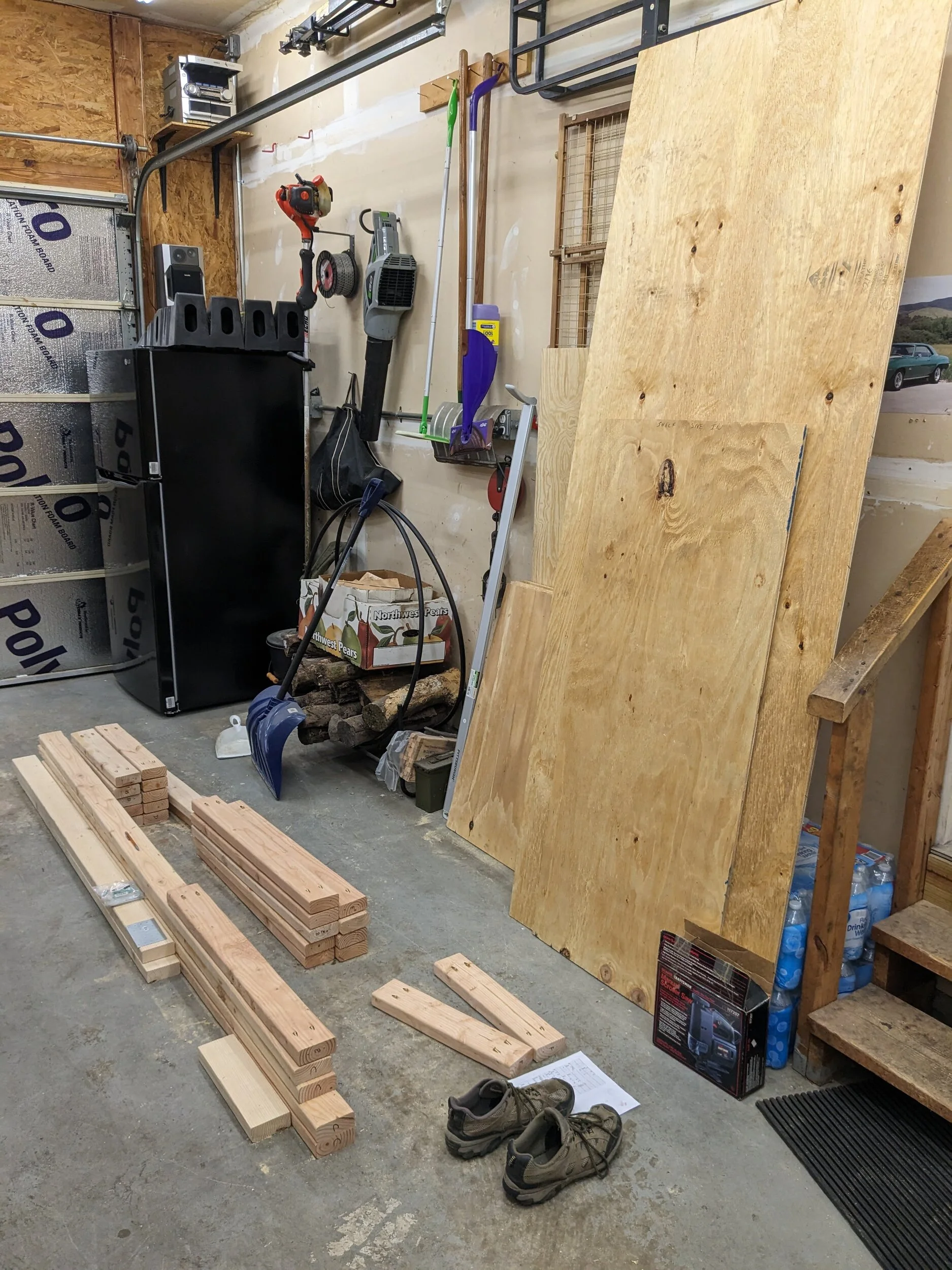

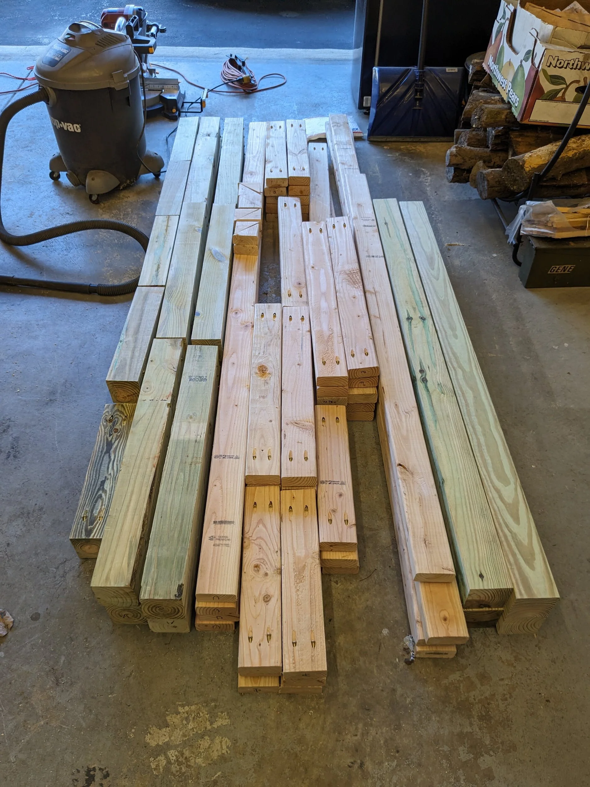

Today, I cut, pocketed, & primed with screws the remainder of the 2x4 boards for this project. (y)
Made a few corner gussets for where the 4x4s legs join the 4x4s supporting the workbench surface. Figured I'd toss them into the design for some extra strength there.
Rest of the un-used 2x4s are for a project in the basement that will come after this is done. Some of them are more warped that I noticed at HD when picking off the slim-pickings pile that was on the shelf...
Hoping to get after some of the 4x4s during the week. I need to keep four of the 4x4s intact to use as supports when ripping the plywood.

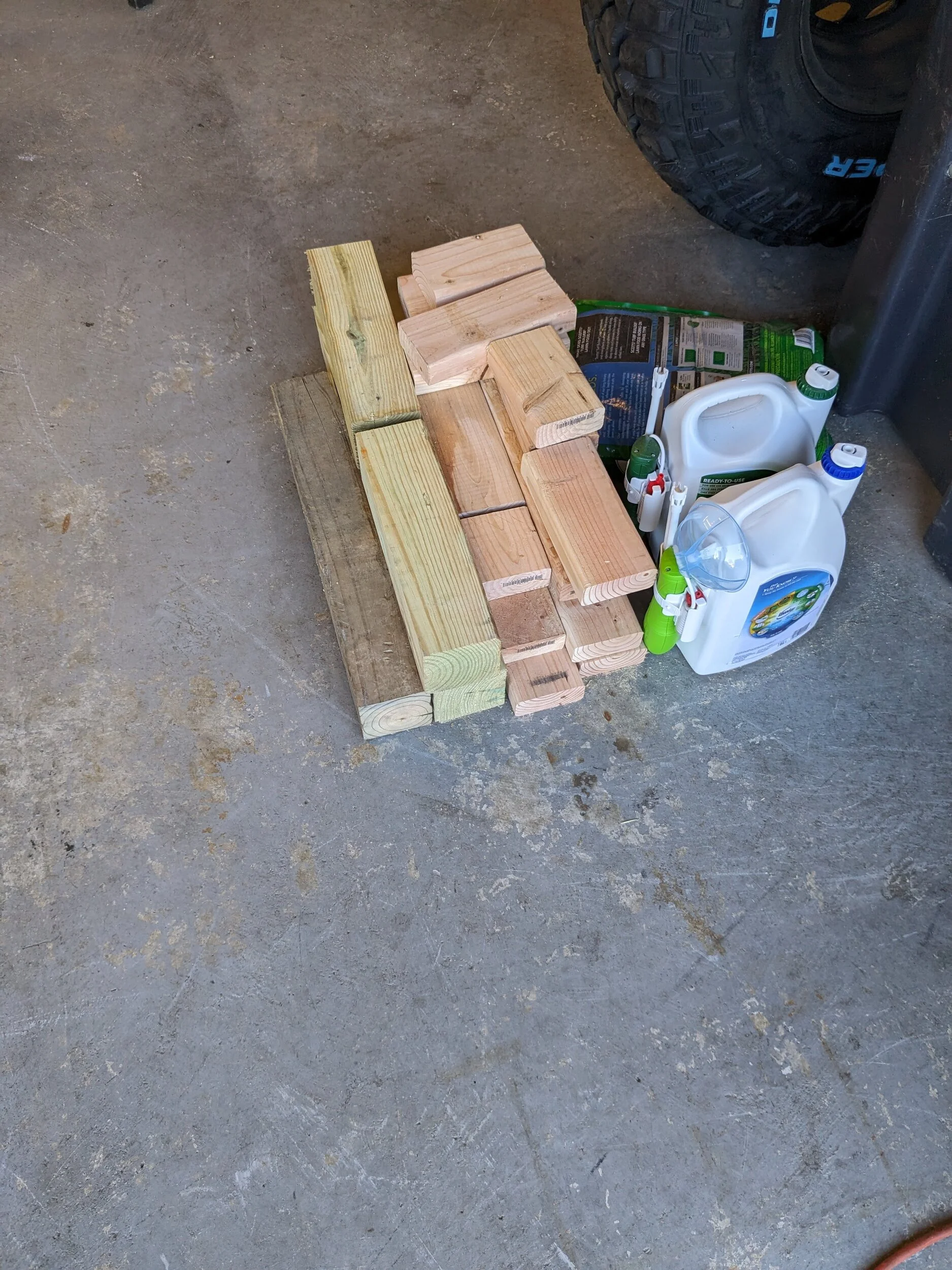

Finished the 4x4 cuts & populated with screws.
Scrap:
I'm pretty happy with this as the leftovers. Efficient use of each board.
I'll keep the 4x4s to chop off pieces to level the workbench. And then what's left will hang out in the garage as short 4x4s are always useful.

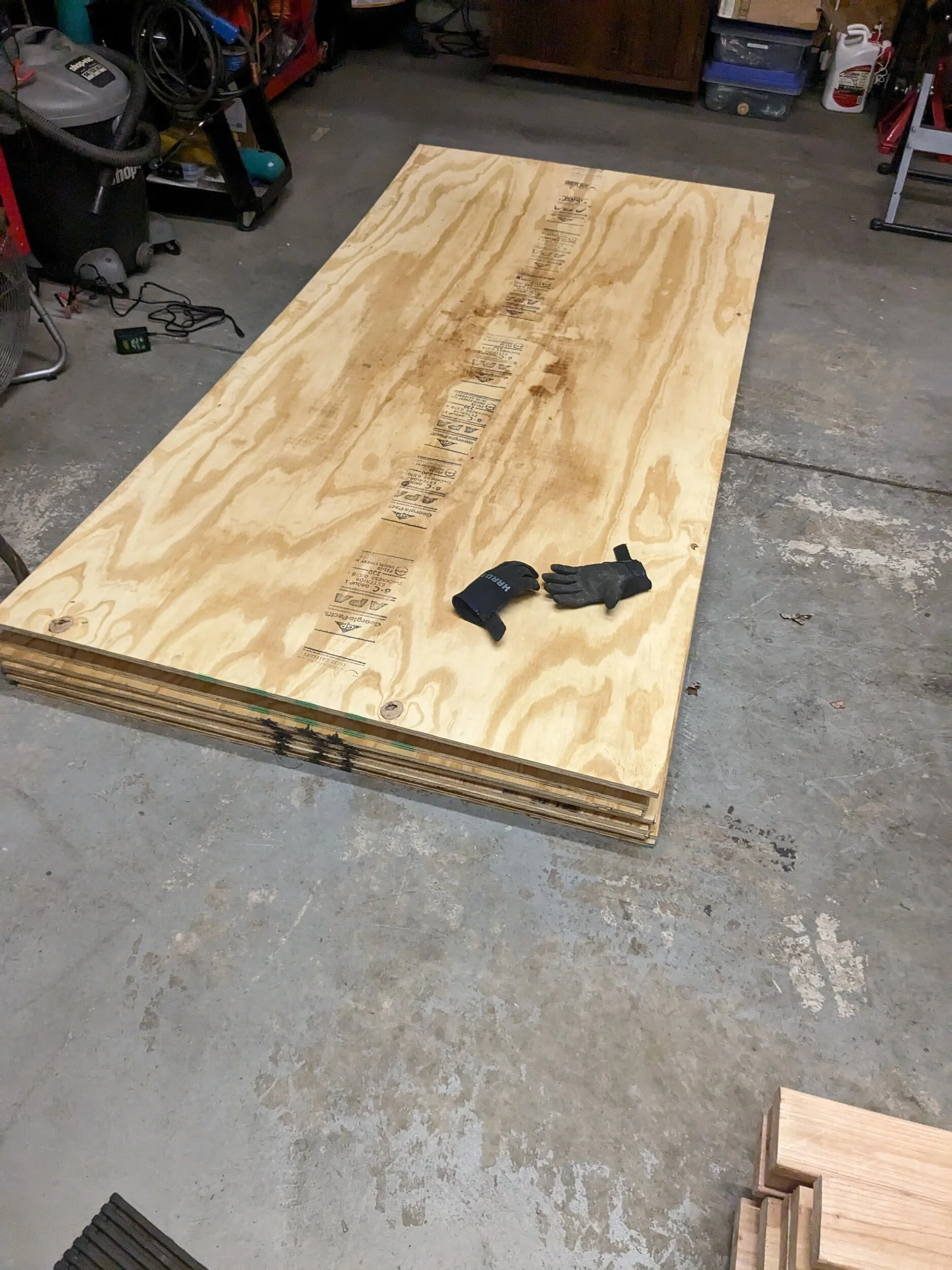

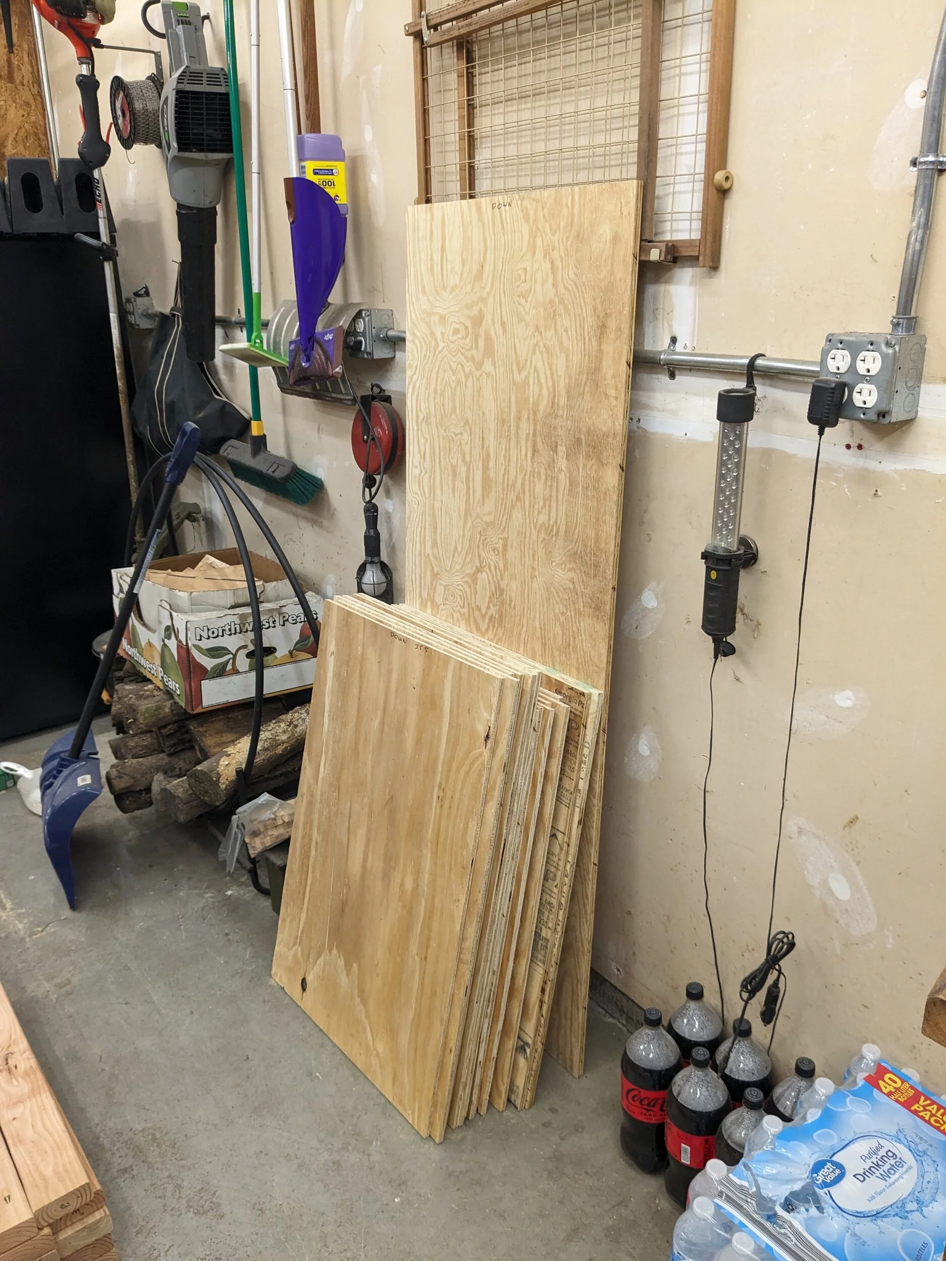

Cut down the plywood for the workbench top and shelves. I cut them a little wide and plan to use a router with trim bit to cut it to the final size.
Used the 4x4s to elevate the plywood. Having 2 lengths of boards on each side of the cut kept the board from folding-in and binding the blade.
Kreg's Rip Cut is a great adapter and tool for this task!
Pics are after I dry-vac'ed. The garage is covered in a file layer of dust that will get cleaned off as everything moves when I migrate to this workbench.

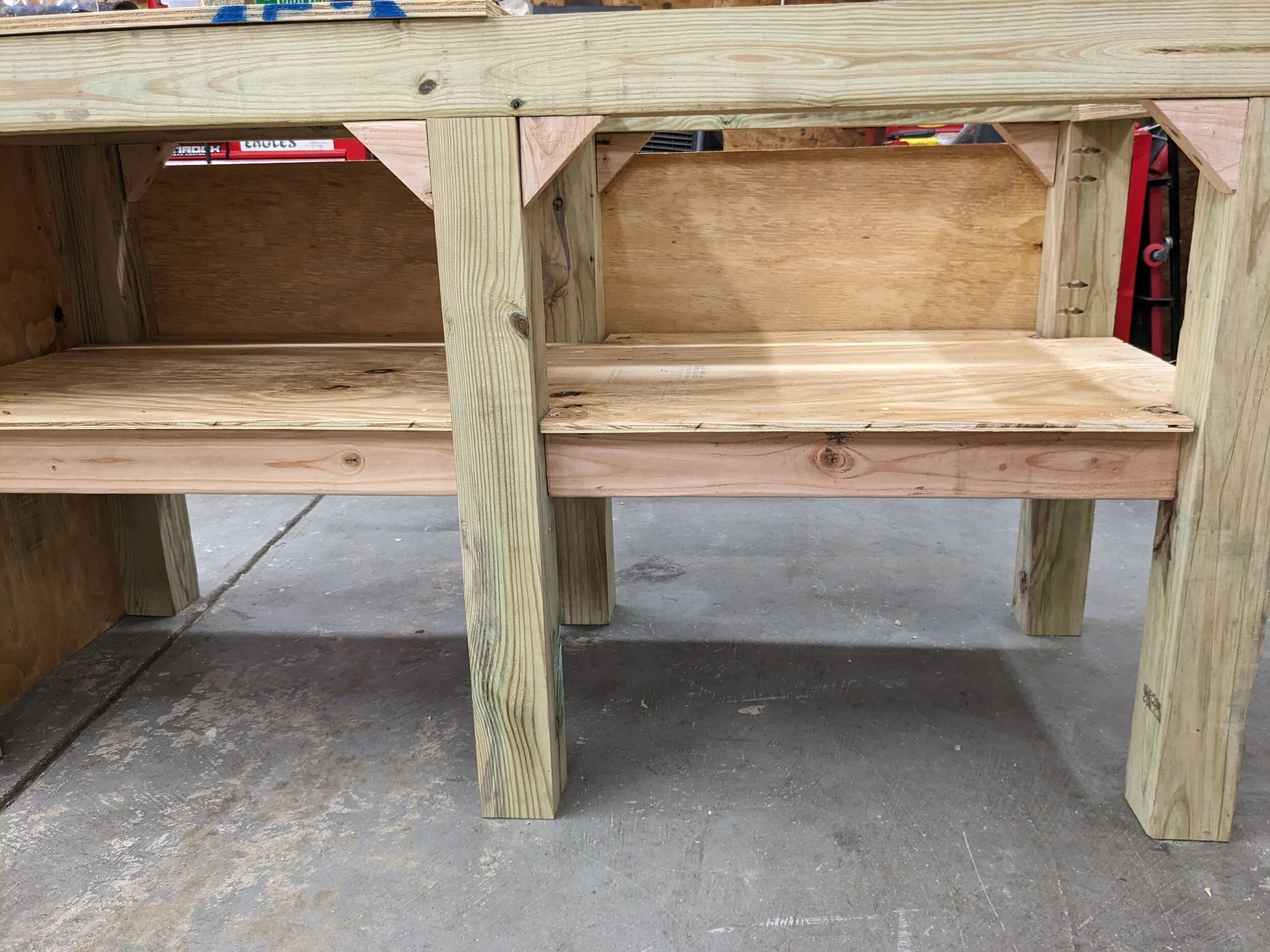

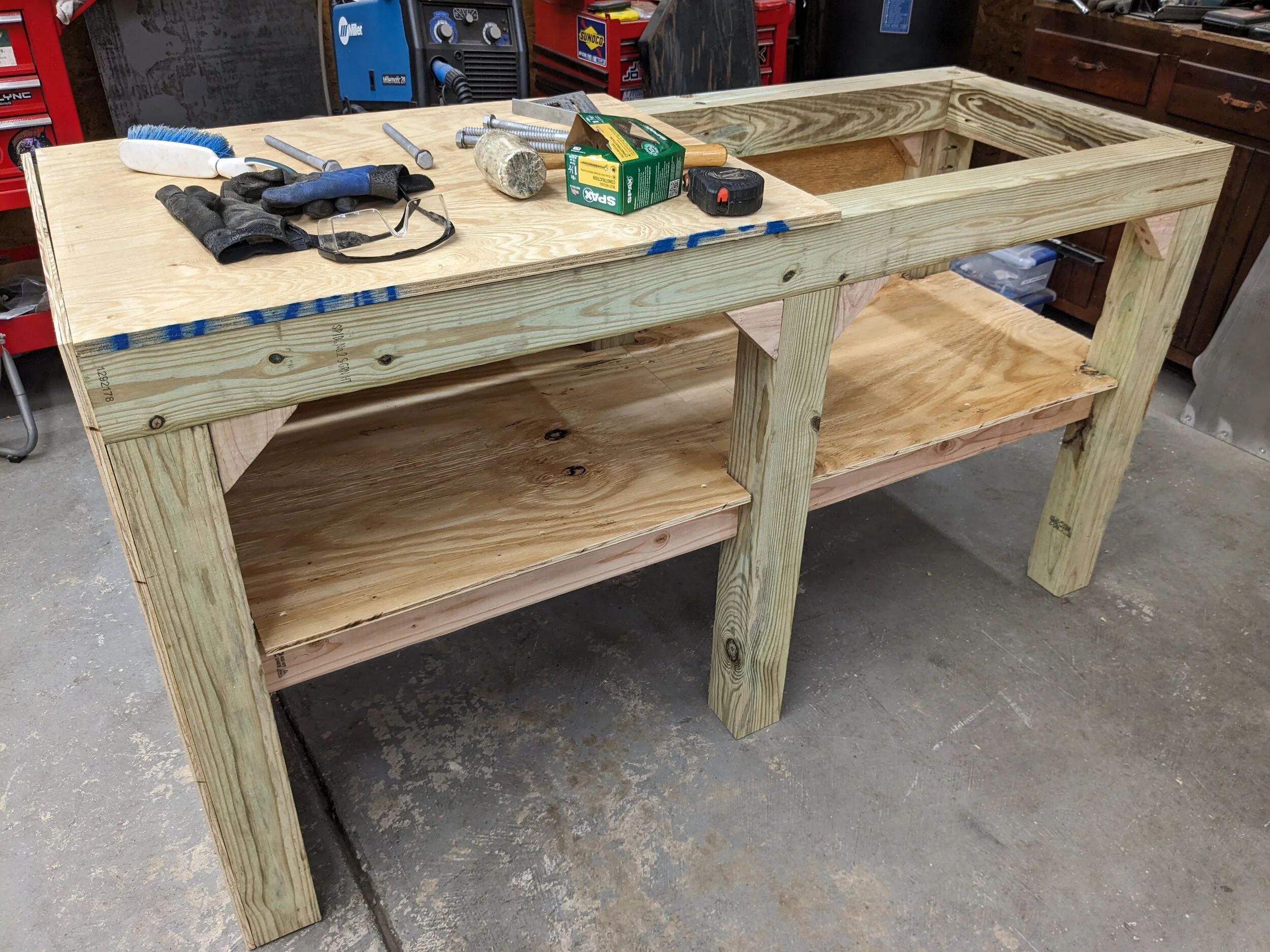

Got through Workbench #1 (left-most workbench section closest to the air compressor - design is basically 3 sections).
Used router to flush-cut the side piece to the top. Workbench top piece will be flush cut once both workbenches are joined together.
After ripping other plywood boards, I had this backer available and decided to save a full sheet and so this will be the backer for these shelves. The goal is just to keep items from falling out the back since there is a 4" curb in the concrete floor.
Back shot. The lower section is open to house my largest jack stands.
I'll be running 8" lag bolts from the top 4x4 into each leg to re-enforce the connection (likely overkill but they're already paid for...).

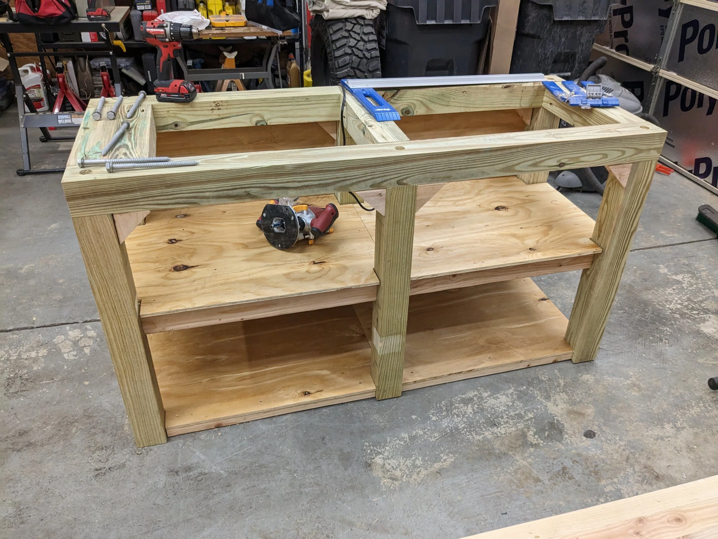

Workbench #2:
Doubled-up 4x4 is for where my vice will mount.
Base/lowest shelf is to elevate the shelved items to avoid collecting ground-rolling dust (dealt a lot with this an dog hair in the past).
