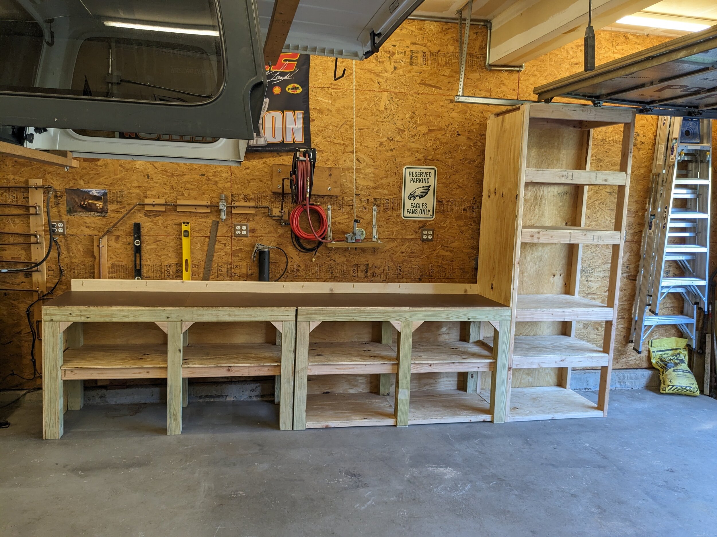

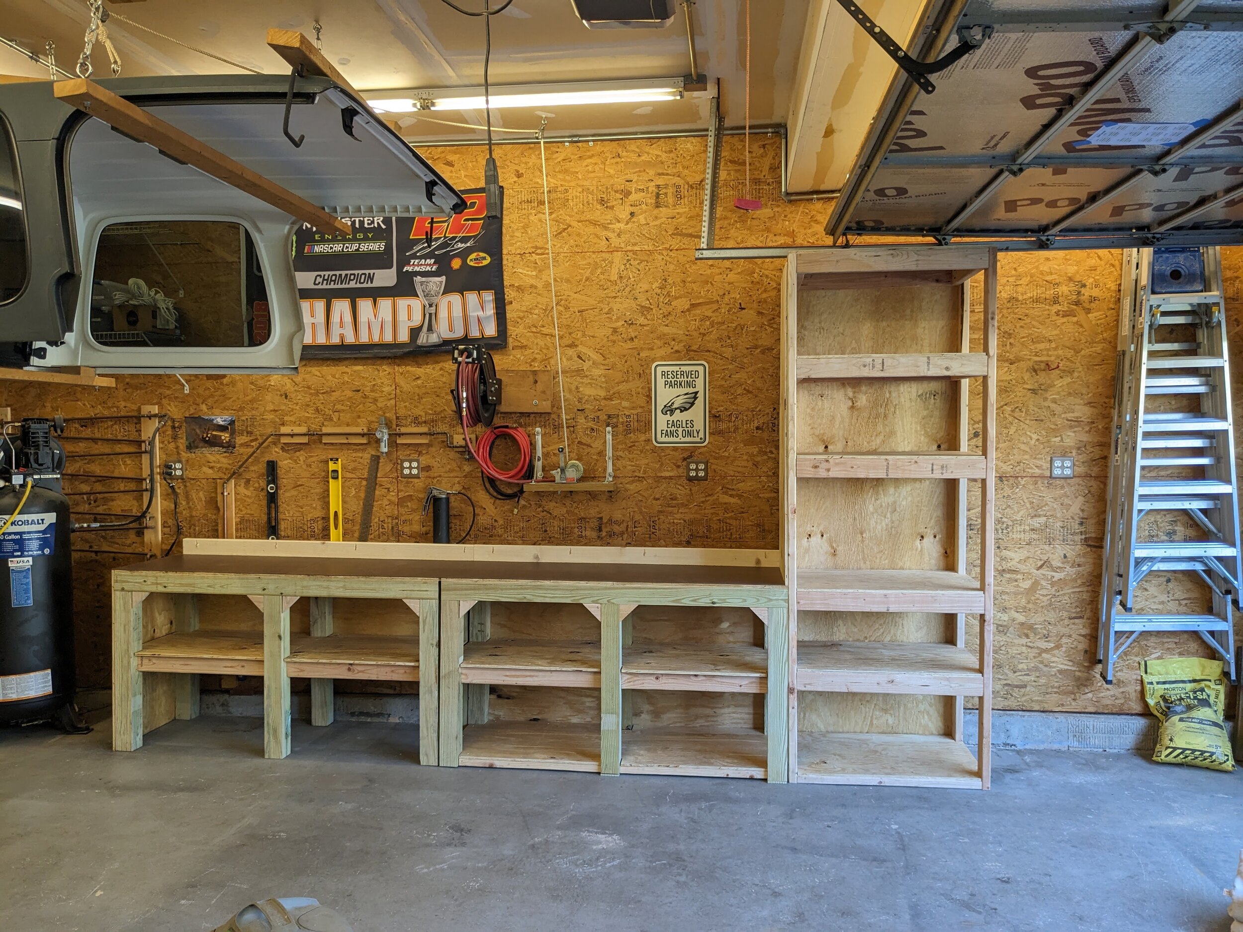

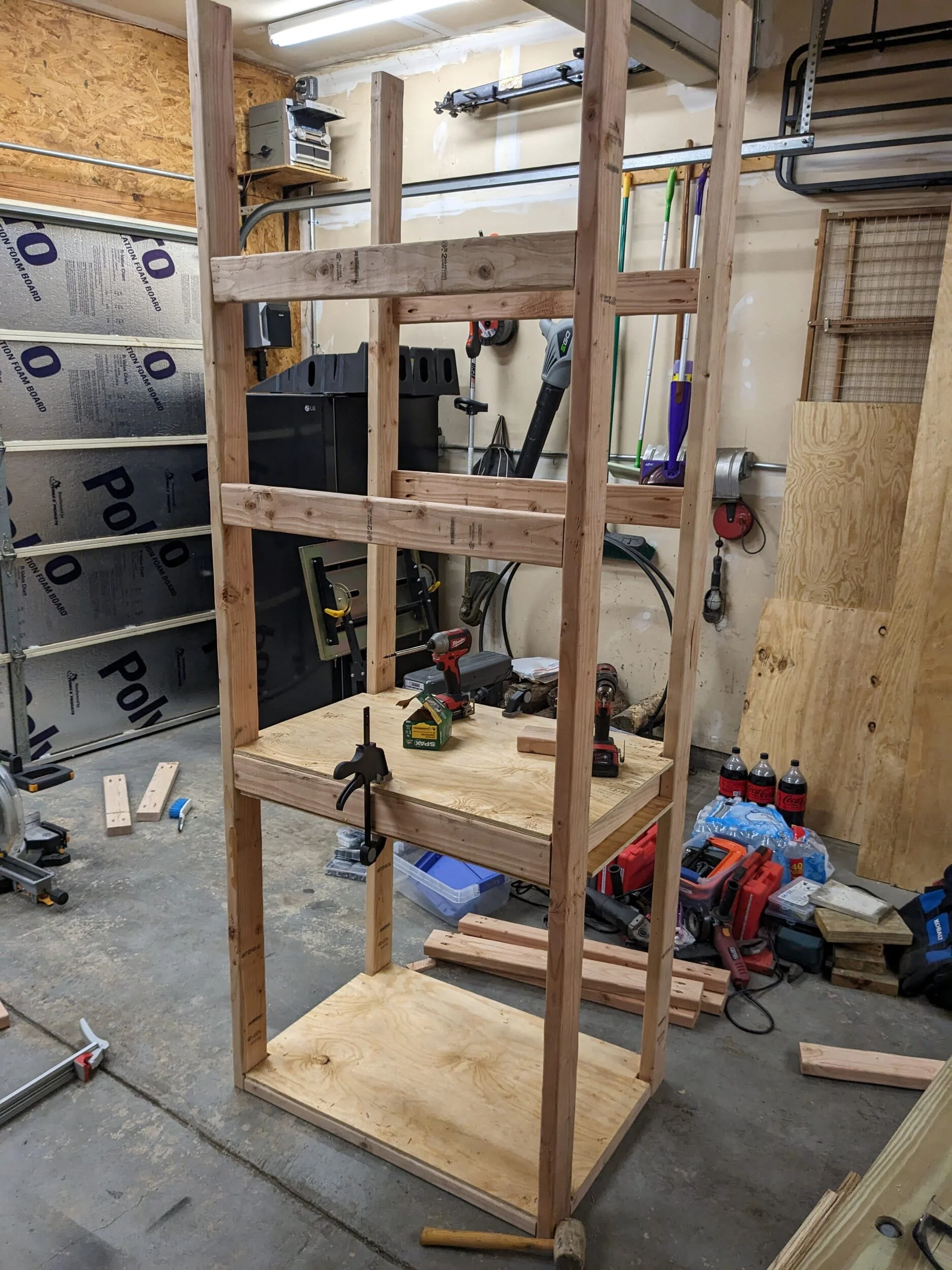

Built the shelving unit skeleton earlier this week. Today, I realized, I failed the first rule of building - read the blueprints...
I don't know why, but I designed the shelve 2x4s that are there for the 'depth' were designed to mount to the 'length' boards, rather than screwing directly into the vertical boards. So I had to disassembly a good bit of it and put it together again. I'll add a screw to secure them into the vertical board.
Today, I got the bottom self in and the third (mid-level) shelf installed. Squared everything up to ease the rest of the build.
The clamps are holding up the shelfing surface for the second shelf. Can't put the plywood in once the cross-support 2x4s are installed. So that's up next to finish the shelving unit.
Weekend goal is to have this project finished... We'll see how far I make it.

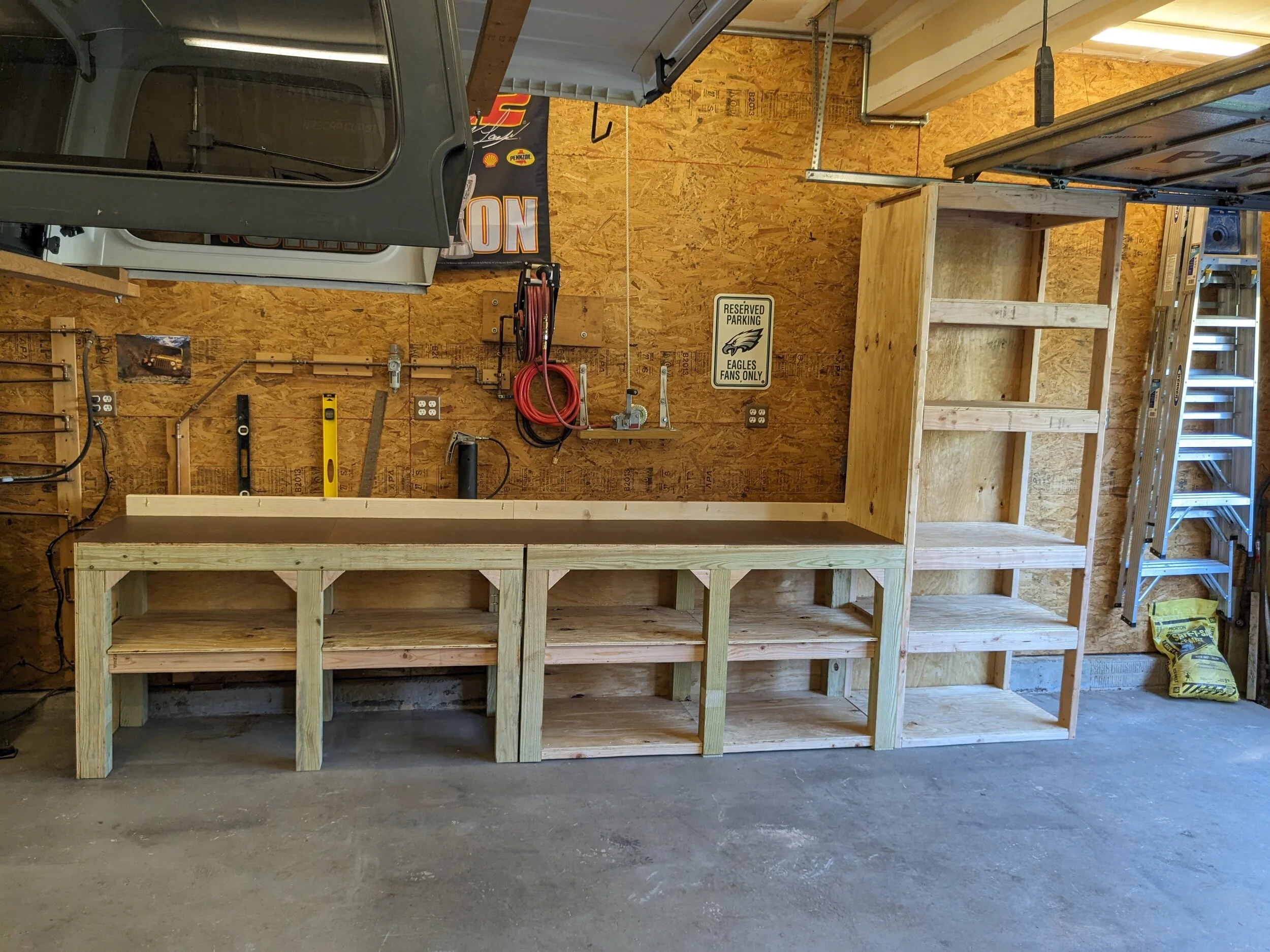

Big day today....

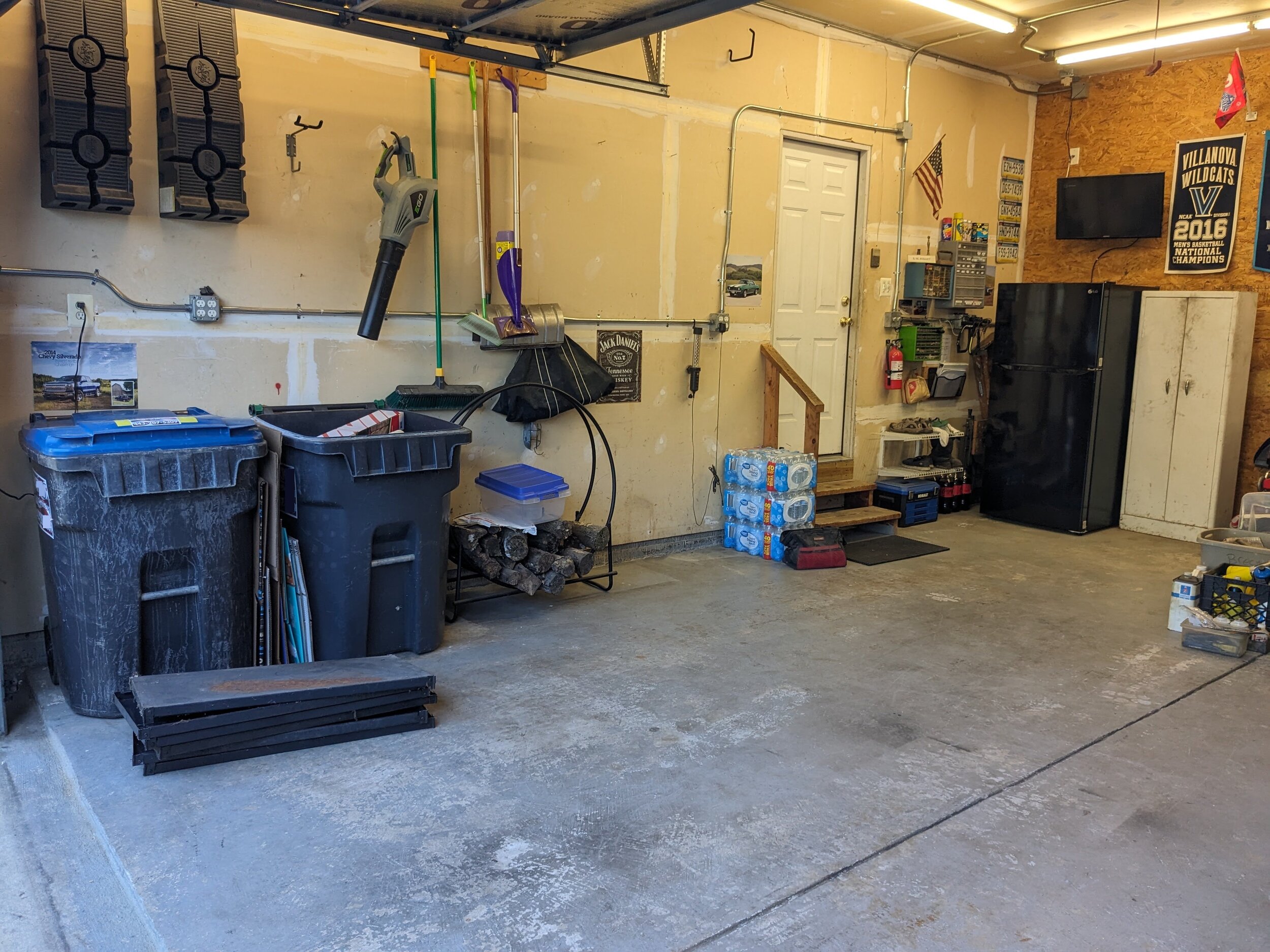

Started off with the garage looking like this:

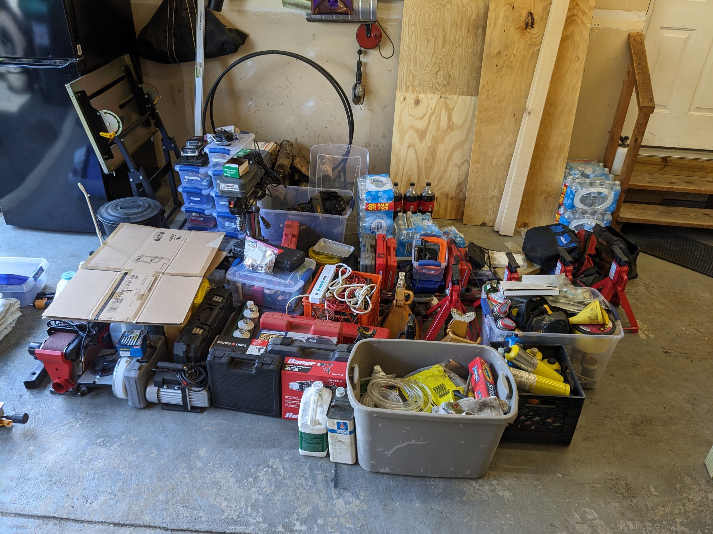

Moved a number of items to the basement and shed and pulled items off the shelving units that the new workbench is intended to replace. Looked good when everything was emptied out.

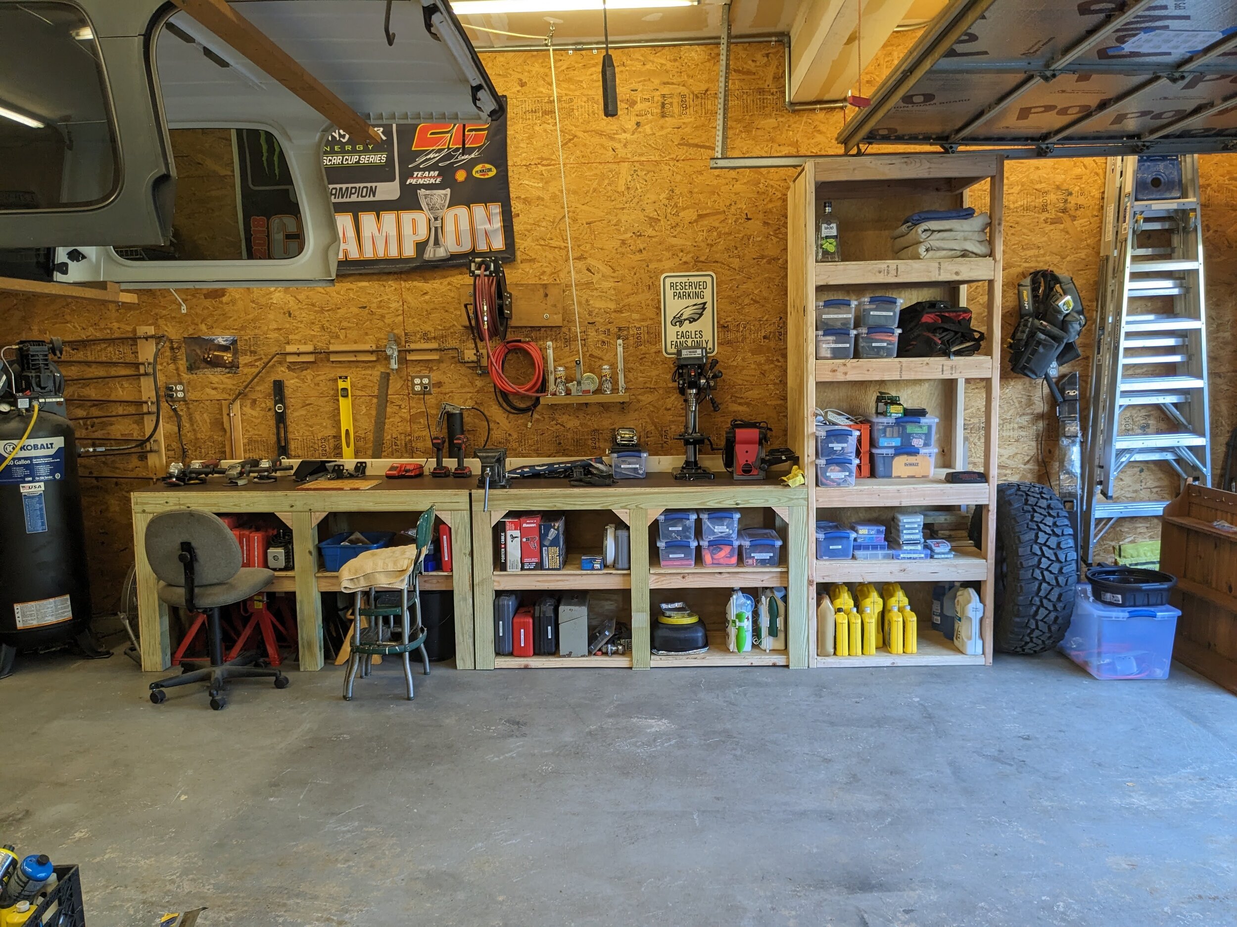

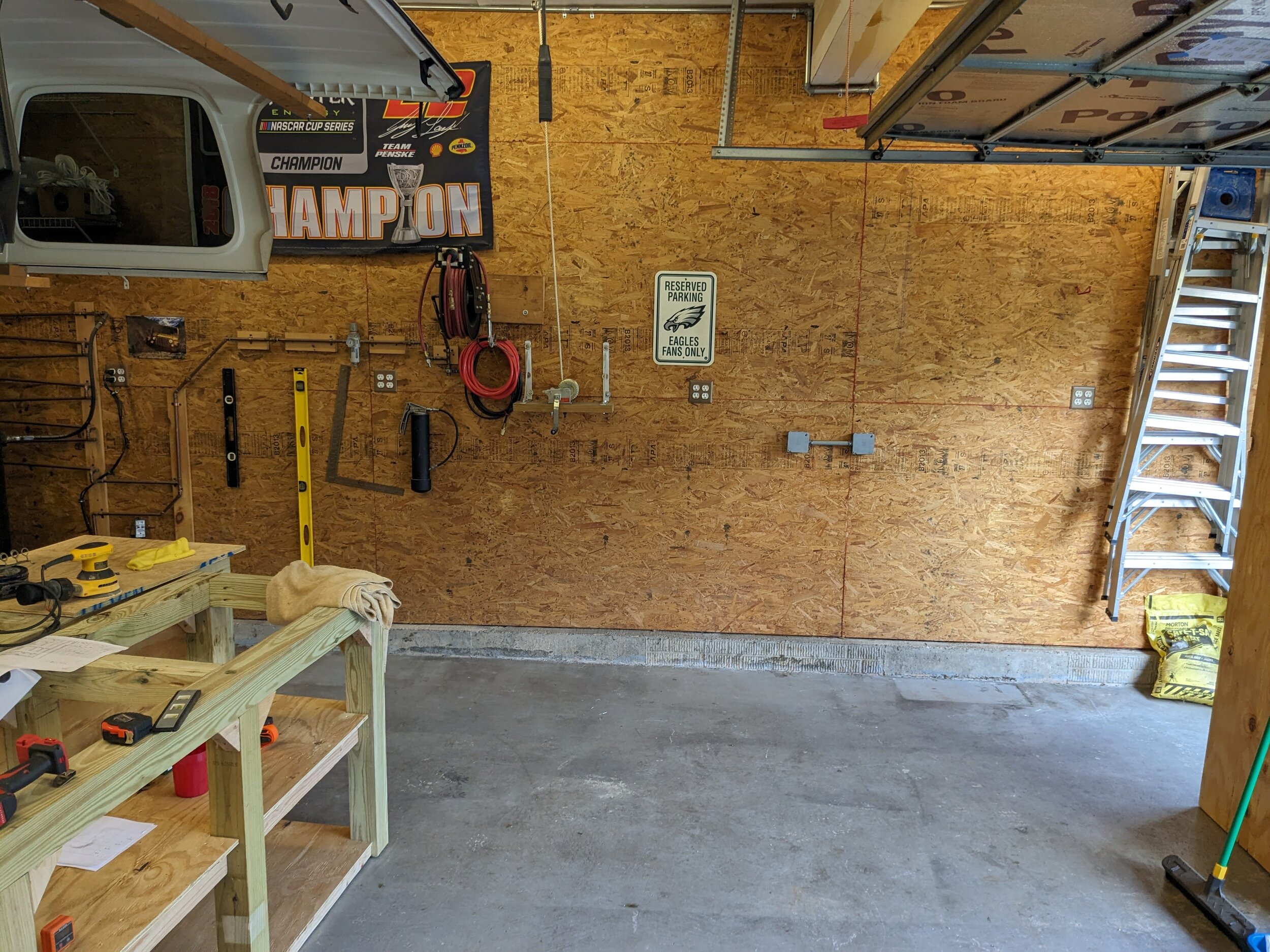

Moved the workbenches into place. Used a laser level to set the workbenches square.
Ran out and grabbed hardboard for the sacrificial workbench top.

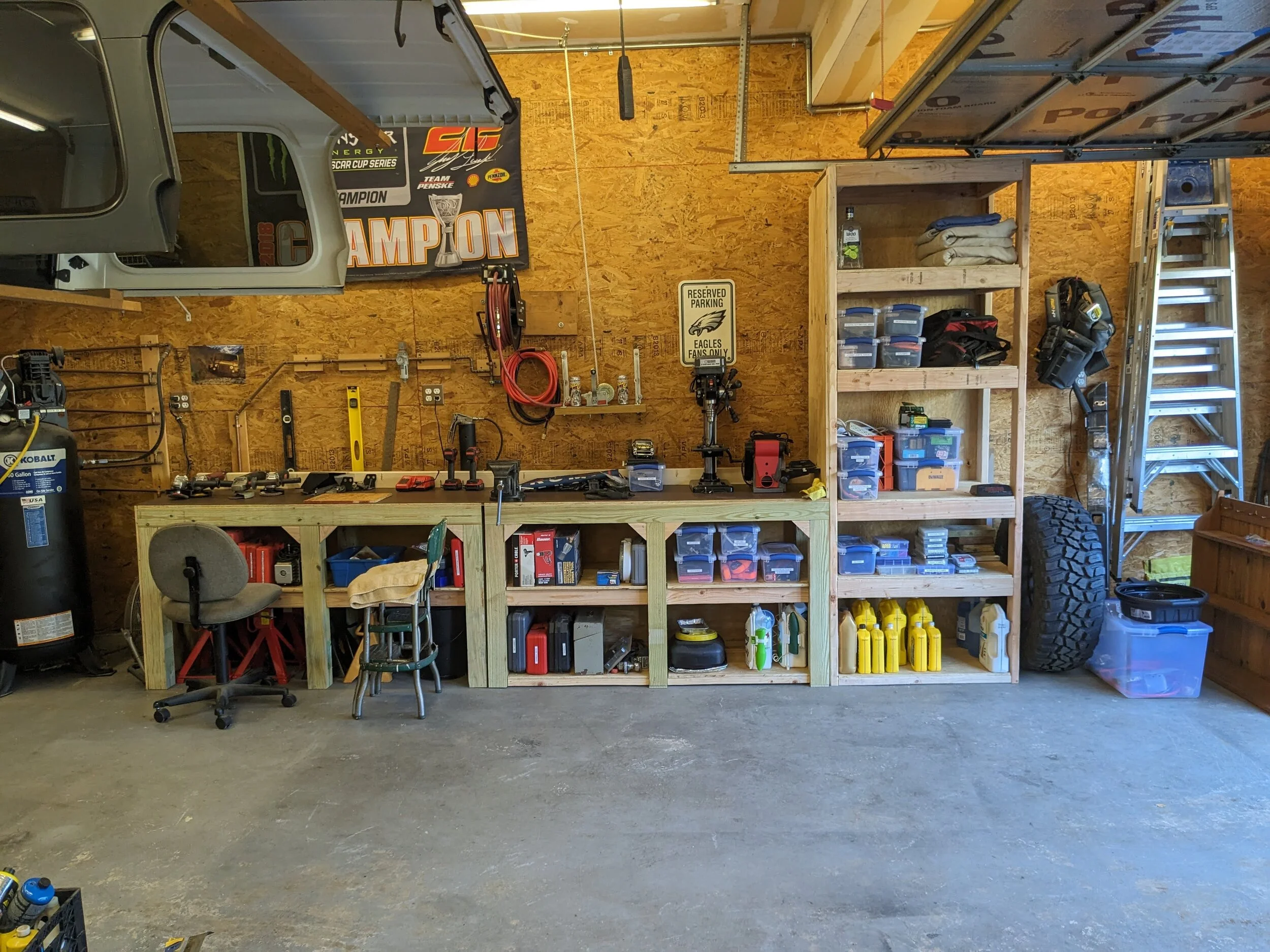

Damn this project came out exactly how I was hoping!

Next task was to load all this up onto the next workbench & shelving unit. Pulling all this off the shelves reminded me that I never want to move again... :ROFLMAO:
Looking good!

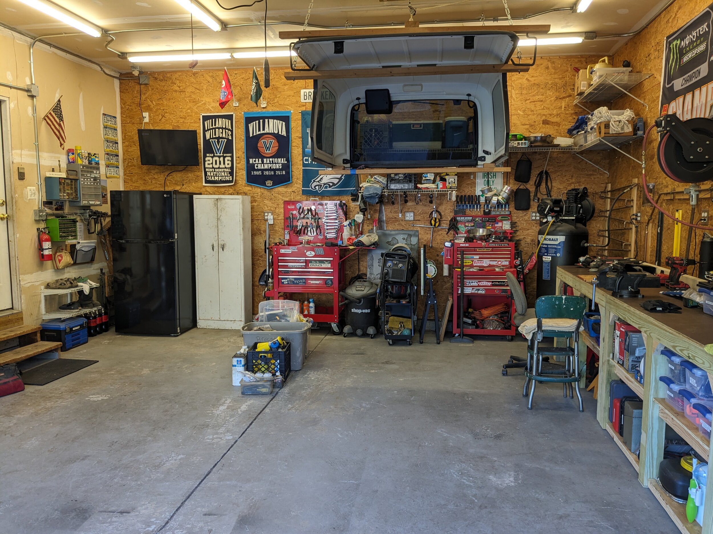

Rest of the garage laid out as planned in the models shown in the first posts of this thread.
Boxes in the middle of the garage hold items to go in the (currently empty) white cabinet. Ran out of time for the day.
Very happy how this turned out!
Now it'll be the little details. I have a plan for the drill/impact driver to mount on the wall. I still need to come up with a plan for the grinders... Thinking perhaps mounting them on the board against the shelving unit - but that's a very initial thought.
I want to keep the workbench surface as empty as possible - I need to keep reminding myself that it's not a long shelf!

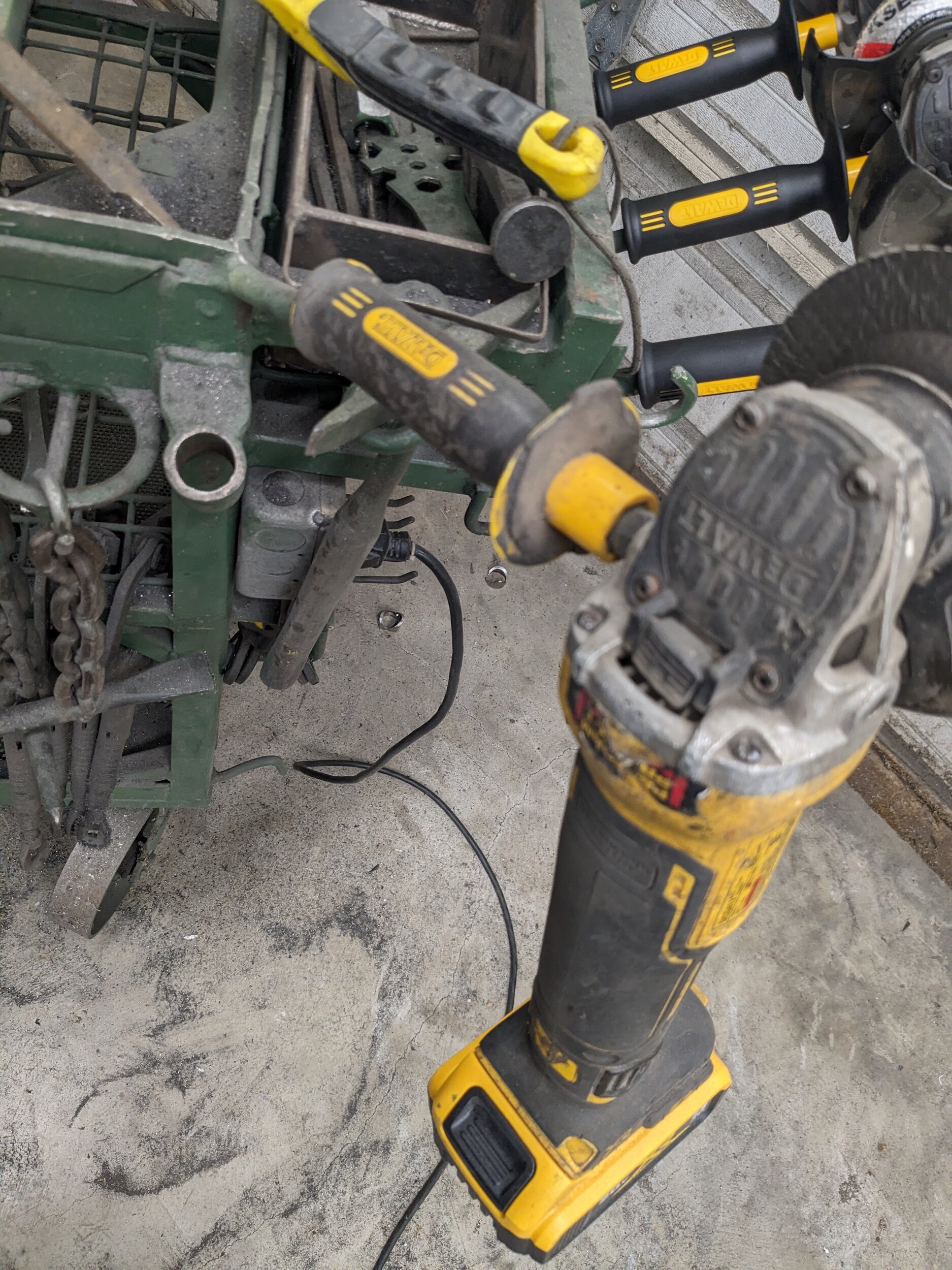

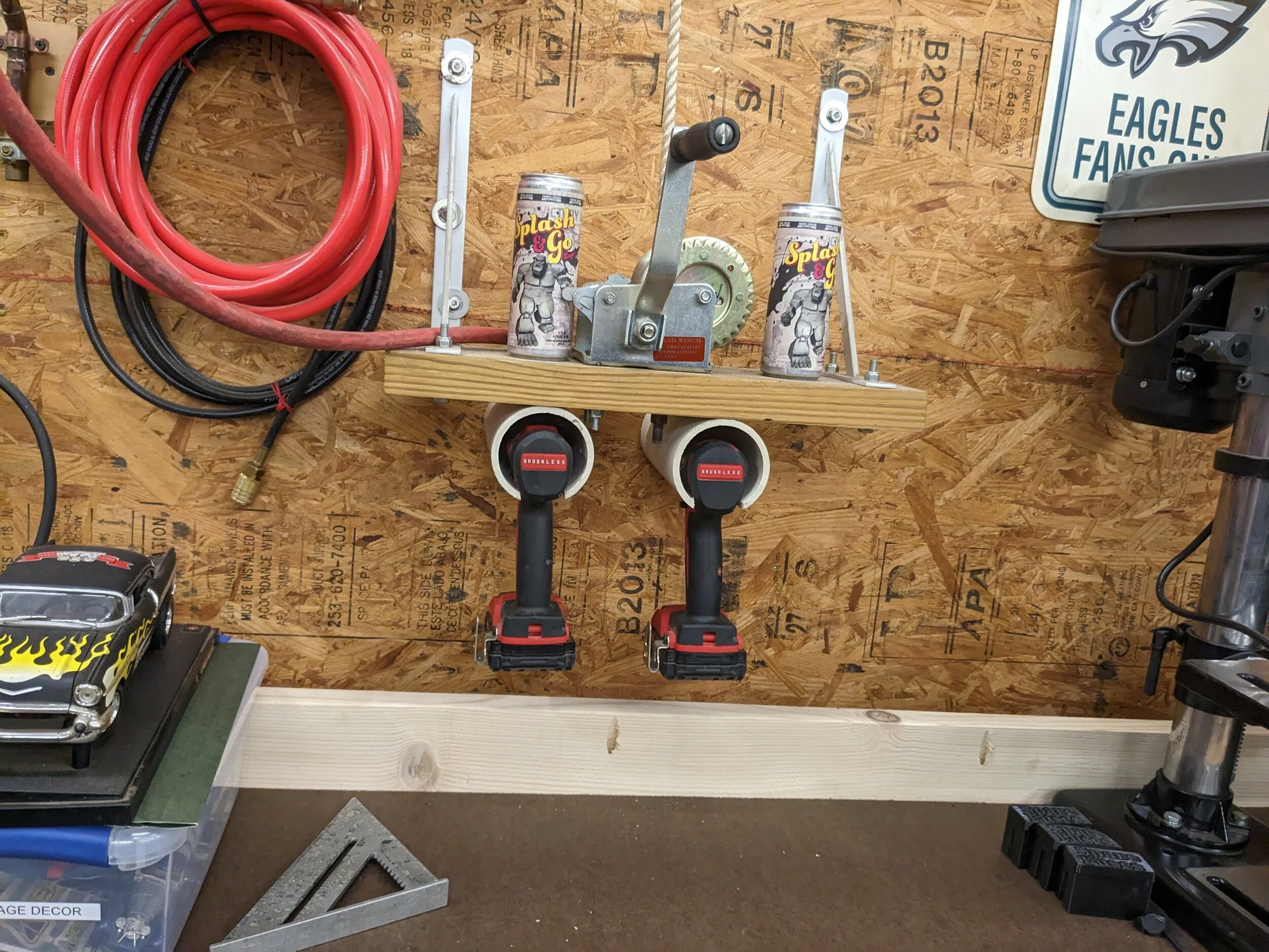

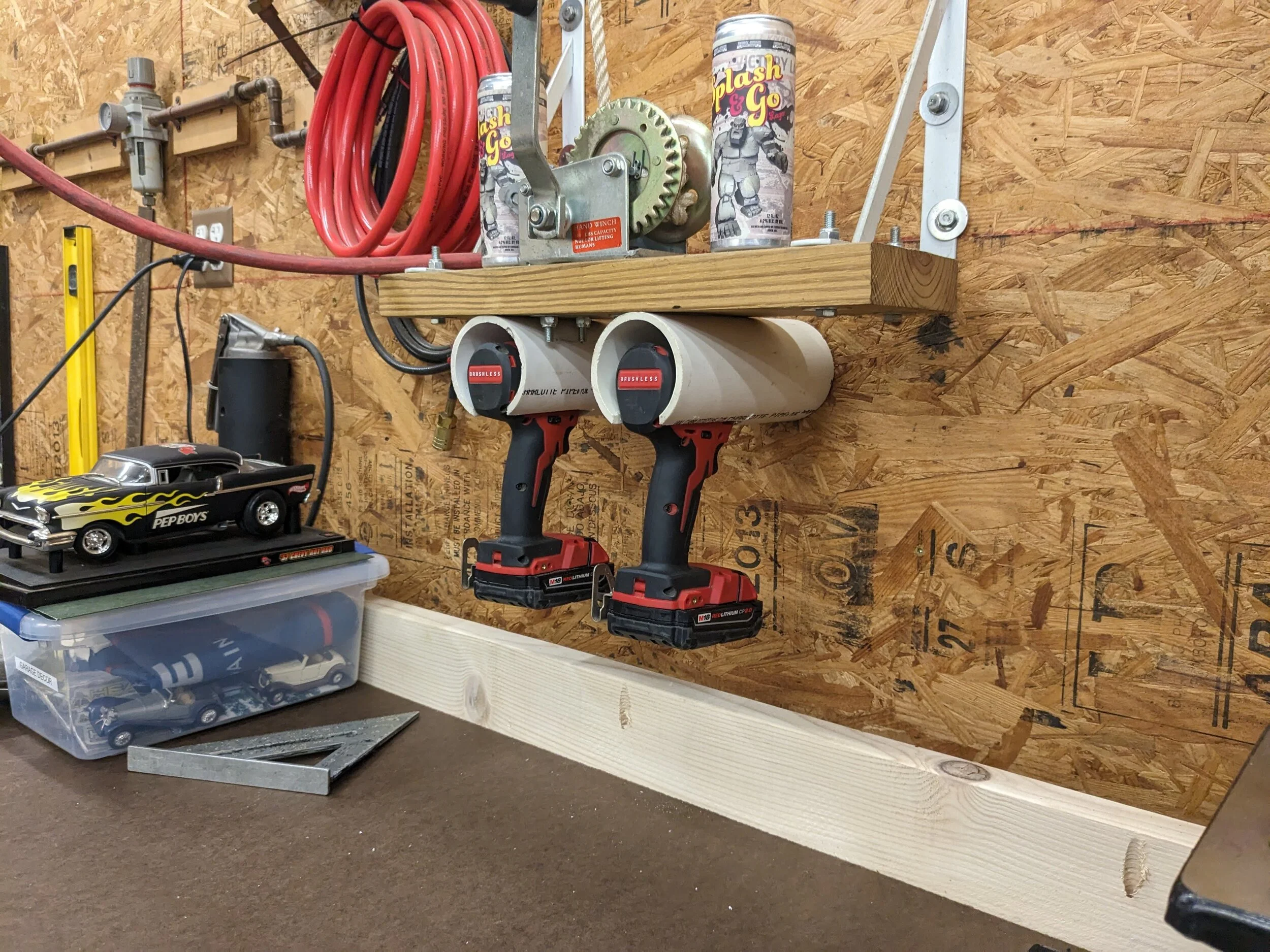

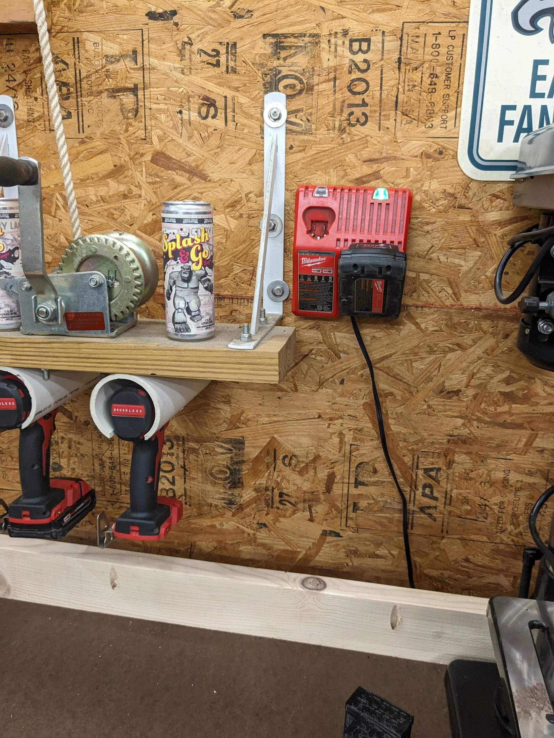

Mounted up the Drill/Impact Driver. Quick work with the oscillating tool and drill.
Threw up the charger nearby. I'm surprised how tight the mounting holds actually keep the charger in place, considering the clamping grip of the charger on the battery.

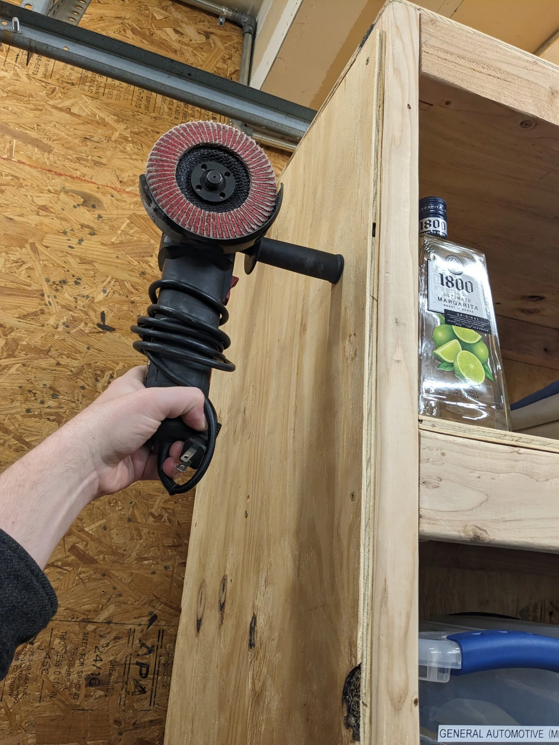

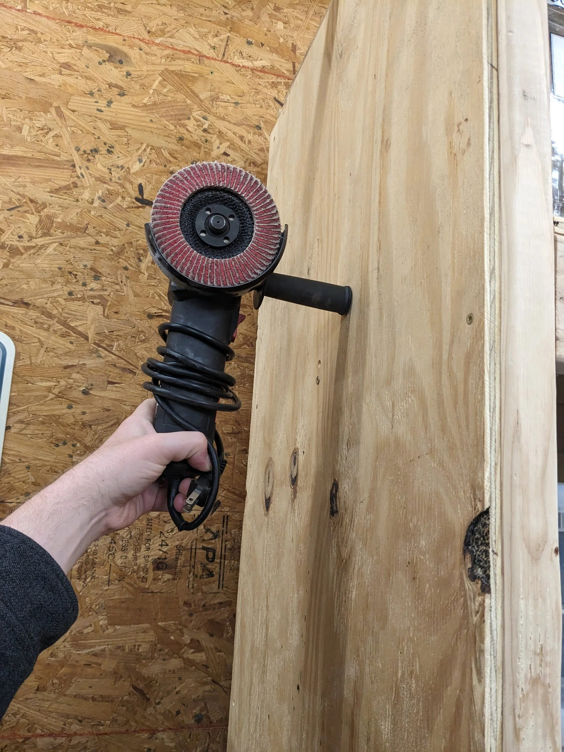

Still working on the best grinder mounting solution...

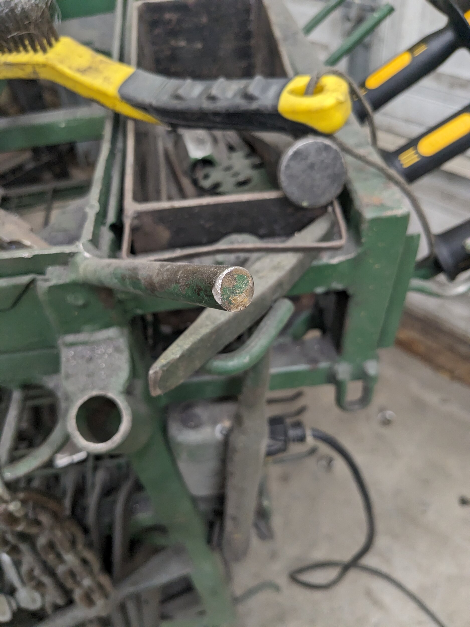

1/2" piece of round bar works best for me. You could probably use anything that fits into the handle. Best part is it's cheap & you can make a bracket to mount it anywhere.
  • Wow
Reactions: FarFire70
Mind blowingly simple option.
The area next to the shelves I'm considering are elevated and I can't walk past and hit the grinders. Really interesting option - Thank you for the idea!
I learned that from an old fitter I used to work with. He'd laugh at all the young bucks going out & spend $$$ on some fancy grinder holders. Meanwhile he spent $10 on a 3' stick of round bar, cut it into several pieces & weld them to his tool cart, work table, saw horses. If it was in the way, he'd cut it off then weld it back on some place else.

What is that hand crank winch used for?

Really liking this 1/2" round bar idea more and more...
Did a quick reach and test of where they'd end up and the grinders would be out of the way and very reachable.
I have plate steel for the mounting & backing plates already so just need the round bar. Looks like I have a weekend project...
