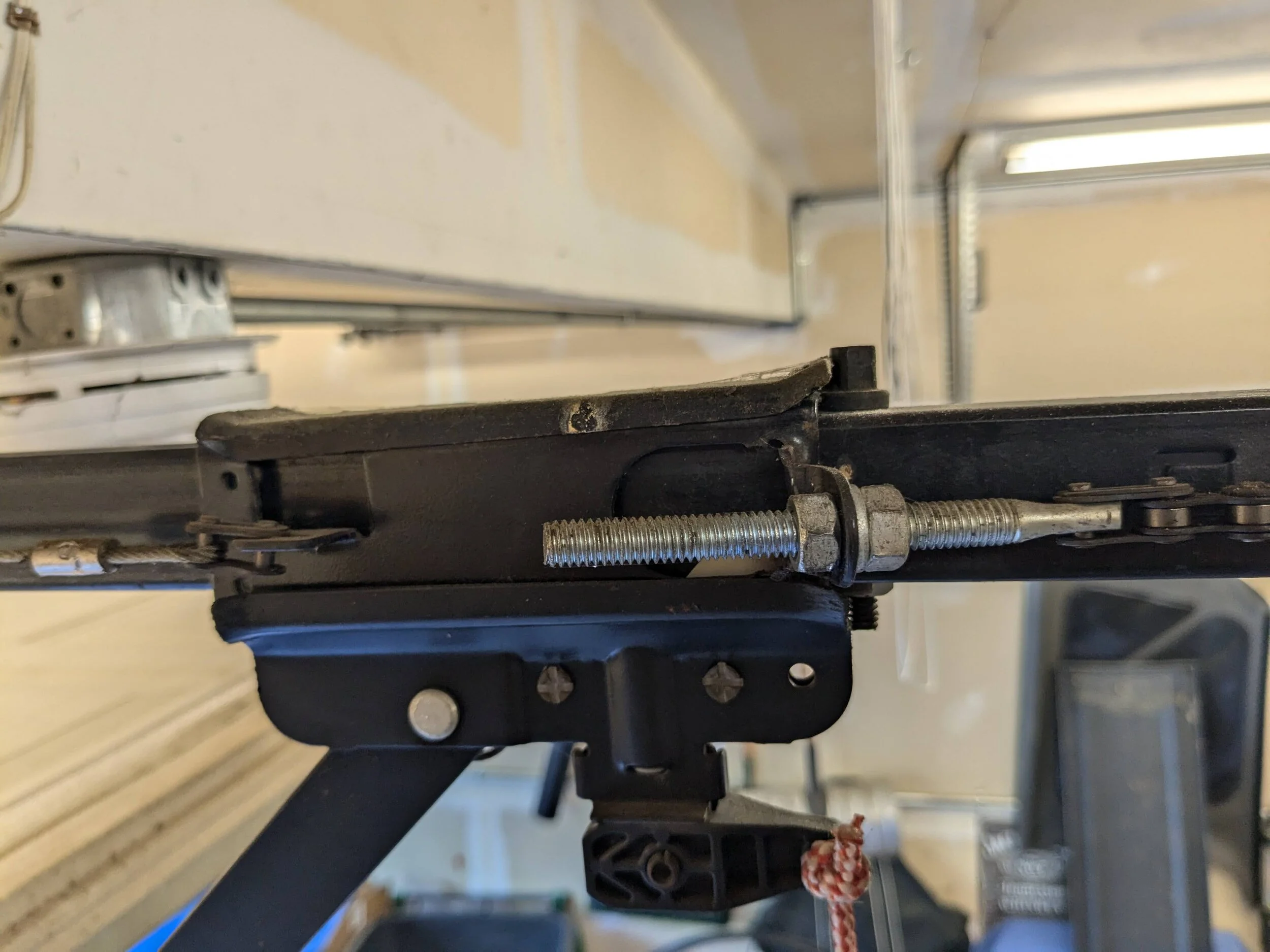

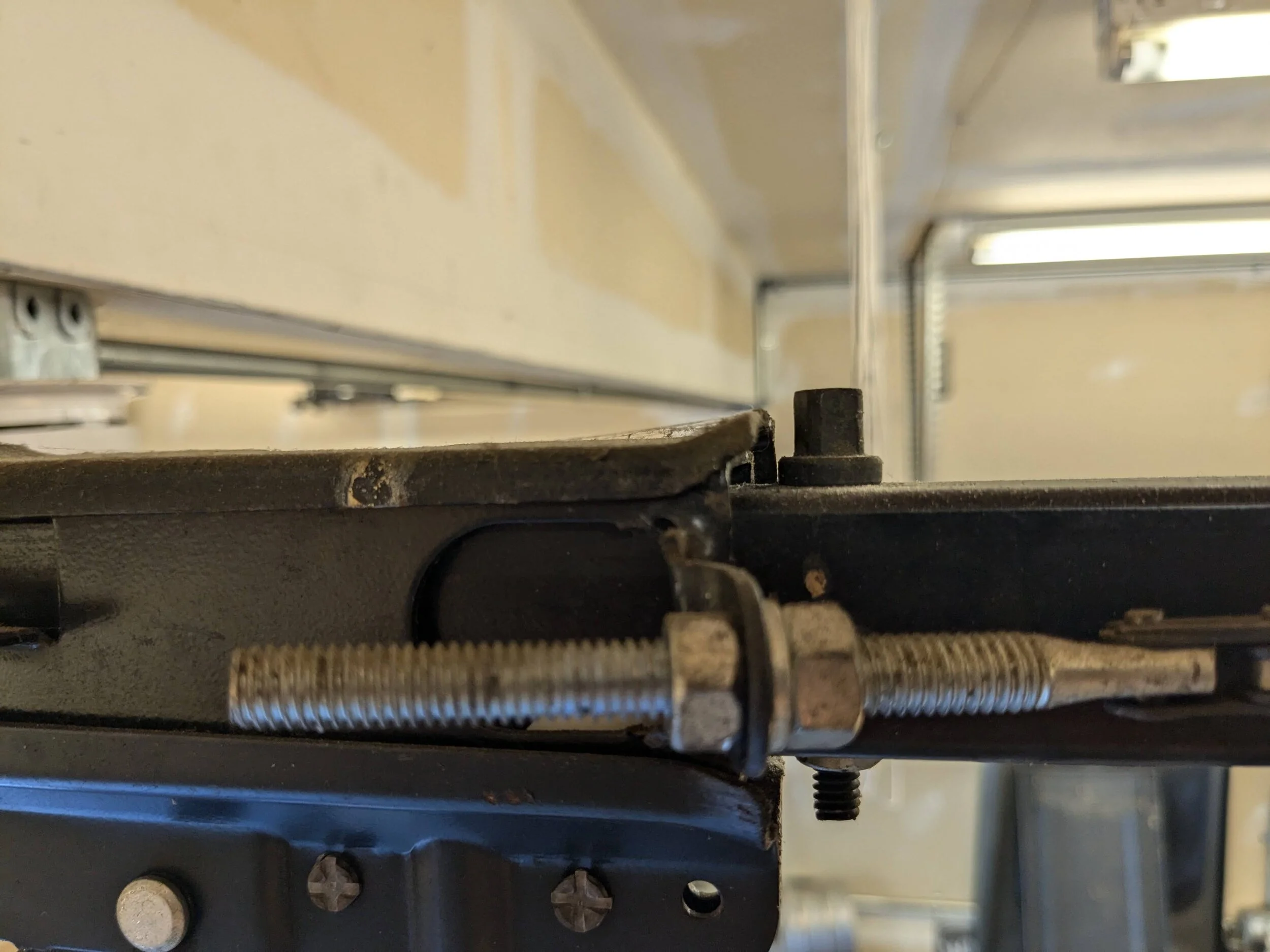

Finished off the time in the garage adjusting the garage door. It was approaching 95* and about 300% humidity. 😅
I had adjusted the up/down travel and the pressure/tension of the opener after installing the insulation a year or two ago. I noticed recently the door really slammed open and found it was hitting a bolt and stopping due force rather than set travel distance.
Adjusted and now it stops here:

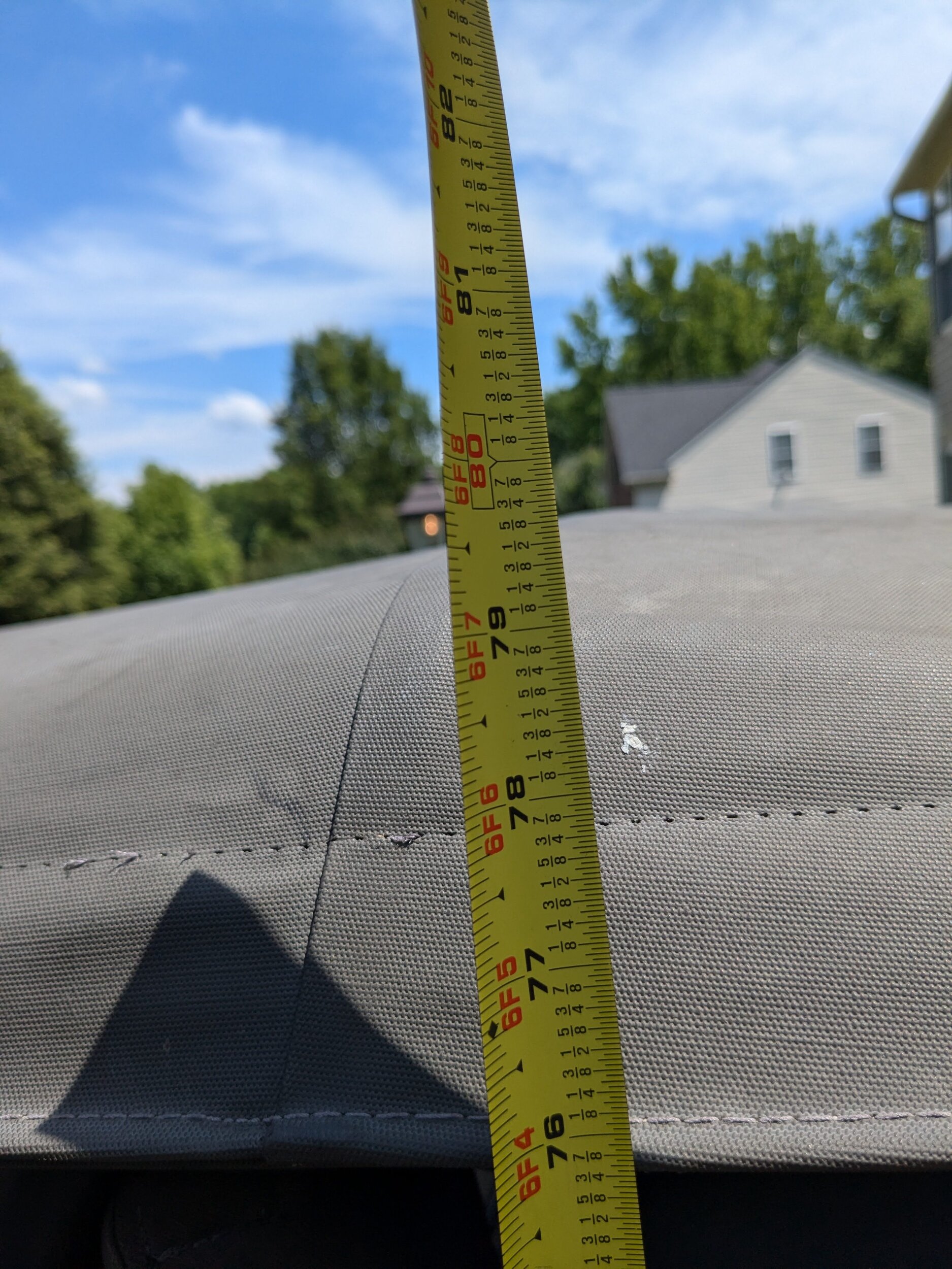

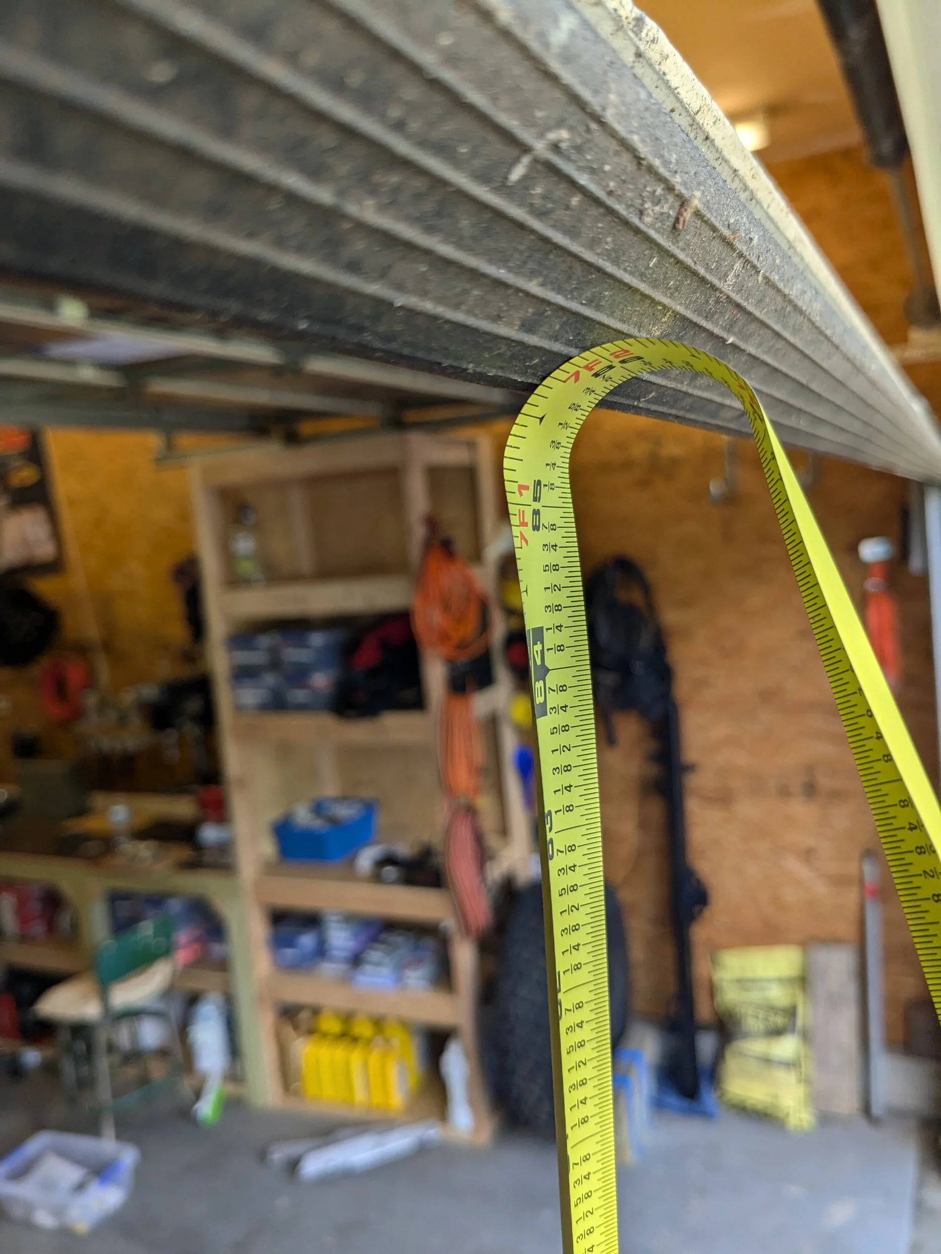

Gives me 85.5" of clearance:
And the Jeep looks to only need ~80"

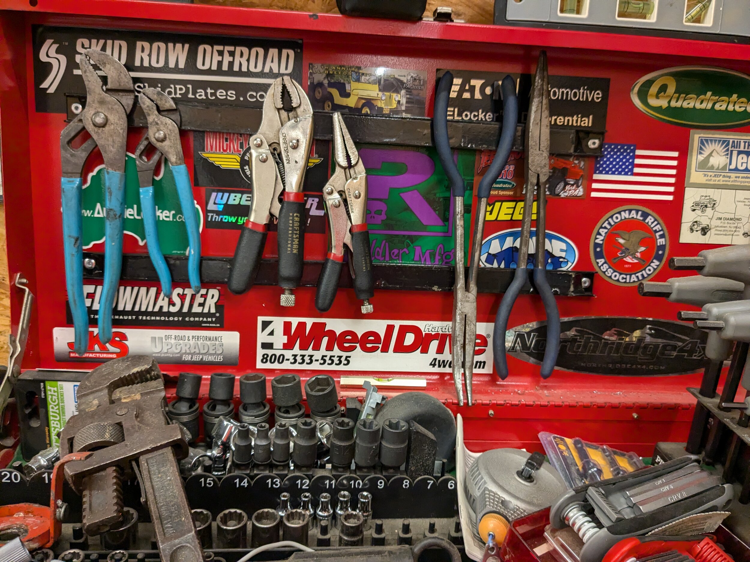

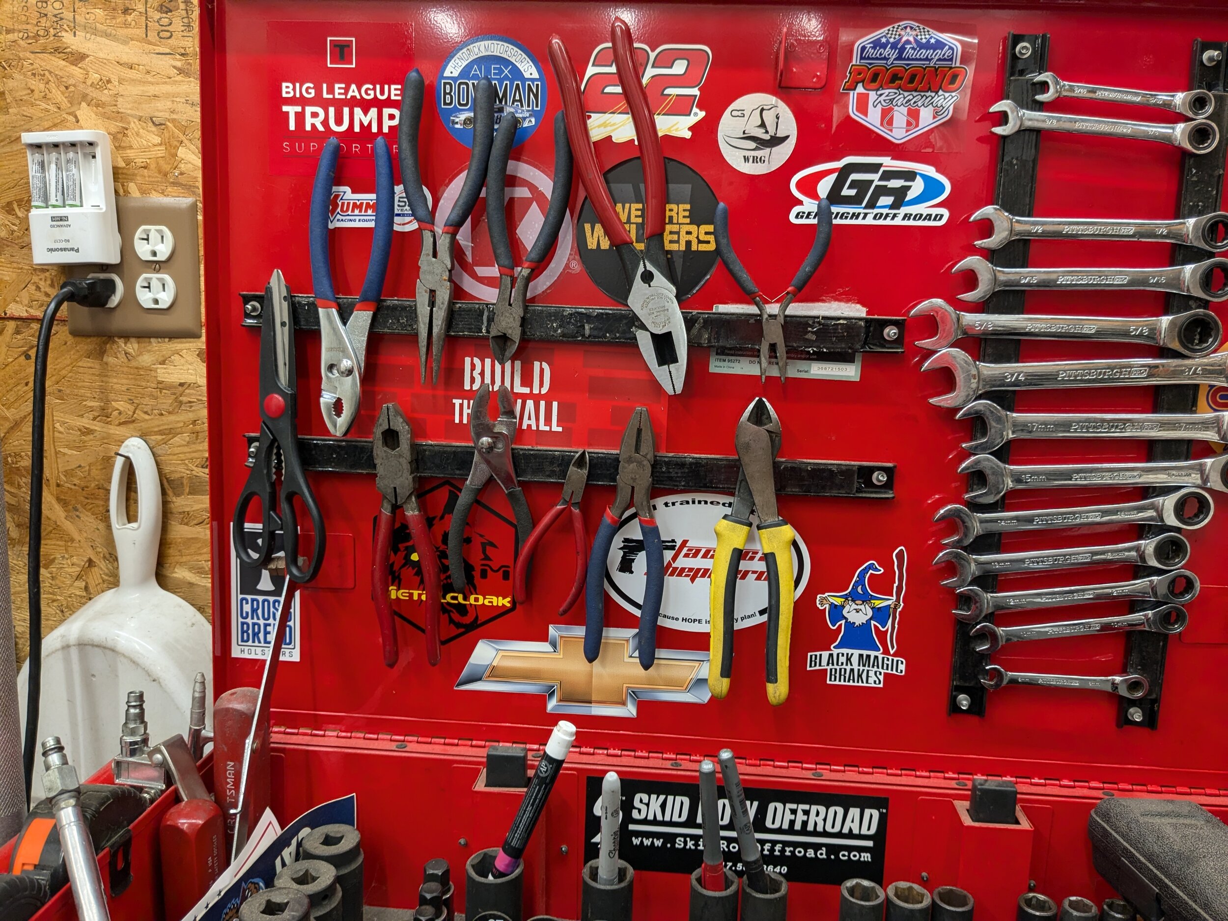

Added some of spare magnetic mounts to the tool chest to alleviate confusion on the tool cart.
Breathing room on the tool cart:

Does this mean you're getting a 4" lift?!?
I just put on 4" of susp and moved from 33s to 35s. That measurement is post lift & tires...
Love you guys here -> but can I get that setup dirty once before you bump me up to 37s, new axles, and another inch or two on the suspension? :ROFLMAO:

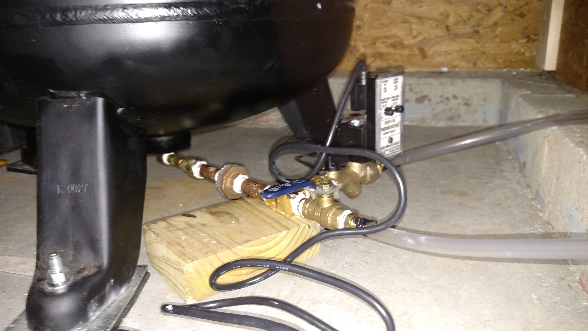

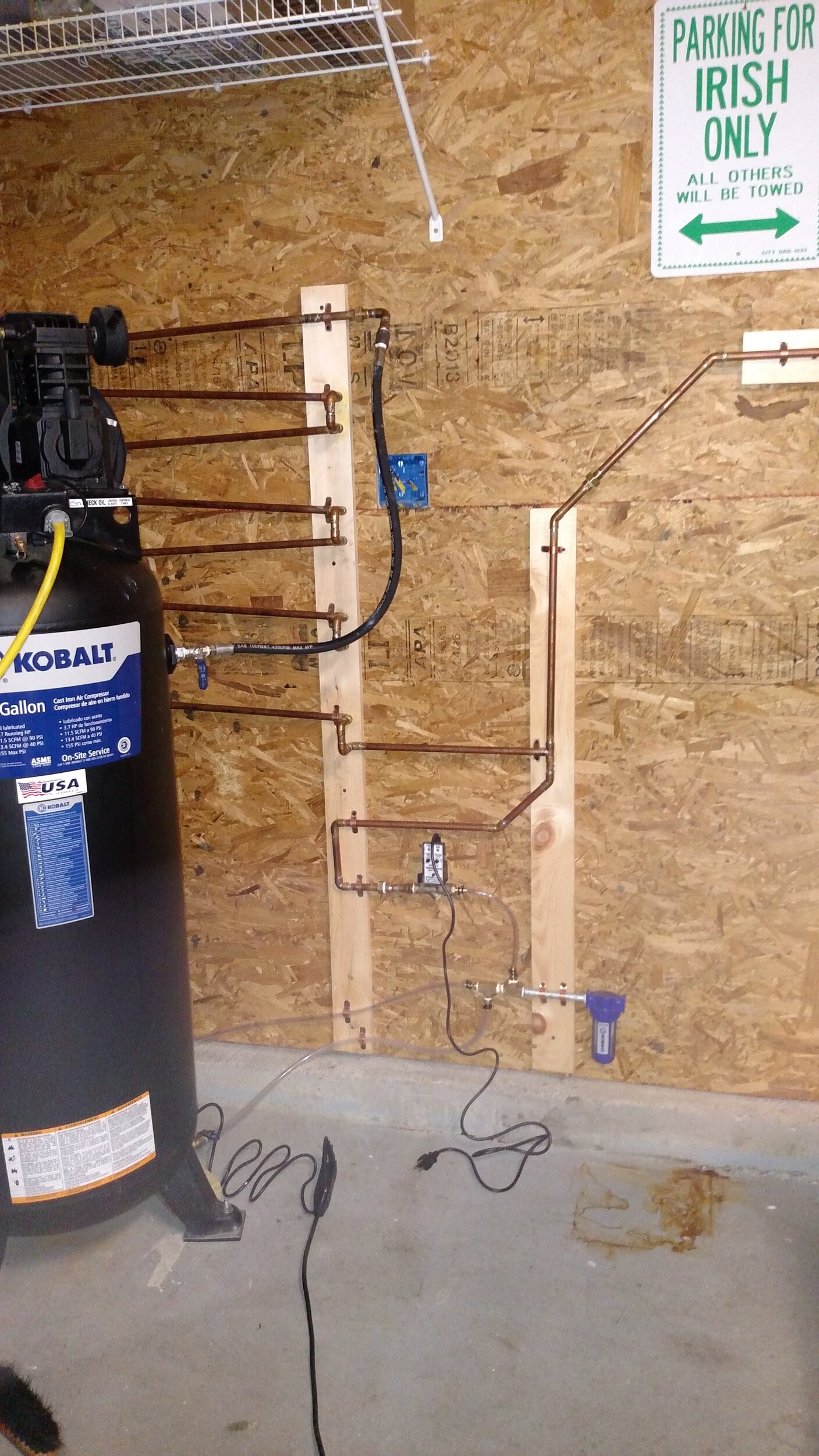

Yup that's the air compressor and not likely to move with this update. It has a pretty extensive copper line to chill the air and condense water out of the air for tool longevity & help when I get around to using it for painting. I live in a pretty humid area.
Tank & lines have auto-drain valves that run for 8-10 seconds to get rid of any water and drain the tank when I'm done with the job. Both are run through a water separator (you can see it at the bottom of the first picture.)

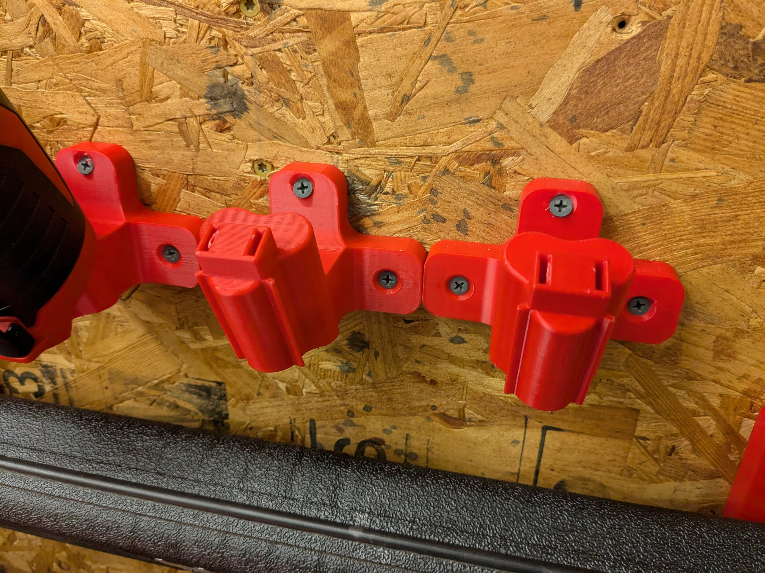

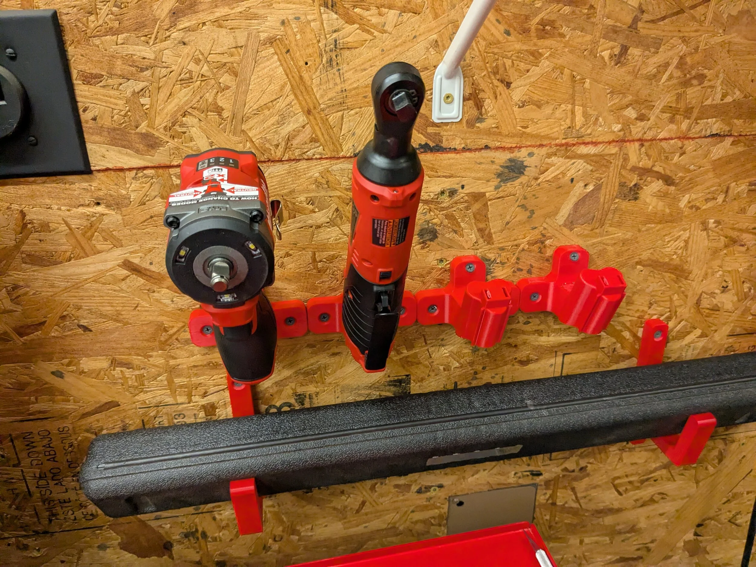

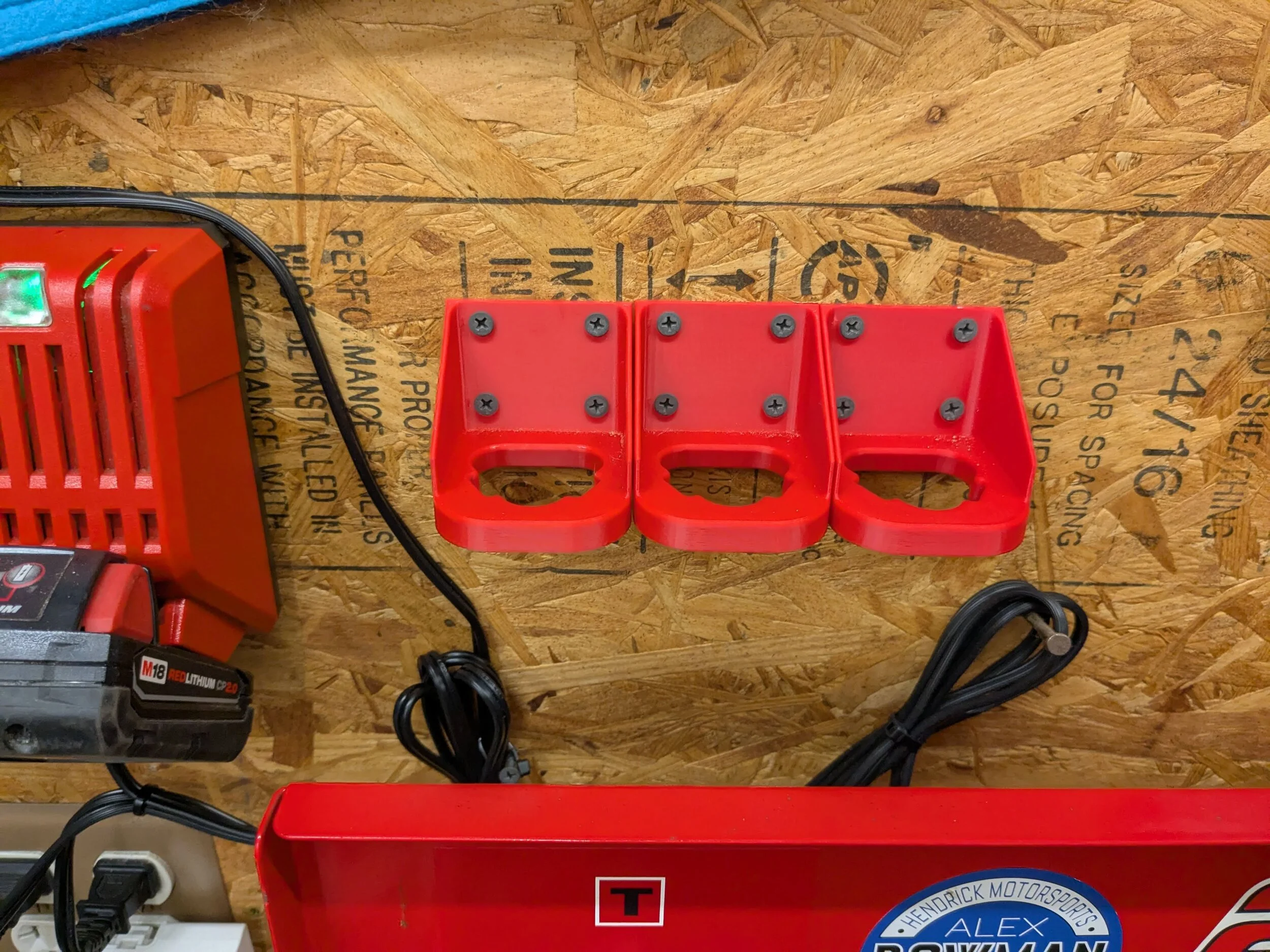

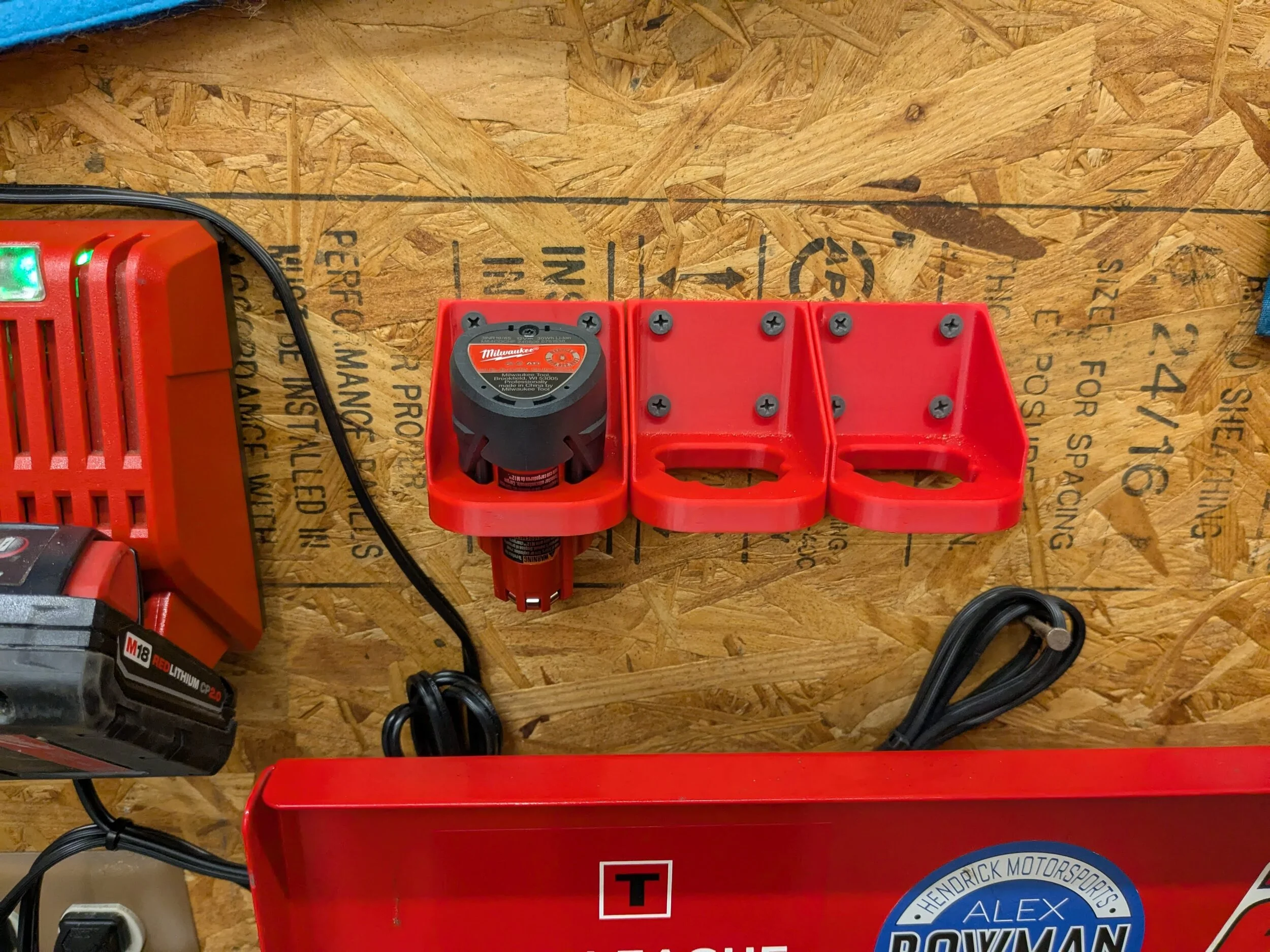

Went to M12 tools recently. Needed a storage solution.
Printed off some mounts in PETG-HF on Bambu X1C:
Also printed battery storage in the same material:
Pulled both designs from design from either Makers World or Thingiverse — I looked at a bunch so I can't recall exactly where these came from to link.

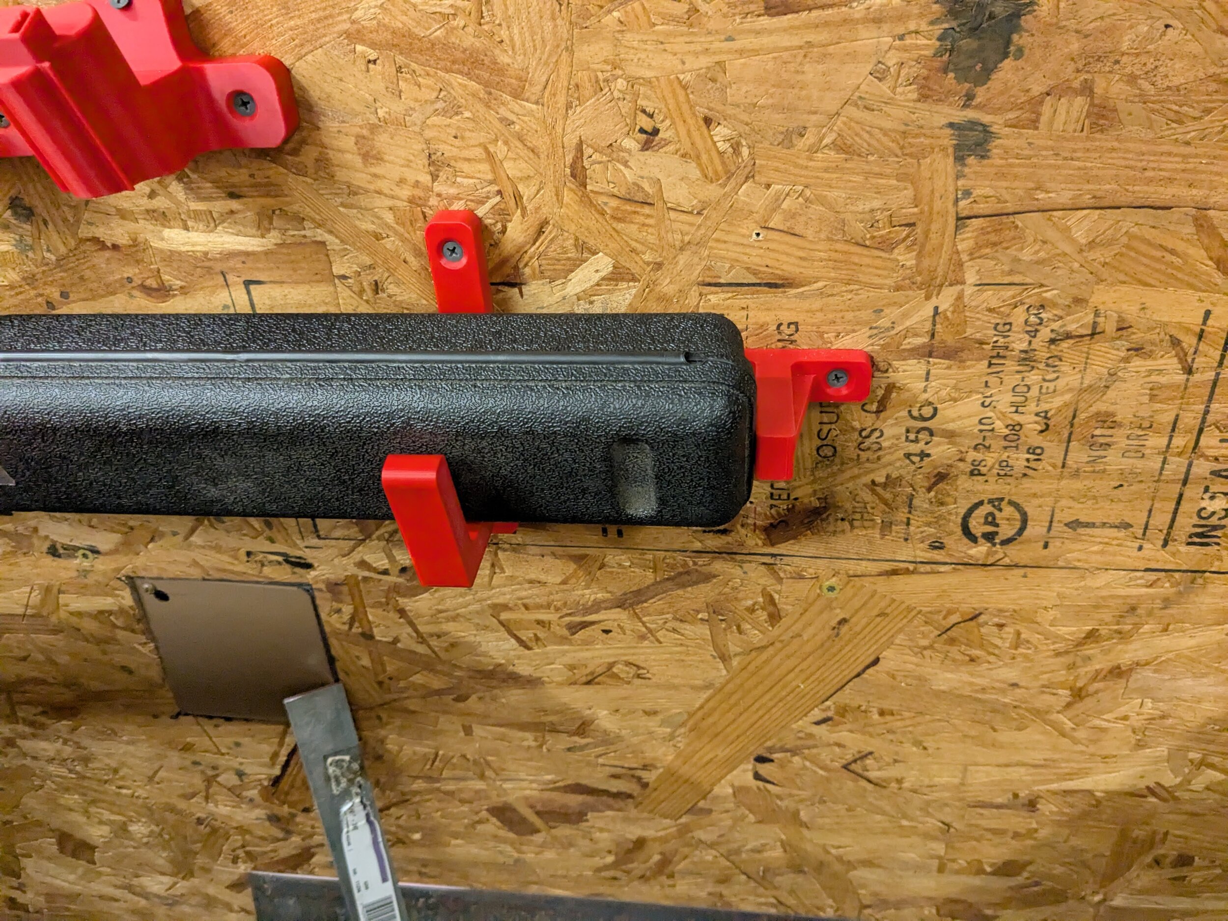

I was getting so tired of storing my torque wrench here because it doesn't fit in any of my drawers (too long). I ran into it too many times....
I draw up some hooks in Fusion 360 and then decided a stopper would keep it from falling to the floor if I misjudged dropping it on the hooks:

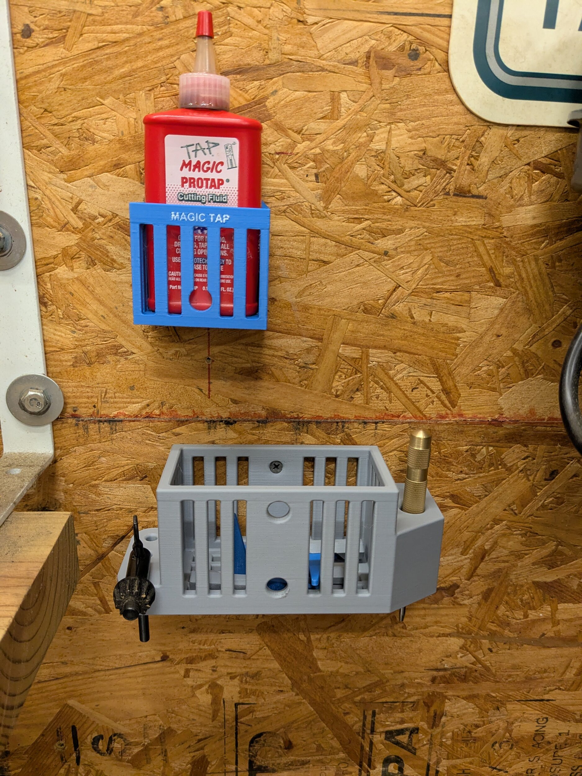

Update on a few new 3D printed add-ons for the garage.
Drew these up in Autodesk Fusion 360. Tap oil holder & holder for bench drill press tools:

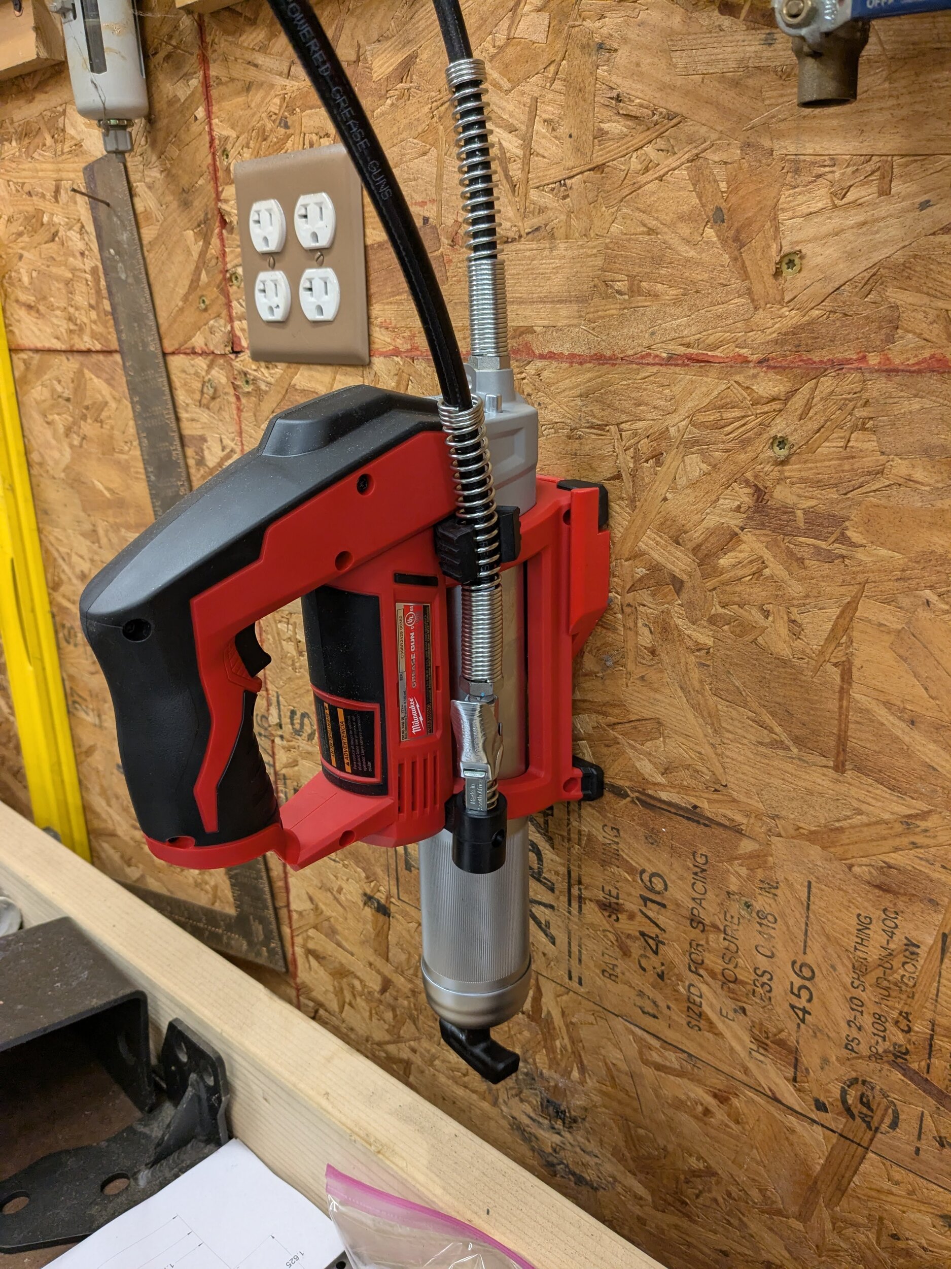

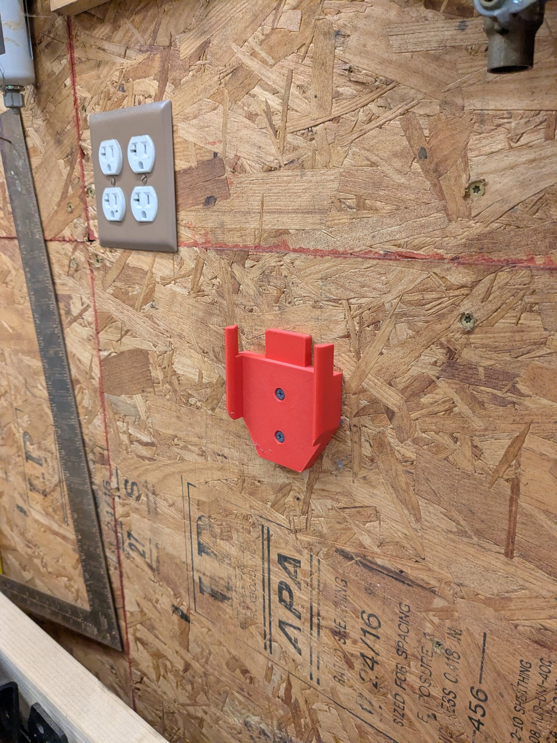

Found this mount design out on the web - Thingiverse, MakerWorld, etc - Can't recall where I found it. Had to make sure I found one for M12 and not M18 tool.
Inside the cage of the gray tool holder are center-finding 3D printed tools to find the center of round stock materials.
Fits perfectly. This is a great solution to get a large tool off my workbench horizonal surface.

Great, now I'm going to have to find that grease gun mount. Nice work.
