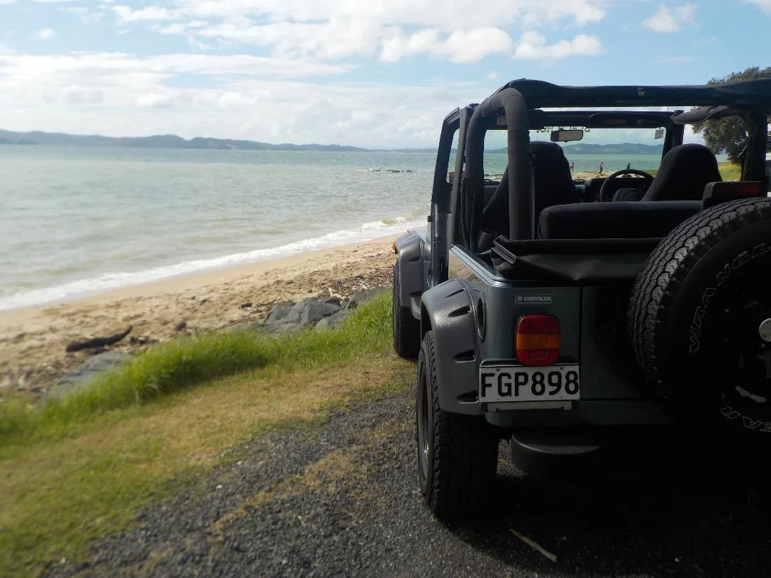

31x10.5 and 6 inch pocket Rugged Ridge flares...managed to get the offset to sit level with the flares. ( its the law here to not have the tire sit outside the guards)
Thanks. Your looks like the tires/wheels and flares were made for each other. I have decided for now to go with 31x10.5 tires. The new wheels and tires should be on in about a week. Once they are I will measure how far outside the flares the tires sit on each side. Then will go with a set of flares that gets the one that sticks out the most taken care of. Problem is then if I decide to lift it down the road the axle may shift. But I’ll live with it if get adjustable control arms then
