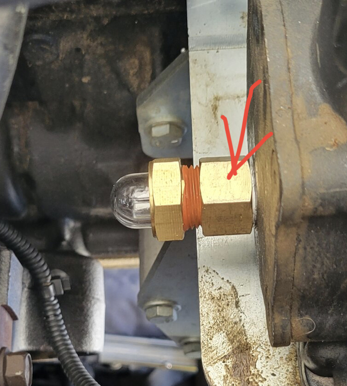

For the oil sight glass, I switched the one on the York for this one, and it is much, much better to avoid overfill.

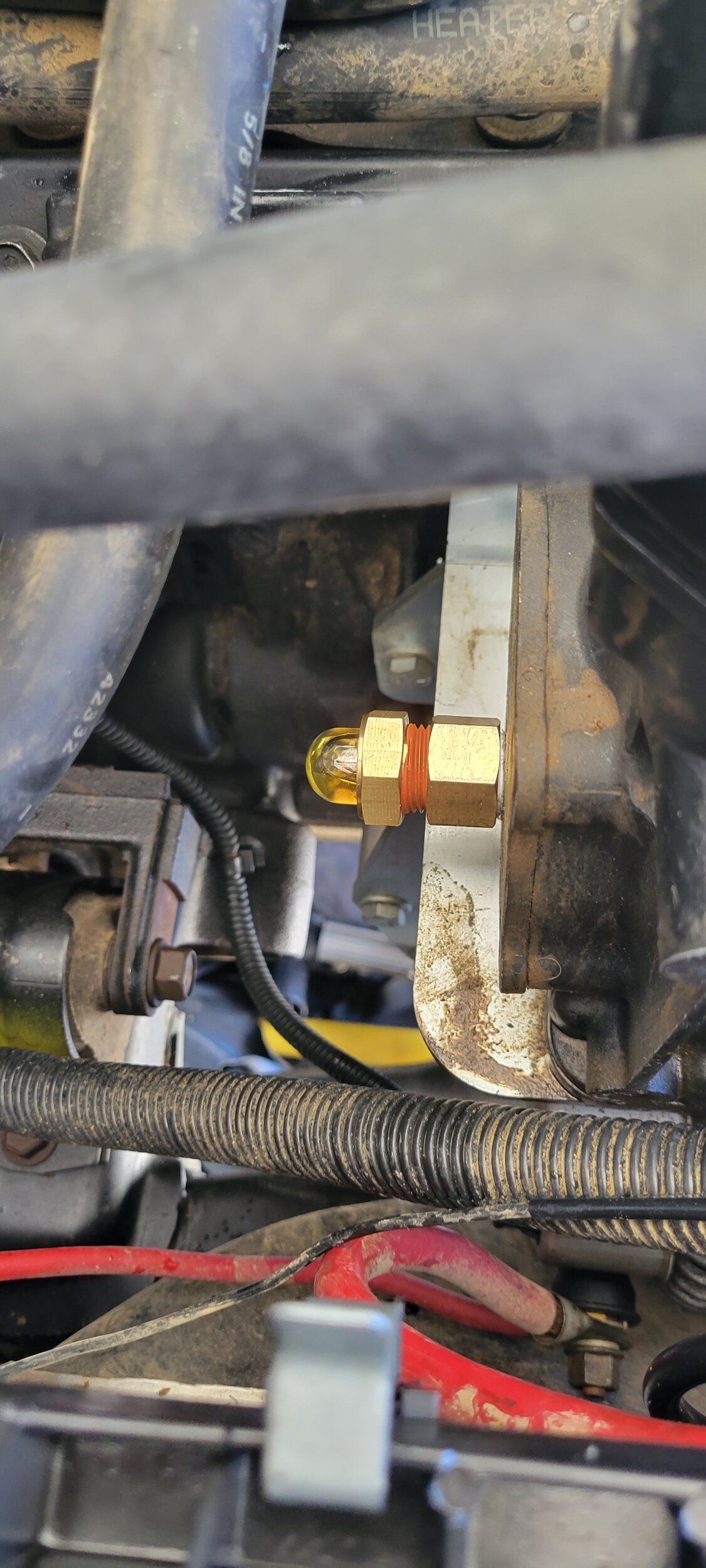

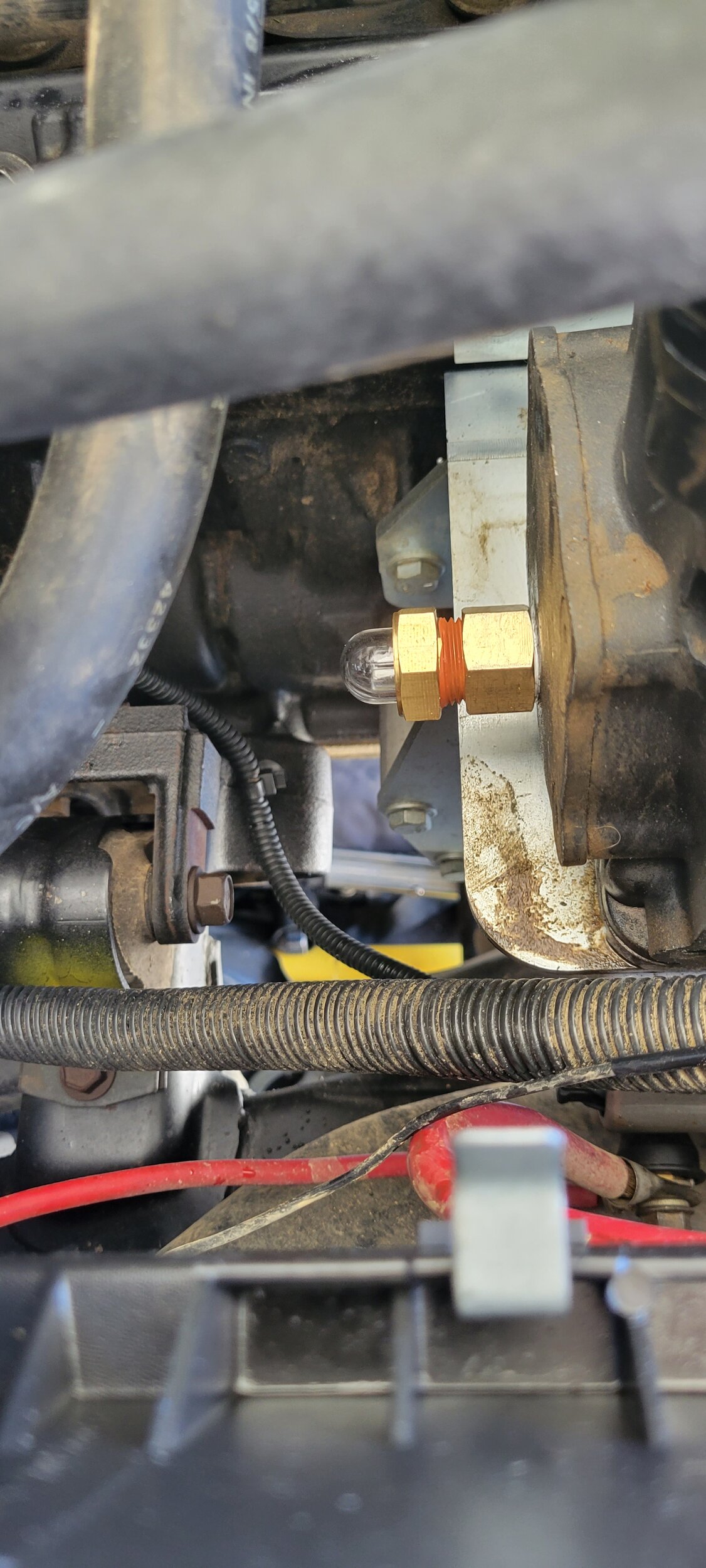

This is what that Sight Glass looks like once installed.

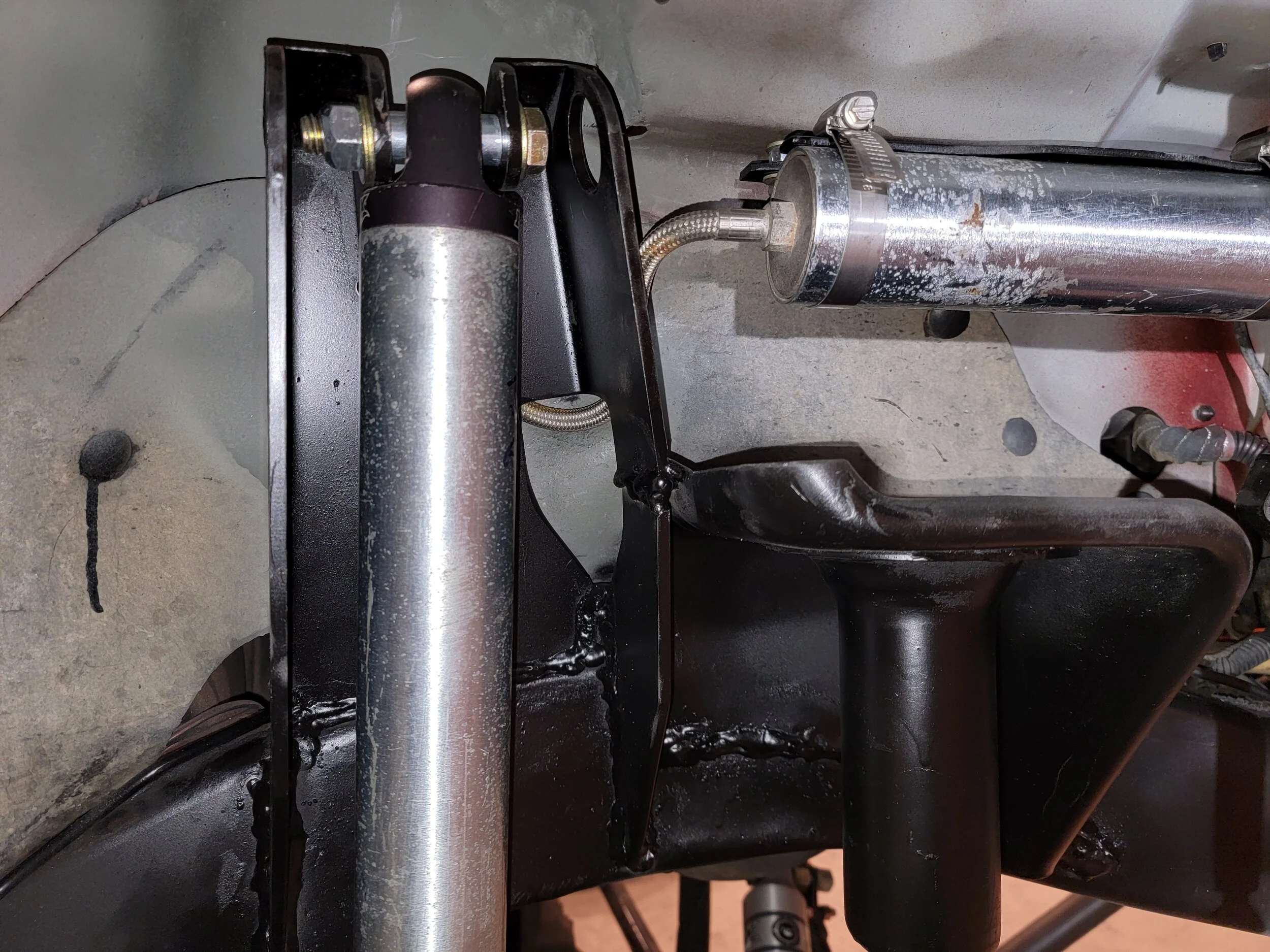

I remembered another reason I wouldn't rush to install a York. Moving the alternator down puts the power lead off of the alternator right in the way of a front outboard shock tower. I needed to cut a big window into the tower to prevent welding the alternator to the frame.
Building for good shocks on both ends is not something I ever considered when I did the York in 2016. And I don't recall ever having seen anyone run into a similar interference. But my problem might be made worse because I did a front wheelbase stretch where I also moved the shocks and springs forward on the frame a couple inches.

I used the Amazon link and ordered the sight glass, but it looks like there’s an adapter fitting as well, correct?
Ah. Yeah, sorry. You may be able to find it at a hardware store. My local Home Depot didn't have it. You can get it here. Some Yorks may have a different fitting, so make sure this is what you need.
TAISHER 5PCS Brass Pipe Fitting, Reducer Adapter, 3/8-Inch Male Pipe x 1/2-Inch Female Pipe https://www.amazon.com/dp/B08N657TR3/?tag=wranglerorg-20

Thanks! The sight glass it comes with has been practically useless.
I agree. Hard to see. There is a dip stick you can use, but it is not as accurate. This sight glass is the way to go. If you stop adding oil halfway, you will see it still fills up. You can see a small bubble on the top section in my picture. That's after stopping halfway.
Did the sight glass come with the kit? I’ve got a York system the PO put in, but checking the oil is a bit of work. I’d like to see if I can get the sight glass separately maybe if the port is in the right place.
The York came with the flat sight glass that is almost useless because of its low, rear-facing position. I had to buy the domed sight glass and adapter separately. Here are the links for future readers.
