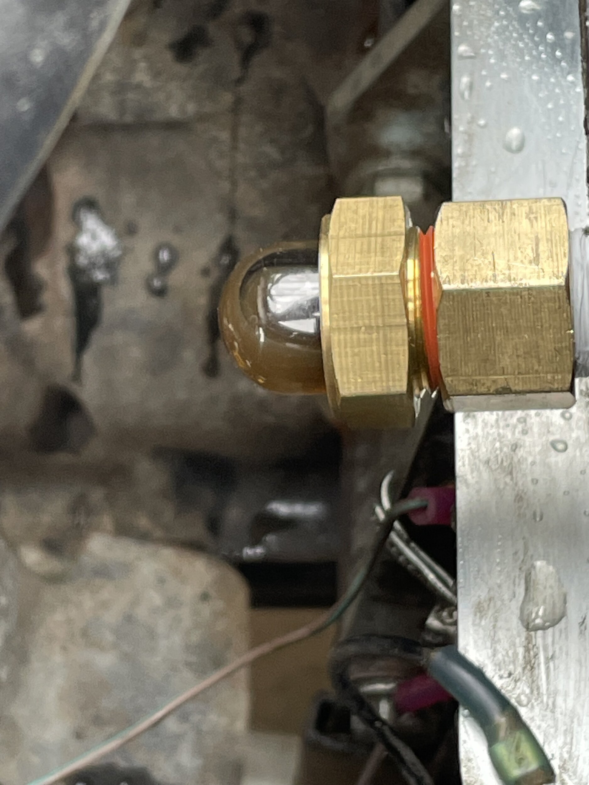

The York came with the flat sight glass that is almost useless because of its low, rear-facing position. I had to buy the domed sight glass and adapter separately. Here are the links for future readers.

Installed! Is this enough oil?
Yes. As long as you are able to see some oil through the glass, it is enough. The small bubble is a good sign. If the glass is completely full, the York may be over-filled. If the oil level is at the bottom of the glass, add some to stay at the recommended level.
