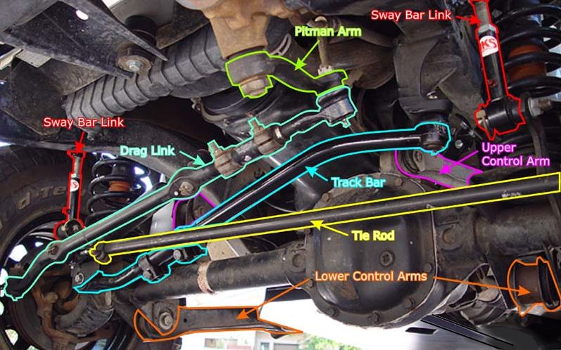

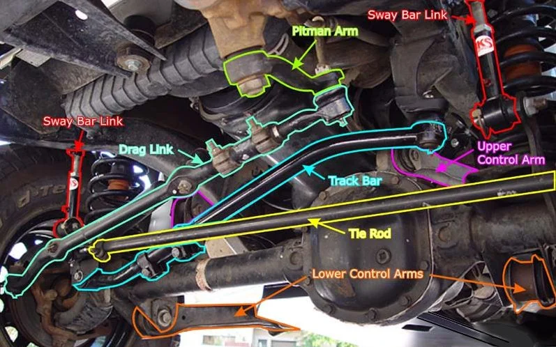

It definitely doesn’t come with a front track bar. Just what’s pictured in the link. The picture below shows the track bar, which is not included in that kit.

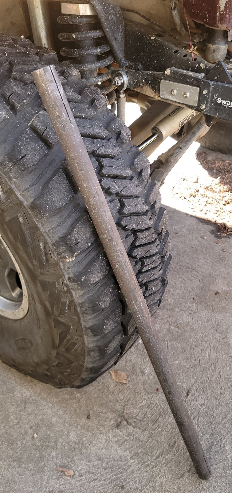

The drag link will need the RHD specific bend for sure, not sure about the tie rod. It may have a directional bend, I can’t recall at the moment.
The Rock Jock tie rod is quite straight.
(Close enough! 😉)
