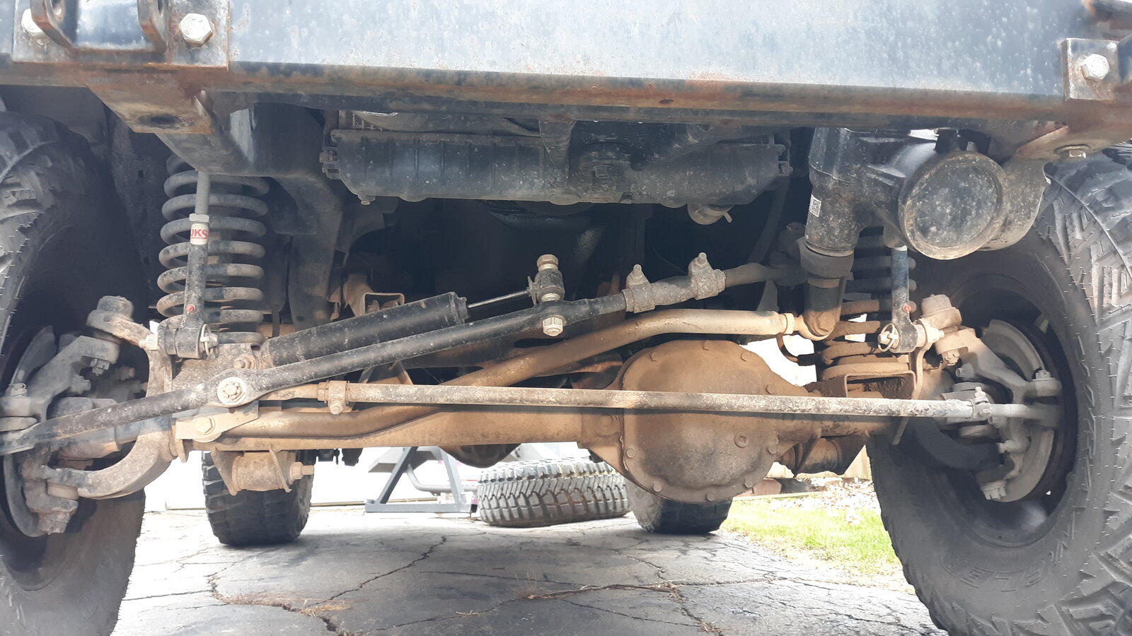

https://www.ebay.com/itm/2743972627...d=link&campid=5337789113&toolid=20001&mkevt=1My question: does this look comparable to the items discussed at the beginning of the thread? Is the quality in the actual ends? Is it still accurate the drag link doesn't need changed?
This is what we have now
01 sahara, 4" lift 33s
Full size bronco steering box and squirrely all over the place

I'll tell you this: Your track bar frame mount looks wonky, along with your steering geometry = squirrely. Go research that.
Not my normal mo, but 29 pages is a lot. I've looked a lot, but am still spun around. I know the geometry is off, but if I lose the tb mount, that'll make it worse. A little better since letting about half of the 47 PSI out of the tires!!!

That looks like your main problem to me. That long frame mount messes up your geometry (squirrely) and flexes the frame even though it seems solid (squirrely). Putting new steering parts in without fixing the real problem isn't going to help. You might need a different track bar if you move that mount. I'm not sure about that frame-end joint on it - maybe it can be made to work if the joints are good.
I thought about a different track bar. That one doesn't have near the bend of the stock, but it's adjustable. I thought about pulling it all and starting over. More to deal with tomorrow. Thanks for the insight

Fix the frame mount of the Trackbar by going back to stock.

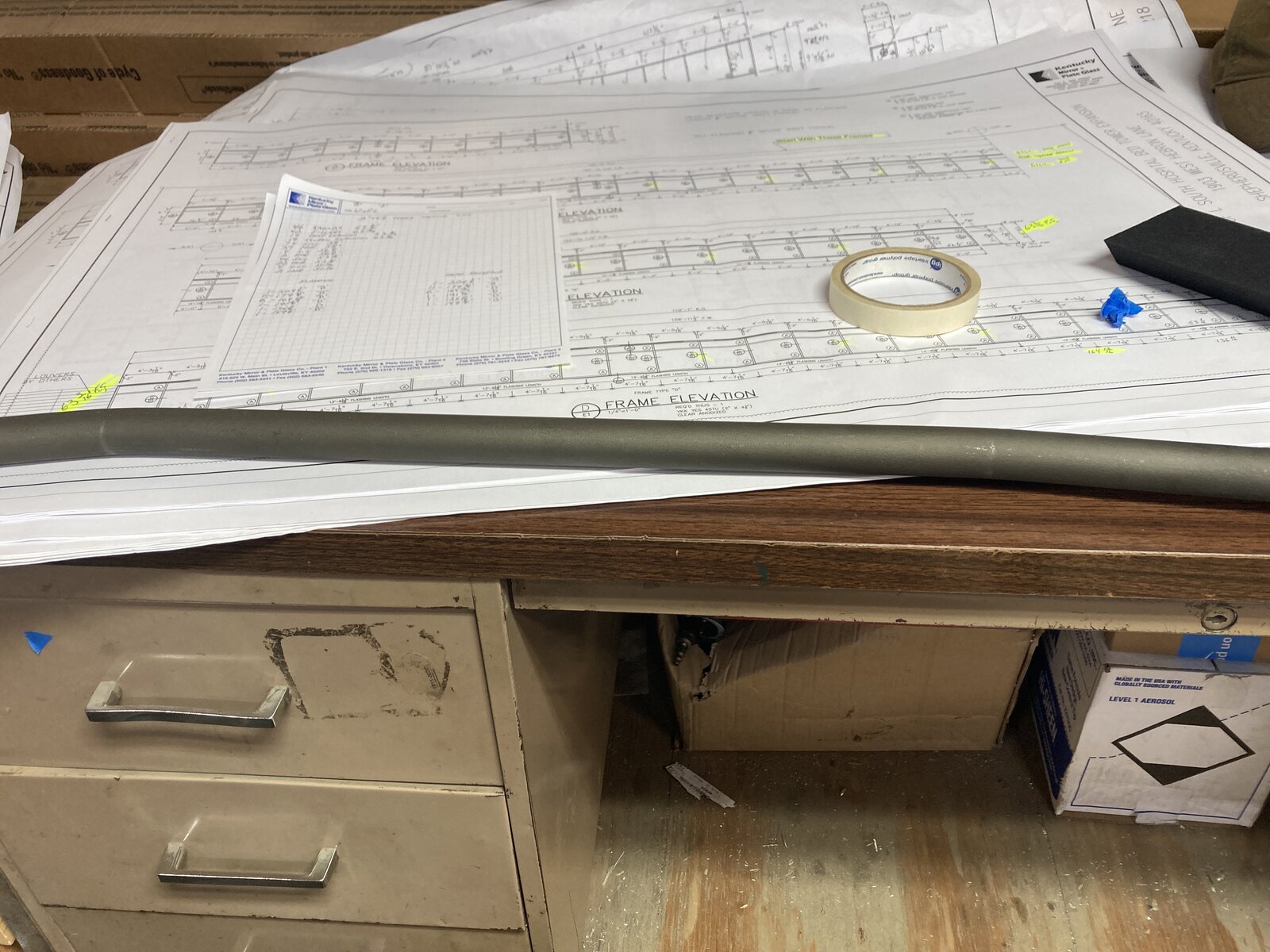

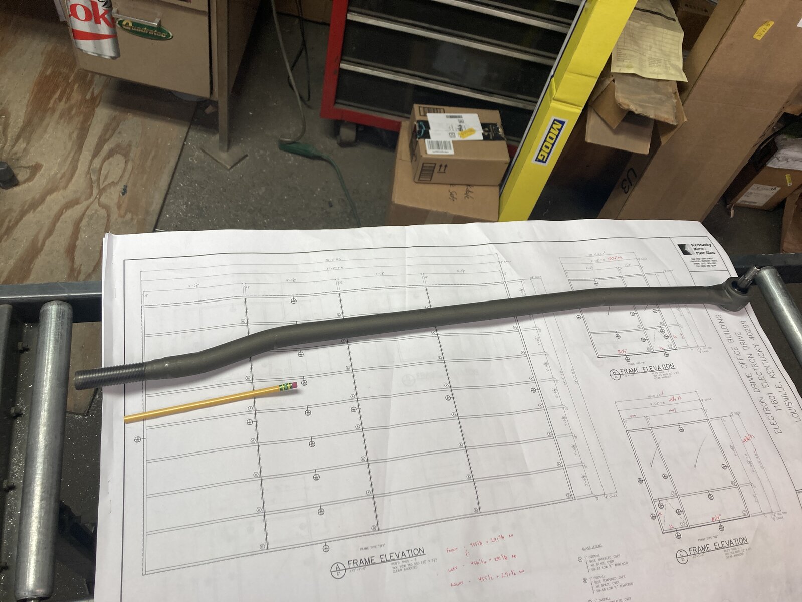

Just received my MOOG ZJ tie rod, adjusting sleeve and tie rod end from Amazon. All three parts were only $78 I’m impressed by the beef of the tie rod! Can’t believe I waited this long into my TJ ownership to do this mod!

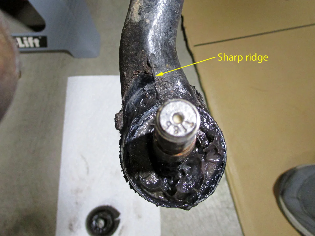

A bit of advice: Inspect where the dust boots will sit for anything nasty. My MOOG drag link had this nice sharp ridge which split a dust boot within a few weeks of installation. It's better to file it smooth before installation than to search for an un-obtainable dust boot later. Keep any filings out of the joint, of course.

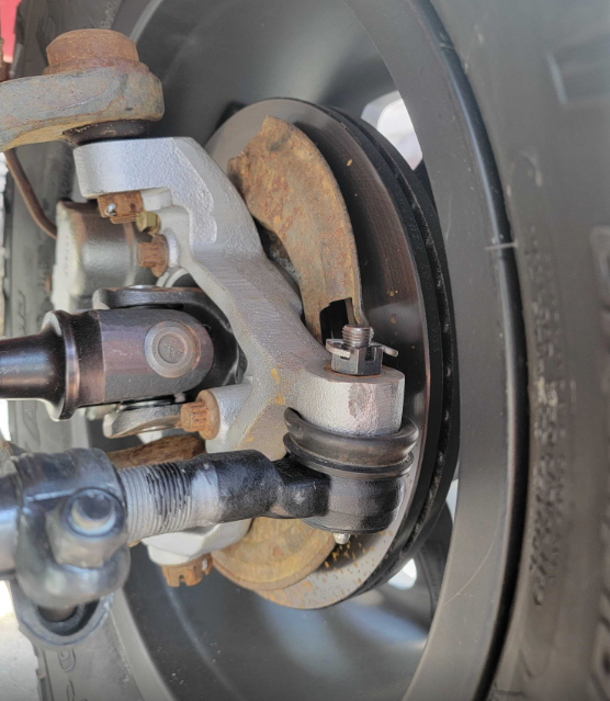

I just installed mine maybe a month ago; a Moog TRE on a BMB knuckle. I checked the thickness of the old knuckle, and while I could not get the caliper on the BMB knuckle with the TRE installed, it appears to be nearly identical.
After looking at my pic, I hope that boot isn't too smashed. The castle nut is torqued to the service manual spec, and then just a smidge more to get the cotter pin to go thru.
