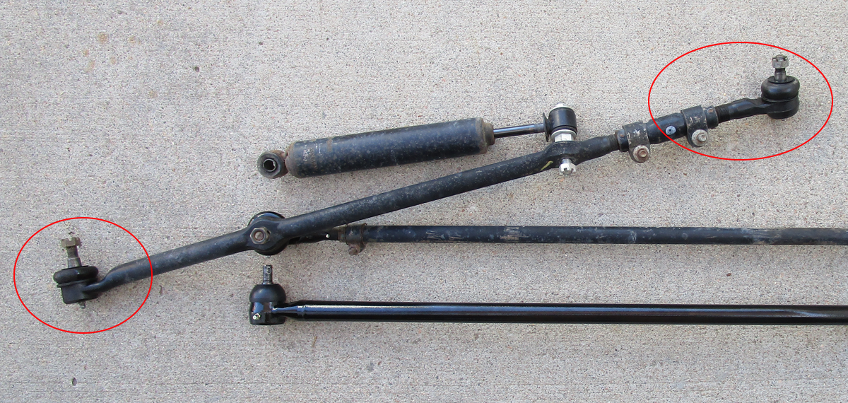

The ZJ tie rod is a tie rod fixed end on one side, one large adjuster sleeve/clamp, and a single tie rod end. The Tj setup is two tie rod ends, two tiny small clamps, one tie rod. The stock TJ tie rod is a joke for anything other than highway cruising. The "second" additional tie rod end is for the drag link. All the parts listed by Chris in the OP will bolt up to the TJ. If you wanted to replace the drag link end components and go with the ZJ tie rod you would simply purchase two of the ES3096L and also two of the sleeves. I would just swap out the tie rod components and go from there, and worry about the drag link and ball joints second. Don't forget that your track bar and steering stabilizer also make a difference despite not being steering components in the traditional sense.

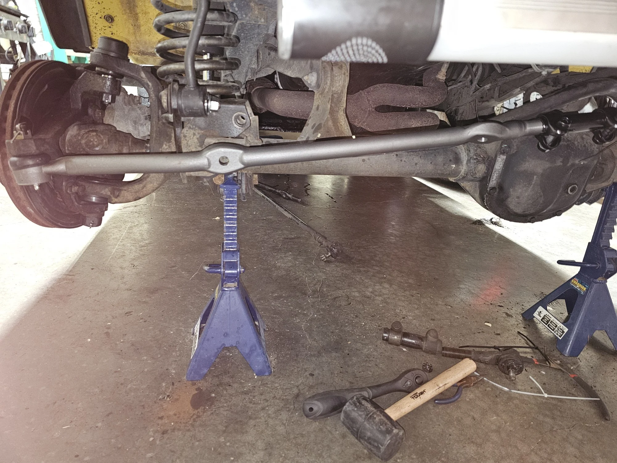

I bought the moog parts on Amazon for the conversion and I am having trouble where the drag link connects to the pitman arm. The bolt on the tie rod end goes into the pitman arm, but it is at the slightest angle and it won’t go all the way through. What do I need to adjust to make it work?
I apologizeif this has been asked previously, but it seems a waste to replace the entire drag link especially if I’m going to just replace it with the same part. Is feasible to just replace the ball joint part of the drag link, as simply as the knuckly ball joints, or is it not usually done? Hate to waste a perfectly good long piece of steel if I don’t really have to. Thoughts?
Thanks.
The pitman end is replaceable, the tierod end has the ball joint as an integral part. If that lower ball joint is good, keep your old drag link, if bad, replace it.
