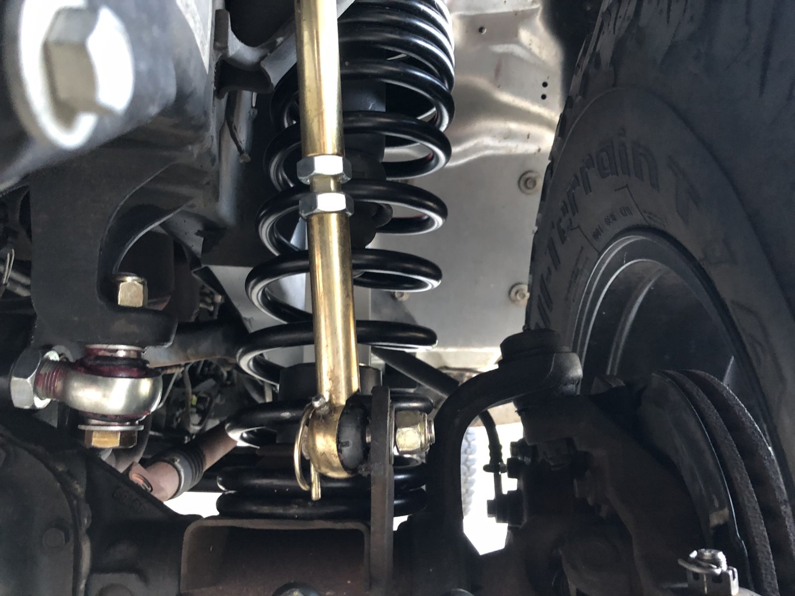

Is that nut on the driver side swaybar link axle bracket loose? It looks to be off kilter, but it might just be the angle of the photo...
OK, No that bolt is supposed to be loose so I can wiggle the sway bar disconnect in and out. The sway bar disconnect is adjustable in length for different sized lift kits. I am limited to a 2" lift so my disconnect bar is a little long and that forces some downward tension on that bolt making it look cocked. I did shorten the bar fully which it was not and got a few more threads showing on that bolt. Thanks for that observation. The TJ is a little better tuned because of you.
What brand of swaybar disconnect is that? It does not look familiar...

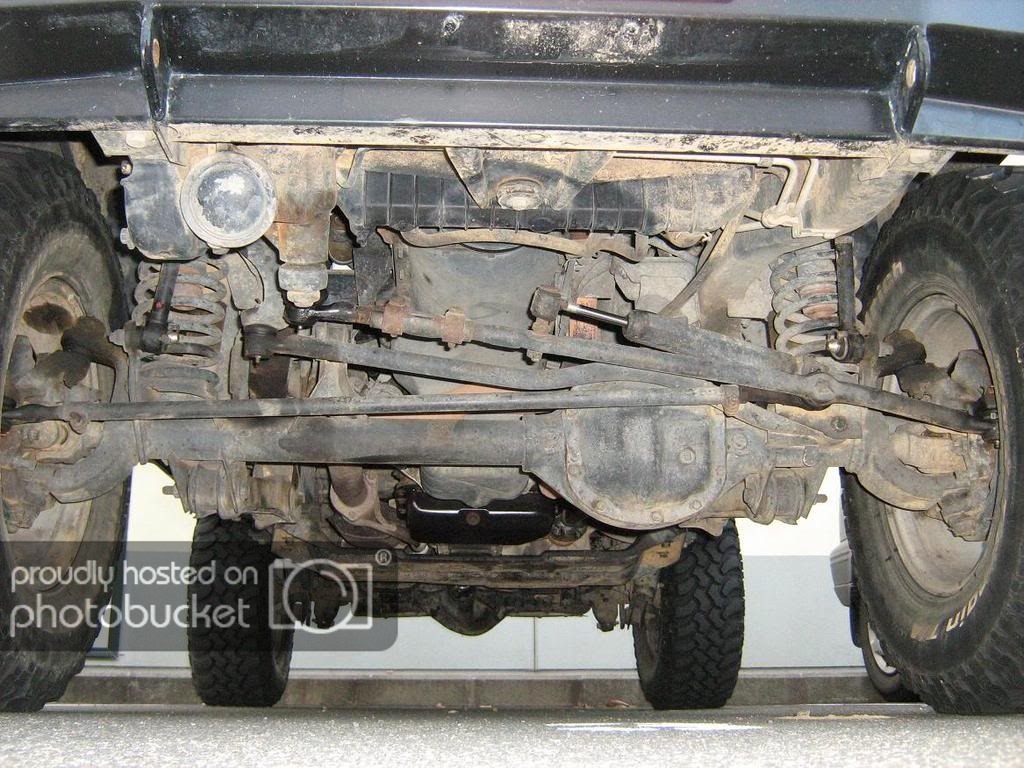

I get the drag links will be different (to clear the diff cover) but surely the drag link, tie rod and sleeve work? To look something like this (not my Jeep)
Thanks in advance!
Actually with more research of this post, looks like the ZJ tie rods are bent to clear the diff cover, meaning the LHD will not work... And the tapers would probably end up backwards..

X2. @Mud dauber, can't the swaybar just go up a bit more to get the end of the links on the pins with the nut tight?
I don't think that endlink bolt should be loose as it will wallow out the mount hole.
Thanks for pointing this out. I called the manufacturing. They stated that the bolt holding the sway bar disconnect was loose (see photo above) It should look like this (see below) The bottom photo has the the lynch pin oriented in the correct position. Thanks for your help!

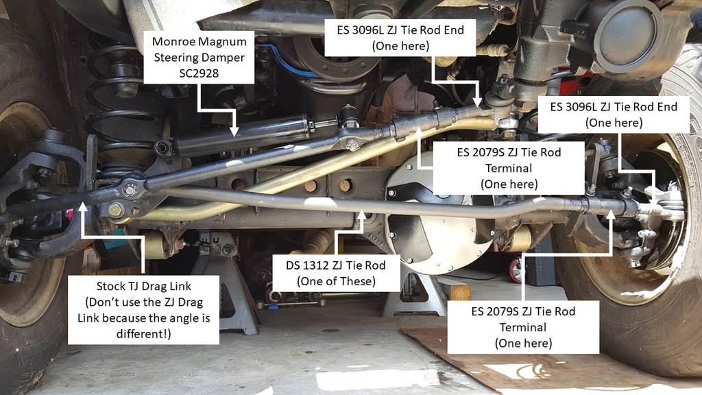

I pulled this image off another forum. It states I want to get the additional Tie Rod Ends and Adjusting sleeves. Do I need to purchase the extra parts or stick to the following plus the damper?
Just those 3 parts for ZJ tie rod conversion.
EDIT: you can replace the other parts if you want a brand new steering setup but they aren’t “upgrades” from stock set up.
