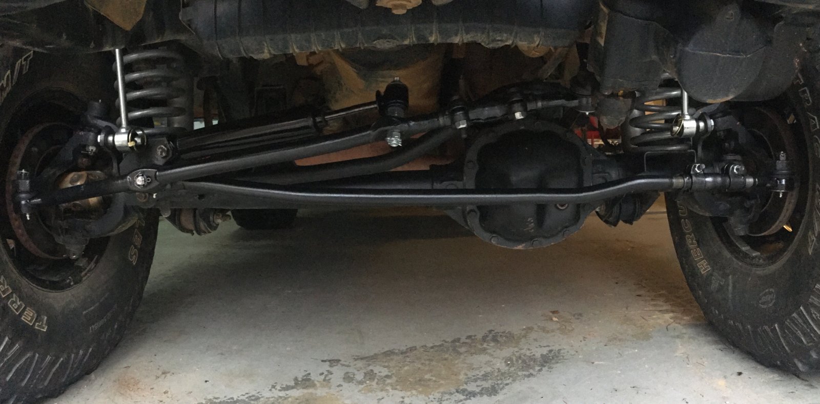

All the parts arrived for this upgrade! Hoping this weekend I can get this accomplished!

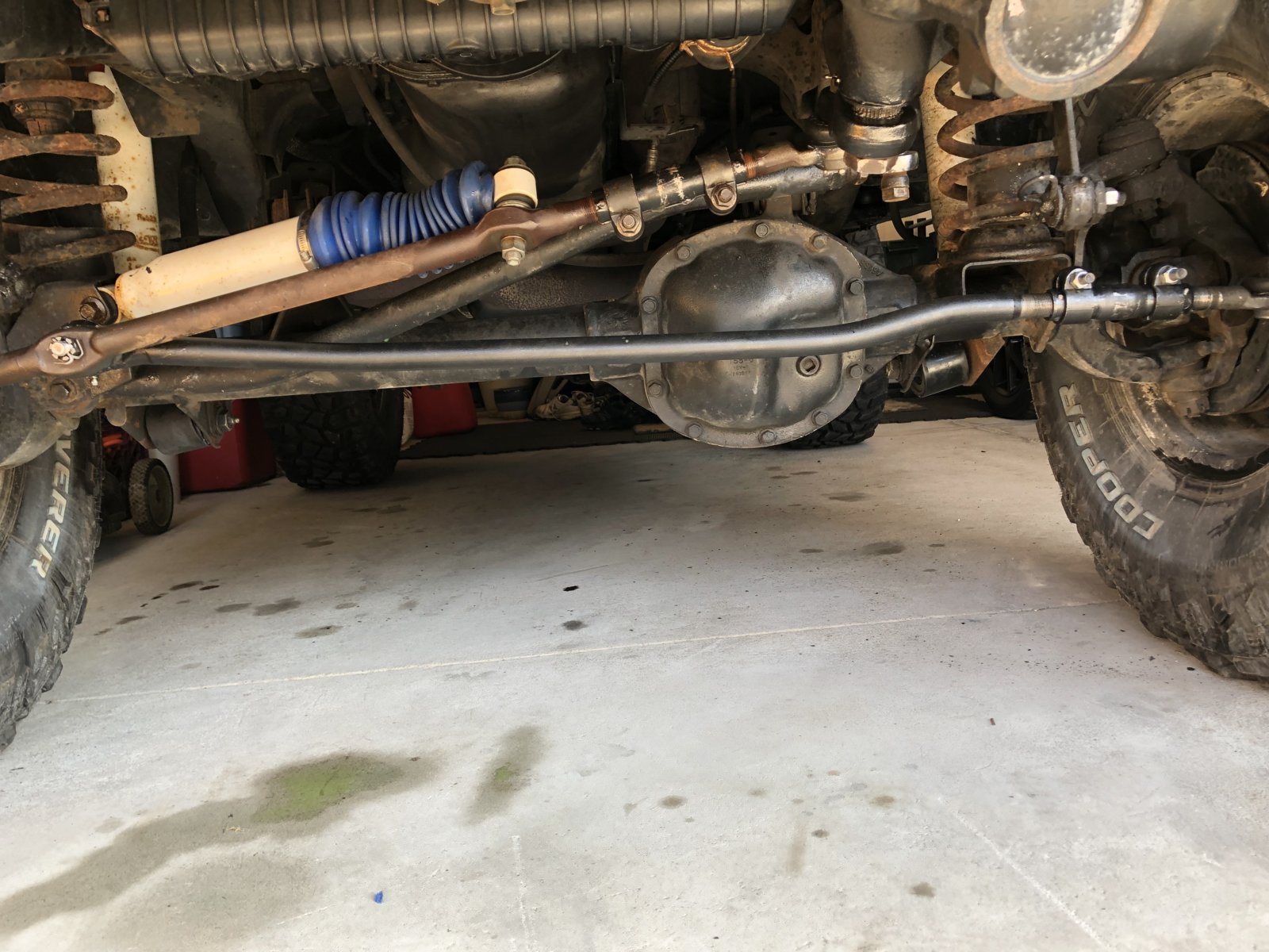

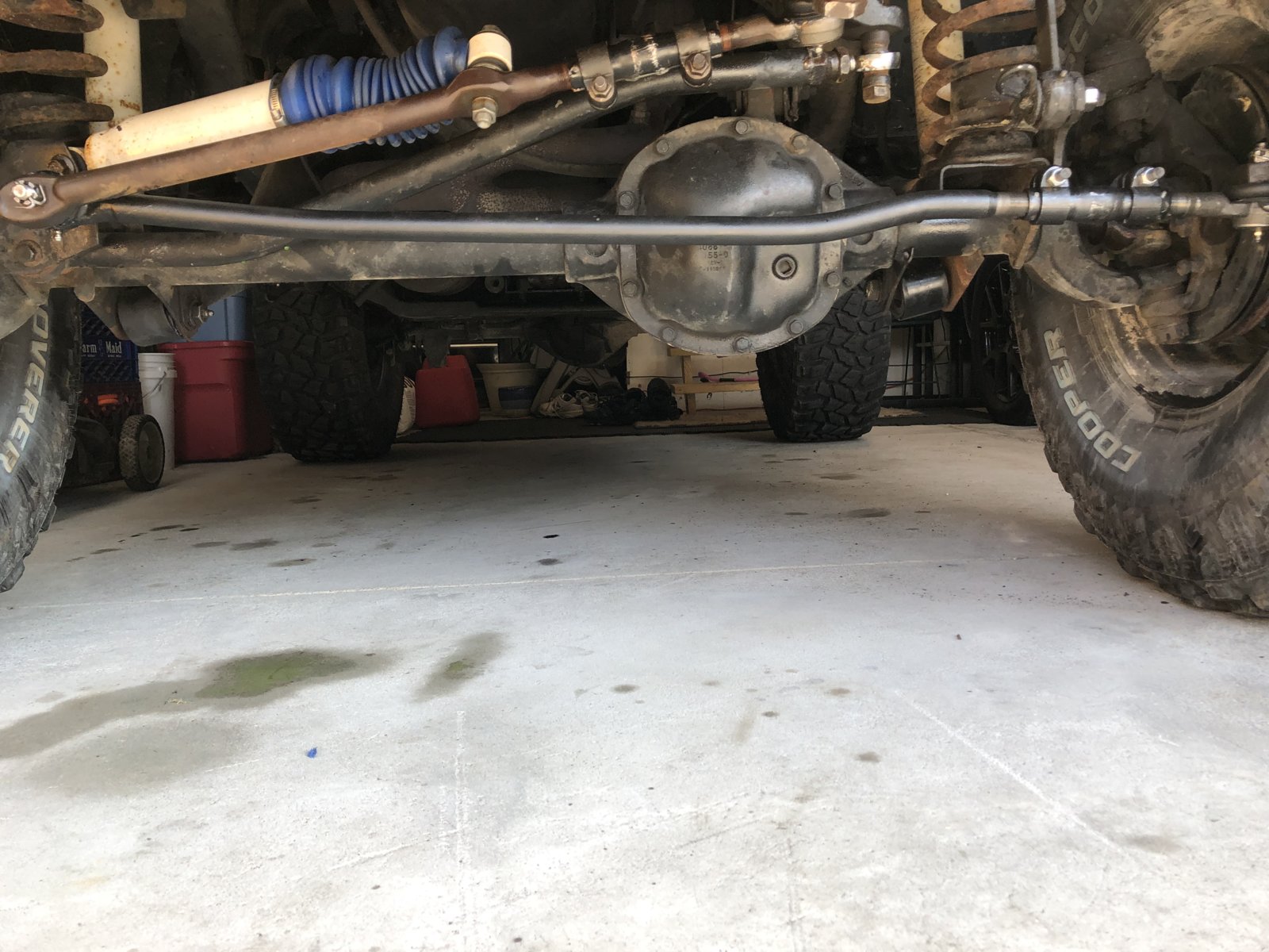

Sun is out and temp around 50, I was able to get the new tie rod installed. Funny how the most difficult part of this job was removing the damn cotter pins!

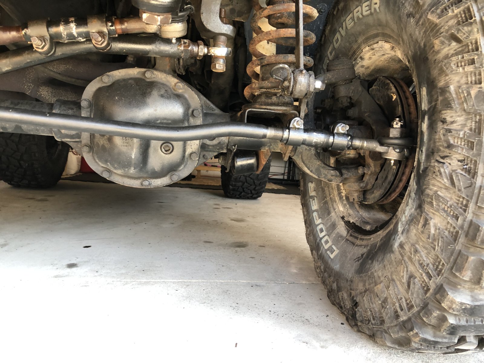

My torque wrench snapped when tightening down the tie rod to drag link, my fault for using a 1/4 drive. So I tightened it down the best I could by feel and look.
Update 2-6-19: Ordered new 1/2” Drive torque wrench and will torque all correctly! :)
Things to note, the tie rod end is reverse threaded into the sleeve. I had a little difficulty, as I was able to get it started into the sleeve, then had to hold the sleeve with vice grips and thread it in. It wasnt turning easily by hand, like the sleeve did onto the tie rod itself.
