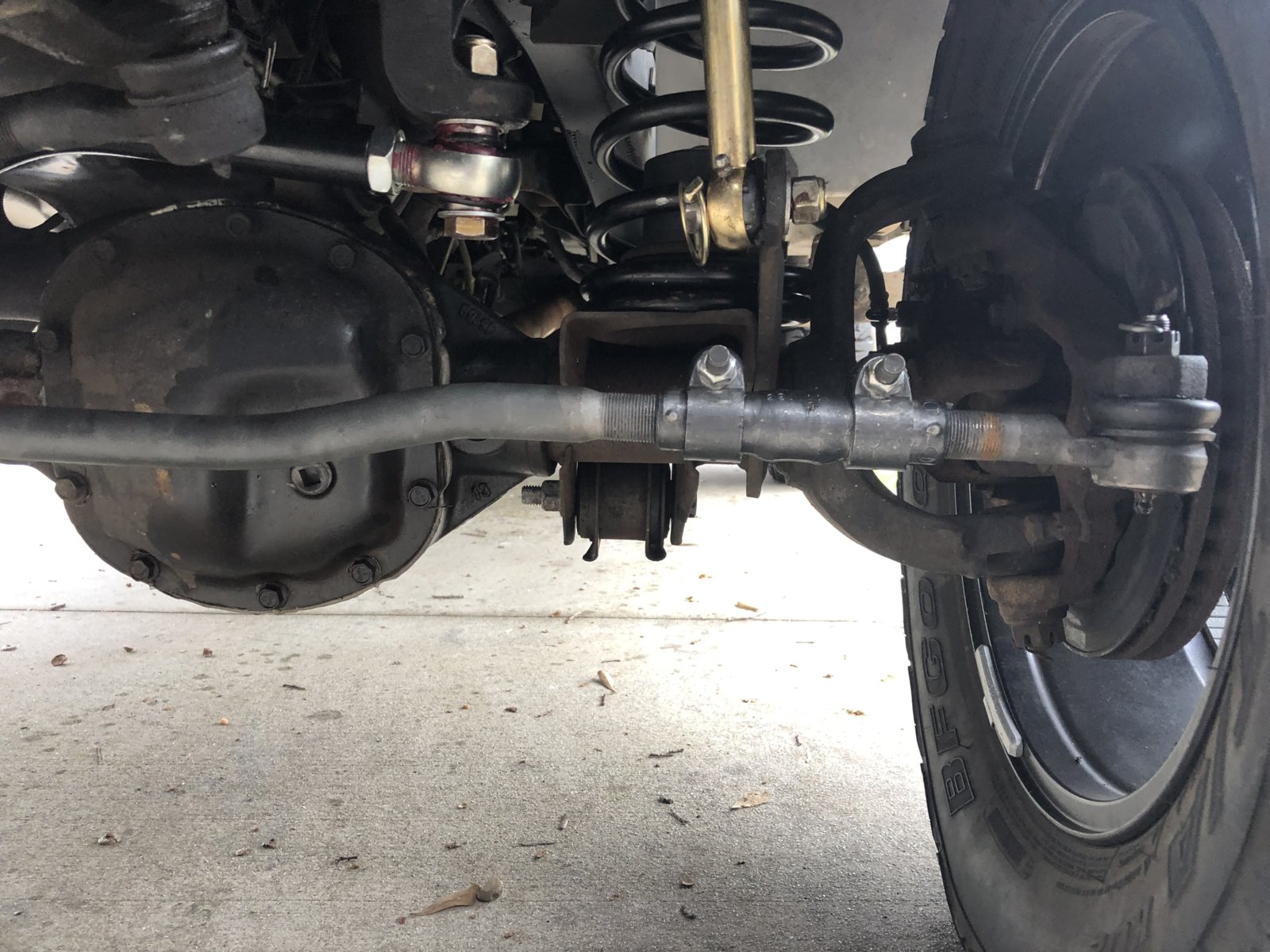

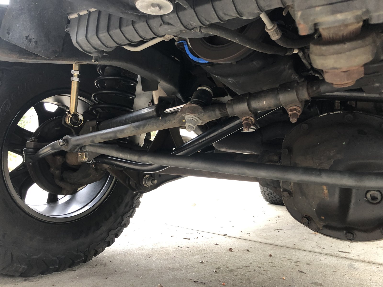

MEN I DID IT! I found me a 1995 Grand Cherokee with a V8. Just sitting in the parts yard not wrecked just retired. Front still intact. I gave it a good shake! Solid! Since I had installed a new set, I called my buddy and he came right down and we removed the entire steering linkage and paid 10 dollars and some change. At this point I am a little perturbed I did not get this deal for myself. My friend thinks I am a good guy now. Here are some photos I am suppose to attach to upgrades and such. My Jeep, with the new stuff I paid for. And the other is of the GC.
Now I will update you all once the drag link and tie rod gets installed and tell you if it works well.

Just finished painting my ZJ tie rod and getting ready to install this weekend. Install looks pretty straight forward but is there anything the needs to be greased on the new tie rod once installed? I’m not familiar with greasing or zerks or anything related in that manner. And couldn’t find anything online outside of the install itself.

Yes, the tie rod ends have zerks you need to grease. Buy a grease gun and grease until boots are full. Also grease your other zerks up front. There are 7 in all
