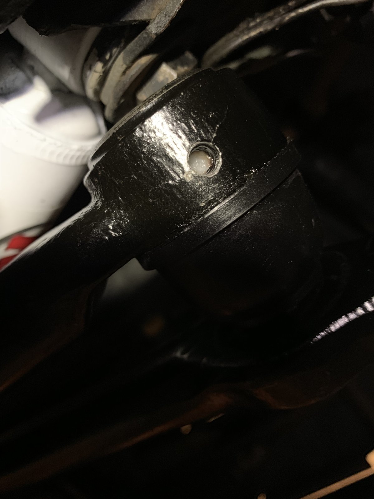

This is one of the joints. The only one that looks to have not been drilled out, when I move the bolt I don’t see any motion inside the grease fitting hole. I should. So if I drill this out and it works I still have 2 joints that are blocked in some way. Maybe they need to be drilled out also. I’m not sure. I have no way of knowing. This is why you buy good parts. I am kicking myself for buying this and not saving for the Currie.
