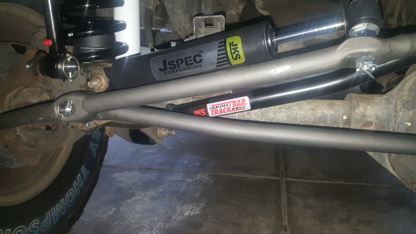

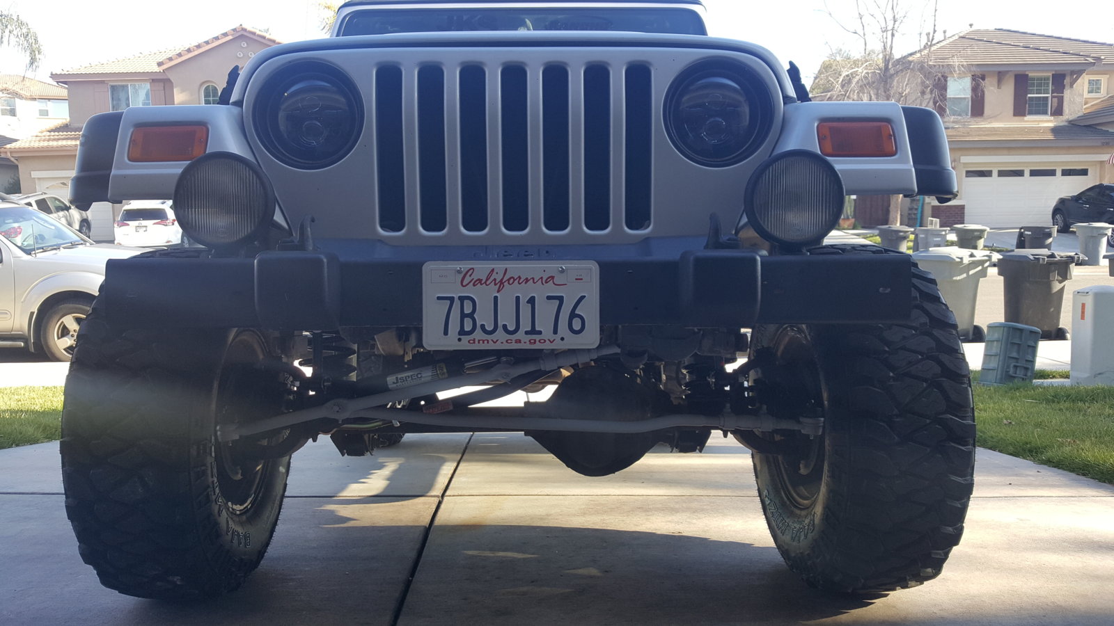

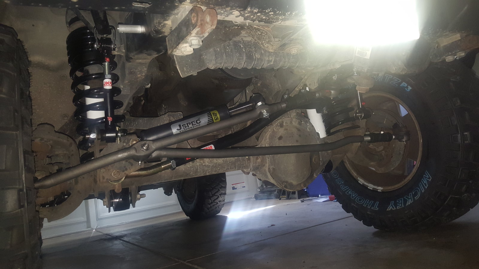

So I'm another happy TJ owner who found this thread and upgraded to the ZJ conversion. I ordered all Moog parts from amazon. Added the TJ draglink to the order just to refresh everything since my jeep has high mileage. The install went really well but due to lots of rain in SoCal and a set date for my lift install I ended up installing the steering before painting it. Just finished painting it today, not too bad!!! I'm so stocked I found this thread.

Looks great! Your whole front end is looking strong

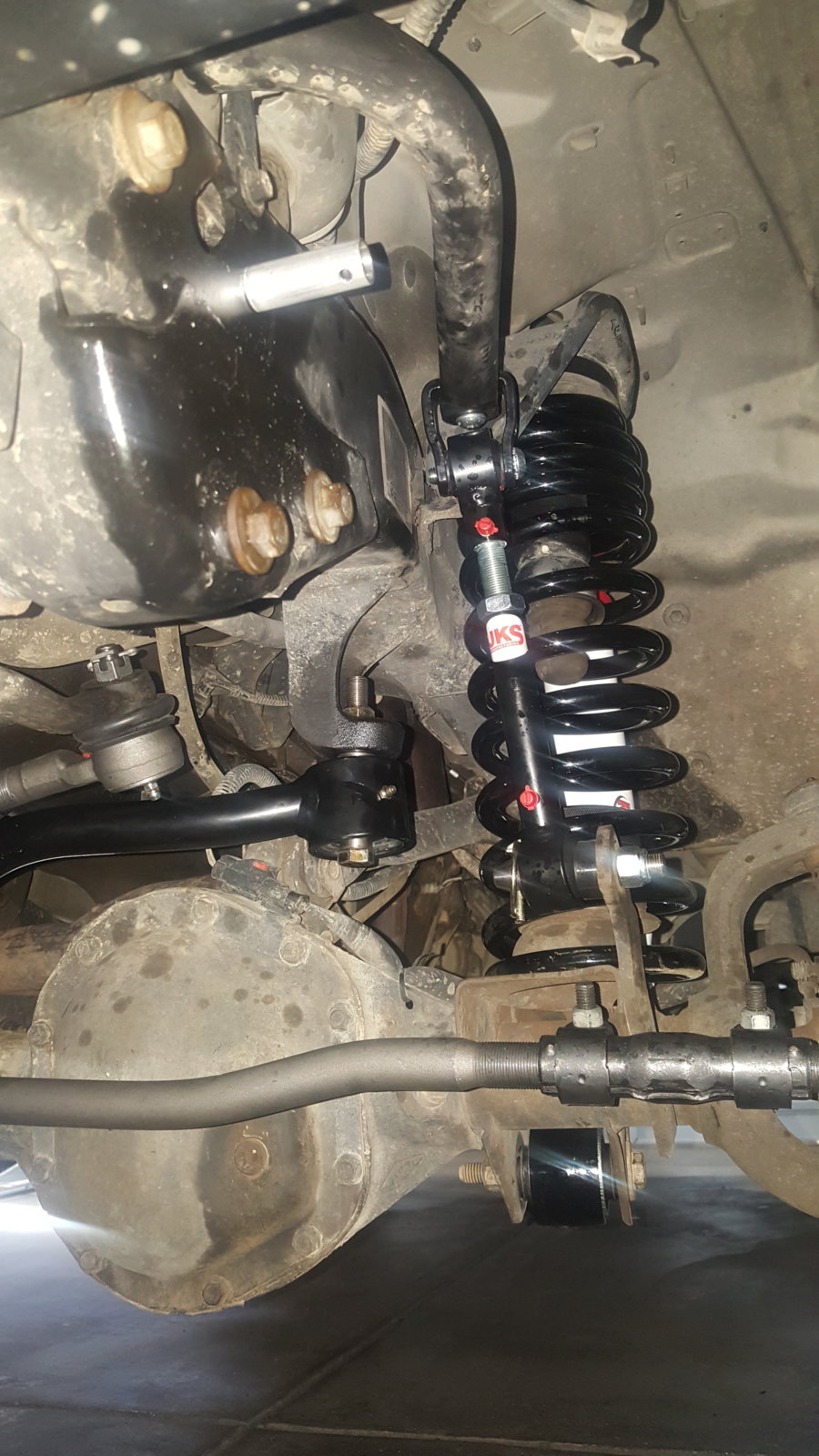

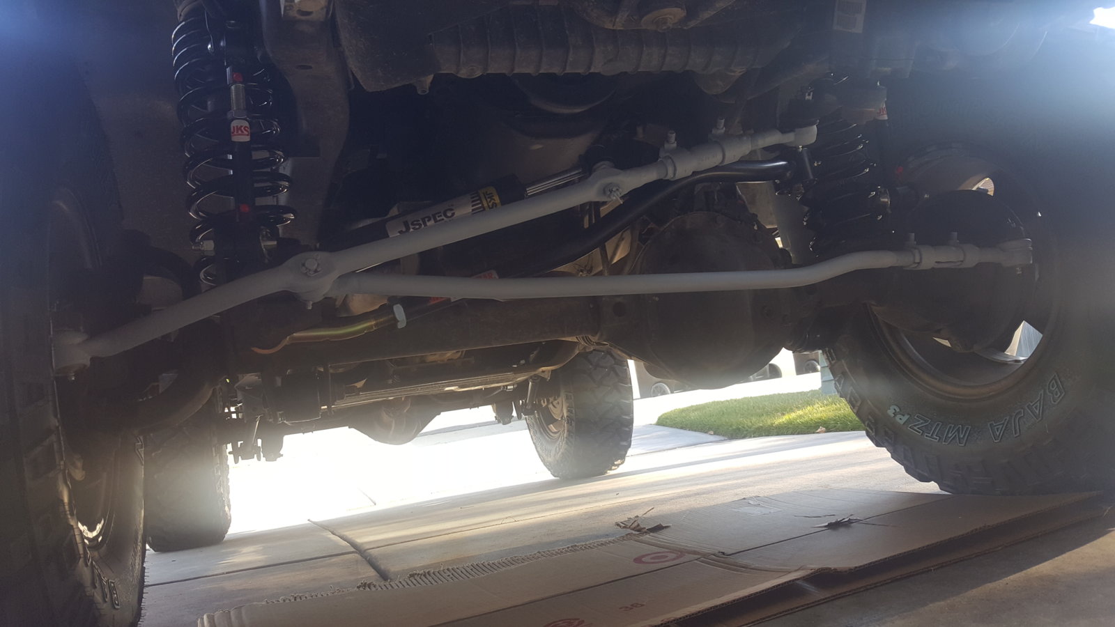

I got 2 coats of primer on the steering components and I'm sort of liking the color. Kind of matches the silver color of my jeep. So my question is.....should I keep it primer color and just seal it or should I go black and not draw attention to the components?

If you like the color, then keep it! But I would buy that paint color and paint it. I don’t think primer is meant to protect. More to adhere the paint coat.
Reactions: Steven Preyer
I almost did the same and paint matched after the primer coat but figured since replacing the Trac bar is on my list (will probably paint match it if the one I go with is black) I went with black just to keep things a little more toned down.
To each his is own but yes I would get a coat or two of paint on it.

All the new components I added to the front end of my jeep (springs, sway bar links, track bar, steering stabilizer) are black so the more I think about it since I need to get some paint on it I think i will just go black. Thanks for the input jazngab and AceShooter.

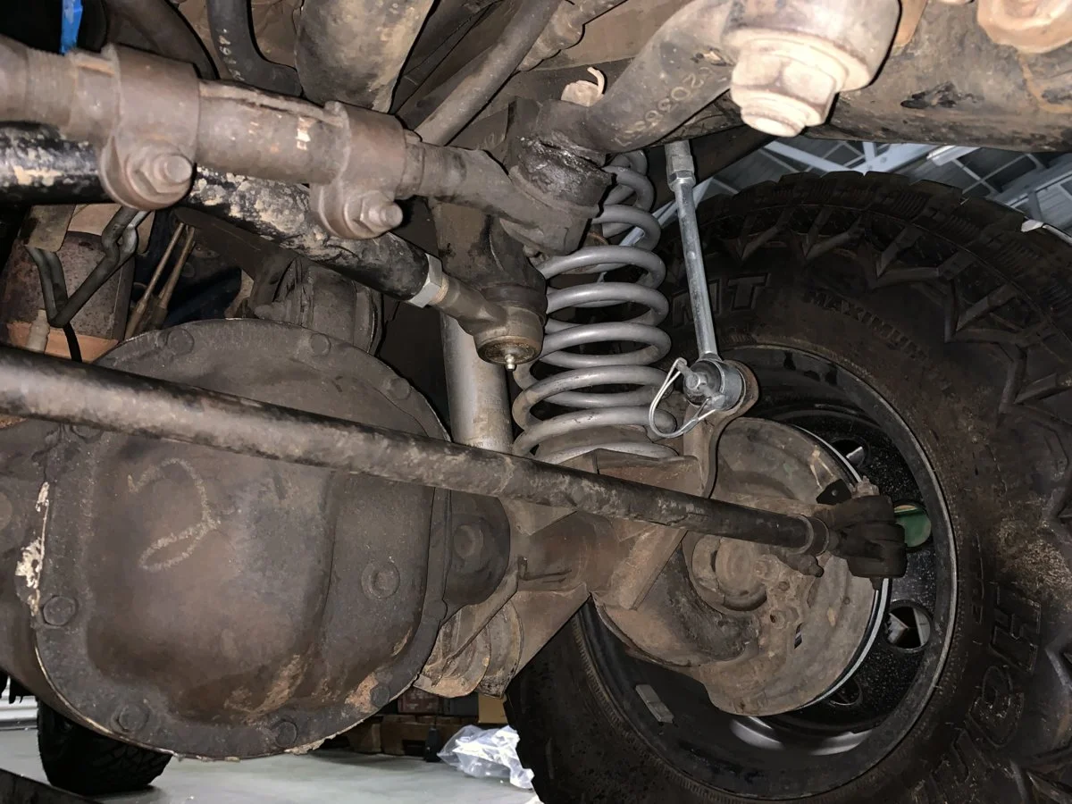

I need to do upgrade the drag link and tie rod and currently Crown is cheaper than the Moog parts. But I don't want to waste the money on Crown if it is terrible quality. Picture of my current stock setup. Any thoughts?
I know this was not asked of me, however I just completed my upgrade with Moog parts Sunday from their problem solver line. They were well made and corrected all of the steering vibration that I still felt. The cost runs ~ 190.00 (little less) on Amazon. Of course if your a Prime member, no tax or shipping.
