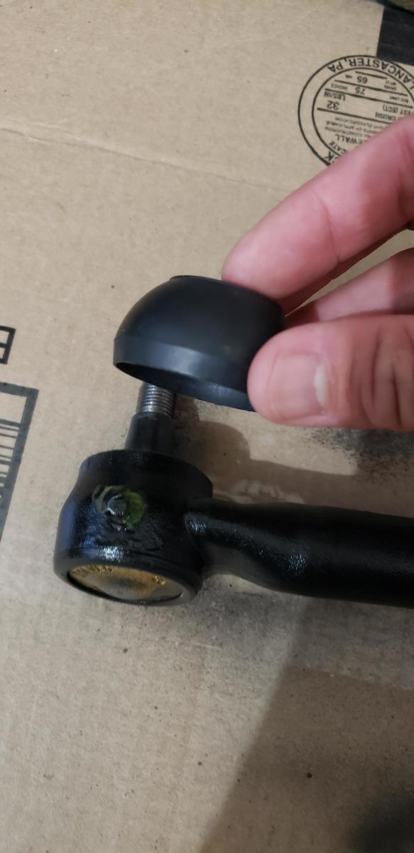

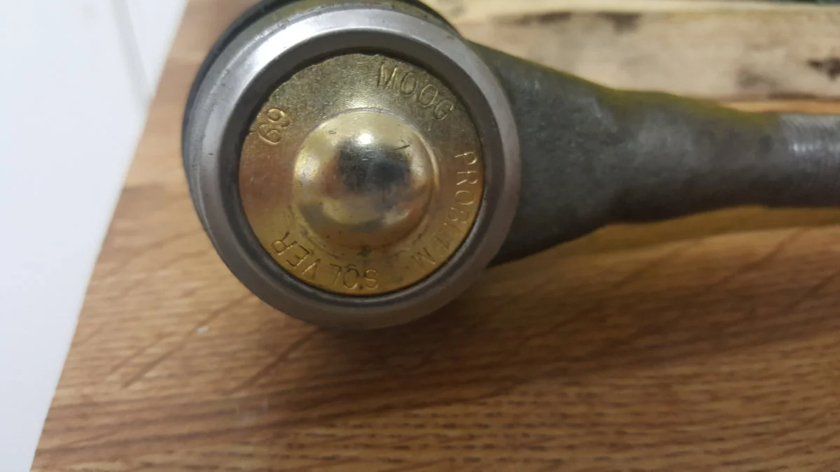

Thanks for the info. I did ask if he had the baggies, and he does. I also asked if he had the reciept from where he got the parts. Said it was from Amazon and sent a screen shot of the order. Here is the link to the CL ad. Is there anything I should look for that would give away it is not a Moog part? is the Ultra power hollow like the stock part?
Thanks again for all of your help.
Looks legit
The brass seal will be stamped MOOG
Reactions: pagrey

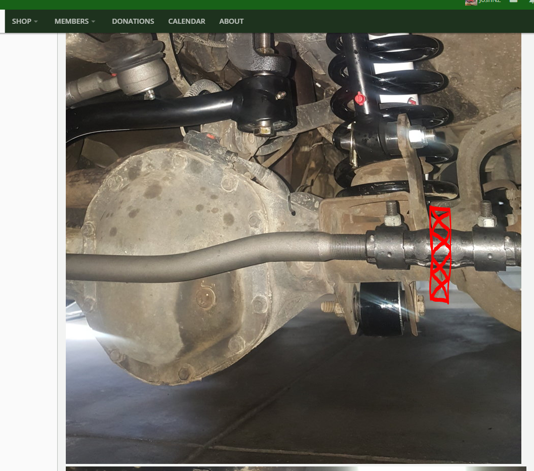

Pro trip; Don't get complacent and drive into a root, assume it was just a root, drive harder to get over said root, then find out it was actually a stump right on the adjustment sleeve....
I can confirm the sleeve is the weak link when driving into a stump right here.
(thanks @Steven Preyer for the picture)
The tie rod was bent all the way back into the spring seat which prevented steering.
Luckily it didn't damage any threads, and the tie rod is still nice and straight, so I just loosened it rotated the sleeve out and came out with more clearance (and toe in) than when I started.
Still glad I had this over the weency stock one!

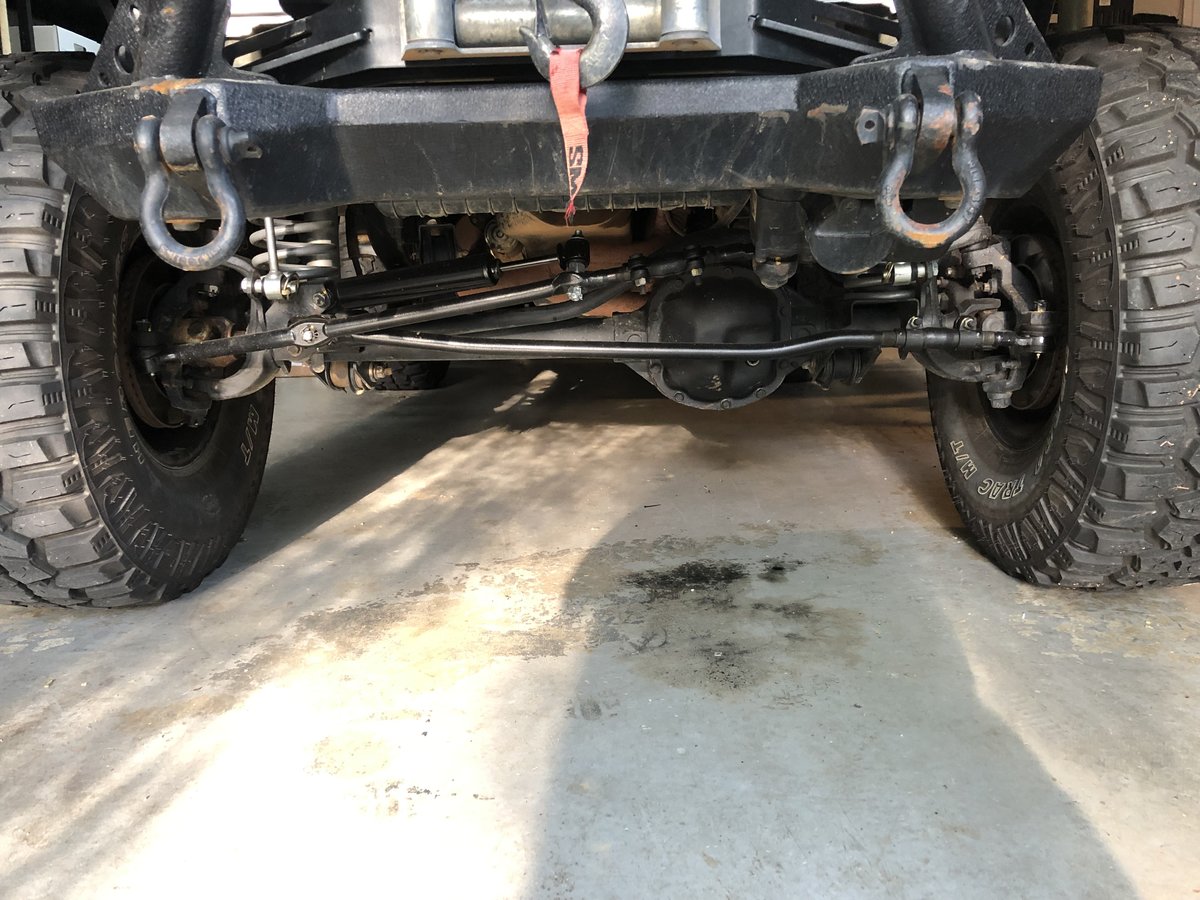

Quick question. Awhile back I did the ZJ upgrade. Everything went great and has been since.
I noticed that the Tie Rod is not level to the axle like I’ve seen in some pictures. The driver side is lower than the passenger side. Is this normal?
I’ll try to get a picture if needed later on today.
Makes sense. I do have a 2.5” suspension lift and an awful 2.5” body lift from PO.
Figured it had to do something with the lifts.
Yes plz post a pic.
