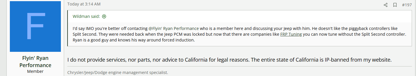

02 modified TJ, I don’t know where its going rebuild
Well……not, I did not see Flyin Ryans post. Even if I pass smog, no help? I feel I should go to the smog shop that the dealer used I bought the rig from. I am going to give them a call tomorrow to make an appointment. I recall they paid a large some to get her on the road, sure this is a referee shop as well, they did not have the Banks CARB compliant sticker, they found it later. I know what I am doing today at least.
It's nothing against you or your Jeep... It's a CYA thing and you can't blame him with how businesses have been ruined from places dealing with smog things.
I thought one you had your CARB sticker you could take it to any place to have it smogged? Also I'd check to make sure that innercooler is legal...

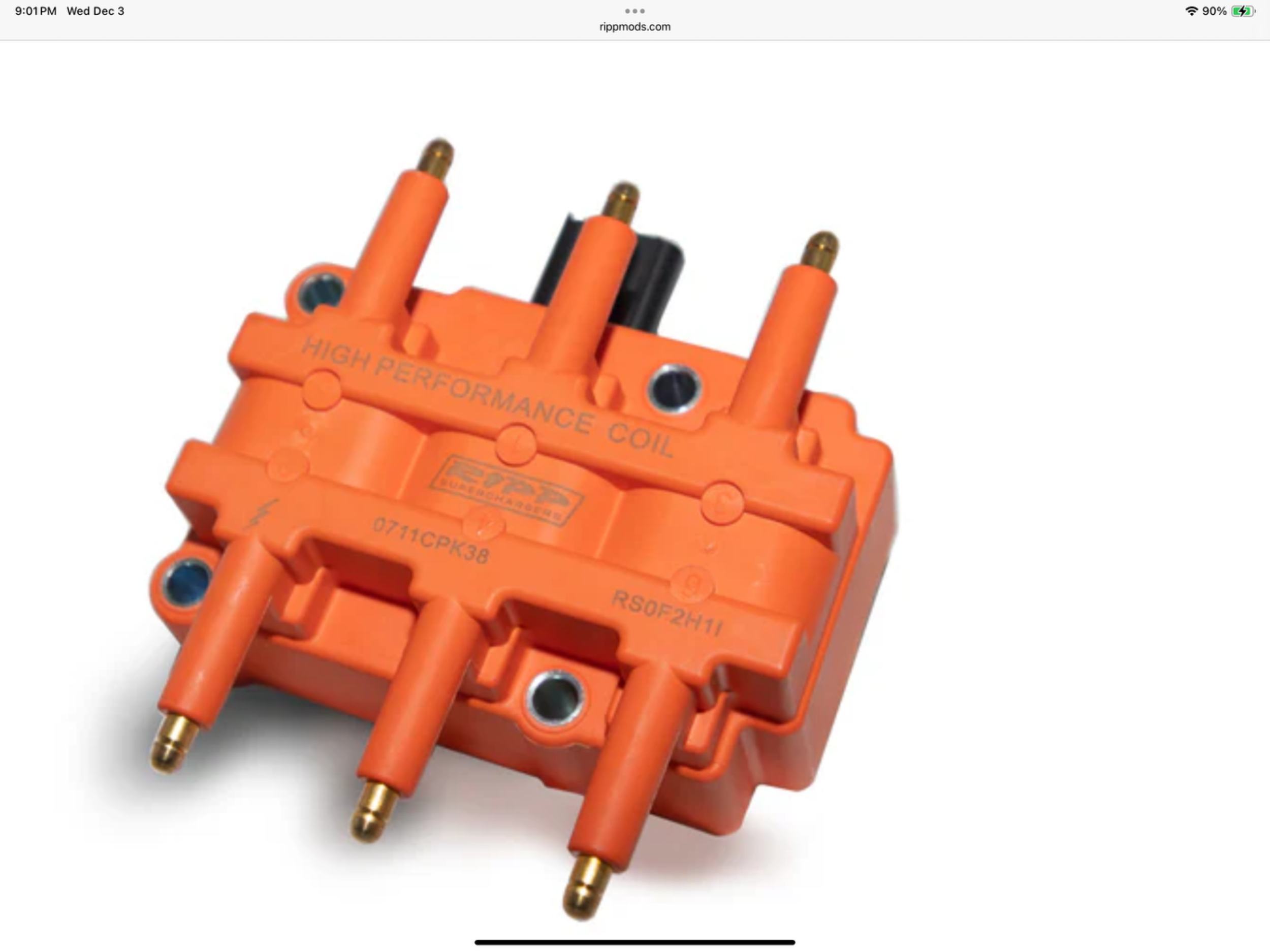

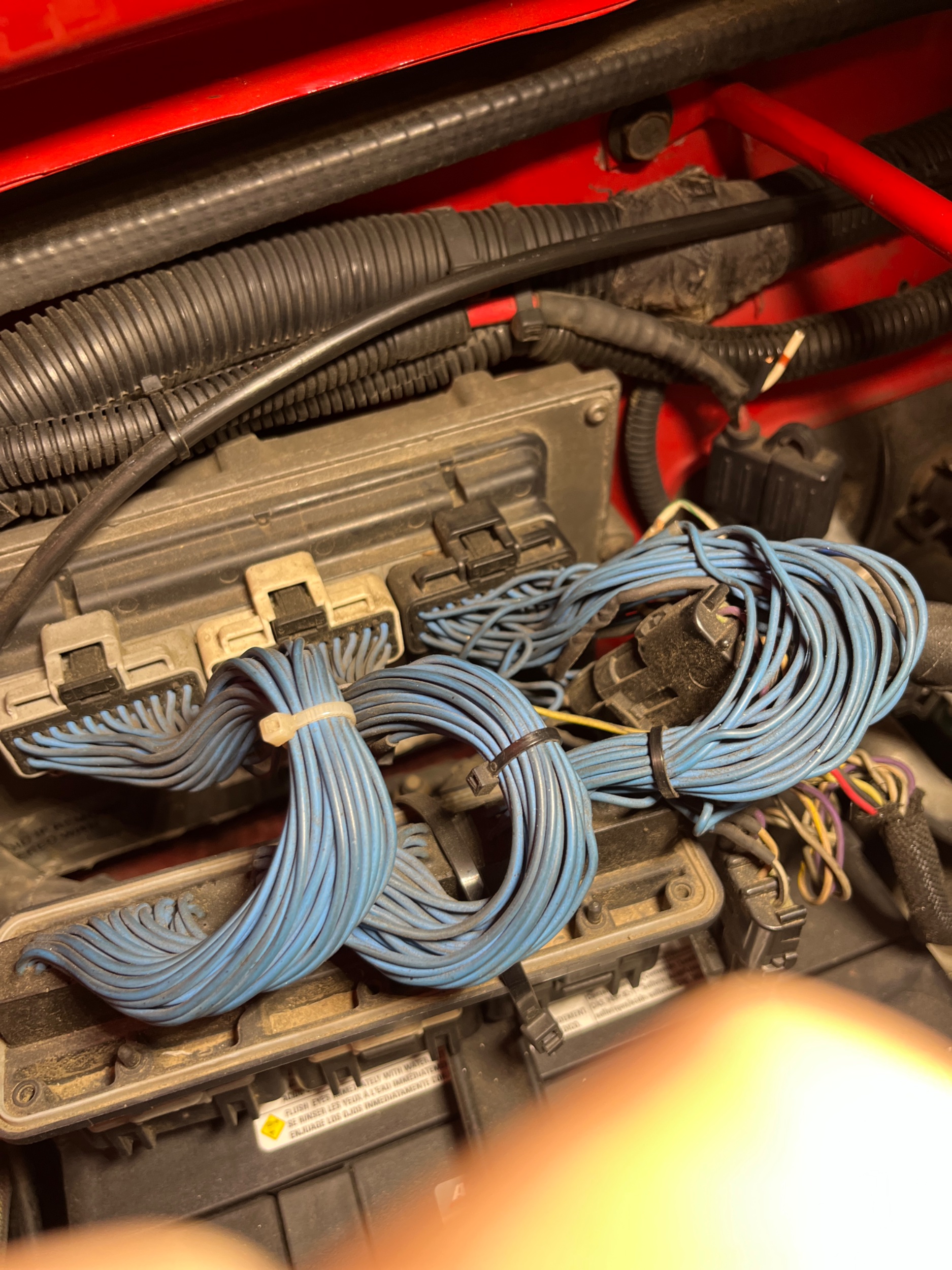

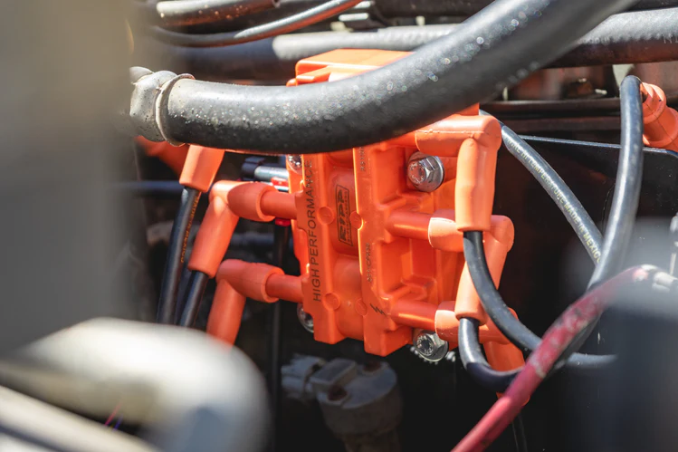

Yippie! She passed smog, only question out of his mouth what year and where is down stream cat? Along with a new high current alternator, I am putting this ripp coil on my list with R4 software and clean up this pcm swap/split second piggy back splicing mess. PCM replacement is from Auto Module source, I reached to Mark at Wrangler Fix .com. Need to tear into it more to get better info on pcm replacement.

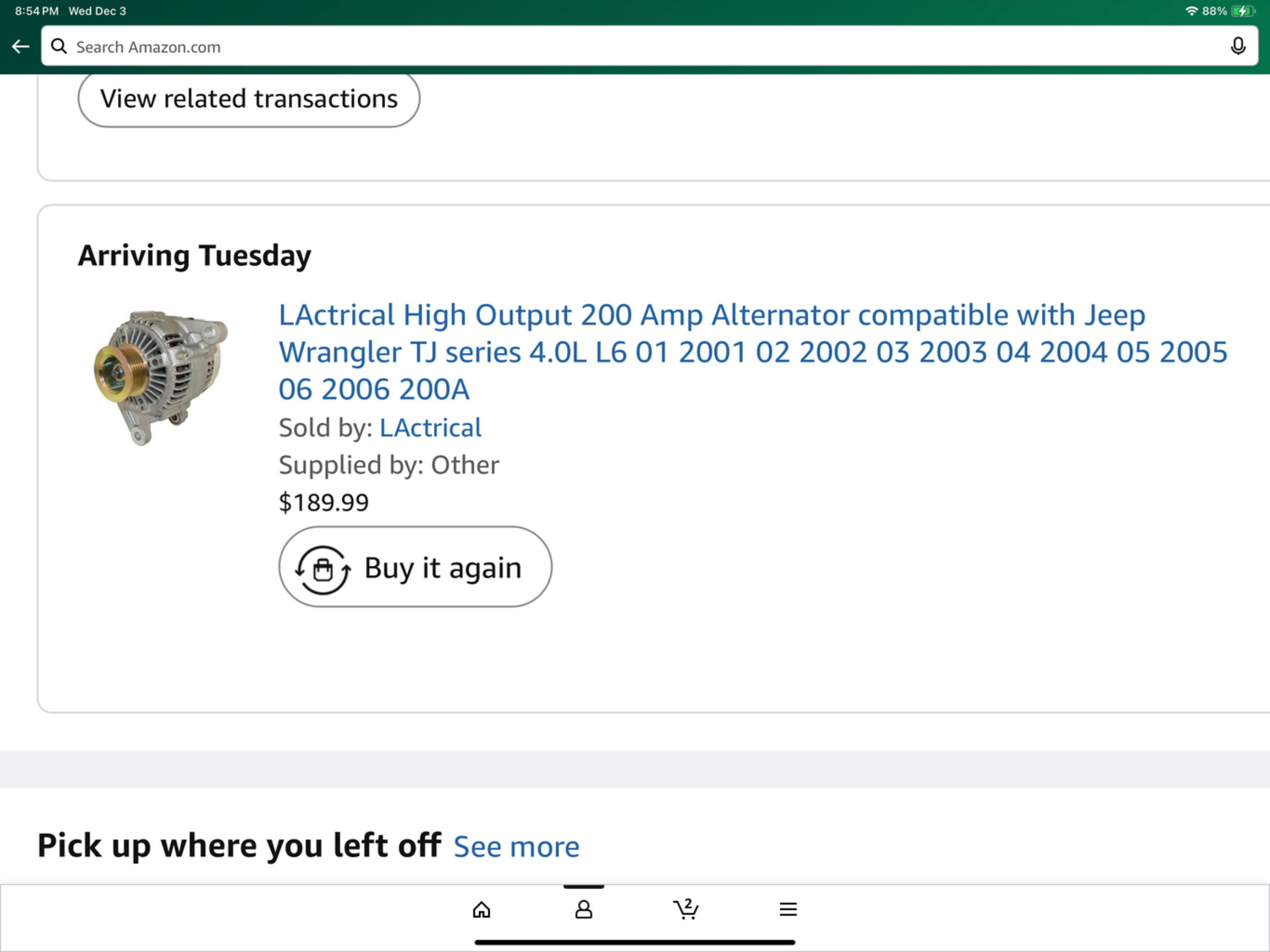

I discovered the alternator I ordered on Amazon which I paid extra shipping (have prime account) LActrical is right here in Burbank CA! They have a E-bay site as well. They offer a 250amp for TJ’s 50 bucks more. Have not found store front service yet, may trade up.

Watch as some of the higher amp alt won't make as much at idle as the lower ones do. So unless you've got a huge drain on your electrical system you don't always need that extra.

You really don't need a huge amp alt for that. My point was that before trying to upgrade ask them what each alt is putting out @ 750-1200 RPM's. That is the more important data as opposed to what the max is.

Well,,,here I go again. I will be returning the Lactrical Alternator and get the power one hairpin, no worries with this one.
Rated 80amps at idle

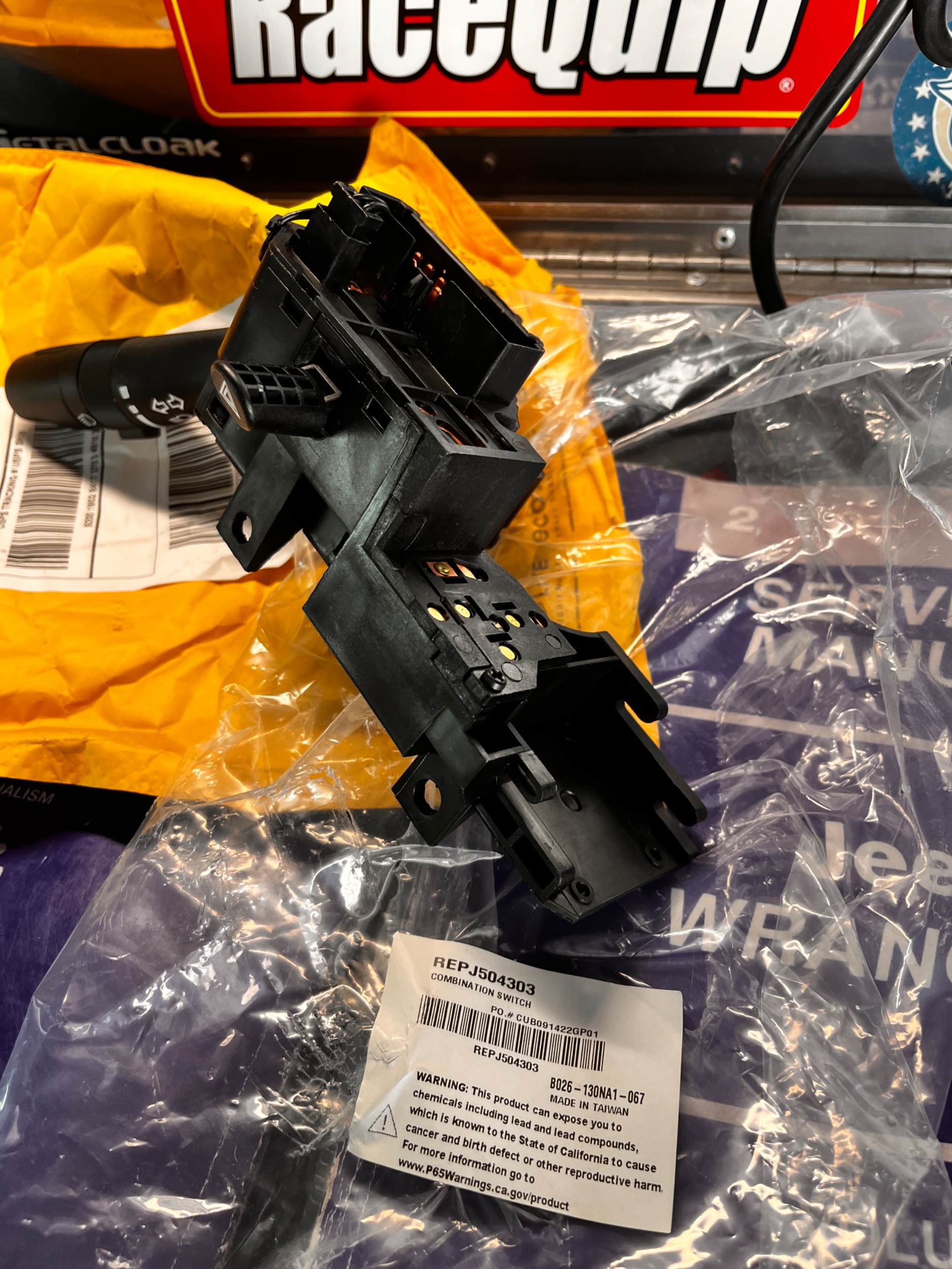

I received the replacement switch module today. I swapped over wiper switch and got it in, so…..The led flasher still chattering when I switch battery power on. I found the oem flasher, stuck that in and no chatter and of course no turn or brake signals with old flasher. The headlight issue has been fixed with new module, got low and high beams now, all other switch positions work, didn’t test fog switch yet. The other bonus no idle change either when turning on headlights and alt not wining as much. Waiting for new led flasher, should get it next Thursday. If it still chatters I have some short going on in wiring harness? Alternator from Amazon may roll in tomorrow, I get some more info on that current output at idle rpm range before pulling trigger on hairpin. I Got the Malibu moving today, cleaned throttle body and did the throttle position reset procedure, all good for now. Struts and control arms need replacing and fix oil leak with a tune up. She wants it done this month. I am giving her very fair price for the job, it will cover the RIPP coil and the difference on alternator swap and or new battery? 😃
