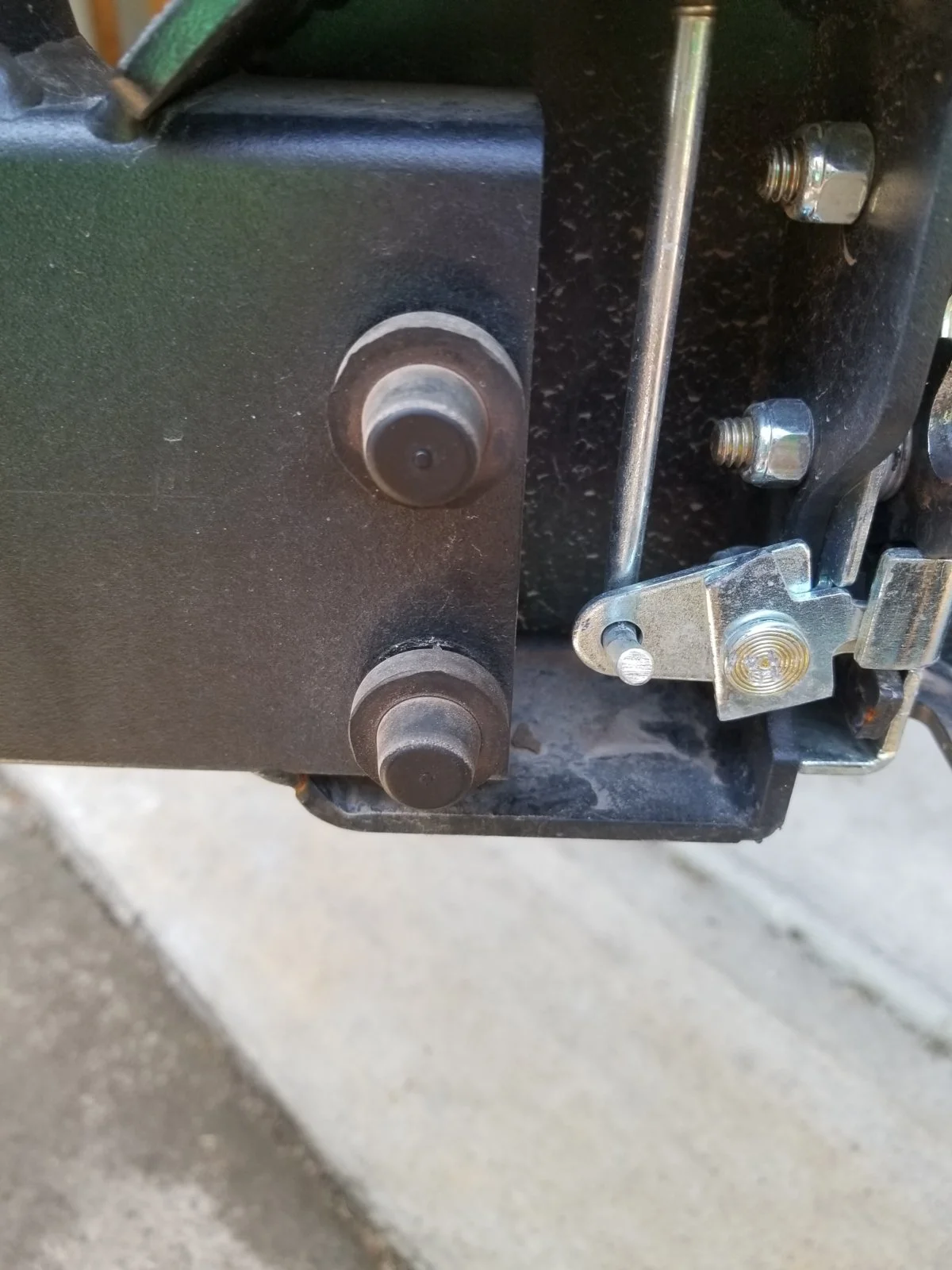

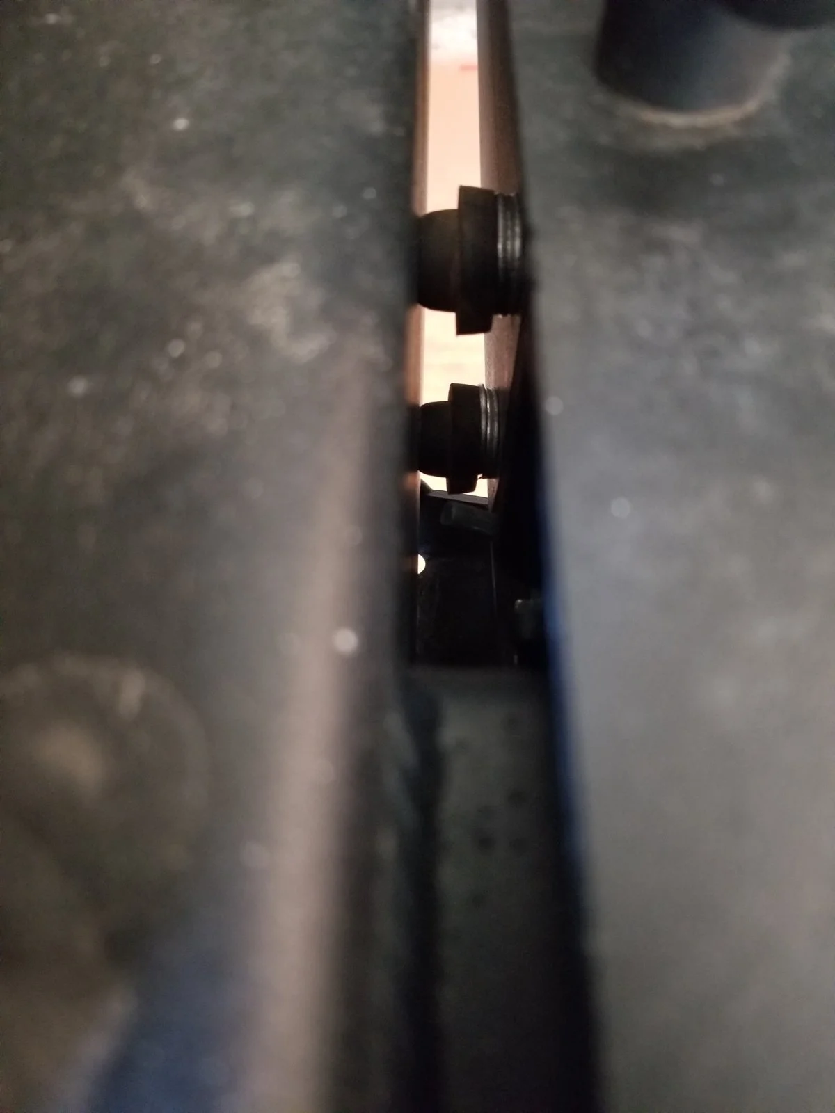

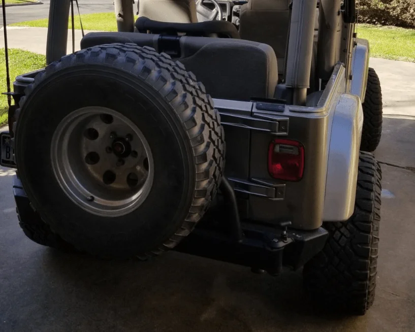

Just posting an update about my Metalcloak rear bumper/tire carrier. Had an inquiry about the bumper today.
You can't find much information on these bumpers.

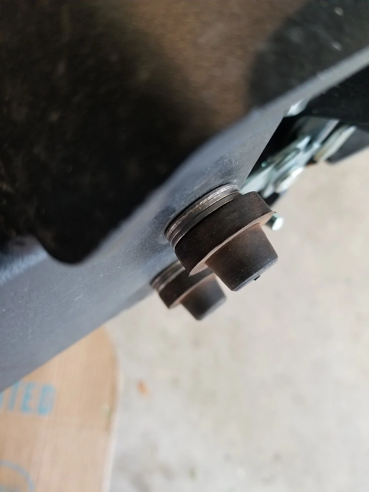

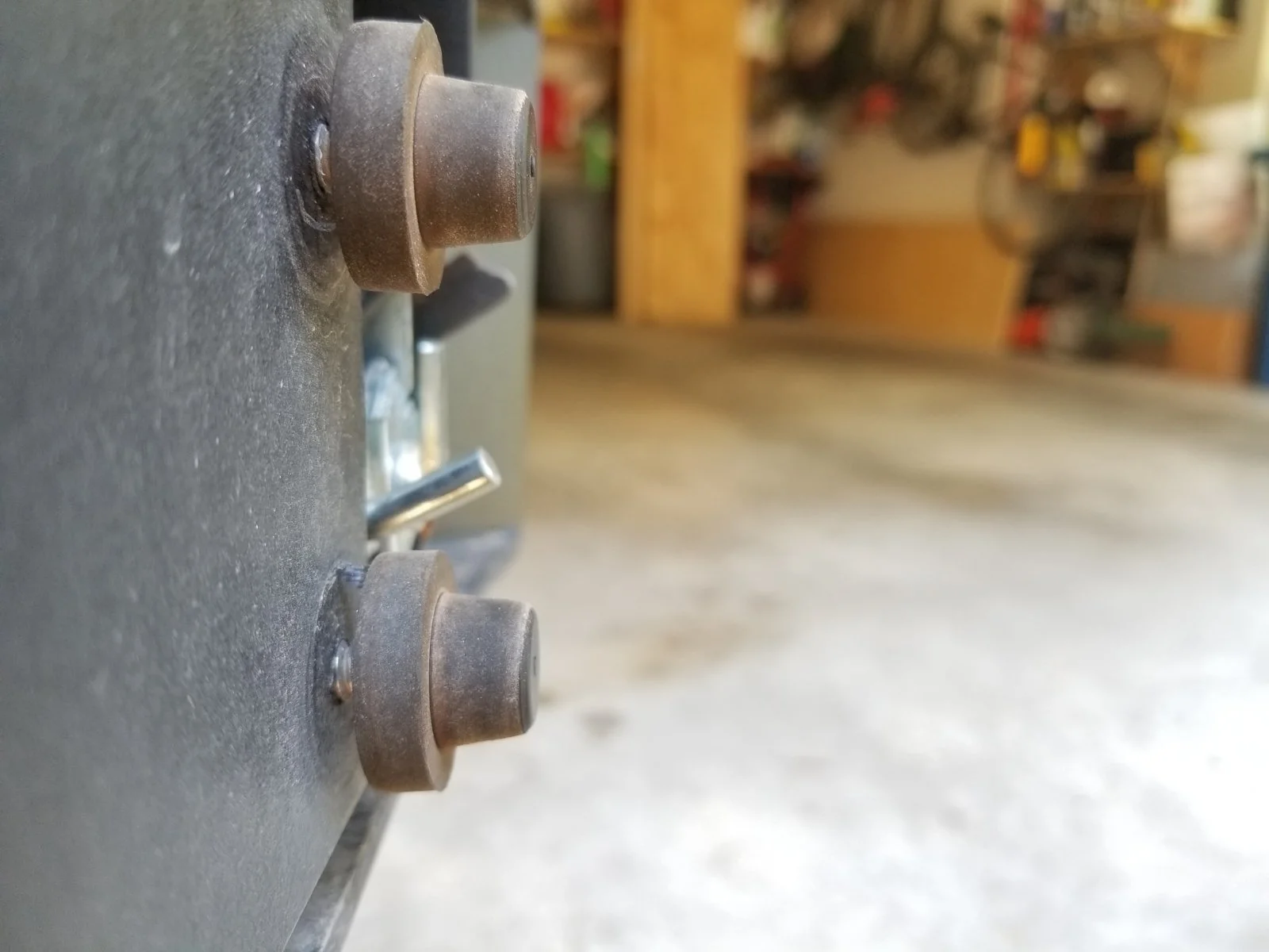

Probably after about 3 months I noticed a rattle. I thought maybe it was something with the suspension but couldn't find anything underneath. After further inspection, I figured out it was the bumper. It has these rubber bumpers which I didn't realize could be adjusted. I adjusted the rubber bumpers 1/8th in. I have had absolutely no rattles since doing this. Finally added some washers so I could snug the rubber bumpers up.
I am also very pleased with this bumper and have zero complaints about it. Well... maybe the price? Definitely worth the price compared to others on the market. I have heard many times "You get what you pay for".
Nice! I guess the little rubber bumpers stayed out where you needed them for a few months then. Did the tire carrier just hold them in place for that time? Good solution.
The rubber bumpers are basically a threaded bolt. I just drank a beer and said "watch this... I will unscrew it. This will make it snug" then it worked.
Some of my best ideas originated when I was drinking beer. Some of my worst ideas also originated when I was drinking beer.

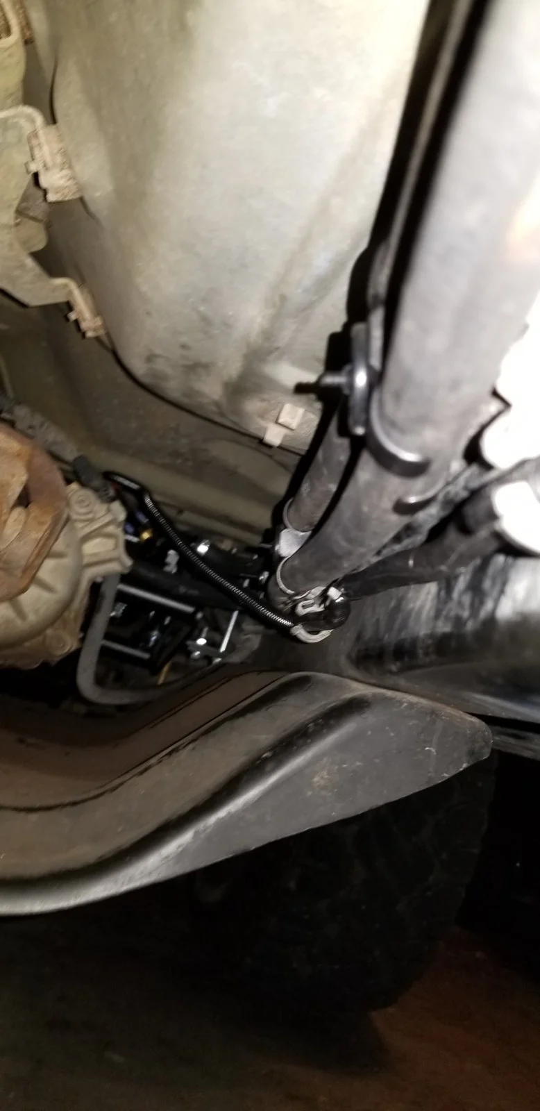

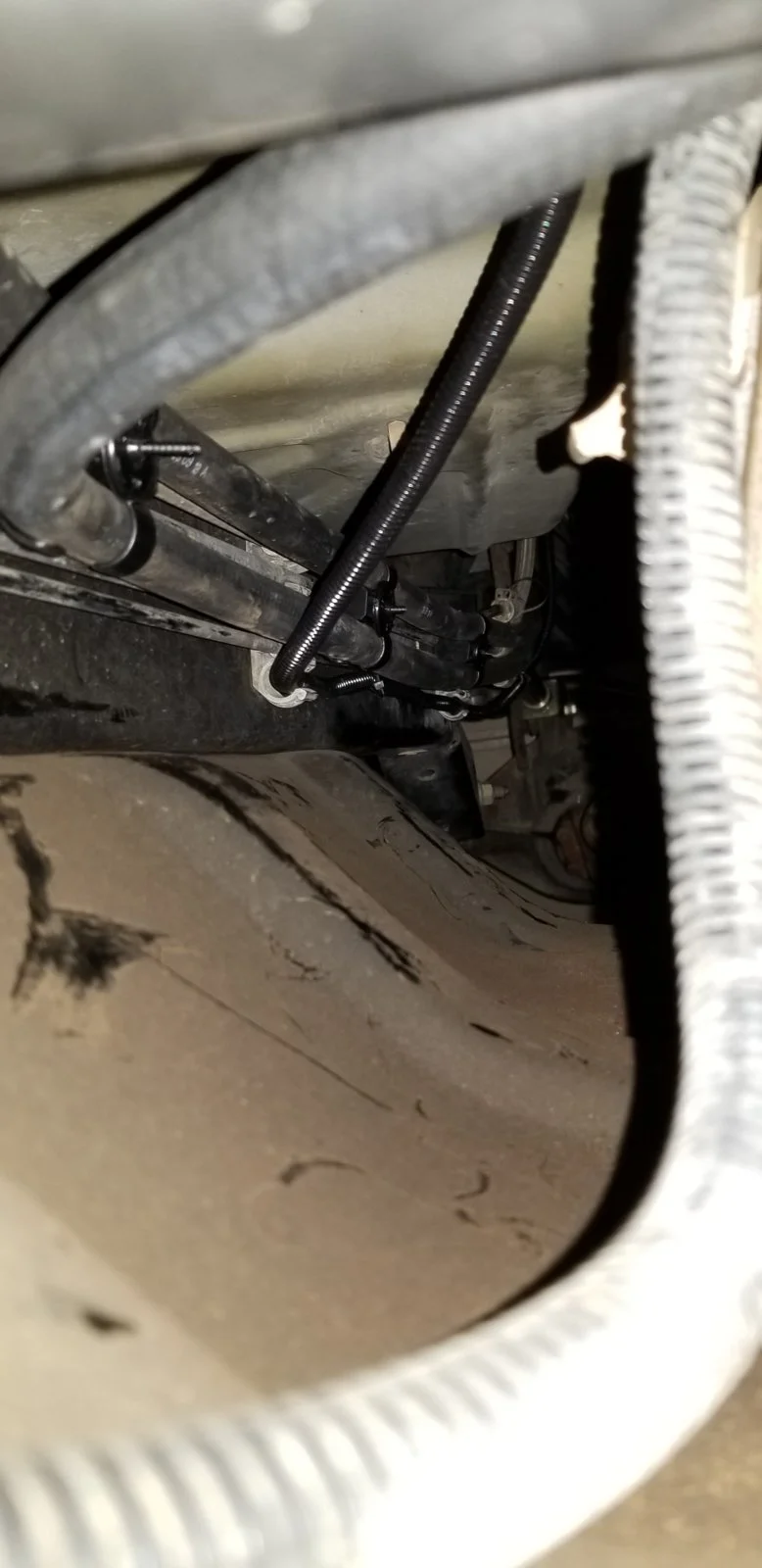

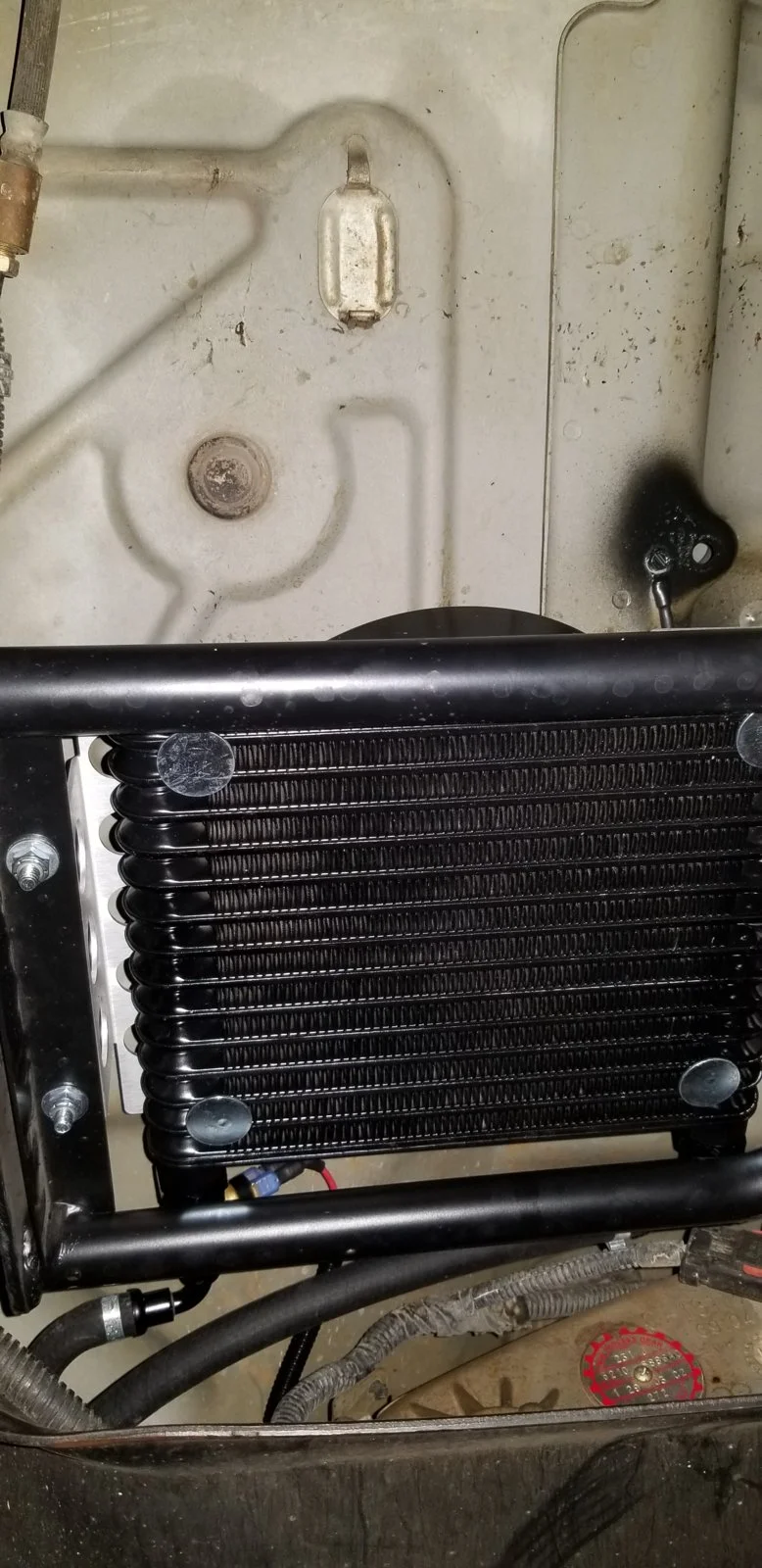

Few install pics...

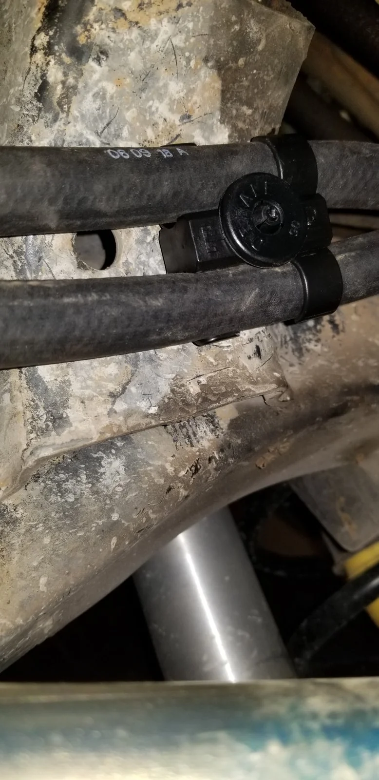

Hoses run along the fuel lines towards the front.
Looking back at the cooler from the front.
The hoses were hanging pretty low. I managed to use one of the hose clips and attached it to the frame.

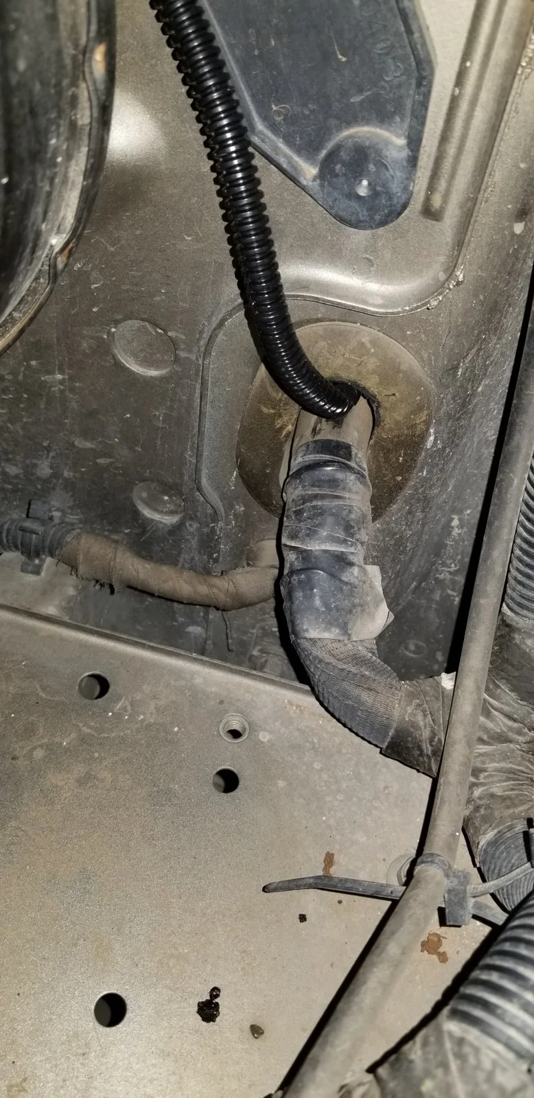

Ran the power wire through the driver side firewall.

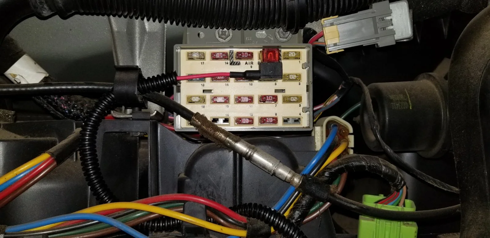

Setup a fuse tap in the #6 port which is powered by the ignition.
Yeah, it really does look good. I’m glad I took a few minutes to look at the details in your pics. Frame and skid plate look good too. Everything you did on that Derale cooler looks better than professionally done!
Reactions: KCsTJ
Thats beautiful work @b0xcar, looks very well thought out. :)
Thanks guys! I'm just glad it works. There was a bit of relief when @JMT heard it running on our last trip out.
