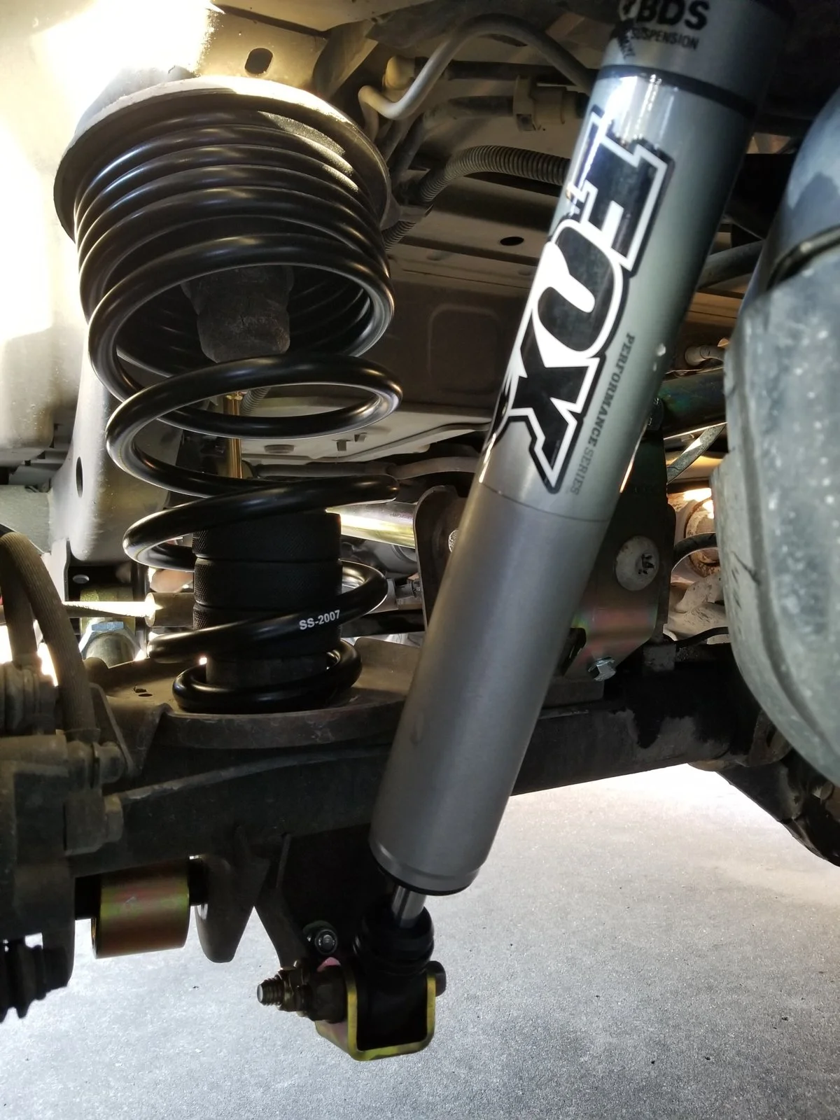

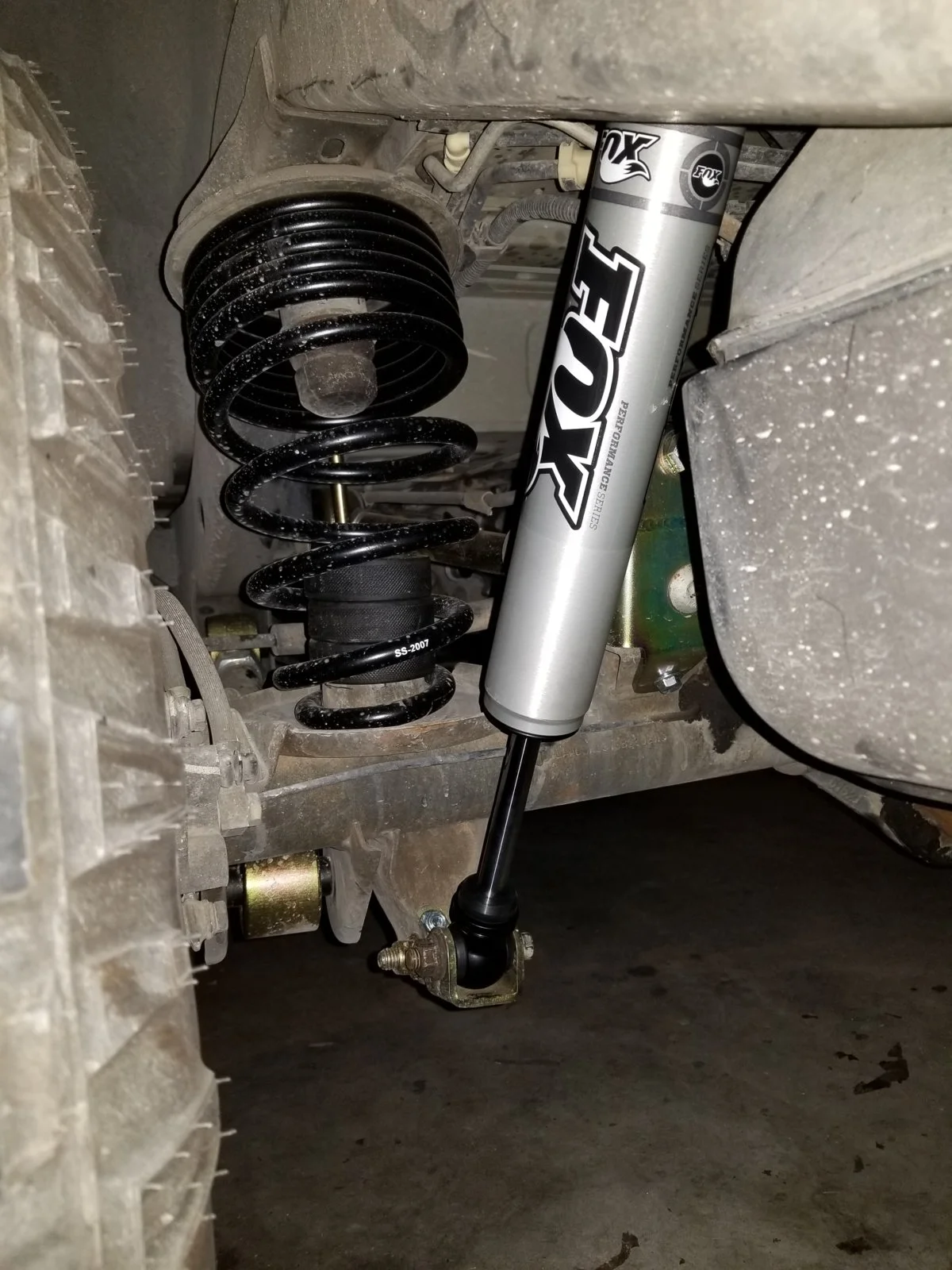

The new rear shocks came in today. The rear shocks that were originally installed ended up being too long. Replacements were ordered and they came in today. The ride quality is night and day with the proper length shocks.
So I believe these were for a 6in lift. The only number I could really read was BDS-8250 for this shock.
The correct length. 985-24-086 is the rear shock for a 2.5"-3.5" lift.

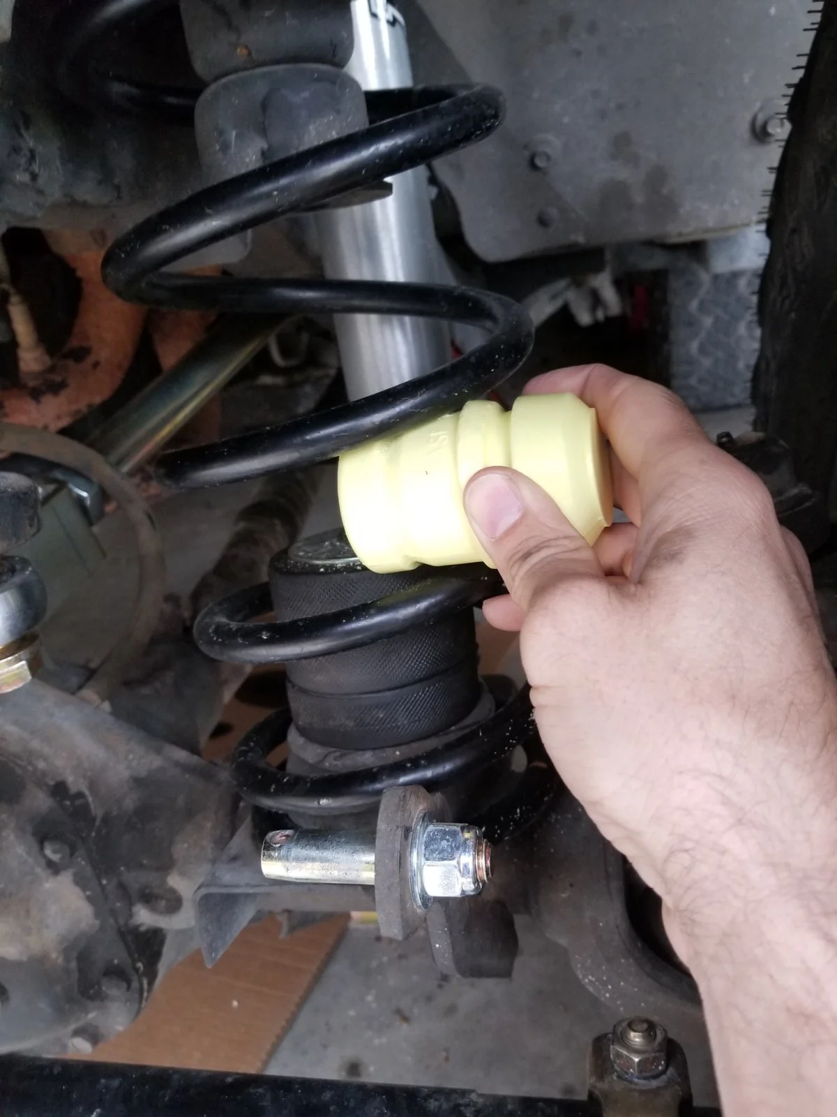

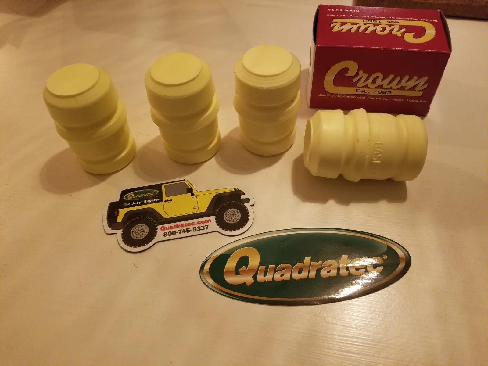

So I decided to purchase these jounce bumpers from quadratec. Almost went with the black energy suspension cone shaped ones but I really couldn't pass up the savings on these puke yellow ones. They were sooo much cheaper by a whole $1 that all I could think about was the extra beer I could purchase at Apple Bees during happy hour. The bumpers won't be yellow for long with all the dirt, mud, grit and grim that gets thrown underneath the Jeep.
Still need to purchase some silicone spray to help slide these beauties in the cups. Install is set for tomorrow!
So I decided to purchase these jounce bumpers from quadratec. Almost went with the black energy suspension cone shaped ones but I really couldn't pass up the savings on these puke yellow ones. They were sooo much cheaper by a whole $1 that all I could think about was the extra beer I could purchase at Apple Bees during happy hour. The bumpers won't be yellow for long with all the dirt, mud, grit and grim that gets thrown underneath the Jeep.View attachment 35529

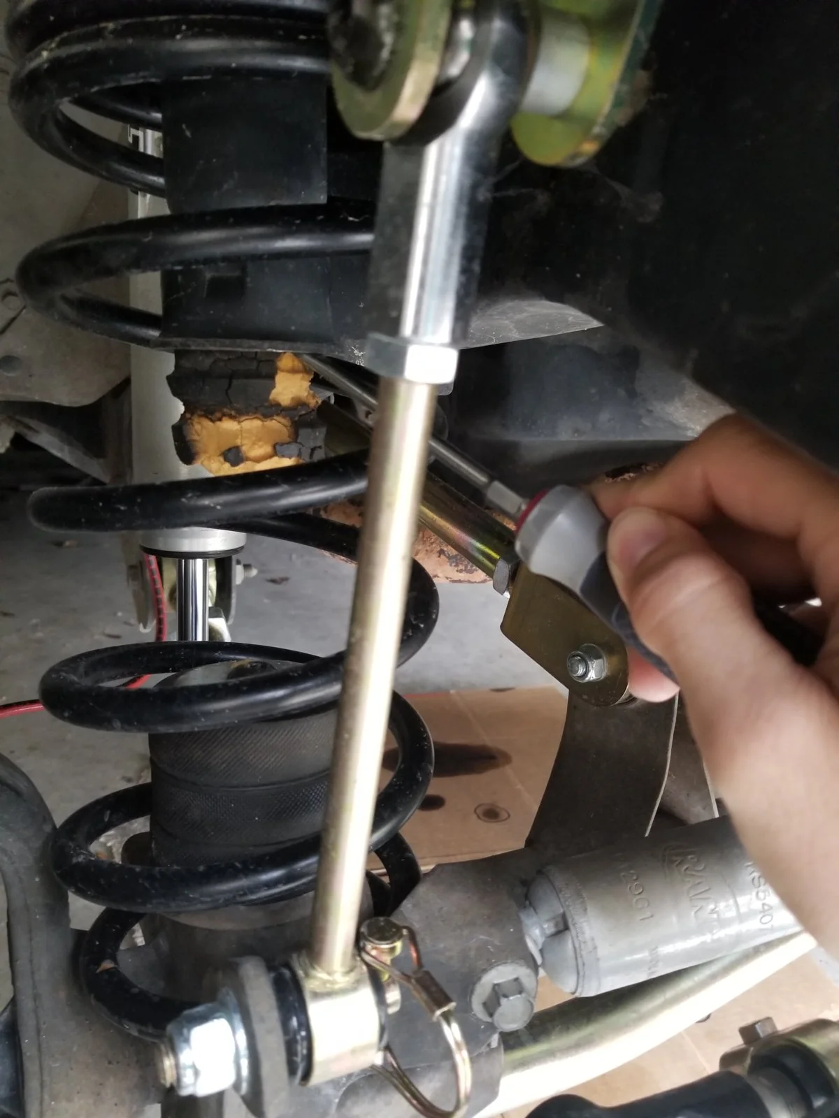

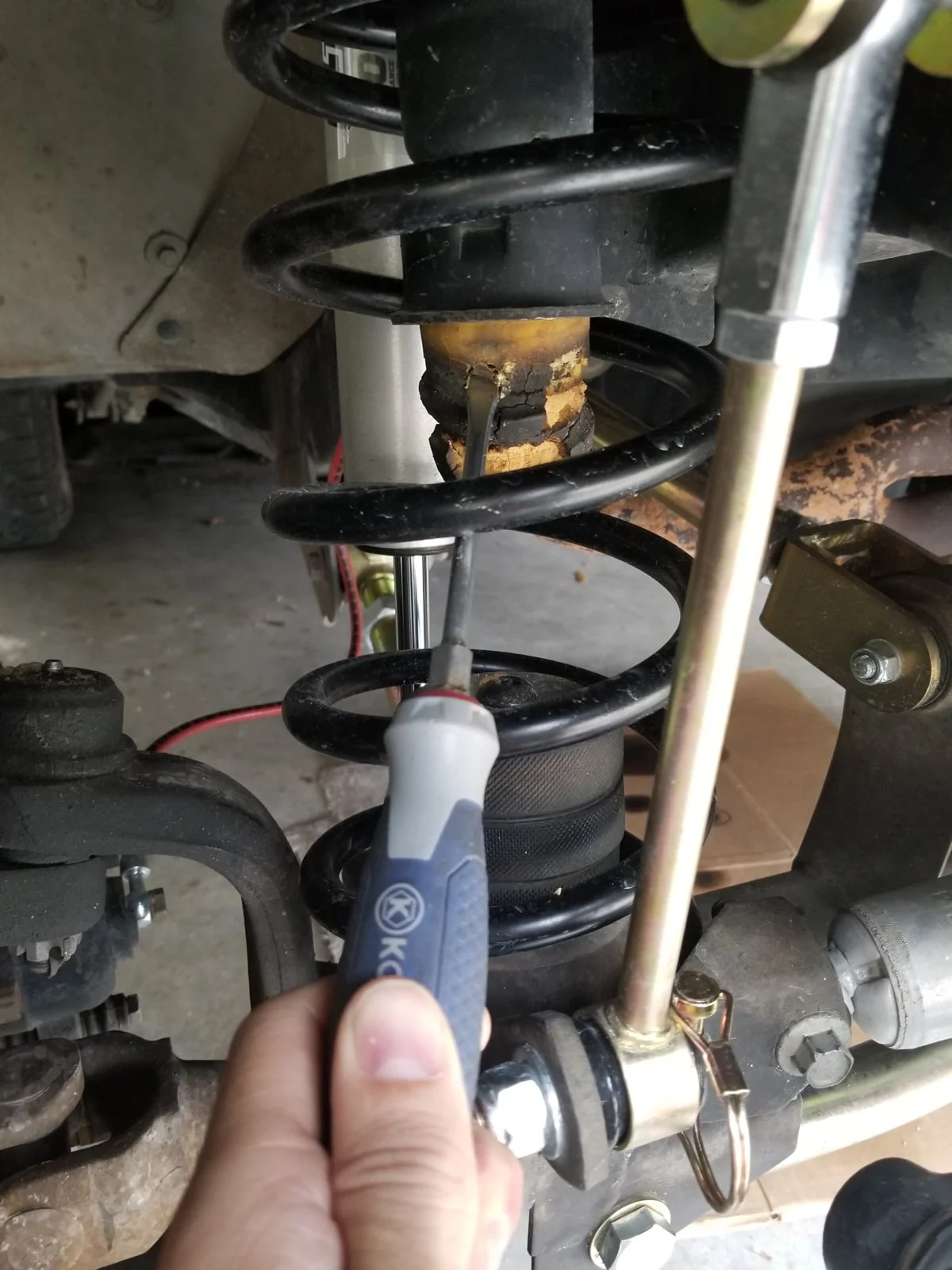

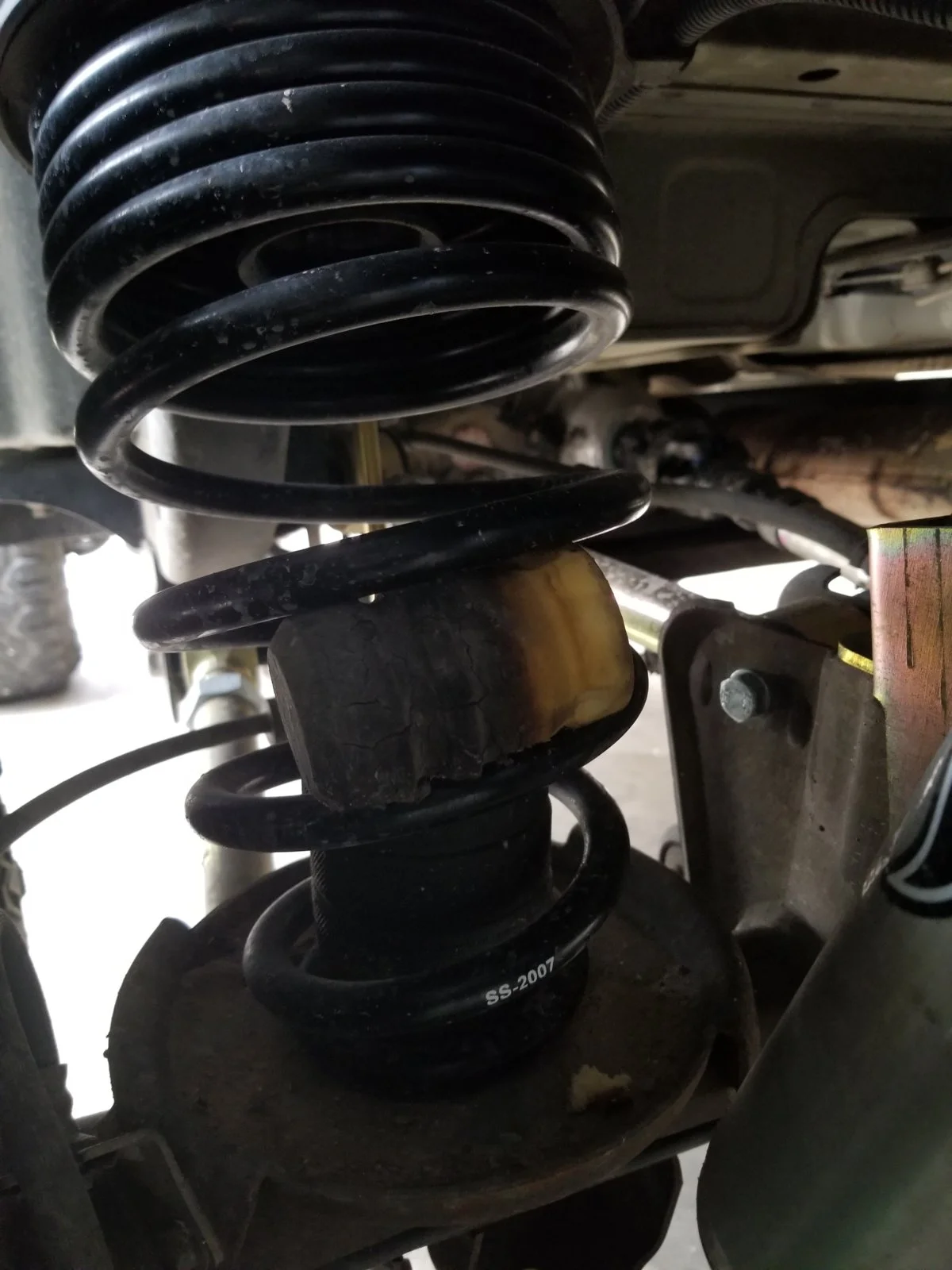

Jounce bumpers are a pretty easy install.
Pry the old ones out with a screw driver.

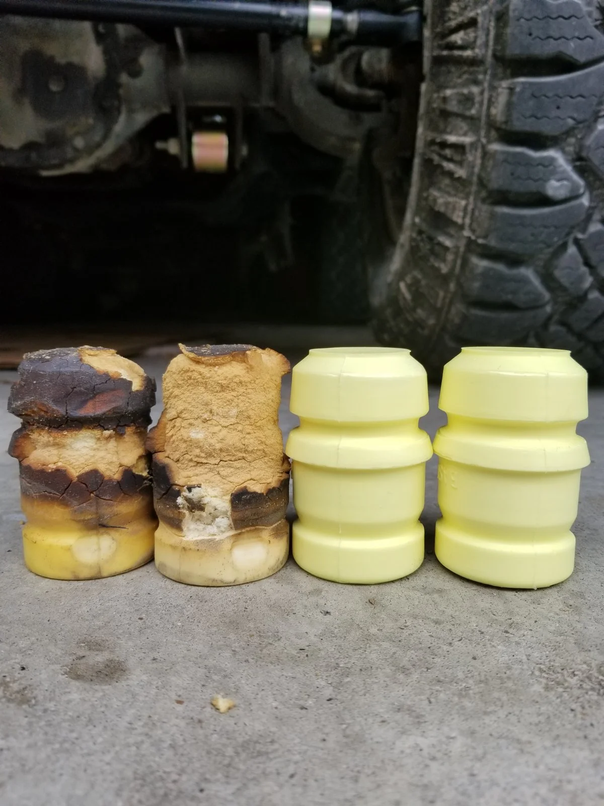

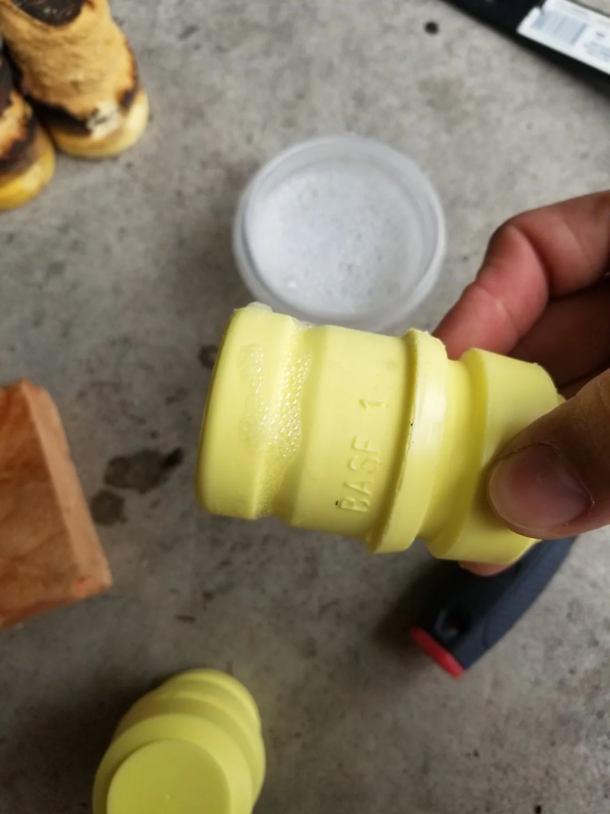

Comparison of the old vs new

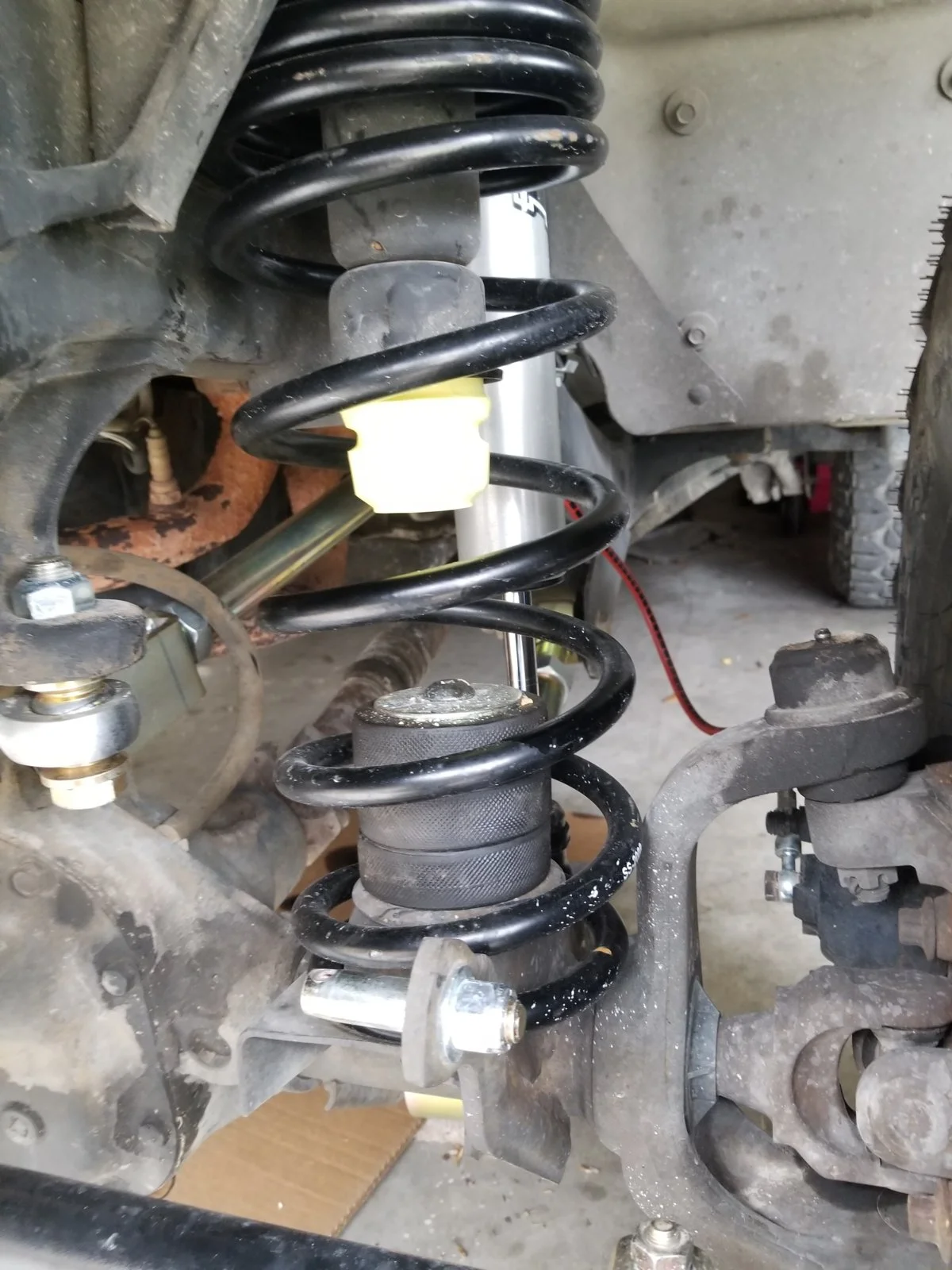

Used a little dish soap recommended by @derekmac to help slide them through the springs and in the cups.

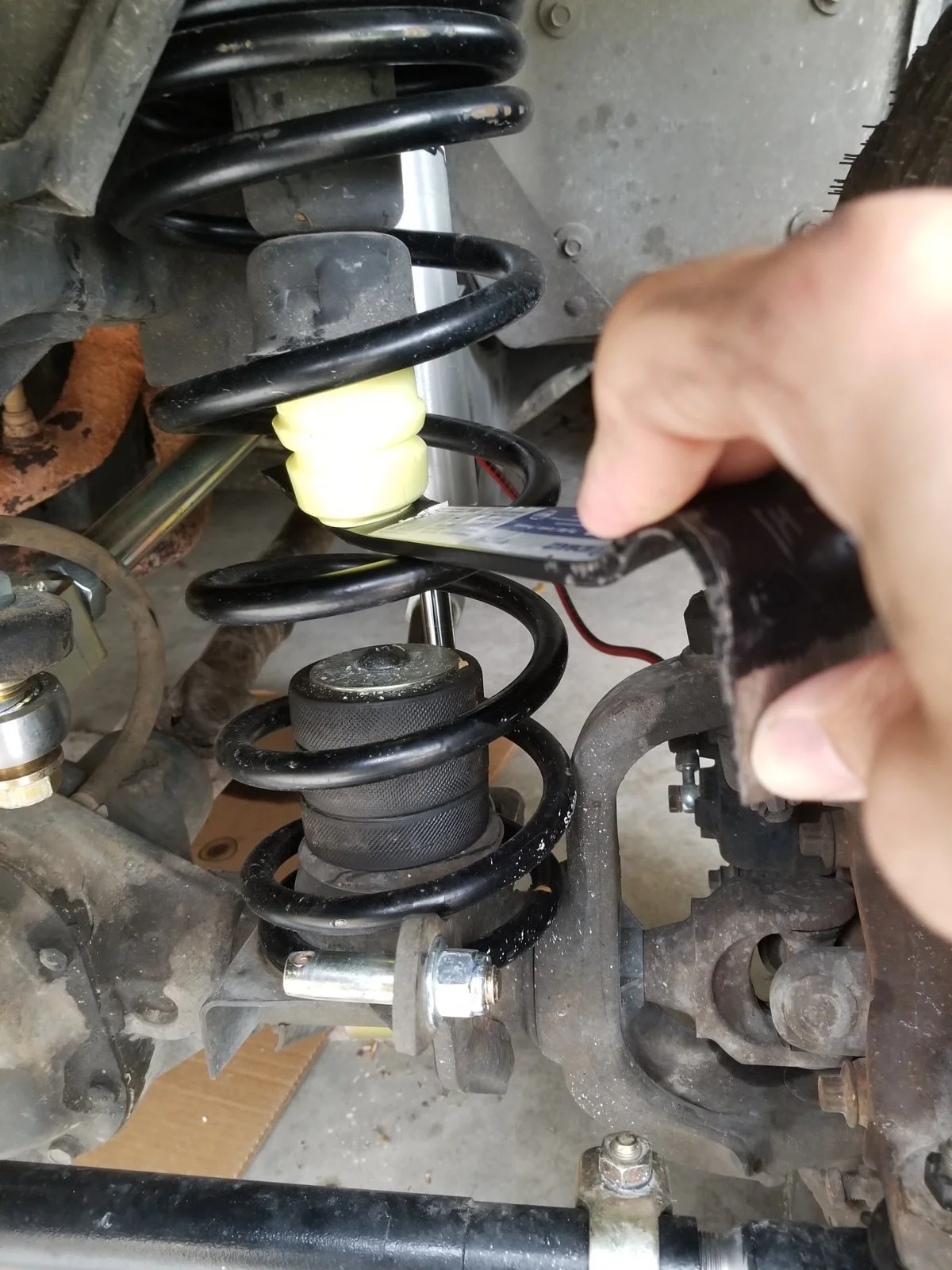

Plenty room on Metalcloaks front springs to slide the jounce bumpers through.
Used a flat bar to push bumpers up into the cups.

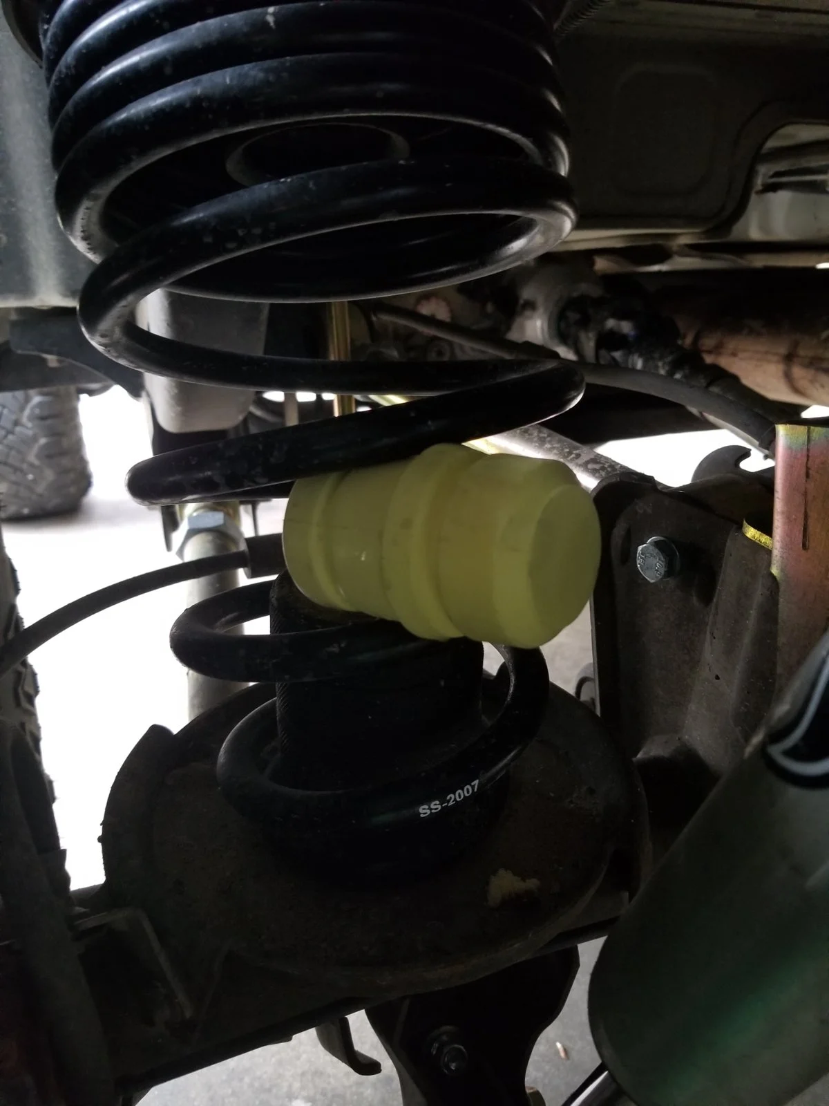

Finished front

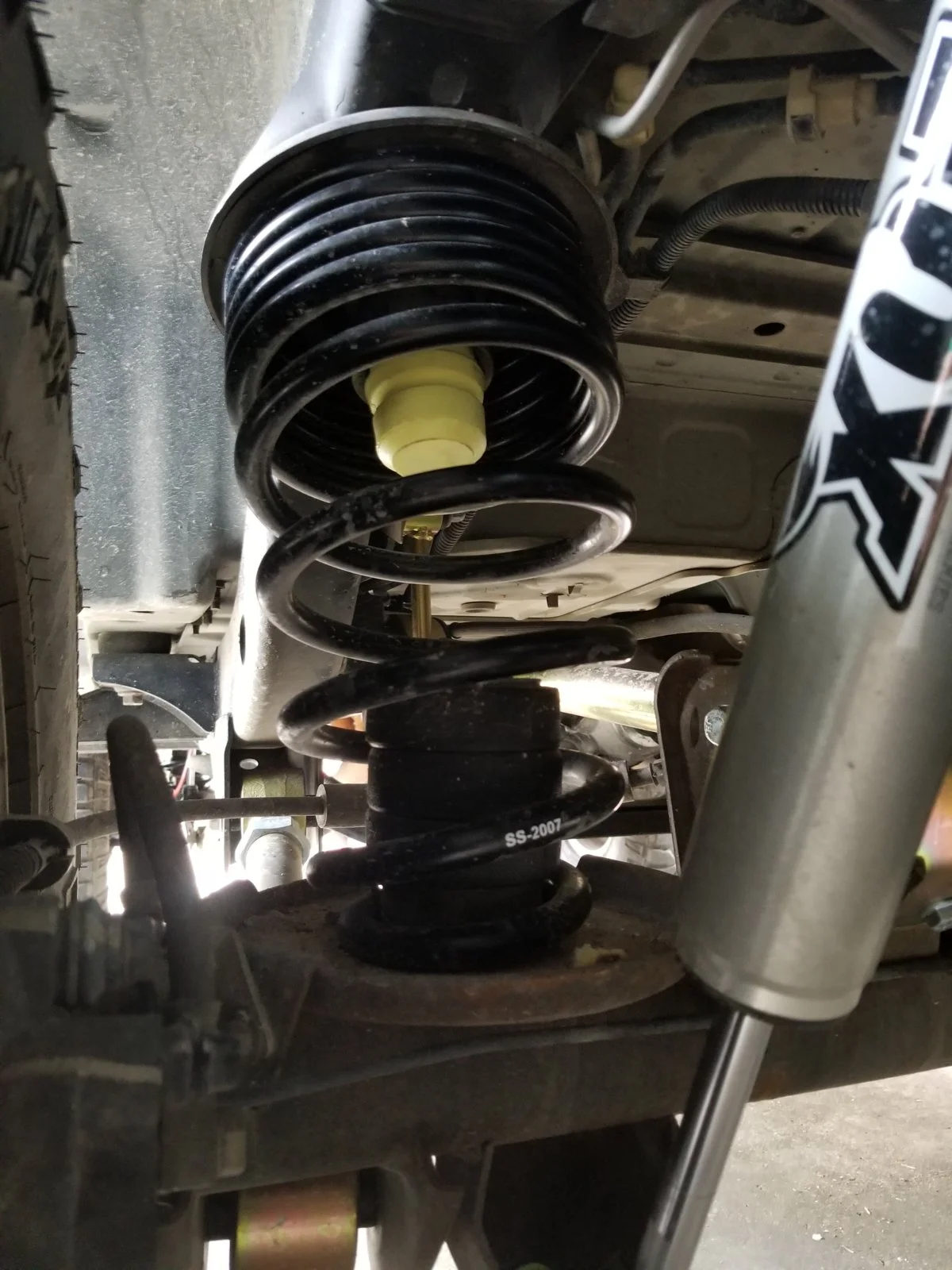

The rear springs were a little tighter but same process as the front.
The jounce bumpers all around went into the cups easier than I expected. :thumbsup:
Finished front
View attachment 35568 View attachment 35569 View attachment 35570
The old ones look like a dessert gone bad! Maybe some Tiramasu you brought home from Applebee’s!
Lol... The old ones were definitely toast! Pretty good comparison with the Tiramasu.

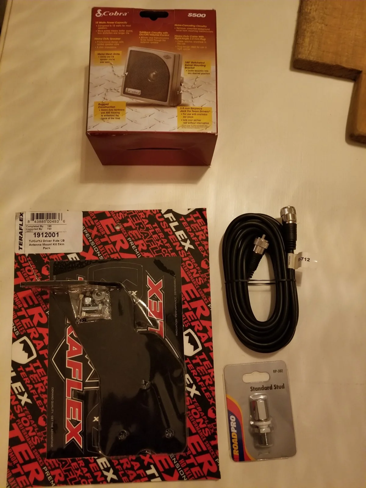

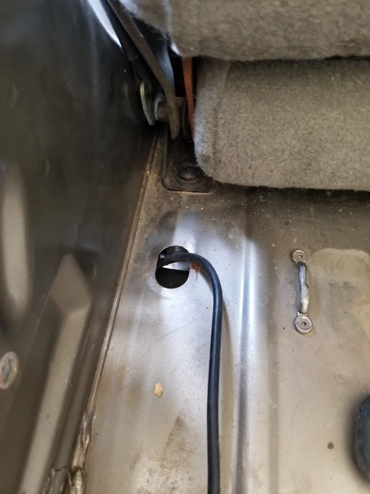

Got the Cobra 75 wx st installed today. Just lacking the antenna (should be here in a few days). Wired the CB directly to the battery. Using the Teraflex mount on the drivers side. This is how I ran the coax cable into the Jeep.

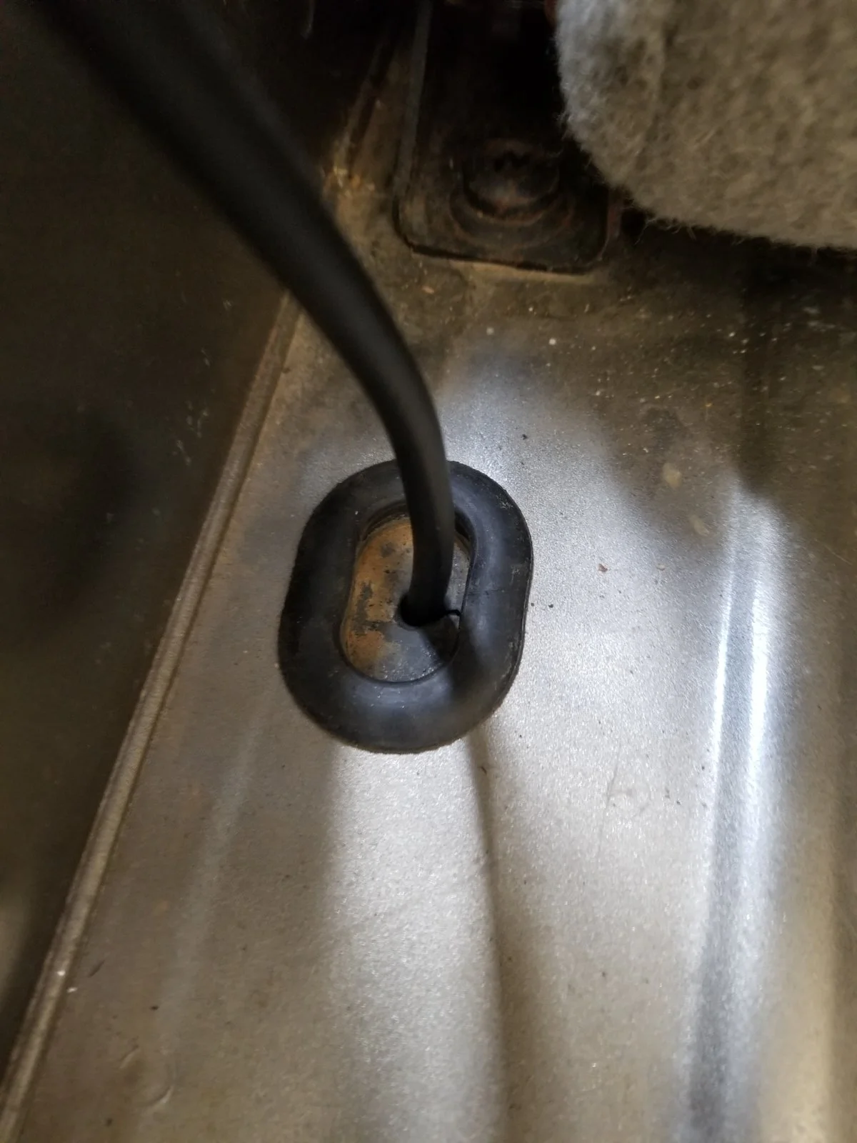

Pulled this drain plug.

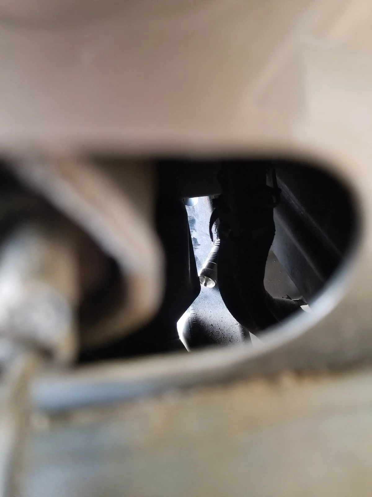

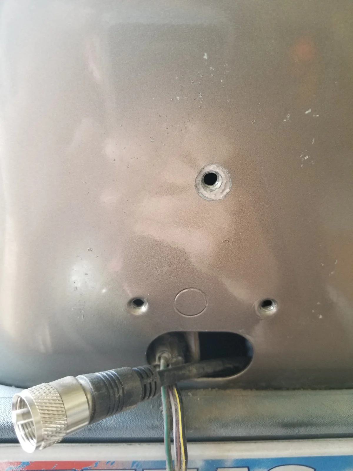

Looking through the tail light hole you can see the end of the coax cable peeking through.
Feed it up to the tail light hole from there. Also grinded some paint from the top tail light hole. The powder coat on the Teraflex mount was already removed for that spot. It also had the powder coat removed underneath where the antenna stud mounts.
Drilled a hole in the rubber drain plug and cut it down the side to fit the coax in the hole.
