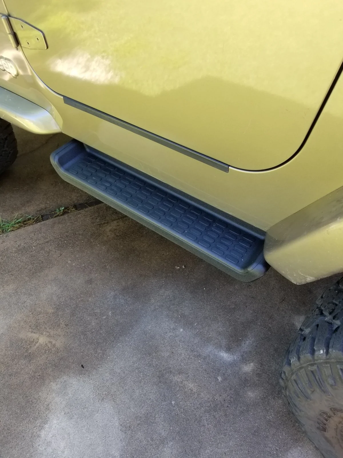

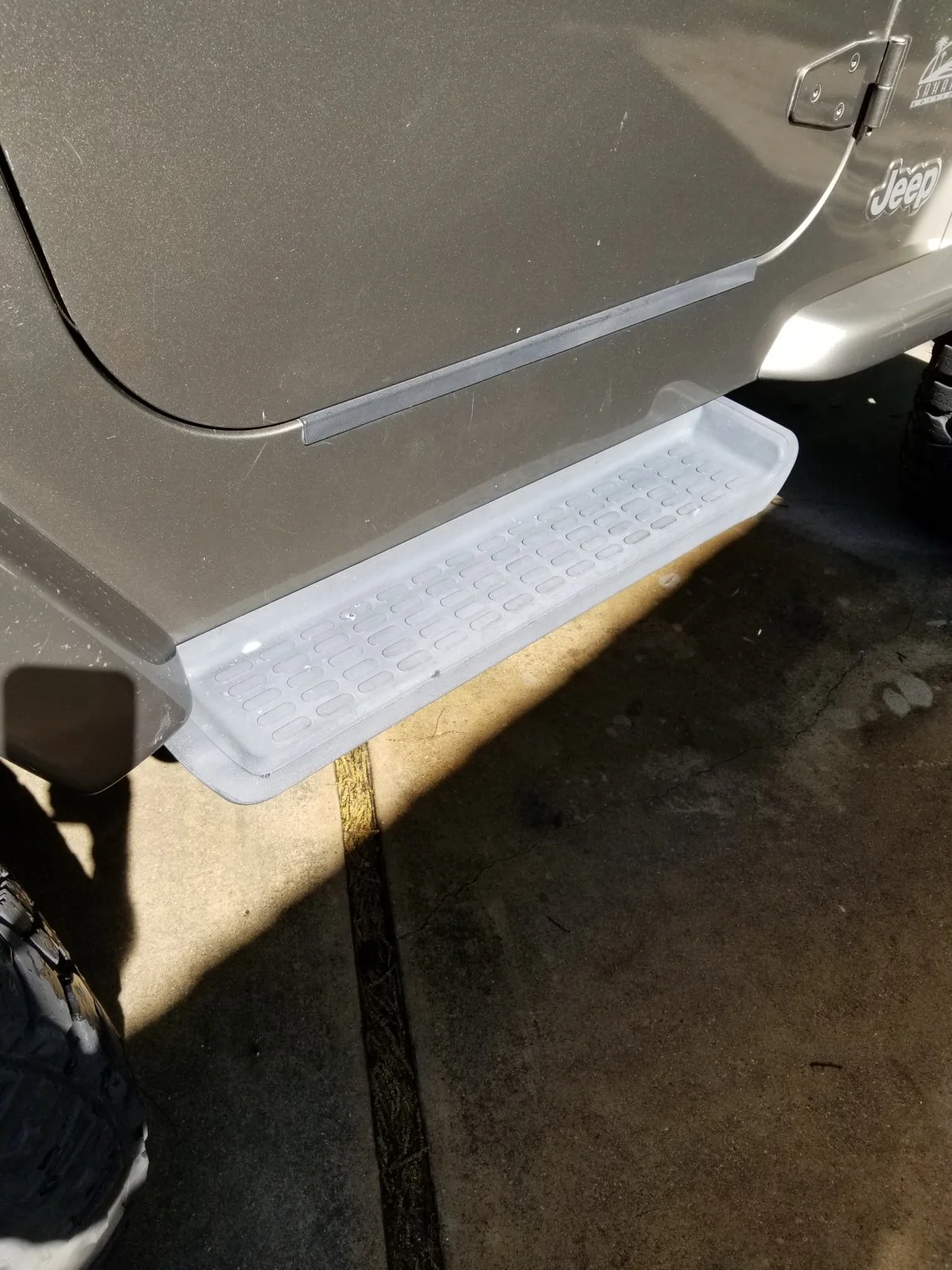

BEFORE - Really faded/gray

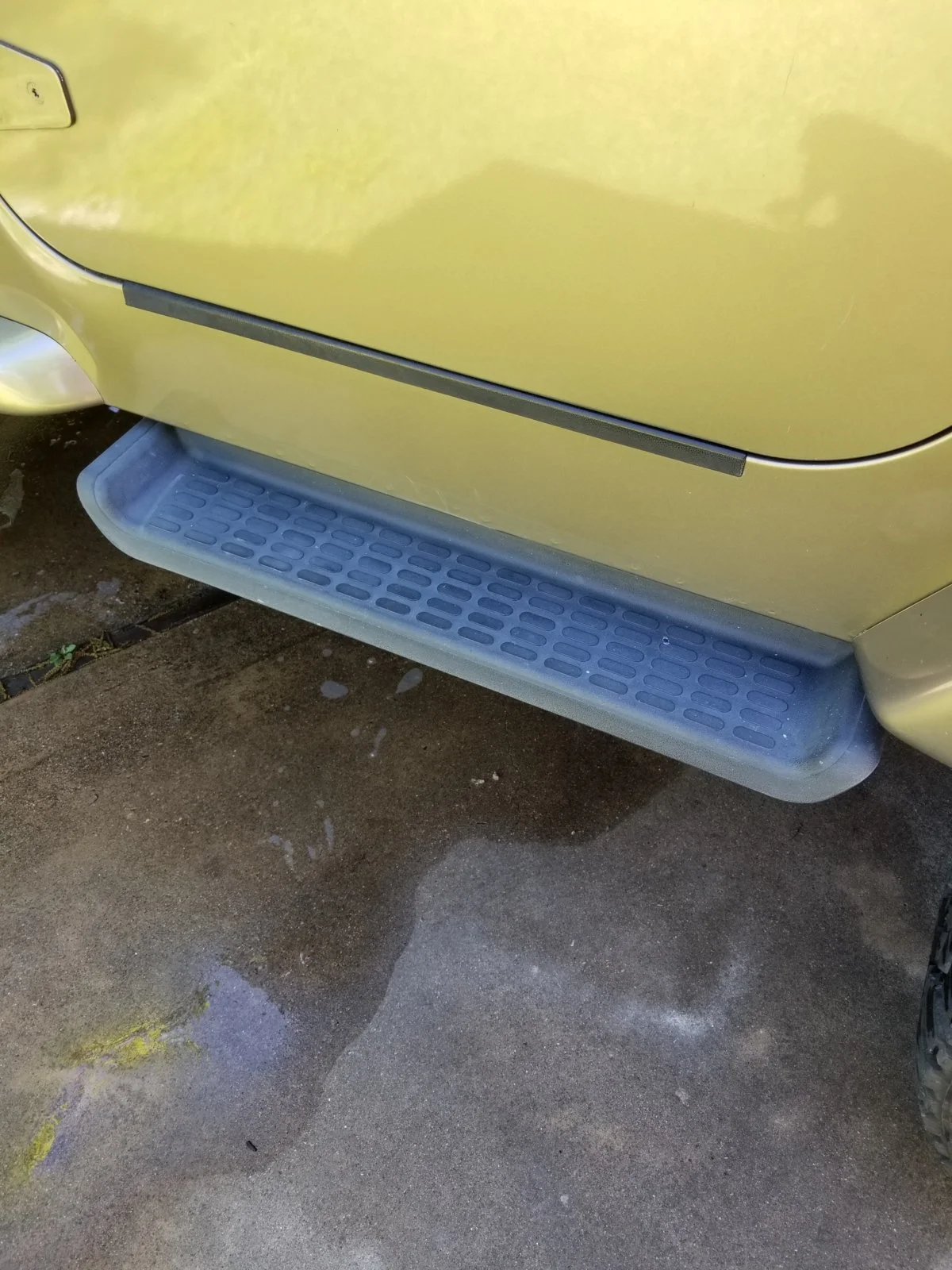

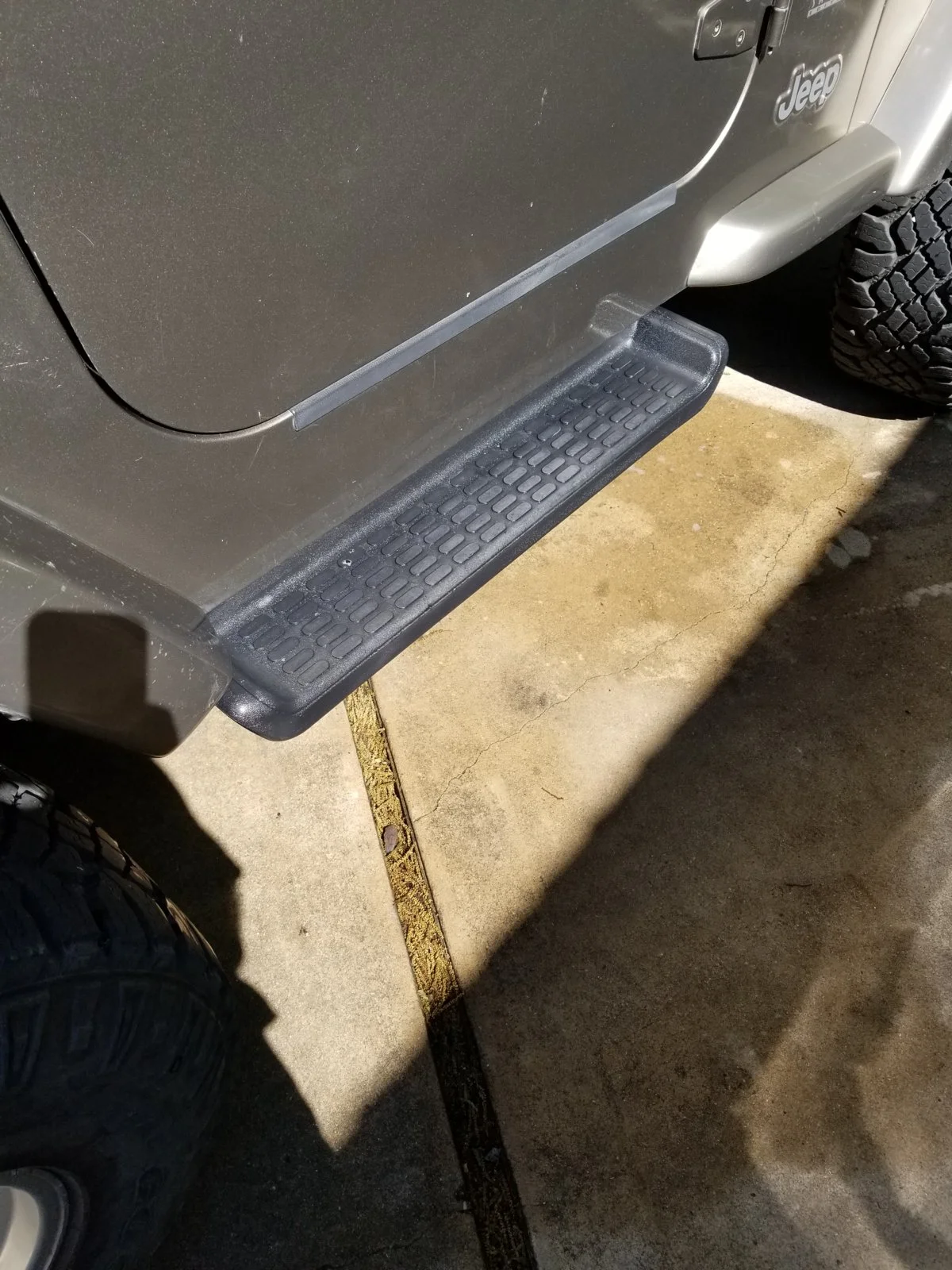

AFTER - Black and somewhat new looking
Check the color difference of the light metallic khaki from shade vs sun. Looks like 2 different Jeeps.

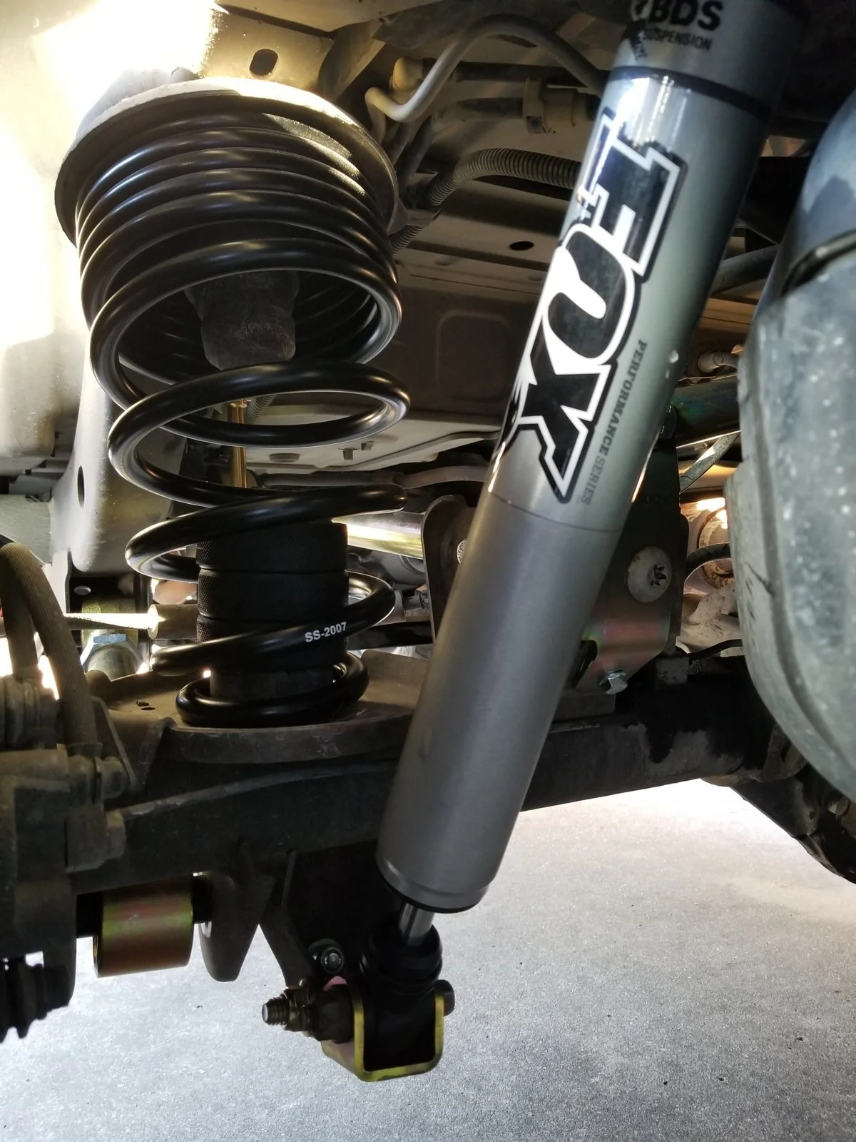

Can someone educate me on the purpose of springs where the top five coils are touching?
I’m fairly certain @mrblaine had something informational to say at one point regarding springs like this. For the life of me though, I can’t find the post.
I’m by no means an expert, but it would seem that compressed top portion is effectively useless. I’m probably wrong though.
View attachment 40752 View attachment 40753

Springs that are coil bound like that are essentially acting as a spacer. They don't compress, so provide no liner compression resistance. Marketing gimmick. There is only one way to make a progressive rate spring, and that is by varying the wire diameter. Spring rate is a very simple calculations...F=K*x
F = force
k = spring rate
x = distance
all the magic happens with the k variable...
