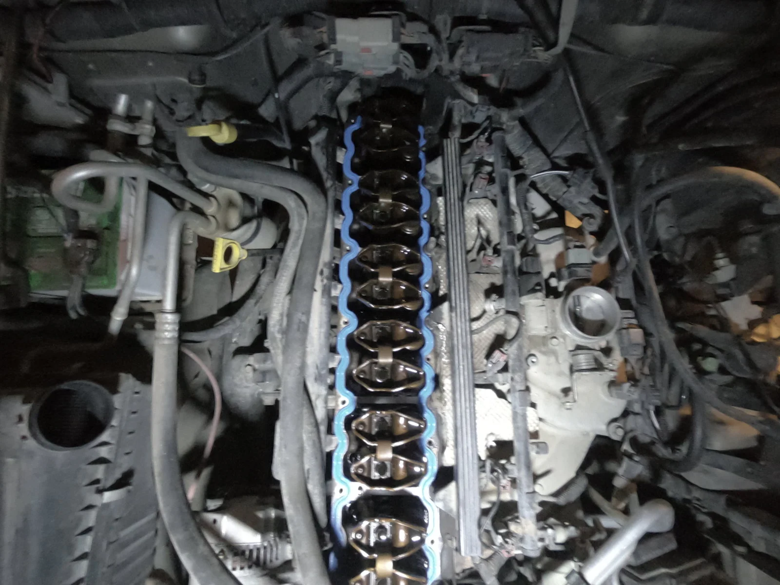

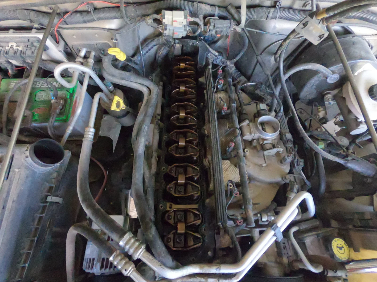

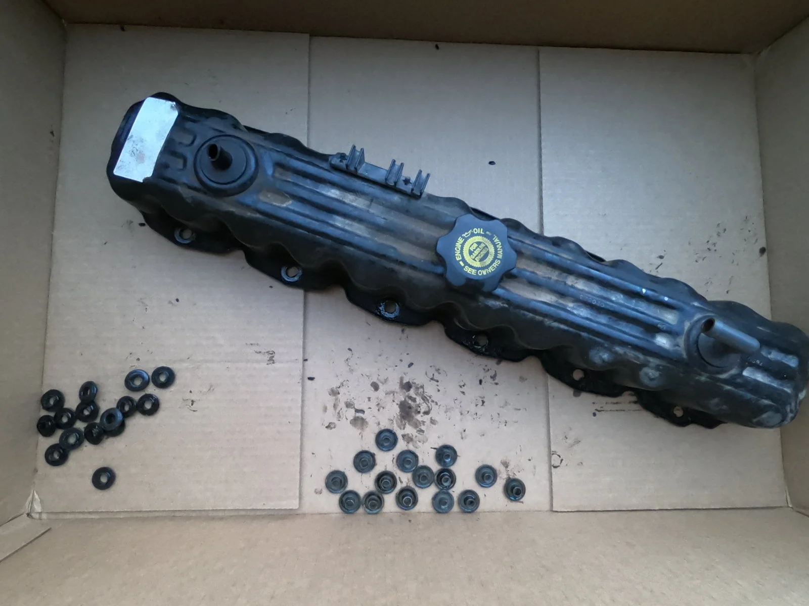

Replaced the valve cover gasket today. The leak was getting bigger so I figured it was time to go for it.
I got all the bolts out with no issues, even the tricky bolt in the rear. The harness in the rear was a different story. I felt like I wanted to break that thing to pieces and get rid of it! After fighting with that bad boy and a bunch of wiggling back and fourth of the cover, I finally got it off.

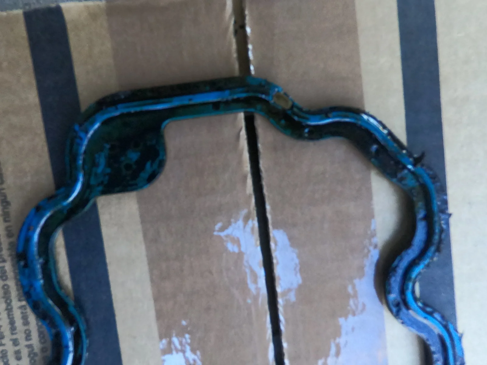

The old gasket was torn. I'm hopeful this is the only oil leak I had.
Got everything seperated and ready for cleaning.

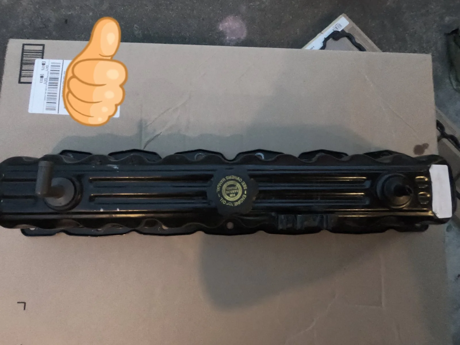

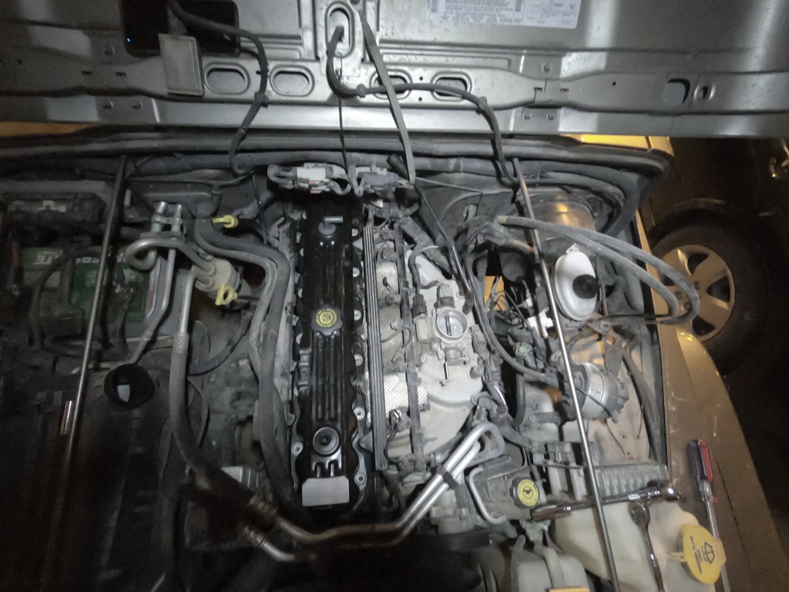

Cleaned up the valve cover the best I could. Almost clean enough to eat off of.
Put the new gasket cover on after some more cleaning. The rear area on this particular job is a real bear! I think I got it cleaned good enough though.
The cover went back on fairly easy.
Hoping this is the only oil leak I have.

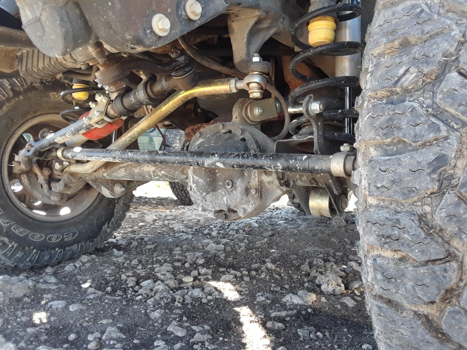

I'm looking at your suspension pic and it almost looks like your track bar is touching your drag link. ?
I'm sure it isn't because you would know, but is that a rub or wear mark on the track bar, not sure.
Could it be so close that it is giving your Jeep some vibes?

Must be the angle of the camera. Just checked it lock to lock and the drag link isn't even close to touching the track bar. Sure does look like its touching though.

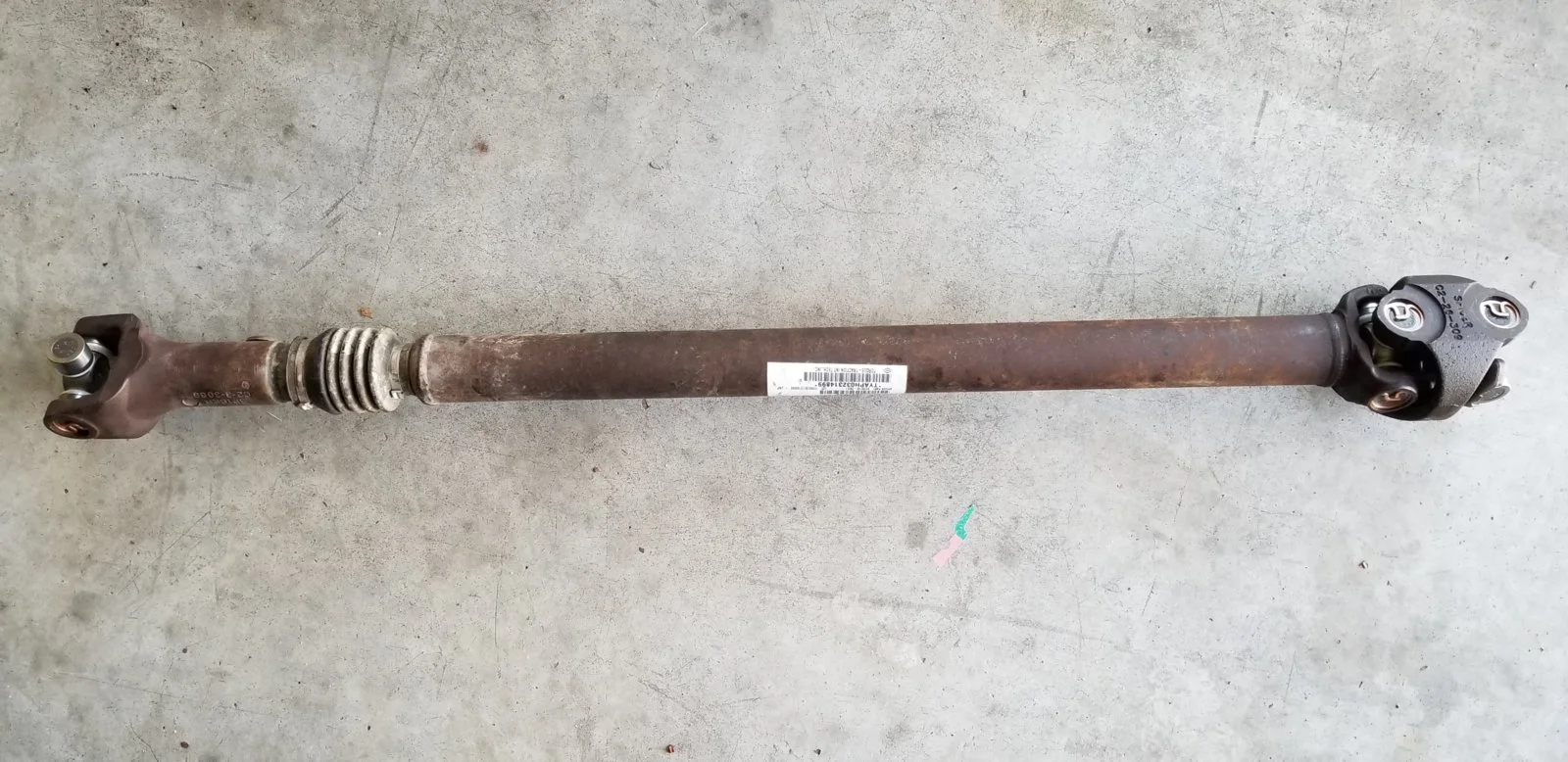

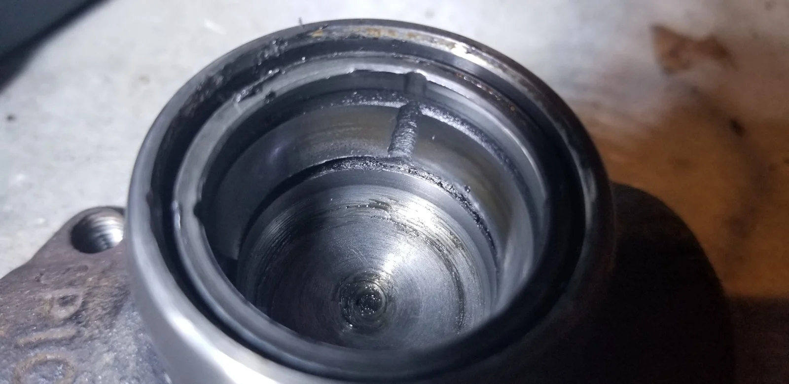

Finished up my front drive shaft before we hit the trails yesterday.
This was my 1st time changing ujoints. The centering yoke was a small challenge but I found one YouTube video that helped me a bunch.

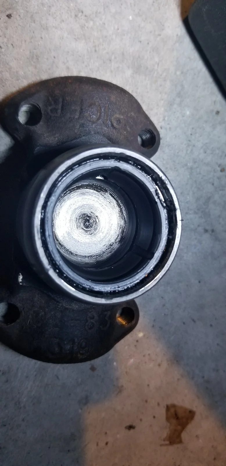

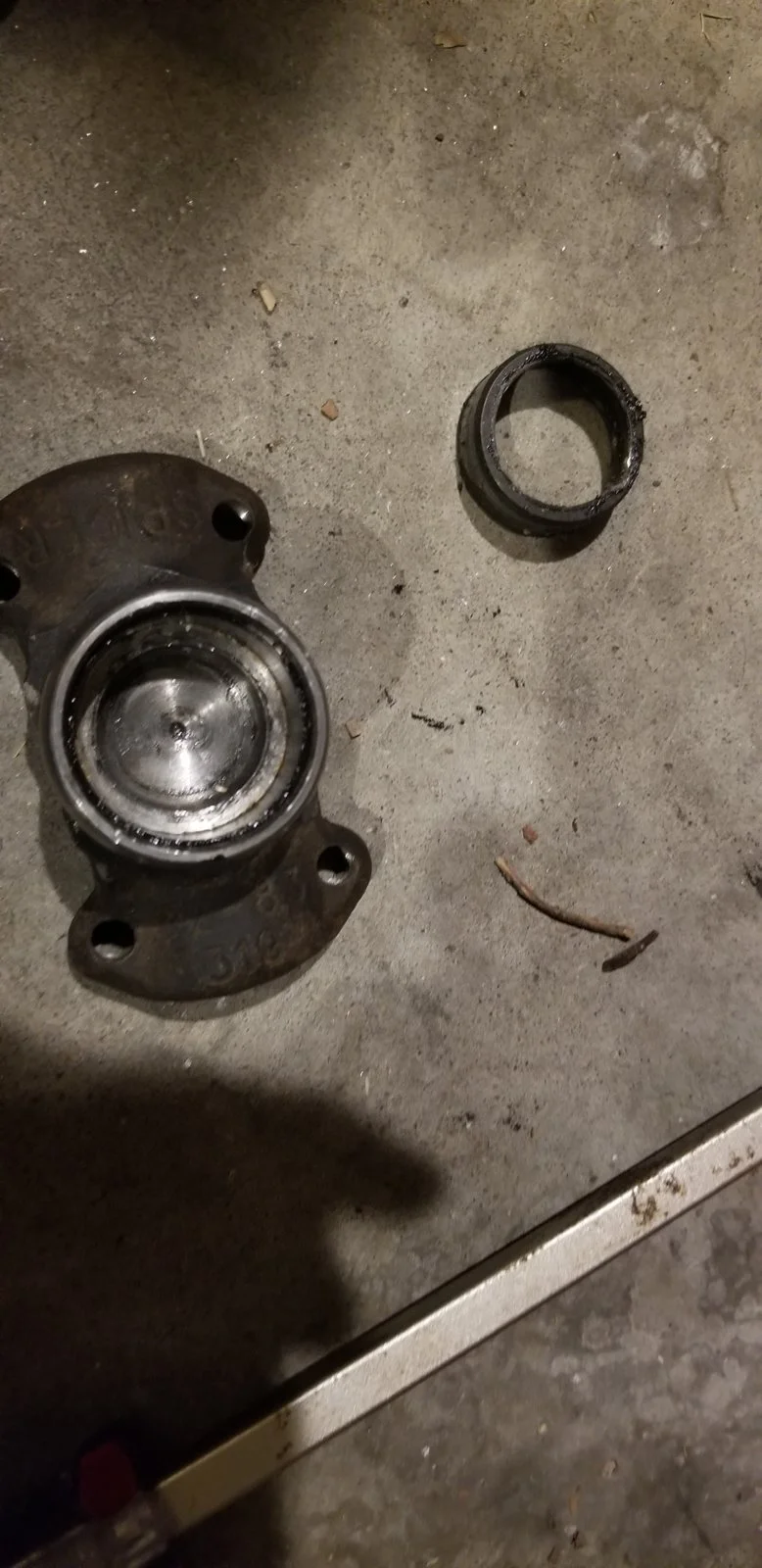

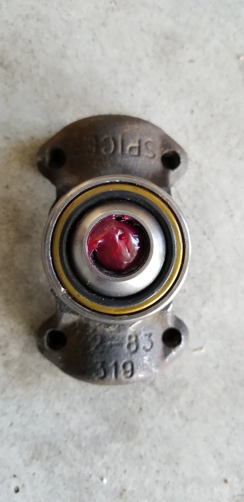

You can get the ball out of the centering yoke by turning it to where the holes are exposed on each side. Use two screwdrivers on each end and pry it out. (Sorry no pic) It may take some time but eventually it will pop free.

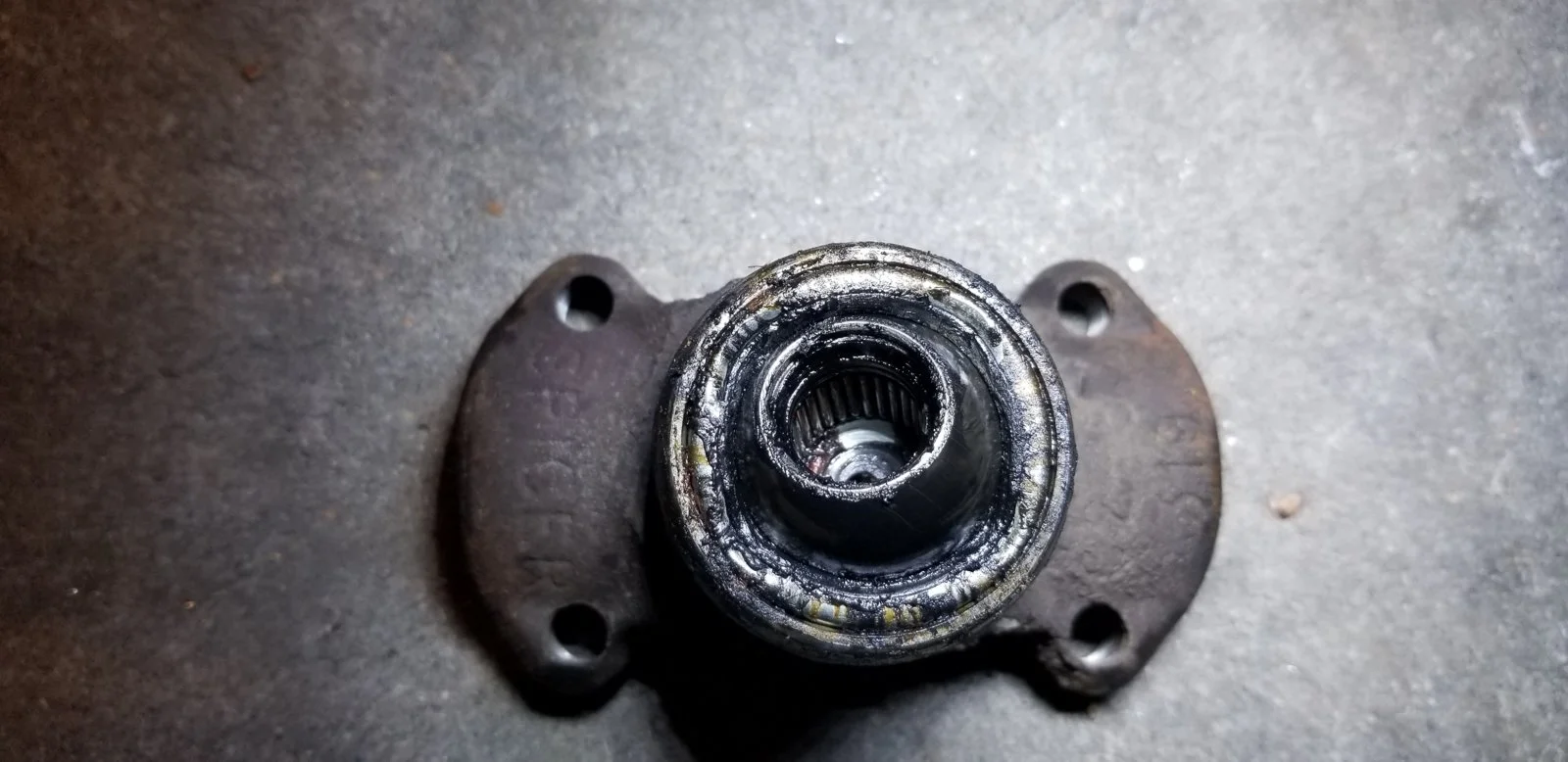

This is what you are left with. This ring needs to come out.

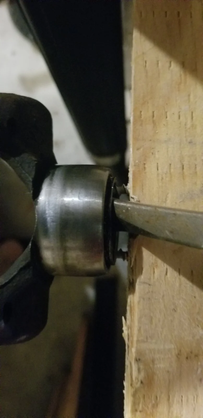

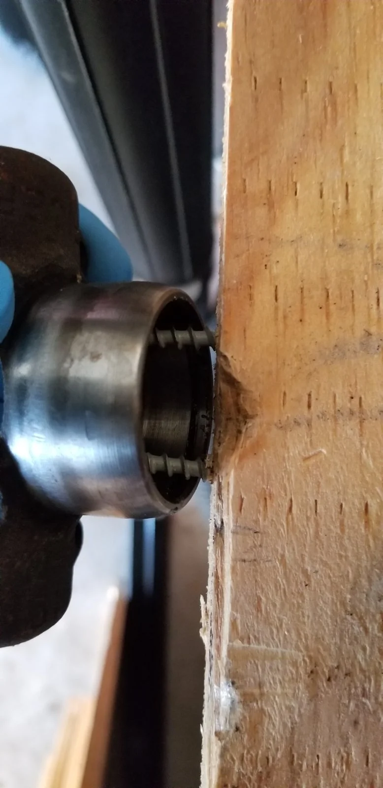

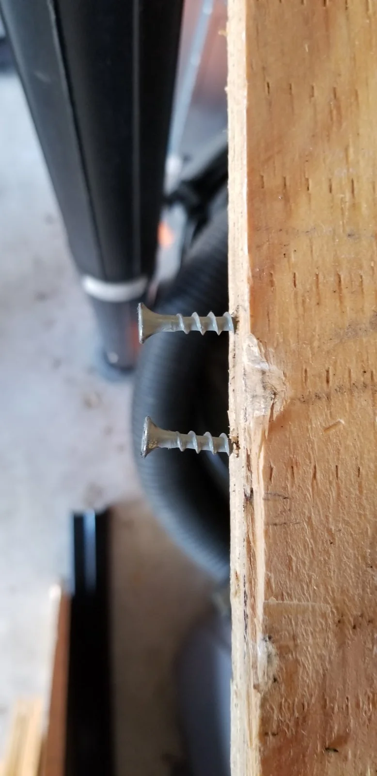

I used a make shift puller with two screws, socket, screwdriver and a hammer.
Put 2 screws into a shelf that is mounted to the wall.
Drop a socket that will fit into the centering yoke. (I forget the size I used)
Use a screwdriver to apply pressure against the socket. Tap the centering yoke with a hammer. You can see the inside ring start to break free.
Centering yoke with the ring removed. Clean it up and grease the yoke.
Install the new parts and this is the finished product.

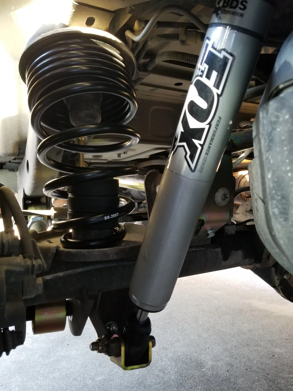

Can someone educate me on the purpose of springs where the top five coils are touching?
I was just on the MC website a few days ago, and they say the extra coils at the top allow the spring to maintain contact with the spring cups during full droop. And their was something about the collapsed coils no longer affect the spring rate for single rate performance on the road.
That might not be 100% accurate, but it was something like that.
