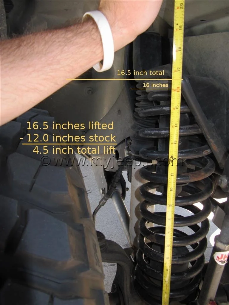

12" front and 8" rear are stock spring heights while sitting. Add more for spacers.

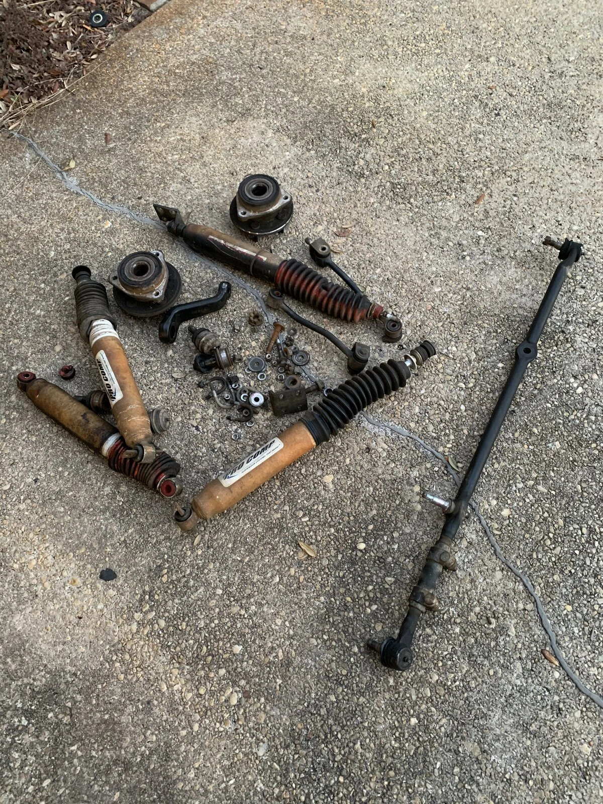

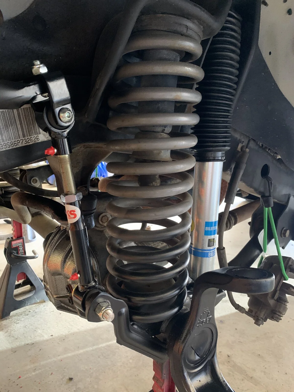

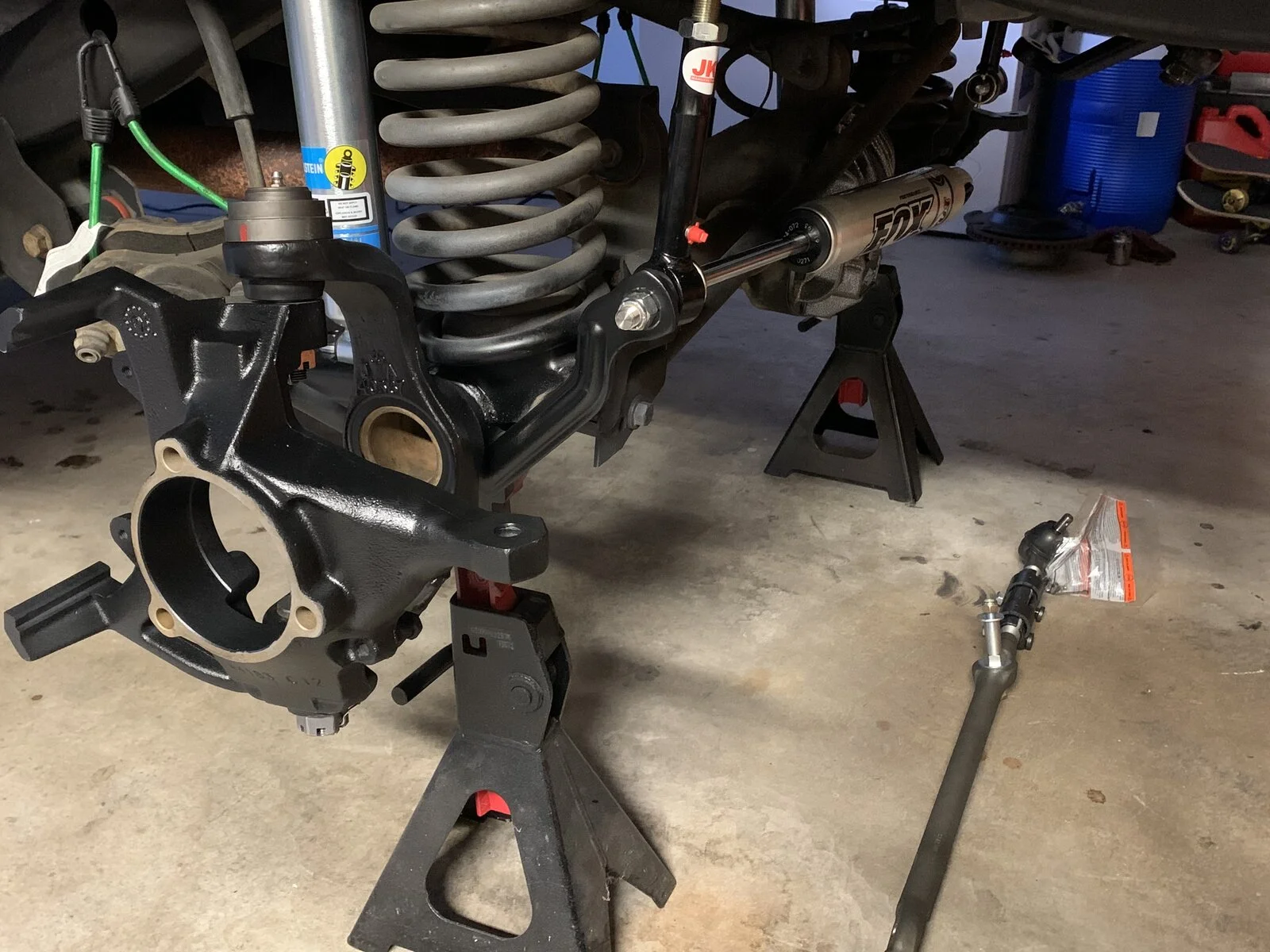

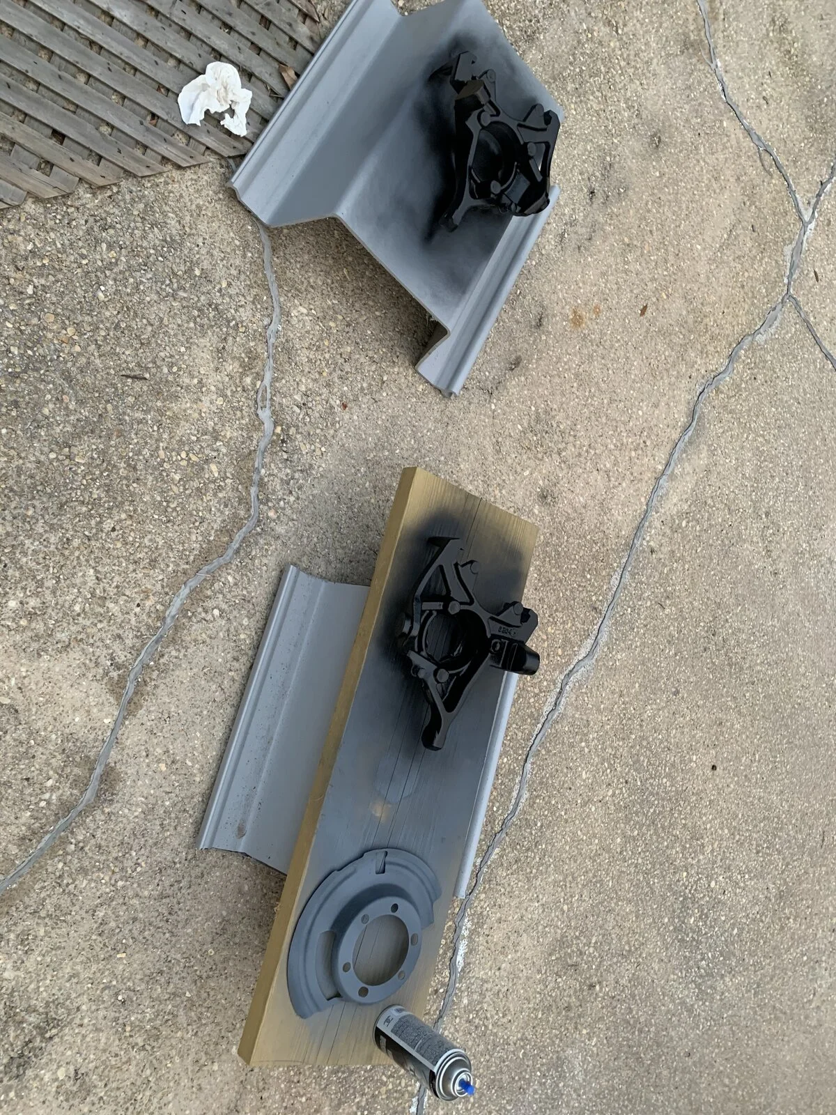

We were in the same exact boat when we bought our 2006 TJ. Not sure if it was true DW or bump steer but at 45 MPH the whole Jeep would shake and rattle to a point where it was unsafe to drive. Not knowing what lift, when things were replaced etc we decided to bite the bullet and replace the entire front suspension and we are so glad we did. Drives so much better now. Took about 2.5 days and cost us about a grand (thanks great grandkids for the stimulus check!) but the time was mainly spent on prepping, priming and painting.
For specifics on your questions, we were able to determine the size lift based off the coil height and some google/forum posts. It was also confirmed by a local Jeep enthusiast who took a look at our set up to point us in the right direction. Once we knew the lift height (4 inch in our case), shocks were easy to shop for, just be ready for opinion overload if you ask which shocks to buy. We went with Bilstein because it was the best rated at the best price point for us.
We replaced everything so we knew what and when. The ball joints were tricky, but nothing terrible especially seeing your maintenance accomplishments. The key is a good kit. I "rented" one from advanced auto that was $249.00 bucks and had everything we needed to get the job done. Impact, good sockets and breaker bar are also a must. Take your time and make sure they stay even as you press them in.
As for hang ups, I'd suggest taking it to a shop to see how your alignment is before you start. If you are going to do the ball joints knowing your caster/camber is important. I had everything apart and received some MOOG adjustable ball joints and since I didn't know where we started, no one could correctly tell me at what degree to set them at. I did some forum reading, rolled the dice and tried to set them at what I thought would be the proper camber degree. It wasn't... The shop was able to get the right toe and steering alignment, but the camber is off and so I either address it, or prematurely ruin a set of tires. The fix is to re-do the ball joints which although is a bit of a set back, I learned so much it really doest seem like that much of a chore this time around. All in all though Im glad i did evertything because the ball joints that came out were shot. Think joystick on an old pac-man game. Every bushing crumbled to dust, the shocks could be pushed and pulled with ease, everything was in desperate need of replacement.

This is incredibly useful for me. Thank you so much for the guidance and pictures. Your set up came out so clean and I hope mine looks the same lol
