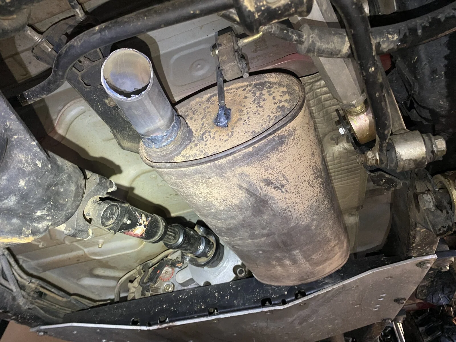

Is this bad? 🤣
Damn exhaust shop. Shit job. Supposed to be the best.

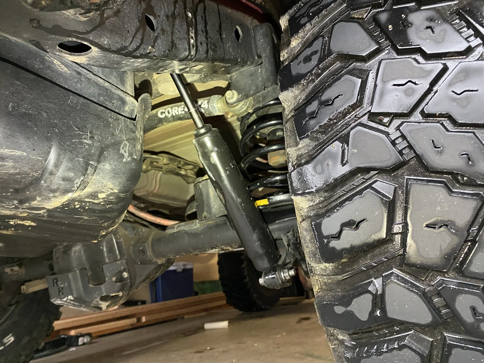

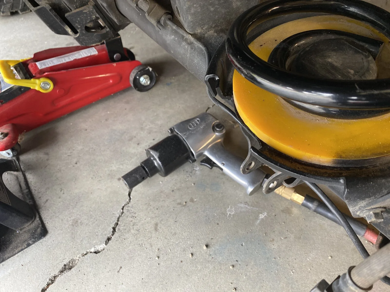

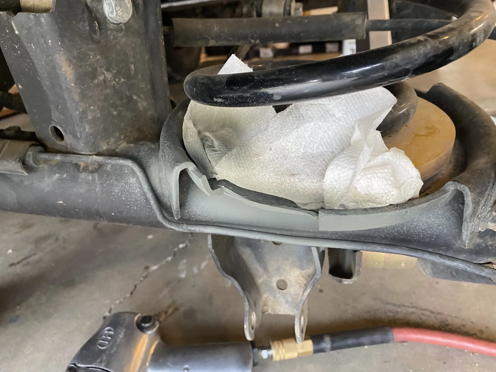

Getting rid of the lower shock extensions. Cutting the perches. Will see if this works with the exhaust.
Yep it's why the sell the shock shifter stuff. I did the same thing to my shocks way back when.
Reactions: Alex01
My rear shocks looked similar if not worse after hitting the spring perches and didn't give me any issues.
Reactions: Wildman and JMT
Agree with @jodomcfrodo. I trimmed my tailpipe when I did my tuck. Cut the downturn out so my exhaust exited pointing straight at the bumper. The exhaust gasses burned the powder coat on my bumper. I had to trim the rest of my tip and install another, shorter, downturn.
  • Sad
Reactions: JMT
I would get a full turn going out the side of the Jeep. You'll have a lot of hot air heading back towards the gas tank when driving on the road. Want to get all that hot air out away from the underside of the Jeep as much as possible.
Meh...I love it, Hot air will be absolutely fine, by the time it reaches the gas tank it will be air temp. If I had 10 more Jeeps I’d do this to everyone of them. Eliminates so many issues.
Not so sure about that ;)
If I blow up, you’ll never find out. 🤣
Those guys at the muffler shop been building them hot rods round these parts for 35 years. They know whut they doin’!
My last tailpipe that came beside the gas tank and out the back looked like a pancake. Tired of that shit.
