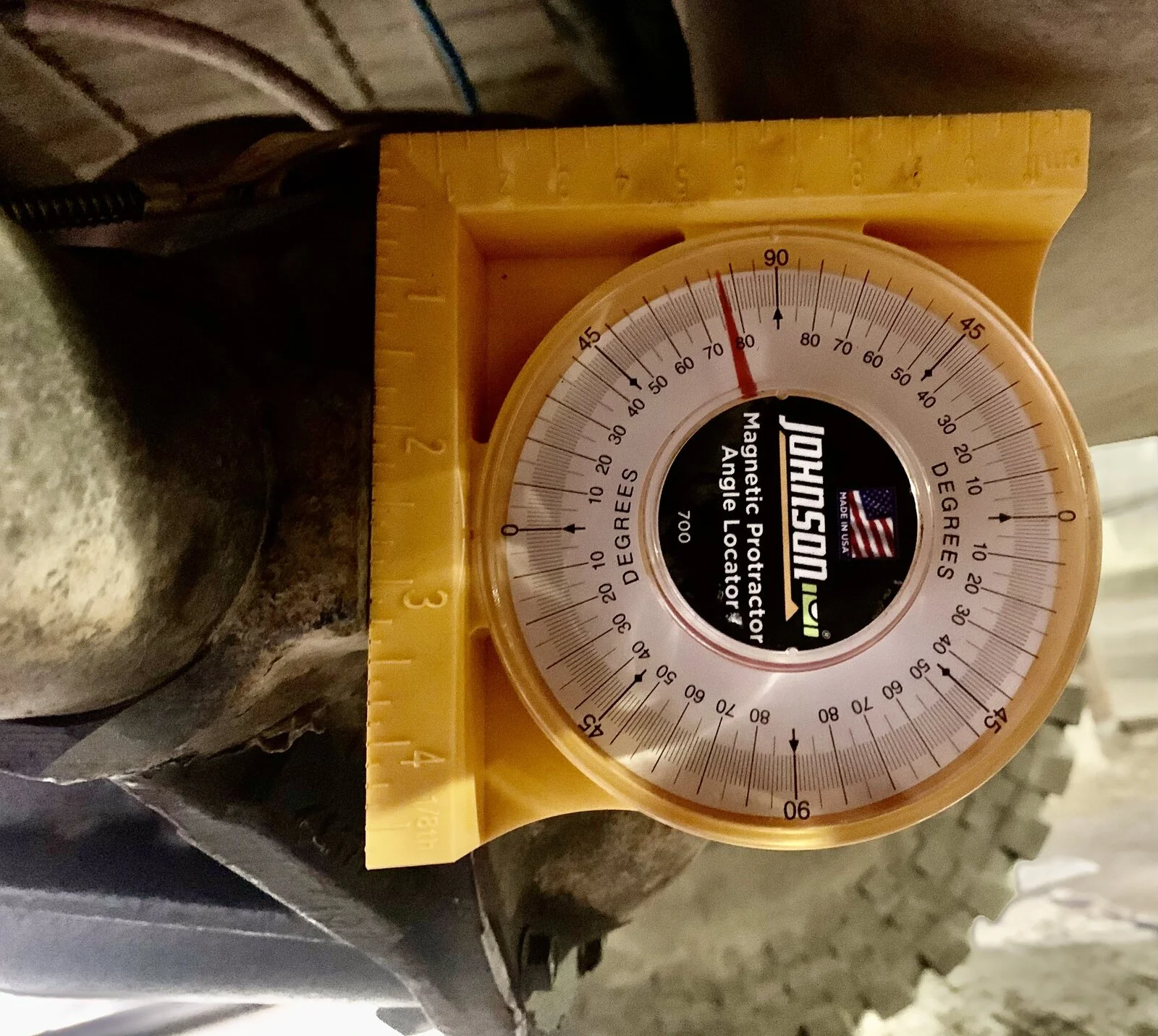

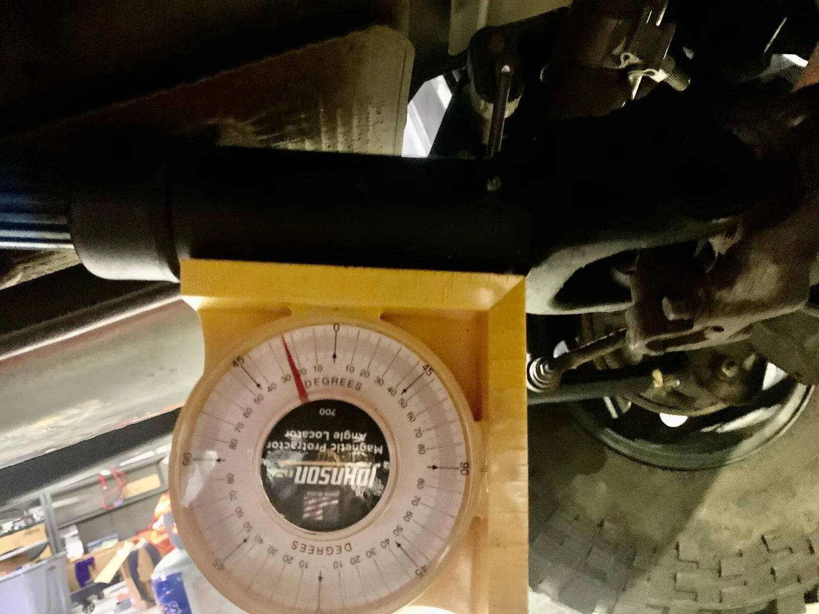

If I'm measuring correctly, my pinion is about 9 to 10 degrees lower than my driveshaft. Heart attack city for a lot of people. Correct me if I'm simply measuring incorrectly, because the extent of the difference even surprised me.
View attachment 202451View attachment 202450
That’s nuts, ~10* lower pinion. You can tell too at the u-joint. But no vibes, so happy days!
