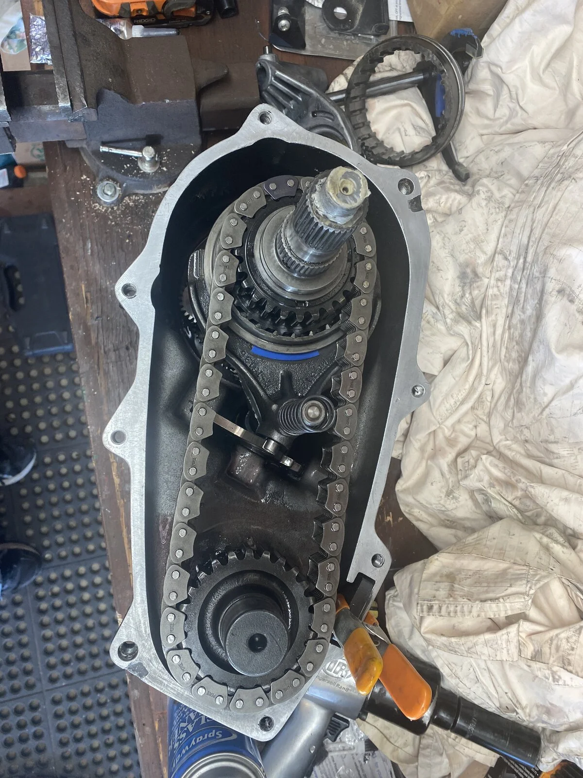

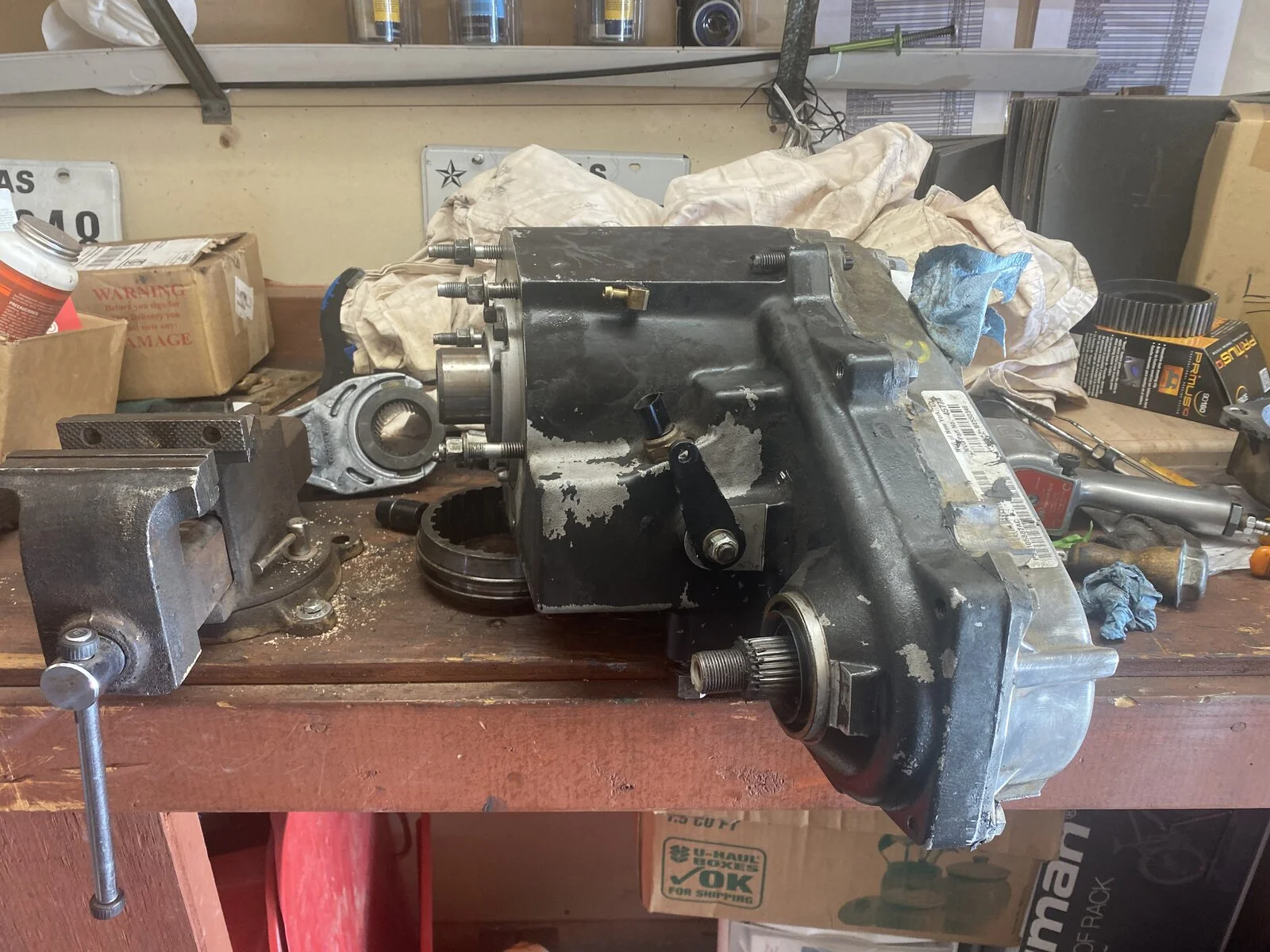

I got the sprockets swapped from the 2 SYE’s to get enough clearance for the chain. With a little help from @Wildman, I was able to check the functionality of 2, N, 4H and 4L. Fortunately, the chain didn’t rub anymore. Everything shifts well. Wildman, you were right, the selector was in the wrong orientation. Corrected now. It was nice listening to you since you knew all the nuances of the TCase. Good stuff. Helpful.

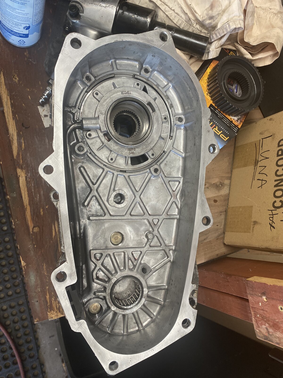

Got the case mating surfaces cleaned up and RTV applied very lightly. I spread it thinly with my finger. You don’t want gobs, because it will get in the case, break free and get in your filter for the pump pickup and clog it up. Had trouble getting the case back together, but it finally went together. It’s all cleaned up and ready to be installed tomorrow.

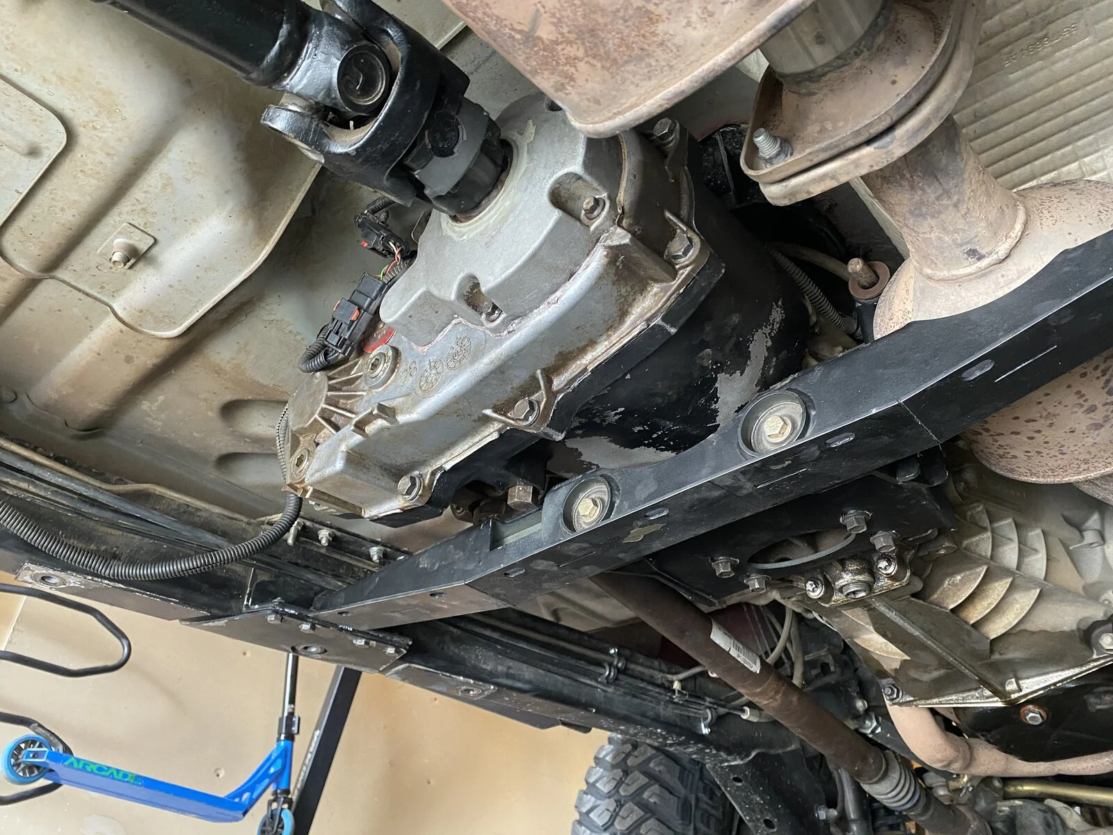

@DrDmoney. The 4:1 Tera Low is now installed and everything done except the skid plate. My boys helped me, so it only took about an hour and a half to get the TCase bolted to the tranny, the transmission mount, the vent tube, TCase sensor, Speedo sensor with brackets, crossmember, driveshafts and new ATF+4. I like to drive a few miles, check bolts and fluids before putting the skid on. Tomorrow’s my birthday, so I’ll do that tomorrow
The first test drive in front of the house. My boys with me, they were like, “WOW, that’s really slow! That’s way slower than before dad.” I got out and walked by the Jeep a few yards. My face was all grins bc I know the kind of capability this will give me when I need control. Game changer. 😊😊😊😎😎😎.
Then we drove to O’Reilly’s to get some supplies. Everything looked good when we got home!

Thanks. It was pretty fun sorting out the details. The tolerances on the chain are so close at the fork that if inverted on the bench the chain will rub. Not being under tension from the back half of the case doesn’t help either. When I laid it in operation position, it just cleared by a couple of mm.
