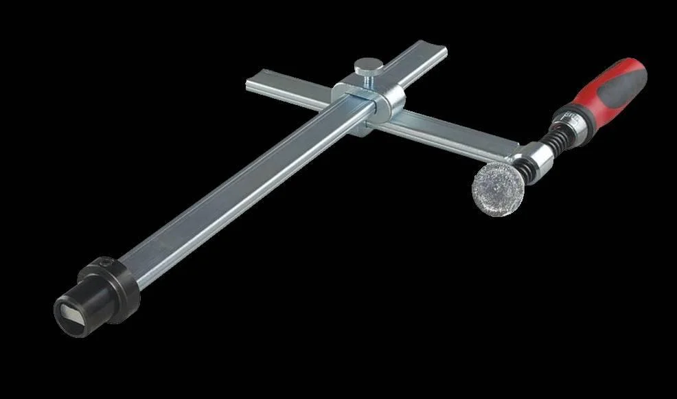

Looking at the CertiFlat DIY Weld Tops like the one you put on top of your mobile weld table. I found this one that looks really nice. https://weldtables.com/collections/...elding-table-top-kit-most-popular-pro-top-kit What is the purpose of the holes? How does it help you weld? Why do they make such an emphasis on the table being so flat? Is it so your pieces are laying flat as you weld?This was my first project with the welder...I put one of those certi-flat DIY table tops on it. Used some 1.5" tubing that was laying around at work. The tool box was hanging around, not being used, it will hold two bottles of gas (TIG and MIG) and has room for a plasma.
The holes are to hold fixturing clamps and aids. They are 5/8 diameter and laid out in a perfect grid, so you can drop some shoulder bolts in, place your steel up against them and use them to fixture your project. Makes laying out 90° corners a breeze. Its important to be flat because you will be clamping stuff down to it, and if it's clamped flat, it will be flat when you finish. Its all in an effort to keep the workpieces constrained as much as possible so stuff doesn't move unexpectedly on you.Looking at the CertiFlat DIY Weld Tops like the one you put on top of your mobile weld table. I found this one that looks really nice. https://weldtables.com/collections/...elding-table-top-kit-most-popular-pro-top-kit What is the purpose of the holes? How does it help you weld? Why do they make such an emphasis on the table being so flat? Is it so your pieces are laying flat as you weld?
Very interesting system. Those clamps look very helpful for bench welding.The holes are to hold fixturing clamps and aids. They are 5/8 diameter and laid out in a perfect grid, so you can drop some shoulder bolts in, place your steel up against them and use them to fixture your project. Makes laying out 90° corners a breeze. Its important to be flat because you will be clamping stuff down to it, and if it's clamped flat, it will be flat when you finish. Its all in an effort to keep the workpieces constrained as much as possible so stuff doesn't move unexpectedly on you.
A clamp that would drop into the holes (there are DIY versions you can make too)
I’m always trying to talk myself into a mag-drill to do that to my big fab table. One day…Very interesting system. Those clamps look very helpful for bench welding.

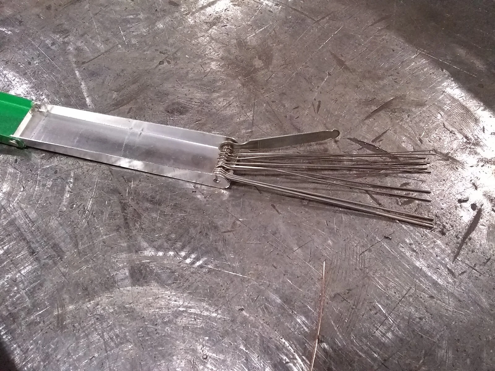

Had the same tip on my work welder for almost 2 months and my home tool still has the one it came with 3 yrs ago. Have a few extra. not a whole bunch. The tip dip is made so your not replacing the more expensive tips to often.
