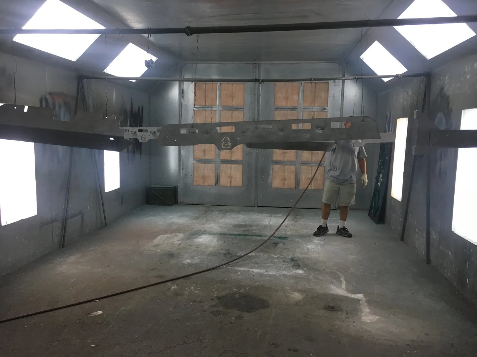

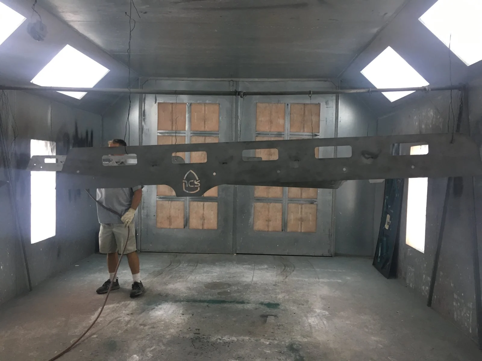

Today I went out to my friend Joe’s place to prep and paint my JCR Crusader Rock Sliders. When I arrived we went in a back room in his shop to do the media blasting to etch the steel. My kids thoight I looked like Michael J Fox in Back to the Future when he’s wearing that HazMat suit. All’s well for about 5 min till sand just starts gushing out without much pressure. We worked with it for a bit till we gave up and went into the media blasting with those tiny handguns, works though.
Then we hung them in the paint room and wiped them down.

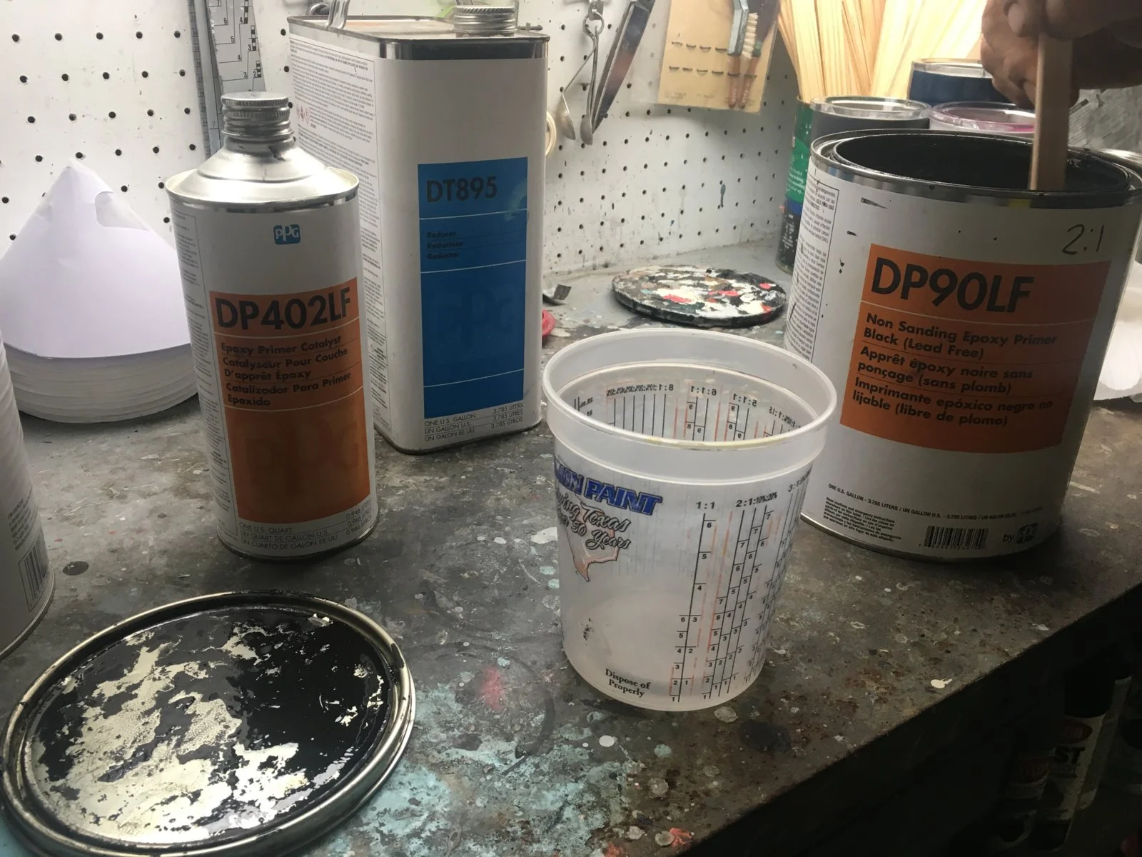

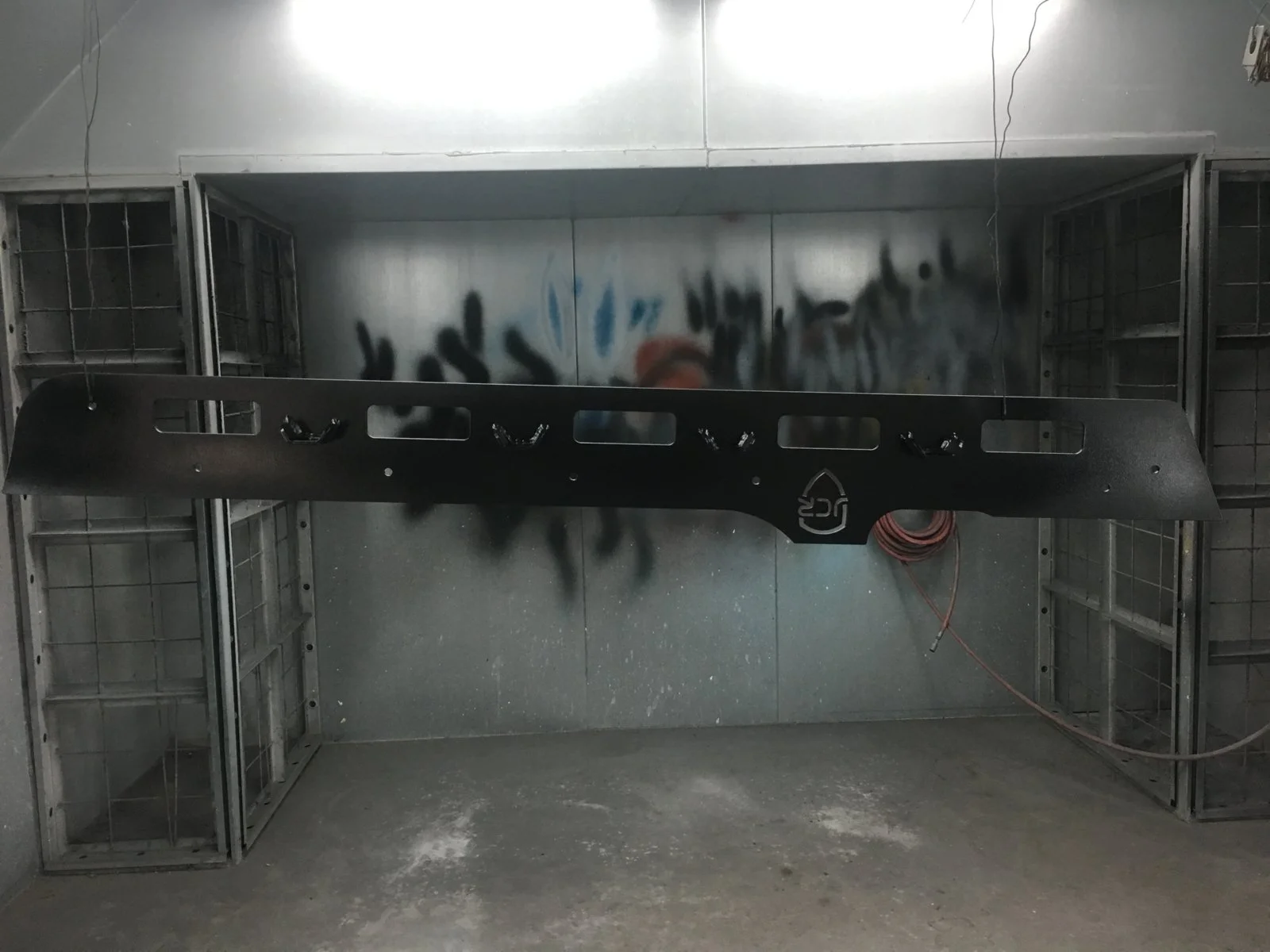

Then we mixed the DP90, Epoxy primer and reducer ~14%.
I gave them 2 coats.

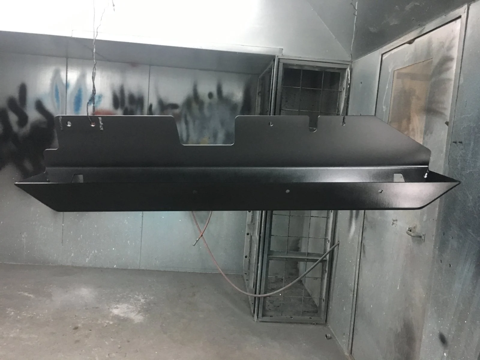

Then we mixed the 2K Ceramic, activator and reducer. That stuff is thick when you open the can. I’ve never experienced anything like it. 7 coats on all the areas you will see and scrape. 1-2 on all the rest. Should be cured in 24 hours. Hopefully I can get them installed Thursday afternoon.

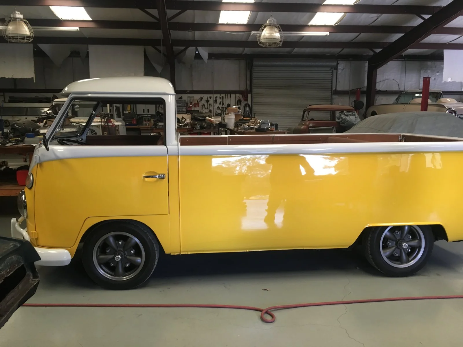

Added a few cars Joe is working on now. These are obviously nearer to completion. @Squatch could tell me what they are
The VW is far from stock, I can tell you that. No window frames (like what a true "hardtop" car has). May be a modified bus. I like it! The white convertible is a 1962 Thunderbird Sports Roadster (or a copy of one). That fiberglass tonneau cover actually covered up the back seat, making your T-bird a 2-seater (hence the roadster moniker, amongst other reasons, obviously). And the convertible top could be used either with or without the tonneau cover on. They were beautiful cars. One of my all-time faves!
