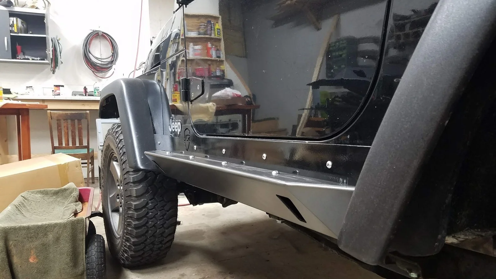

Those sliders do look beef! @Ranger_b0b , what are your thoughts on trimming the flare here so it fits flush to the fender?
I thought about that... But trimming it means you're trimming the mounting flange. The metal is thicker than the plastic, so there wouldn't be any way to anchor the bottom of the flare.
Good point. Bout the only thing you could do there would be double sided automotive attachment tape, if you had enough contact patch left after trimming to apply it. I've seen my share of factory cladding attached by that stuff to know it holds pretty dang well.

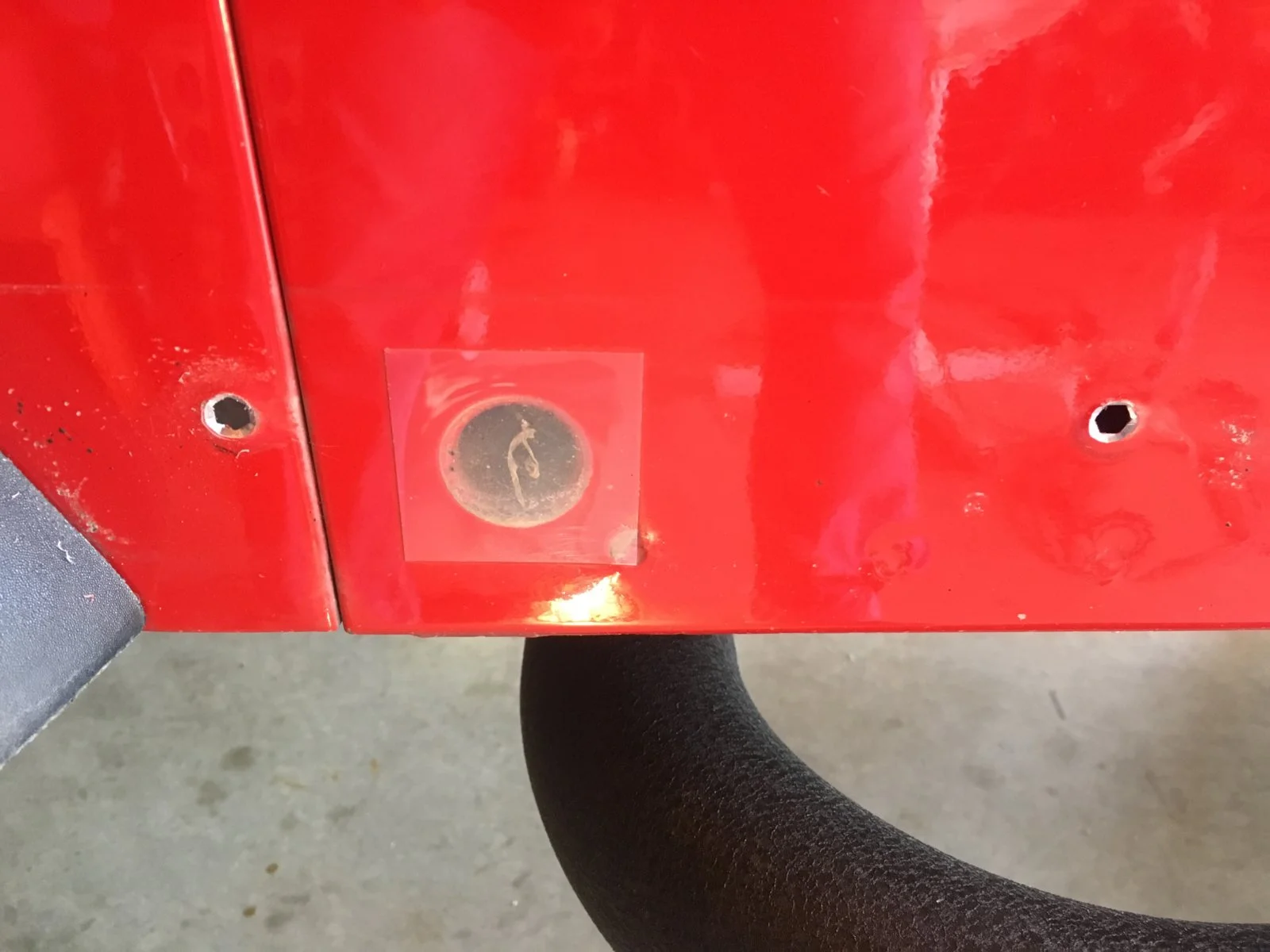

Today we took the morning to ride MTB at Flat Rock Ranch in Comfort, Texas. After lunch I worked on prepping for my new JCR Crusader rock sliders.

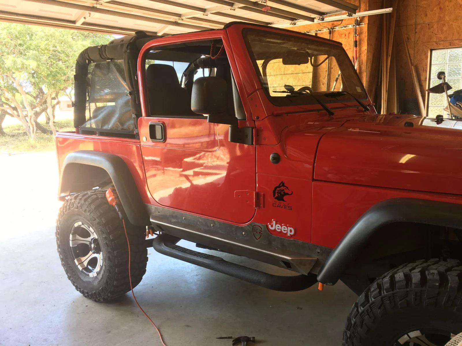

First, I had to remove the Flare extensions. An 8mm ratchet is a must for this job.
All the people in the Rust Belt will hate me when I say that they all came out perfect.

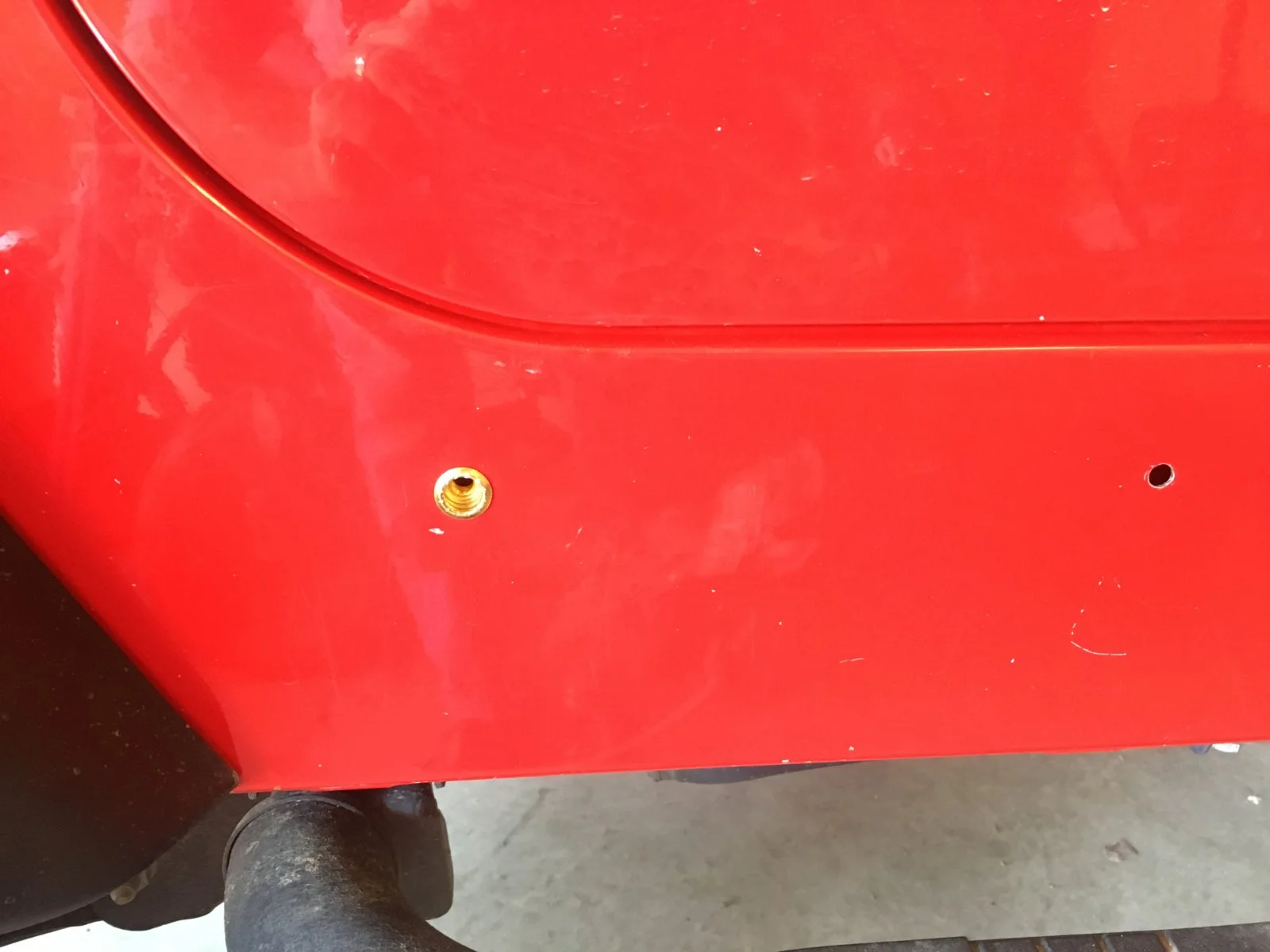

Nutserts still intact
Drilled the nutserts out

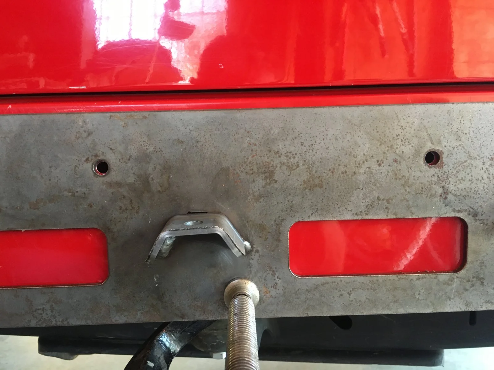

Then I use the same 8 mm ratchet to remove the first bolt on the front flare at the rear and the first bolt on the rear flare at the front. This is to slide the back plate under so they can be held in position for drilling your pilot holes into the tub. These are WW2WW which I highly recommend. There is more tub there than you might realize.

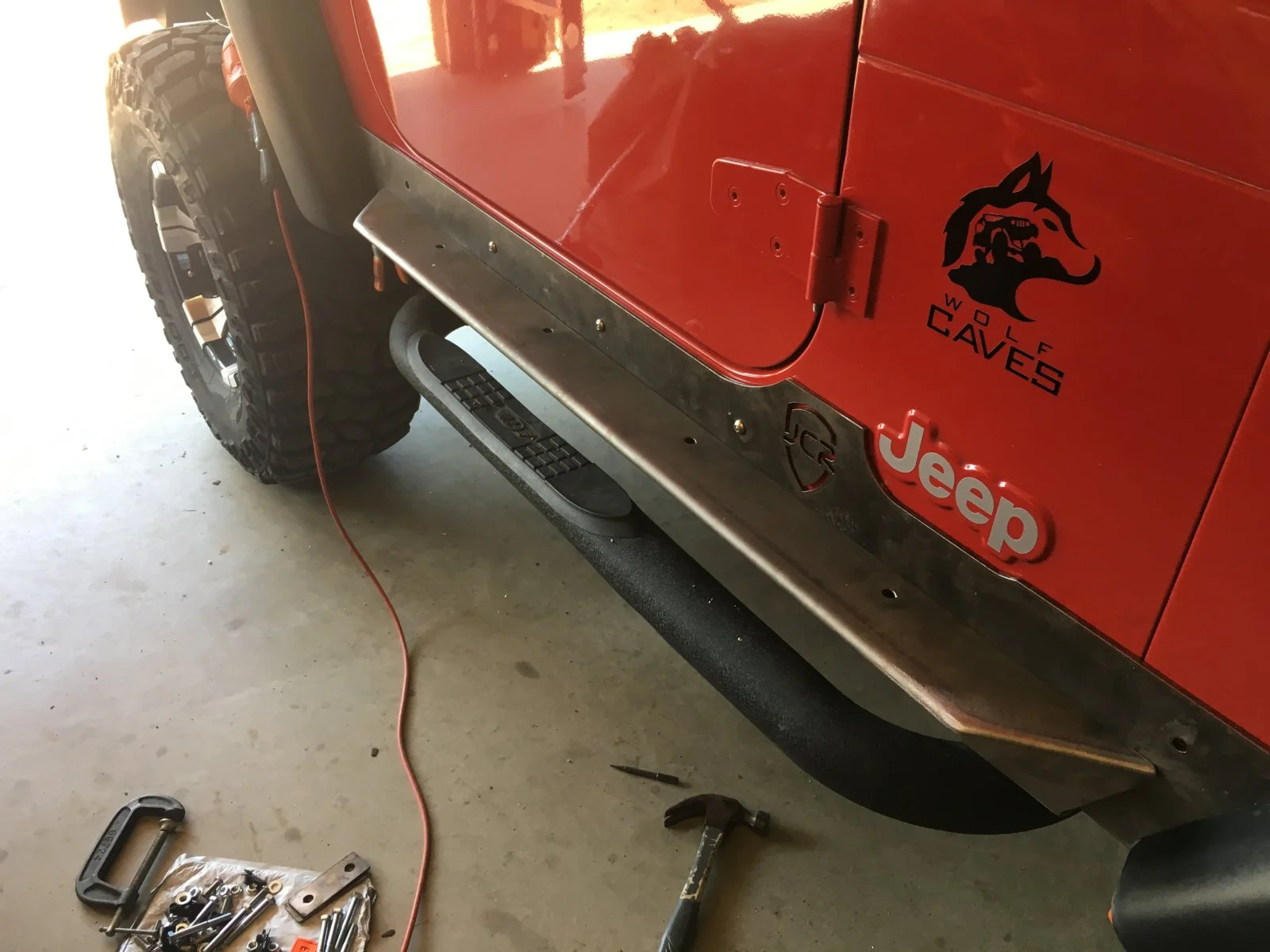

Then I preloaded the backplate. JCR uses a two piece design with the back plate that mounts to the tub and then sliders that mount to the back plate and the underside of the tub. Yes, the stupid nerf bars are still there, but I’ll have to use them for another week or so.
Used the backplate as a guide to drill the holes
Sat the slider on it just to give an idea of the final product. Wife volunteered that they would look awesome and totally transform the Jeep!

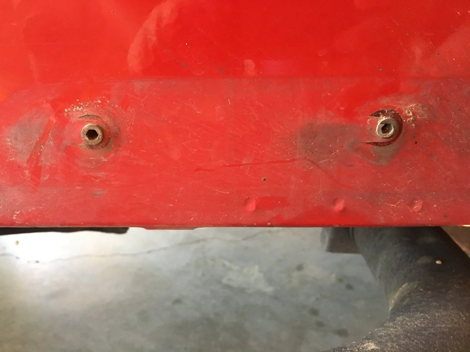

The rear most mount on each side will require a nutserts. JCR mention this as necessary for the LJ, but I need it for my TJ because the body panel on the inside won’t accomodate a regular nut and bolt.
These go to my friend Joe on Monday for sand blasting, prep and paint with 2K. Will look perfect
